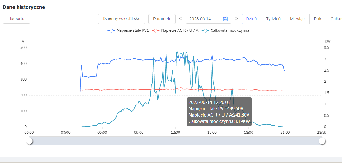

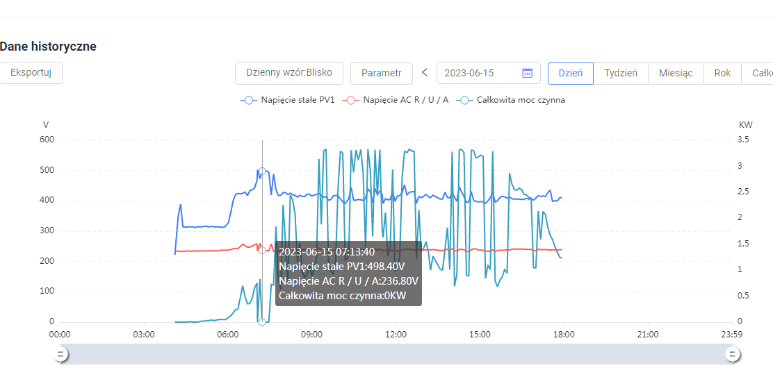

    The inverter is failing (there are periods when it turns off and there are periods when it works continuously).
    Yesterday it did not turn off even once when it generated maximum power, i.e. 3300 W.
    SOFAR 8kW PV Installation: Opinions, Durability, Failures & Experiences with Inverters
    Today, around 7 am, it turned off several times with a power output of about 800 W, raising the voltage to about 260 V, while the voltage I measured in the AC box right after it turned off was about 236 V (you can also see it on the chart). I connected a 2000 W load then - it stopped turning off and I disconnected the load right after. And so from 7 am to now (17:30) it works without load and does not turn off.
    At 5 pm, when the inverter was generating 2200 W, I measured the voltage in the AC box of the inverter:
    - no load 2000W - 239-240V
    - with a load of 2000 W - 234-235 V
    The situation is embarrassing because if I send the inverter to the service and it is tested, it may work well or badly during the test. If it just happens to work well, it will come back to me, and for me it may work well for a while, then badly again. Maybe I'll hold off on sending the inverter to the service and watch its work. If it continues to fail, I will write that it behaves unstable and ask for a replacement for a new one.

  • #1565 20619232
    3301
    Posts: 2100
    Help: 224
    Rate: 868
    >>20618465
    Download in Excel from the export tab the parameters from the day when it turns off, although these will be 5-minute readings, but maybe you can catch something.
    The fact that the DC voltage increases is not the cause of the problem of the inverter switching off, but the result of the lack of load on the string, e.g. as a result of the inverter switching off due to too high voltage or lack of AC voltage.

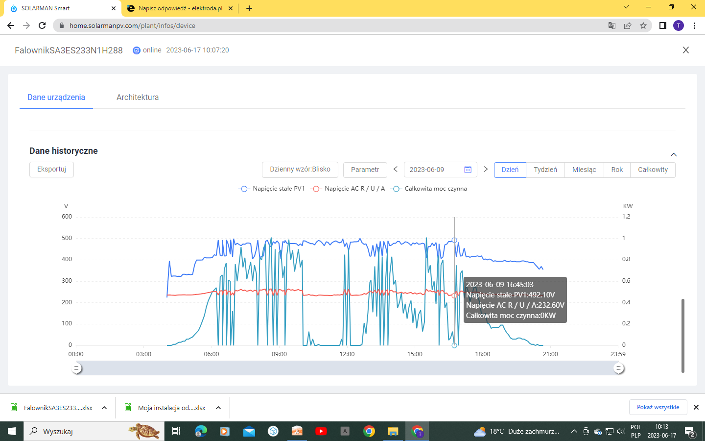

    3301 wrote:
    >>20618465
    Maybe it's worth looking at the detailed data from Friday 09.06.2023 (working day - the external load of the inverter should be high, sunny day - at noon the inverter should generate a maximum power of 3.3 kW and it reset at about 1 kW, raising the voltage to about 260 V)
    Charts from this day:
    and here is the detailed data exported from the inverter for that day
    • Falownik Szczegółowe dane-09.06.2023.xlsx (33.1 KB) You must be logged in to download this attachment.

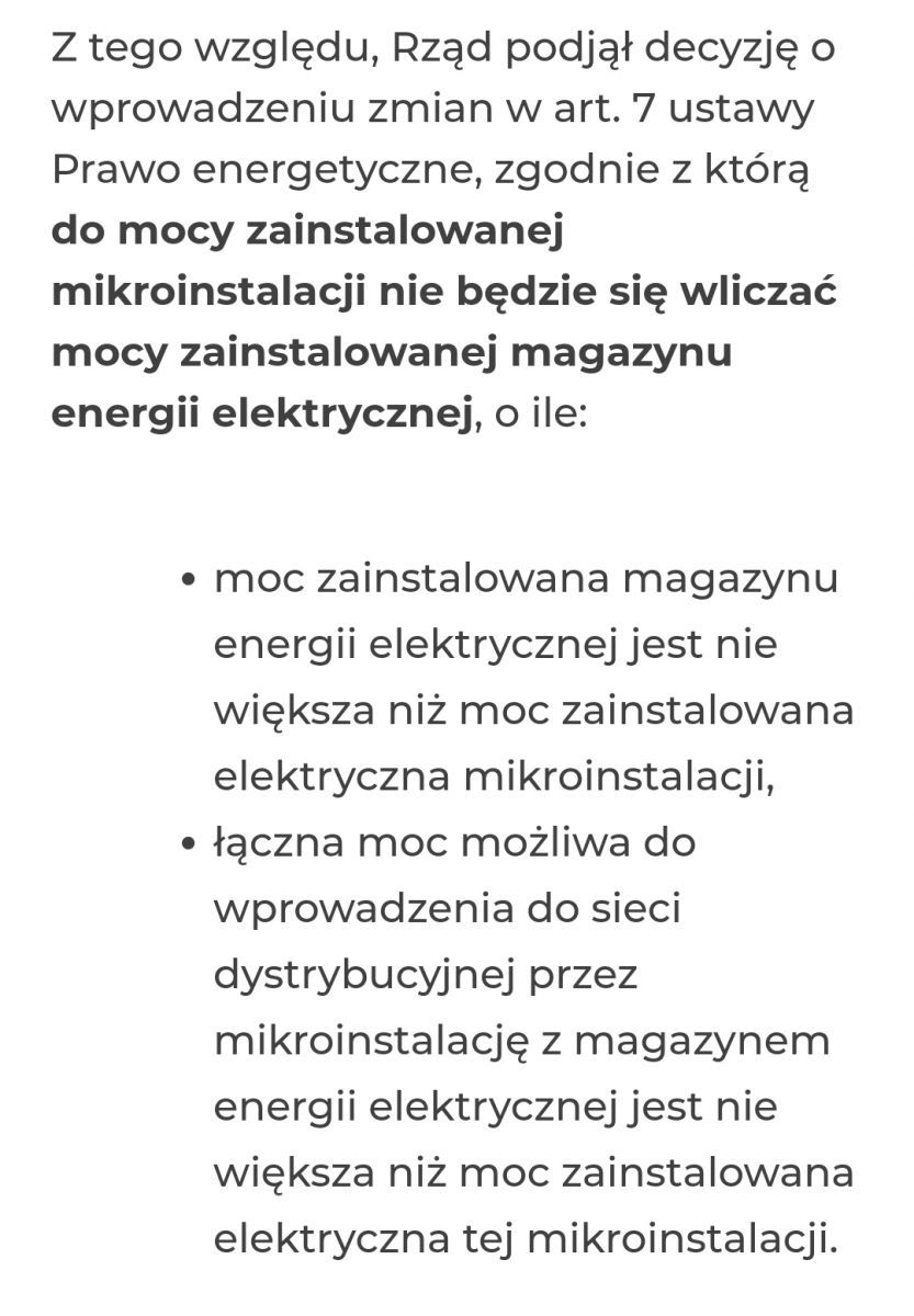

    I've been thinking about storage lately. There are magazines that work with ordinary inverters, but they have some disadvantages. And checking what it looks like, if I have reported 3.68 kW, then the storage power cannot be greater. And hard to find anything. No problem 5 kW and above. And such 3 kW would be just right. I'm checking what's up right now. Prices are starting to fall, so there's an option. Settlement only in April with PV, so then it will turn out whether it will be useful or not.
  • #1568 20639588
    Wawrzyniec
    Posts: 3987
    Help: 391
    Rate: 1068

    There is a hybrid inverter for the warehouse, but there are warehouses that can be connected to a normal inverter.
    this once.
    Two storage power, this is the power with which it can give back the stored energy. If you need 5kW or more for home appliances (induction, pump, car charging, etc.), you need more warehouse power. Power is not the same as capacity. You can have capacitance in resistance, but the power cannot exceed the power declared in the panels. Otherwise, you have summed up and cannot exceed the contracted capacity of the building.
  • #1570 20639656
    k_pec
    Posts: 1772
    Help: 271
    Rate: 560
    What's more, the power of the storage must be multiplied by at least the coefficient of the depth of discharge of the batteries, which can significantly increase the required power of the storage, because in a single cycle, depending on the type of batteries in the storage, it is possible to "draw" not 100% of its power, but only part of it - let's say typically 30...80 percent...
  • #1571 20639810
    Wawrzyniec
    Posts: 3987
    Help: 391
    Rate: 1068
    You're talking nonsense. Both. In order to speak on a topic, you need to know the topic, use the right terms and units. And that's cheating and cheating. You don't even know what you're talking about.

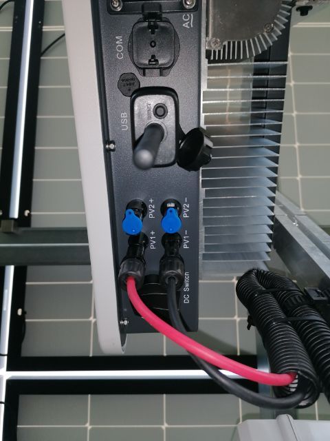

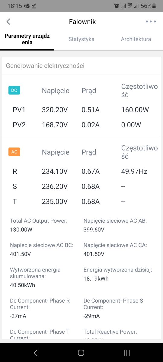

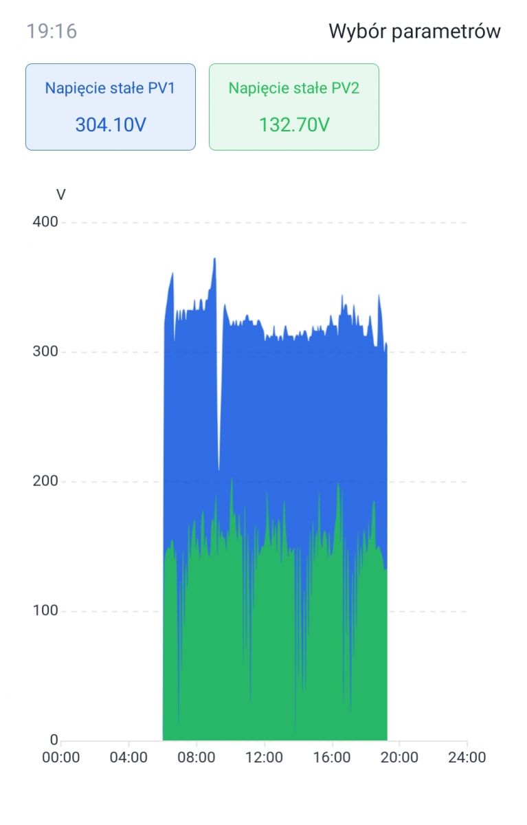

  • #1585 20727253
    lesiakjarek
    Posts: 14
    Yesterday, they installed 10 panels, each with a capacity of 450W. The model is SOFAR 4.4KTLX-G3. There is provision for oversizing, but that's the allocation I received from the municipal donation. All the panels are connected under pv1, and pv2 is free. However, the application indicates that there is voltage on pv2, as if it were connected to a circuit with 6+4 panels. The starting voltage is around 160V, and you can hear a clicking sound. Ideally, pv2 should have a voltage of 0.00VDC.
    Voltage chart of PV1 and PV2 panels in a photovoltaic installation.
    Close-up of a SOFAR inverter with cables connected to PV1 and unused PV2 ports. App screen showing inverter parameters for a photovoltaic installation..
  • #1586 20727265
    ja_pizgam
    Posts: 100
    Rate: 7
    @lesiakjarek this is a bug in their application, I have the same thing on 5.5KTL-X which was launched in 2021 and has been updated several times, only in my case it appears only about 72V, but the current is 0A. See for yourself below in the statistics this parameter then you will have a straight line throughout the entire period of operation of the inverter.

    See photos. The green color is the PV2 connector. Blue PV1. See what voltage. Usually more than 160V. But often it peaks downwards. I looked at the current statistics. Evidently, it is producing something on PV2. Low because about 0.15A, but there is something. I have PV1 and PV2 inputs set as independent. Unless it needs to be set as a bridge? I don't know, but I have a Fronius and have no such problems.
  • #1588 20727291
    ja_pizgam
    Posts: 100
    Rate: 7
    Well, if there is some current, then it is possible that it is the effect of electromagnetic induction. Both sockets from the strings are close to each other, so it is likely.
  • #1589 20727296
    prose
    Level 36  
    Posts: 3031
    Help: 172
    Rate: 846
    All is well these types have it so, do not worry.
  • #1590 20727304
    lesiakjarek
    Posts: 14
    That is, the quality goes with the price. Indeed, these currents are not large, so maybe it's induction inside the device. But this monitoring is taking it up a notch. I wrote to support officially. Although, hope for a constructive answer I do not have. The installation team (UKR) is also likely to say that "musit takoj budiet". Such are the EU tenders. Enjoy what they give for 1/4 the price.
