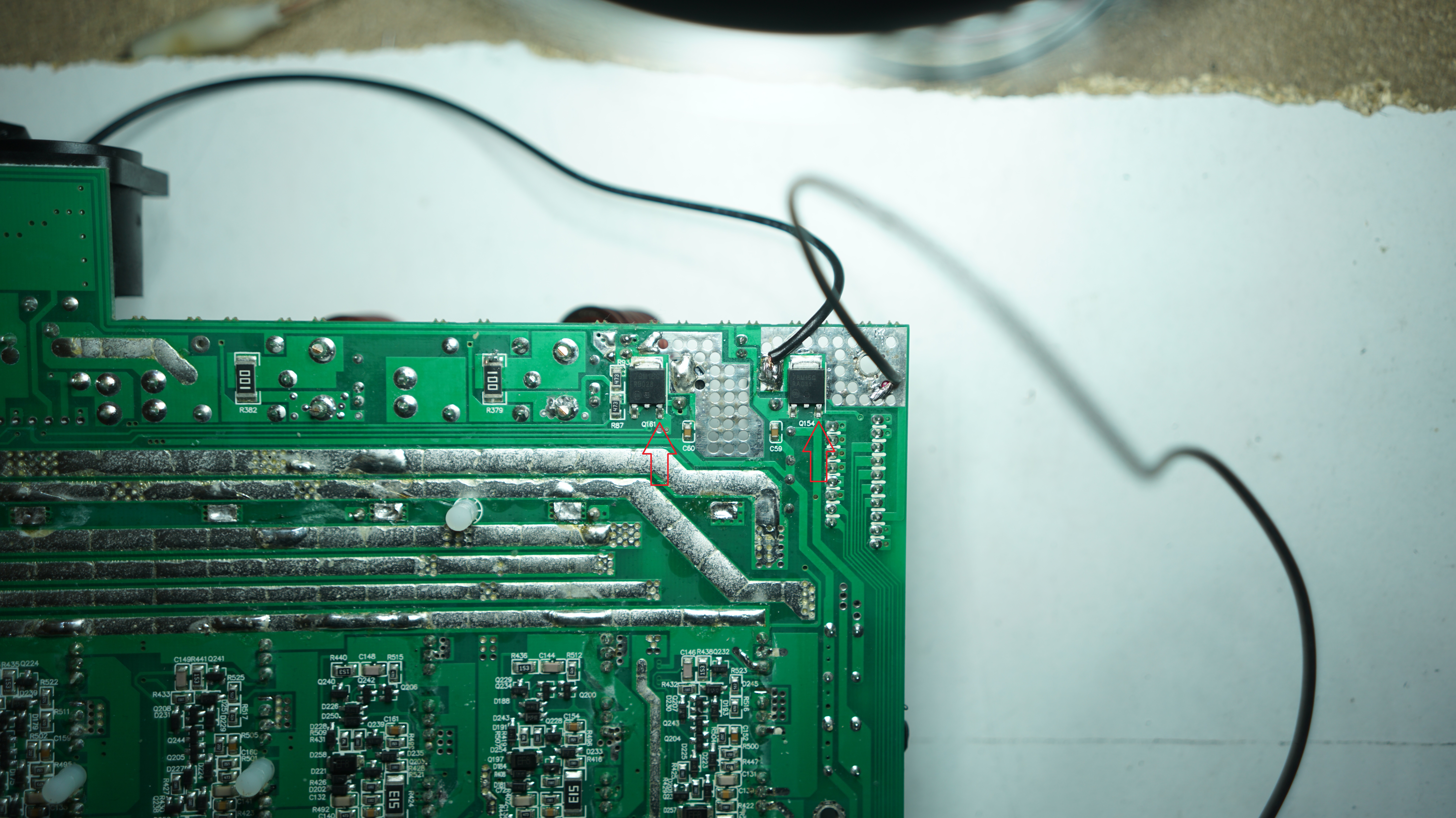

    I have a little riddle, I got the IRGP 4066D transistors as they were installed in the amplifier, they are new. After checking with a tester, it shows me as a diode and a resistor. I also have second new transistors marked GP4066D and the tester shows me as a transistor, exactly as in the catalog. Are those with the designation IRGP4066D any fake? Should the tester indicate this?
  • #93 18382650
    398216 Usunięty
    Posts: 34075
    Help: 3919
    Rate: 9228
    The tester is only a tester - and as "smart" as the one who wrote the program to run it. Many testers cannot check such transistors correctly and show various (!) Stupid things.

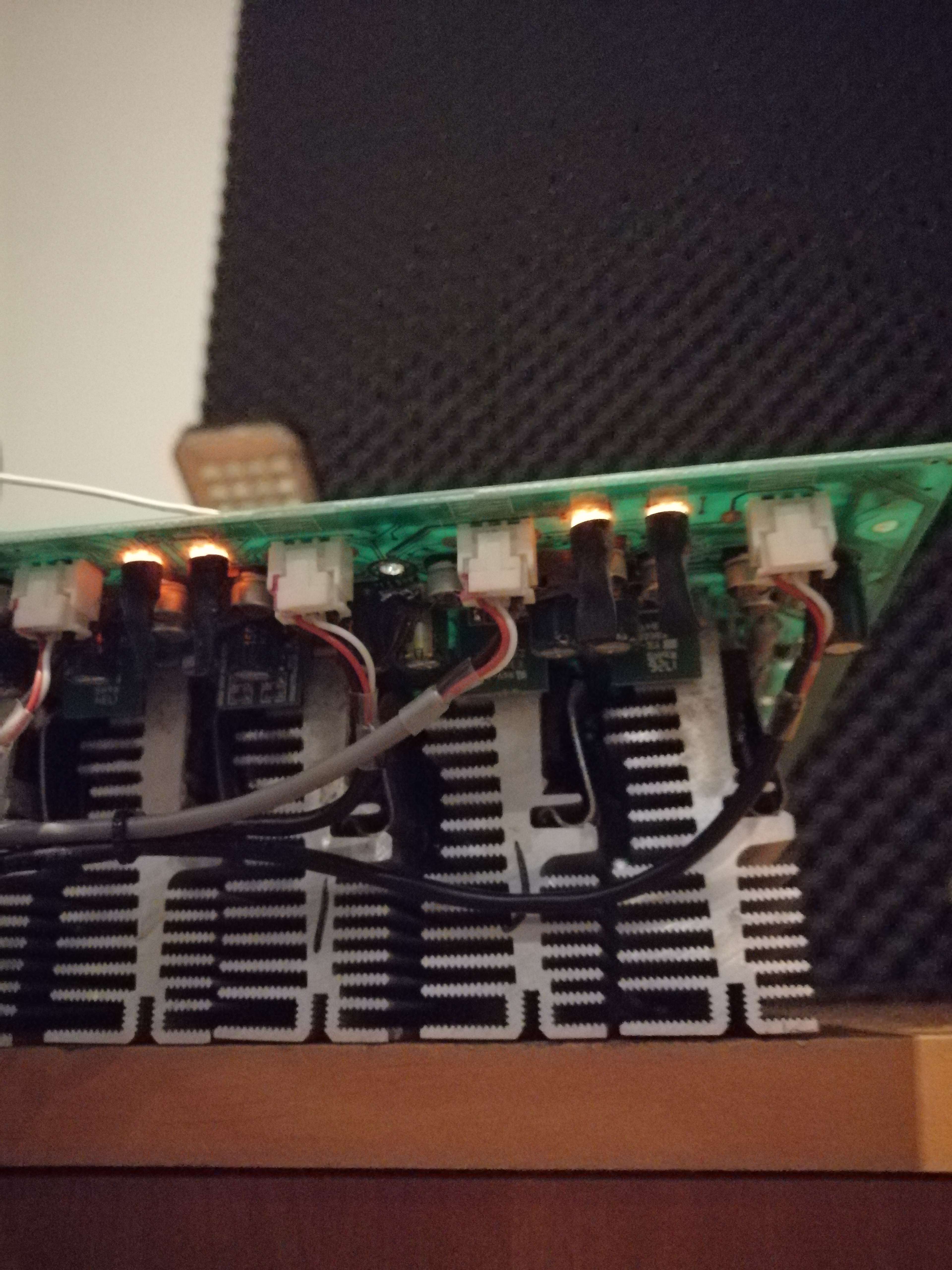

    The only problem I have is the clip on CH2 still glowing (previously I removed all the transistors from this channel because some of them were compacted and I did not need them for testing).
    I probably have something else released on this channel because I have 0.95V DC at the CH2 output, so the relays do not want to turn on and FAULT is still on. Of course, I checked the sound on an artificially shortened relay.
    I removed the preamplifier, but the DC is still there, in general all the preamps get a nice 15V symmetrical and in place of the CH2 preamp I have - 12V and + 15V, that's what I was able to dig out.

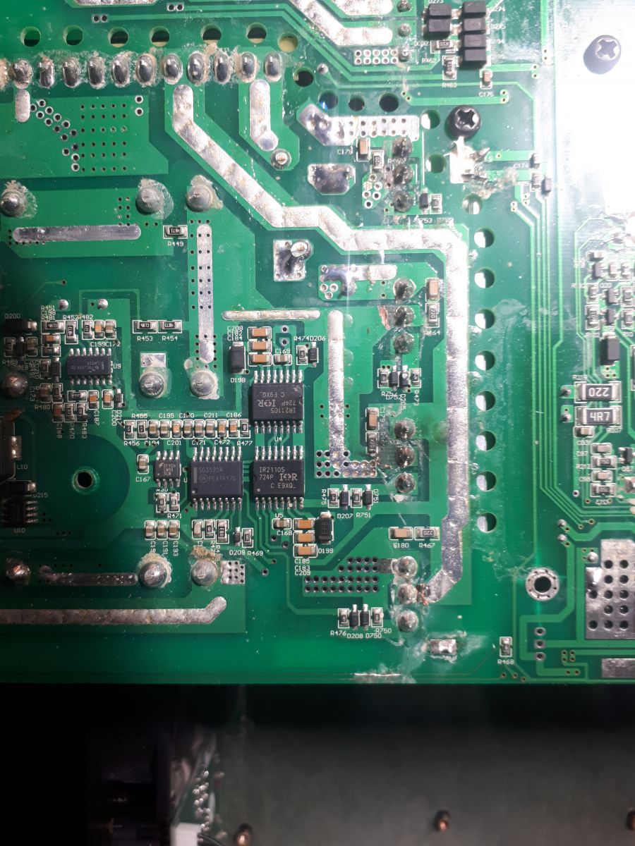

    Some time ago this power amplifier came to me.
    After removing the casing, at first glance, the following were damaged:
    - 3 transistors in the final stage of the fourth channel (Overload)
    - IGBT pair (IRGP4066D) (Overload)
    - BR3 rectifier bridge (GBU2506SF) (The short-circuit current is deposited on it with the most common failure of this terminal, which is the breakdown of the end transistors)
    - IR2110A and SG3525A
    - resistor limiting the current going to the voltage regulator (R134)
    - LEDs on the IGBT control line
    At first glance, that's it. I will continue to act when I have some time for it.

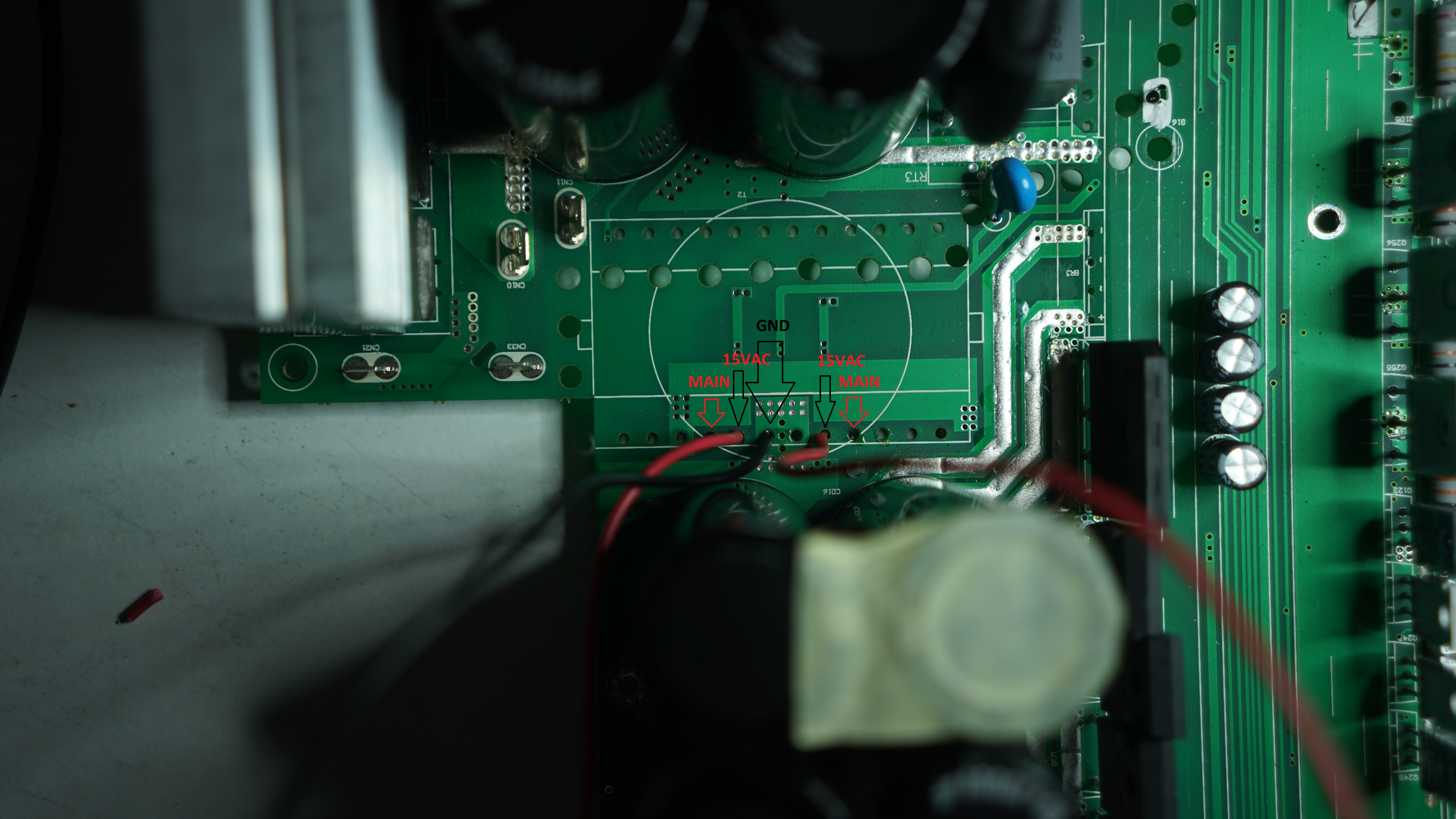

    kudlatyy1 wrote:
    Would anyone draw me up on how to connect without the original power supply? I'm not an electronics engineer, but maybe with your help I would revive him.
    To run the tip on the replacement power supply for the first time, you need to do:
    - first, choose pierced terminal transistors
    - see post # 94 on this topic
    - unsolder the impulse transformer and connect a symmetrical auxiliary power supply in its place (15VAC is enough)
    - be sure to check the BR3 bridge and the D273, D272, D274, D275, D194, D196 rectifier diodes.
    - connect "in the air" control panel
    - start the auxiliary power supply and verify the voltages on the voltage regulators.
    - When everything is ok, you connect the H-1 (main) symmetrical 15VAC or 24VAC power supply (better to start with the lower one)
    - you verify the presence of DC voltage at the output
    - if it's ok up to now, give the signal from the generator to the amplifier and see if the channel is OK. The best is an oscilloscope with an artificial load, or a loudspeaker, and you test it by hearing. This test requires a heat sink on the tested channel.
    Ideally, you should provide clear photos of the tip plate as you may have a different version and a slightly different connection layout. I would also like to have a look at the connection failure in the inverter.
    What replacement should be used for the GBU2506SF bridge? It is an ultra fast bridge, the usual ones will not work.
    Regards.

    Today I also buried a little and so:
    -IGBT fired (broken lines on laminate) but not fired
    - one pair on the first channel (the one from the converter) is out of order
    - two bridges in working order (APT60DQ60BG diodes have not been checked yet).
    I desoldered the trafo, I desoldered the entire channel out of order, I gave a symmetrical DC auxiliary voltage of about 18 V behind the bridge and smd diodes, the grounds are shorted, the orange leds are on, which are poorly visible, because there is a shirt on them, probably to make it tight not offended (see photo). After applying the AC voltage in front of the bridge, as shown by ziro_9 in the photo, the diodes do not burn anymore. I suspect the smd diodes are released. Question for ziro_9:
    - I do not know how to verify the voltages on the voltage regulators after applying auxiliary power
    -Do the auxiliary AC connect as in the picture? i.e. three gnd points? because your cables go somehow different.

    kudlatyy1 wrote:
    should auxiliary AC connect as in the picture? i.e. three gnd points? because your cables go somehow differently.
    In the photo provided, the auxiliary voltage is marked with black arrows (the description above the arrows is assigned to the arrows). In turn the red, or "main", is the basic supply voltage of the final stage. The mass is shared. Orange LEDs have two functions. They are CLIP and ERROR indicator as there is something wrong with the final grade. In your case, the LEDs were on because the final stage had no primary power.
    You measure the voltage between the marked point (one and then the other) in the photo below and ground. Indications should be max 15V and -15V. They can be unbalanced and lower due to the lack of power supply to the final stage.
    But here we will not find out too much, first you need to give the "main" power supply (symmetrical 15VAC or 24VAC) and test the end as AB class.
    After that you must:
    - check the presence of DC voltage at the terminal output (measure e.g. against the mass, and with the foot from the output coil),
    - verify voltages on regulators and MC33078 operational amplifiers,
    - if the orange LED in a given channel goes out, you can try to test it,
    - you can connect the load, give the signal and check if the given channel works
    • T.amp TSA 4-1300 Power Amplifier Issue: Not Turning On, Red Diode Flashing, No Visible Damage DSC05026.JPG (5.43 MB) You must be logged in to download this attachment.
