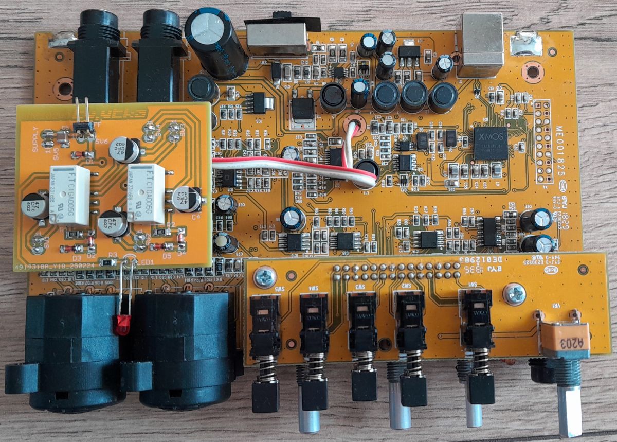

  • Modifies the Behringer UMC202HD rev.1.12 audio interface into a direct line-input version for audio measurements by bypassing its factory input amplifiers.
  • The key change feeds the inputs straight into the signal symmetrization stage on IC8 AD8694 and then the IC7 CS4272 converter, skipping the MIDAS preamps entirely.
  • The module uses two OMRON G6S-2F 5V relays, 47uF 16V capacitors, a 1206 100nF capacitor, and a 1N4148 diode.
  • The modified mode improved the test results enough to make the card suitable for audio measurements, while a switch preserves the original factory behavior.
  • It works only with unbalanced jack inputs, voids the warranty, and excessive input level in modified mode can damage IC8 AD8694.

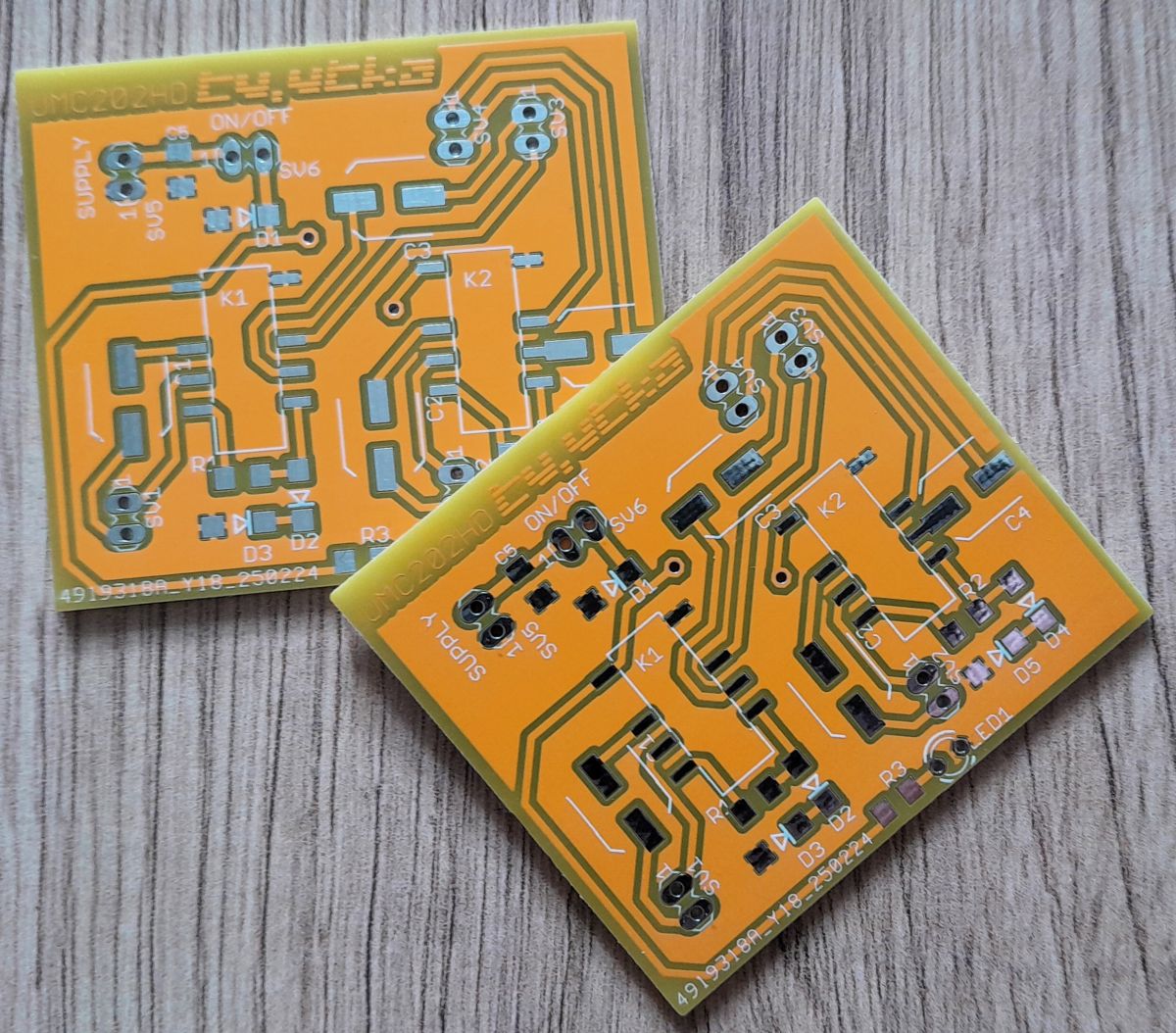

    Well, that's the way it is now.
    Circuit board with various electronic components. .
    Two yellow printed circuit boards with visible traces and markings on a wooden background.

    Well, and beautifully. Even the soldermask colour appropriately matched to the factory plate :) .

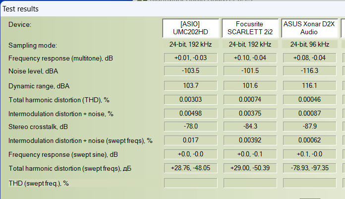

    From what can be seen in the publicly available, demonstration (abbreviated) copy of the ZE 4/25, it is not out of the question that Peter, in his deliberations, was inspired by my material posted here. He only simplified (and at the same time somewhat complicated) the shortcut of the audio track. Because instead of a complete solution as I presented here, he shortened the input path of the card by adding an additional input on the cables and an input switcher. (Hardly elegant).
    And my attempts with added (as in the article) diodes (1N4148), unfortunately resulted in increased distortion. So, in the end, I opted for a solution with Zenar diodes at 2.4V, because this, in my case, did not negatively affect the distortion level.
    Anyway, in my card, I also made a few other minor changes that I haven't mentioned here.
    Now the noise in my card comes out in measurements at -103.5 dBa, dynamic range 103.7 dBa, THD 0.003.

    If I can find my notes of these additional changes to the card, I can present them here.
    I don't really remember the details of the changes and where I put the notes. It's been a long time in which I've dealt with a lot of other things.
    However, despite the corrections, it is still the UMC202HD, not the best card I currently have.
    Screenshot of test results for various sound cards. .

    I rammed the first DAC in this card and on it the results were not particularly impressive. I bought a second DAC and tested it, it reached -104dB of noise and geez I was so pleased I rammed it too. I bought another one that barely approached -101dB and it stayed that way. This reinforced my conviction that you also have to hit a better piece then you will also gain a bit. I should add that my card has only the modification mentioned in the subject. Along the way I flew some parts, it cost some time and money, the hardest thing was to find good opamps, because on some supposedly great parameters card was humming at the output, originals were impossible to get, so I had to combine and managed to catch good operational amplifiers for the output.

    This reinforced my belief that you also have to hit better art then you will also gain a little.
    All in all, there's quite a bit right in those words.
    My Xonar, has supposedly worse WOs because from UTC, and my friend's Xonar has WOs from TI. And mine on the Taiwanese ones, performs noticeably better.
    Honestly, I was stunned by this, because some time earlier, I was struggling at work with the improvement of a certain device of ours, in which (due to the costs) it was decided to install replacements from UTC instead of the amplifier from TI. And with these replacements, after some time of operation, problems started to occur, the amplifiers started to excite. So previous experience indicated that the Taiwanese chips were weak. And here suddenly such a surprise.
    Going back to the UMC202HD, it once occurred to me to throw everything but the Xmos out of it and build it anew with a different ADC and DAC. But after thinking it over, I let the subject go, as it would have been unprofitable overall. Especially since I was already putting together a small measurement computer with Xonar at the time.

    If anyone would still be interested in a board for such a conversion, please contact me.
