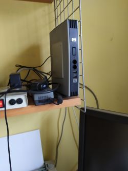

    And I took a different route - I tried earlier, I made a small 1-disk nasa from an HP terminal with a 2.5 "SATA disk inserted.
    It has proven itself over several years of work.

    Later I got my hands on the disposal Netgear ReadyNAS NVX - a 4-disk solid mechanical construction. The investigation showed that the power supply is faulty.
    The original Netgear power supply available on Amazon costs half a fortune, and I wasn't sure if only this was damaged.
    After a short search, it turned out to be an ordinary PC power supply with the usual 20-pin motherboard connector, but the witty designers swapped
    a few pins in places. So I put a 24pin to 20pin power adapter into the housing with appropriately crossed cables:
    We are building our own NAS server
    The whole thing is not impressive, but it works and allows you to use a regular PC power supply:
    I didn't like the original Netgear soft very much, so I built my own.
    I don't need the GUI and the gimmicks, I hate it when the device does something out of control and I don't know what's going on underneath, I prefer to have full control.
    The main task is backup, the rest are add-ons.
    My soft is not very friendly - the whole configuration has to be done from the console manually (vi or nano :-) ), but I know what's squeaking in the grass.
    I lost XRaid (Netgear's own idea) but replaced it with unionfs, which has pretty much the same effect - except manual configuration.
    Services available:
    ssh
    ftp / sftp
    www with CGI
    appletalk
    samba
    And of course, access via serial console ;-)
    Nothing prevents you from adding whatever your heart desires.
    The whole system boots to RAM, no element of it is placed on the matrix disks (unless expressly requested).
    To synchronize files with the computer I used the open source SyncThing program - amazing, it allows local and WAN synchronization, everything happens in the background.
    System boot screenshot below:

    As you can see, the system is 135MB with 2GB in RAM.
    At the moment www, ftp and netatalk services are disabled in the configuration, but enabling them does not change the memory usage.
    The whole thing has been running for several months, but it is still "Work In Progress" -
    recently I added a menu that allows you to view important system status items on the LCD display - disk status and occupancy, RAID status, etc.
    I offer all kinds of assistance to those who are interested ;-)
