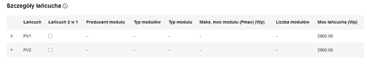

    Hi,
    I have a question about the string power settings in the inverter.
    Originally I had 8 panels (370Wp) per string, so in the settings I have 2.96kWp per string.
    A year ago I added 3 panels (1 to the first string, 2 to the second). The installation team did not change the settings in the inverter. I wonder if it makes any difference and should I change it now?
    Regards

    This is just informational data, does not affect the production of the inverter. I also added it there once, but since I don't have installer permissions, it contains old data.
    What is not entered has no effect. However, it is very important that you added the panels to the string. Is it the same model? Or only a panel with similar parameters?
    Sometimes, when adding 1 panel to a string that had 4-5 panels, we get a decrease instead of an improvement :]

    Exactly the same panels were added :)
