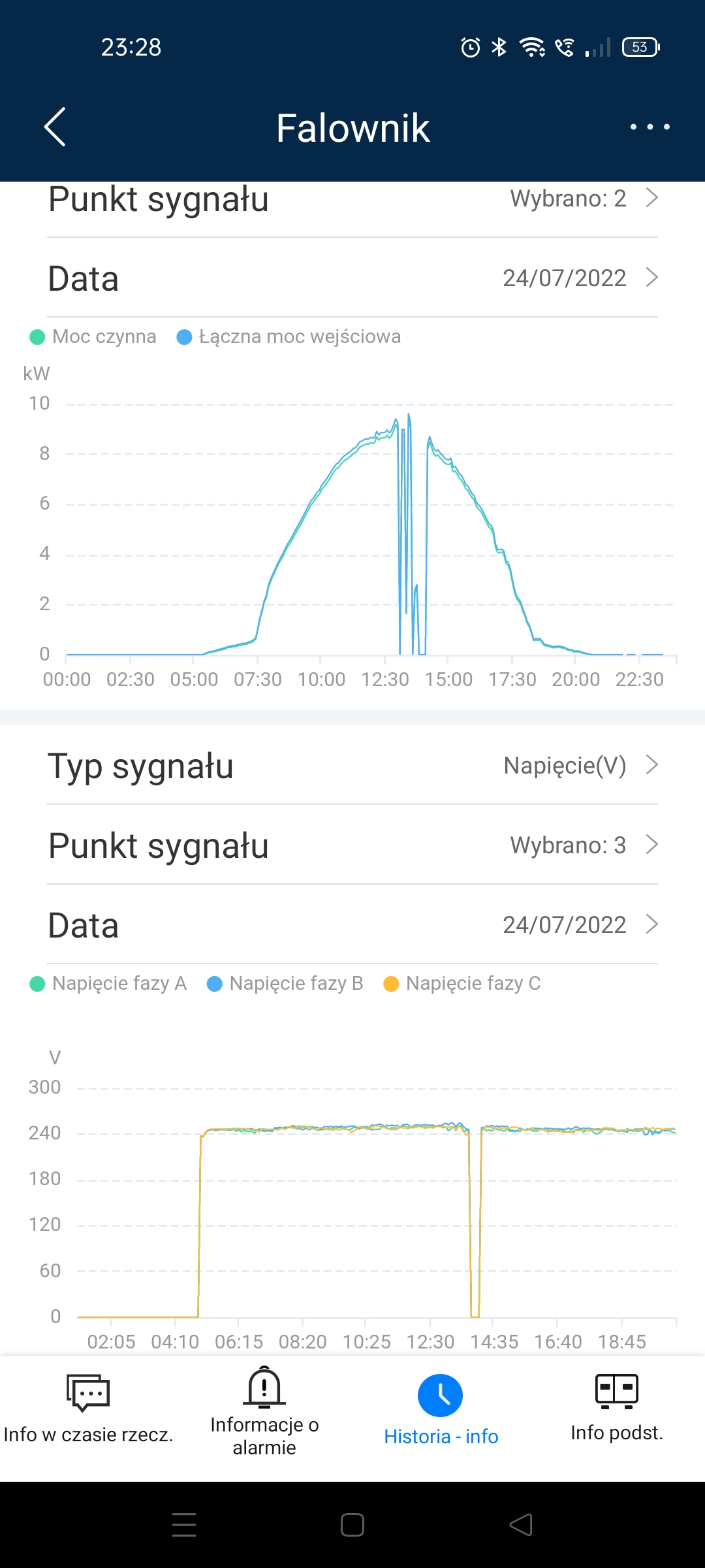

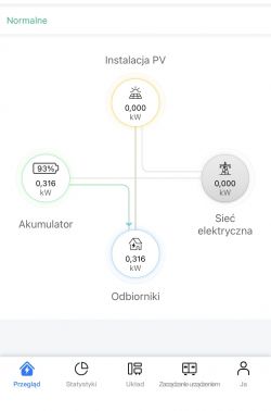

    I have just such an arrangement recently
    Can you have a fusion solar screenshot on a clear day? I would like to see what it looks like on the chart.
    No problem, I will test in a few days, but what graph are you asking specifically? Because the picture on the app looks like this: Huawei SUN2000 Inverter: WIFI Dongle Connection, Firmware Update & FusionSolar Huawei SUN2000 Inverter: WIFI Dongle Connection, Firmware Update & FusionSolar

    JMZZ wrote:
    It's about the statistics tab

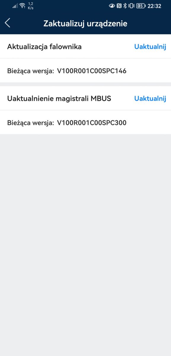

    tomaszbiel81
    SPC145 update
    • SUN2000MAV100R001C00SPC145_package.zip (3.32 MB) You must be logged in to download this attachment.
  • Remote power correction possible on older Growatt TL3-S

    tomaszbiel81 wrote:
    SPC145 update
    And maybe you can throw in a description of changes in this version?

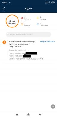

    01rafalm
    Good morning,
    He has been using PV installations with the SUN2000-5KTL-M1 inverter for over a month. I am connected to the PGE network and I have problems with feeding power to the grid (AC> 253V) described on this forum (sometimes power reduction and sometimes inverter shutdown). I am connected to the inverter with Modbus TCP IP and I can read the error codes.
    I noticed that sometimes the generated DC voltage exceeds 600V (this is just temporary only) and then the inverter shuts down and generates Fault code 3401. Has anyone encountered this problem? I wonder why the inverter turns off above 600V DC, when it should withstand even DC 1000V?

    Posts: 197
    Help: 12
    Rate: 30
    01rafalm wrote:
    Good morning,
    He has been using PV installations with the SUN2000-5KTL-M1 inverter for over a month. I am connected to the PGE grid and I have problems with feeding the power to the grid (AC> 253V) described on this forum (sometimes power reduction and sometimes turning off the inverter). I am connected to the inverter with modbus TCP IP and I can read the error codes.
    I noticed that sometimes the generated DC voltage exceeds 600V (this is just temporary only) and then the inverter shuts down and generates Fault code 3401. Has anyone encountered this problem? I wonder why above 600V DC the inverter turns off when it should withstand even DC 1000V?
    It is not the DC voltage above 600V that disables the inverter, but the mains voltage above 253V. Take a look at the DC voltage charts for each day. The inverter boosts the DC voltage during startup and shutdown

    Helpful for users
    Posts: 12035
    Help: 1233
    Rate: 2423
    Strange error code. Errors in 3-10KTL models start from 2 of what I can see. The AC voltage overrun is error 2072

    tomaszbiel81 wrote:
    SPC145 update
    I would like to update the SPC146

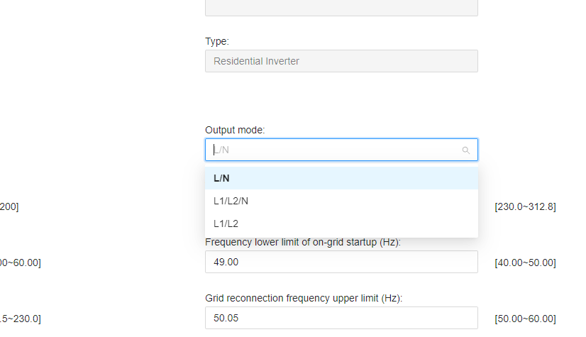

    sz.lukas
    Posts: 10
    Good morning,
    I have a SUN2000-3KTL-L1 inverter, which is single phase. The installation is three-phase. The inverter is connected to L2. Everything has been working as it should for a year.
    Recently, however, I came across settings where as output it is possible to set L / N (and so I have) L1 / L2 / N and L1 / L2.
    Does this mean that this inverter can also work, for example, on 2 phases?
    Hooking up in this way could increase self-consumption.
    Please explain.

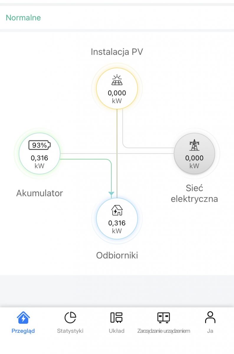

    gmacko
    Posts: 175
    Help: 5
    Rate: 42
    JMZZ wrote:
    unfortunately only with one phase. However, it has many disadvantages, most of all it turns off with a load of 2-3 kW (and it should withstand 5, because I have 2 batteries). And a terribly intricate change to default settings. Huawei should try better for this money.
    It's good that you wrote, because I was somehow focused on this LUNE in the 10kWh configuration, but if it does not give these 5kW for any phase at home, then I need something like that.
    Induction is in a phase different from that of the refrigerator and electronics. 2/3 of the hardware will not work without the 2 remaining phases.
    So I understand that when the sun goes down and your battery is loaded, you power Phase 1 from the battery, and the other 2 phases are taken from the network?
    I am not afraid to power 3 phases only from a battery within these 2-3kW (supposedly 5kW)?
    As for me, it is a strong failure of the manufacturer to disseminate the documentation for this equipment.

    #864 20136611
    kotbury
    Gantry automation specialist
    Posts: 9584
    Help: 2098
    Rate: 3625
    It's not like that.
    If there is current in the grid and the inverter is synchronized with it, without the sun, Luna gives power to all phases within the capacity of the battery and inverter, i.e. slightly over 3 kW per phase. The demand for energy exceeding its capacity is selected by the inverter from the grid separately for each phase.
    The colleague's entry above is for Off-Grid work. When there is no power in the network, the inverter uses the Backup-Box to switch the L1 phase from the normal installation to a separate backup output - and then only one L1 phase works from the battery (or more precisely, its clone in the form of a separate backup circuit, which, however, in the presence of the network works as a normal phase L1, so in the case of "W" you do not need to run and plug the equipment to the second sockets) within the limits of its efficiency from the inverter, i.e. about 3 kW.
    But it's an emergency.
    The full power on the Off-Grid backup is given by the single-phase version of SUN - i.e. 3 or 5 kW depending on the version of the inverter.

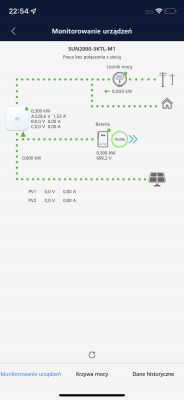

    kotbury
    Posts: 9584
    Help: 2098
    Rate: 3625
    Not my equipment - Sun 2000 3-phase 10 kW inverter (I did for installers who "had no training" yet) and I did the hardware and initial configuration and the owner himself took care of more precise settings, but it reminds me that the adjustment of the power output with one Luna in total for 3 phases, it ended at 3 kW (it is set, in addition, you can set the minimum charge from which the battery no longer outputs electricity and limit the maximum charge level in advance - to increase the battery life). Tomorrow I will ask about it and about the maximum charging power (the maximum efficiency of the inverter is easily achieved because the guest has 12 kW on the roof). I know that if the generating power exceeds the charging power of the battery - the surplus is first used "on the spot" and the rest goes to the network for the prosumer (but these priorities can also be set - e.g. the first prosumer, then charging with battery leftovers - everything is in a rather complicated manual inverter and battery)
    PS. For precise settings and power readings, we use the SUN 2000 program working under the local WiFi network of the inverter. Fusion Solar with the Internet is only useful for remote quick reading of the inverter status via the net and there are as many settings there as nothing.
    Posts: 9584
    Help: 2098
    Rate: 3625
    The buddy replied. With one Luna battery, the maximum charge / discharge power is 3 kW. With two batteries and one power supply - 5 kW (both powers for all phases in total).
    He learned that if you add a second battery tower (2 or 3 xLuna) with a second power supply, the download / charging power will increase to the maximum capacity of the inverter, i.e. 10 kW. You can use up to 2 towers of 3 Luna each, i.e. 18 kWh capacity. For 100,000 .... ?.
    As for the apps - after the latest updates, the Sun 2000 app and the local network of the inverter no longer clutter. Fusion Solar has taken over all the functions of this app and it goes on the net. From a cursory glance it appears that it has all the functions of both the previous ones aggregated into one.

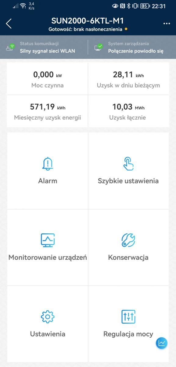

    gmacko
    Posts: 175
    Help: 5
    Rate: 42
    kotbury wrote:
    after the latest updates, the Sun 2000 app and the inverter's local network no longer clutter. Fusion Solar has taken over all the functions of this app and it goes on the net.
    I do not know what kind of inverters that are not bangla. My 6ktl bangla with the sun2000 app on the latest spc146 software and normally broadcasts its local area network.

Firmware: what’s new in SPC136 and how do I install it?
SPC136 adds battery-version alarm, M1–M3 parallel support and faster offline self-check [Huawei ReleaseNotes 2021]. Download via SUN2000 or FusionSolar app (Me > Device Commissioning > Update). Stay within inverter Wi-Fi, tap Update, wait ~20 min; the inverter reboots once at ~80 % [Elektroda, MisiekDPx, post #19639882]
How do I update the SDongleA-05 Wi-Fi dongle?
Unplug the dongle, re-insert: it broadcasts “Dongle–AP”. Connect with SUN2000 app, default pwd 00000a, go to Maintenance > Update Device, choose SPC118 file and start. LED blinks fast green during upgrade, steady green when done (≈10 min) [Elektroda, lizak1983, post #19640000]
