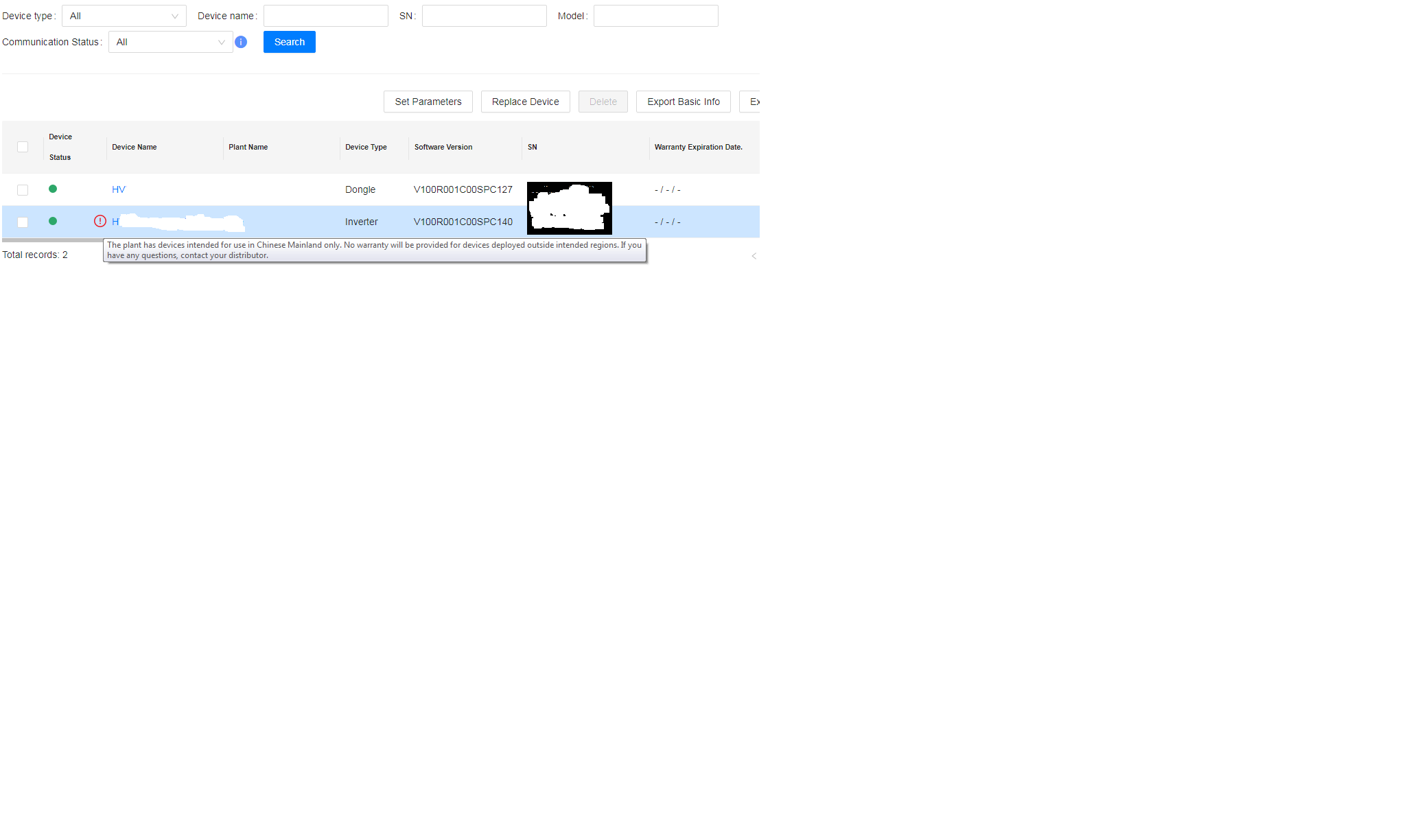

    luozewen1111 wrote:
    Just because the Chinese version of Huawei's inverter requires more settings doesn't mean it can't be used. The only problem is the warranty. Tech veterans can know more.
    For some time now, an inverter from the Chinese market cannot be joined to the Polish fusion solar account - it probably is the case all over Europe, the owners of such an inverter are left with either an application in Chinese after logging in to the inverter's wifi locally (not via a dongle) as an app installer or communication after modbus and 3party software.

    strucel wrote:
    For some time now, an inverter from the Chinese market cannot be joined to the Polish fusion solar account - it probably is the case all over Europe, the owners of such an inverter are left with either an application in Chinese after logging in to the inverter's wifi locally (not via a dongle) as an app installer or communication after modbus and 3rd party software.
    And you know from when? It so happens that I have a "Chinese" and a problem with logging in.

    Unfortunately, I do not know, two years ago it was possible without any problems because I assumed it myself and last year it was impossible to do it last year.
    Fortunately, the old accounts are working and the only sign that something is wrong is such an annotation in fusion solar
    Huawei SUN2000 Inverter: WIFI Dongle Connection, Firmware Update & FusionSolar
    2 years ago, the purchase of this inverter from the Chinese was a good deal for the economical - there was no guarantee (well, some virtual seller), but it cost half the price of the Polish distribution, which at the rate of faults that huawei boasted around 1%, as far as I remember, minimized the risk of a meltdown Of course, the VAT invoice was "my current" fit.
    Going back to the merits, we tried a false geolocation and none of this - it turned out that the Chinese have their version of fusion solar, completely independent from the rest of the world and to set up an account there you need to have an active Chinese phone number, just like in the case of baidu. You need someone in China to do us a favor and it probably would have to be a permanent one, not a one-off, and the application would probably be in Chinese anyway.

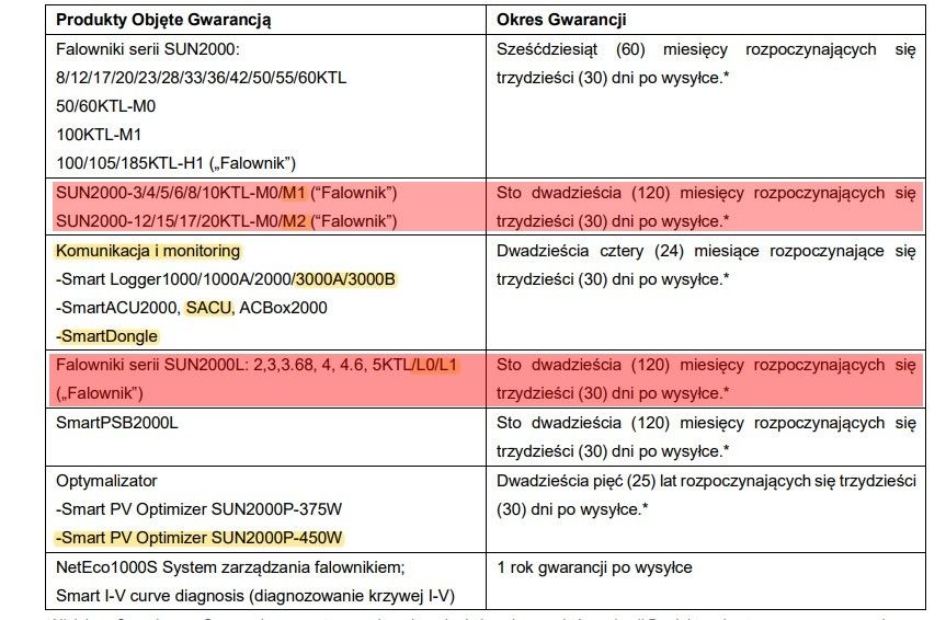

    One "but": inverters have a 10-year (not 5) warranty with us.

    strucel wrote:
    Two years ago, the m0 series (because another one was not on sale) was 5 years old in Poland with the possibility of a paid extension.
    You are wrong, I have had the M0 series for over two years and the warranty from the start is 10 years without any paid extensions.

    Well, different guarantees for different inverters.

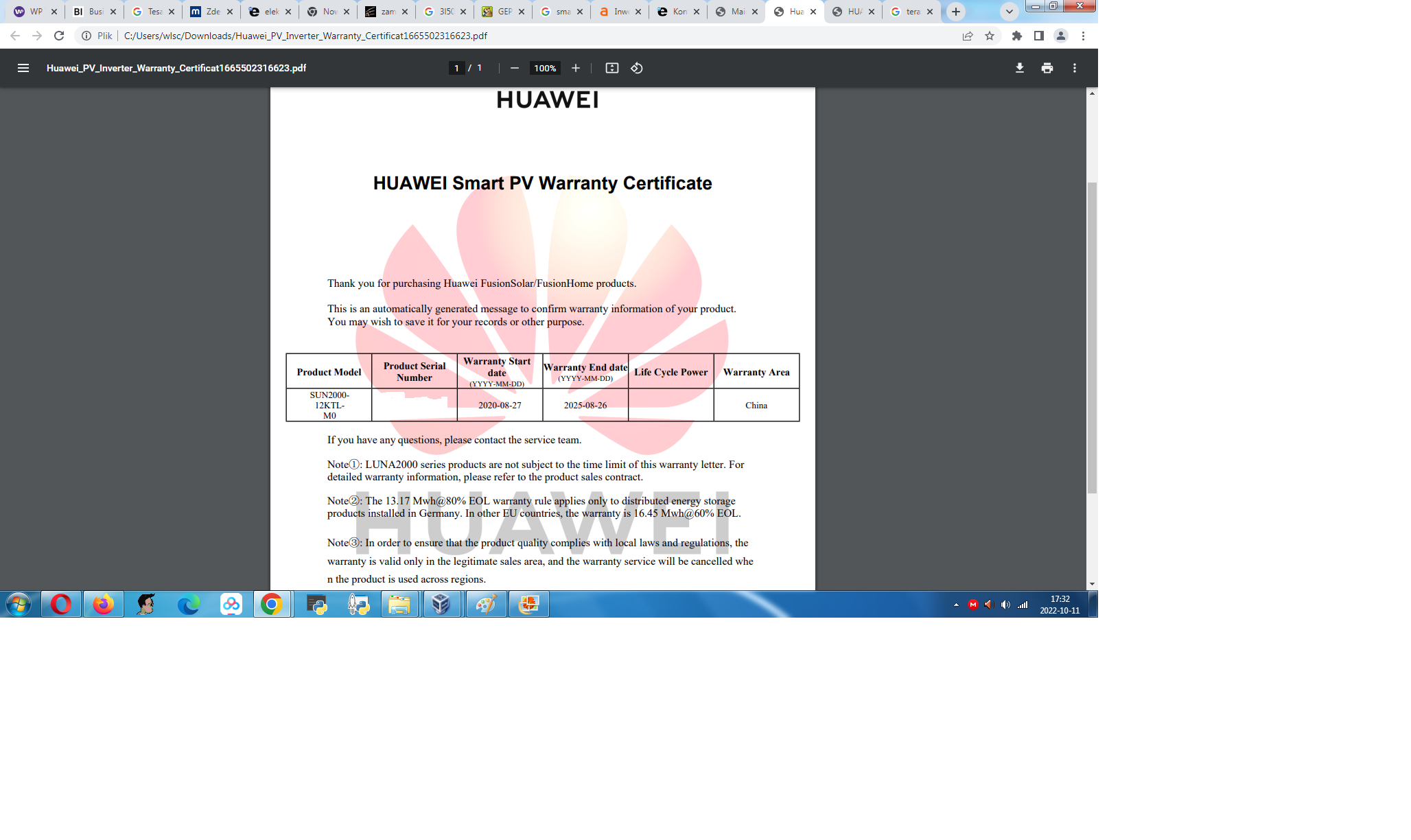

    No copy / paste, only the situation from 2 years ago with the hook, as it is now, it has little to do with what it was then, so you can brag about who has a longer one, but it has little to do with the merits. You have a 10-year warranty which you probably will not use because there will be no need and I was only two years old during which I had no breakdowns and for the money I saved I bought over 3kWp more in panels.
    And I'm not sorry, I have guarantees until 2025 implemented in China as if. Huawei SUN2000 Inverter: WIFI Dongle Connection, Firmware Update & FusionSolar
    I told you - no matter some copy / paste made of paper. It is important what the system will say about the hardware.
    Another thing is that you are unlikely to do it with us.

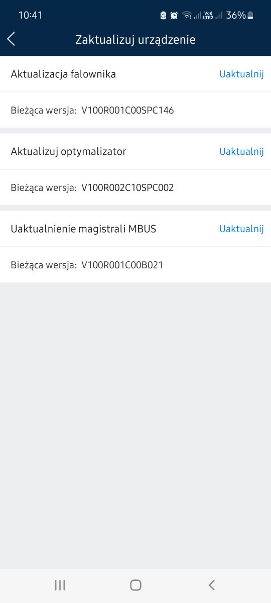

  • #921 20268911
    Robyn212
    Posts: 197
    Help: 12
    Rate: 30
    I have a question for people who have optimizers. Do you also have the option to update optics in the application in the maintenance and device update tab?

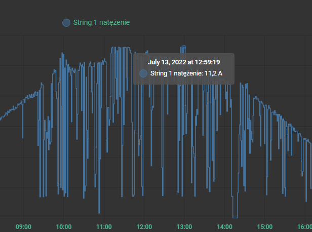

    Does anyone have an inverter in the HC version supporting the current up to 13.5A? I wonder how much more I would take, because by accident I noticed that in the high season the amperage cuts me to 11.2A with 450W panels.

    I have it for a month and it does not cut to 11.2A as the previous one. In the chain with the 450W-P optimizers the most was 12.78A.

    @ robyn212
    Firmware 147 and information about this update
    SUN2000MA ...uments.zip (3.96 MB)You must be logged in to download this attachment.
    SUN2000MAV...ackage.zip (3.4 MB)You must be logged in to download this attachment.

    There is a new version of the FusionSolar and SUN2000 applications. The inverter temperature and insulation resistance were reported. The layout of the optimizers of blue saturation levels shows the production volume of the panel. But there is also one error, if we have a horizontal panel drawn in the physical system, bushes appear and the production volume is not visible.

    Posts: 6
    Colleagues, maybe someone can find new soft for SDongla V100R001C00SPC133 and could provide a link?
    In the requirements for the new V100R001C00SPC147 inverter software, the above soft SDongla is compatible, so it's probably better to update SDongla first (I currently have V100R001C00SPC127) and then update the soft on the inverter.
  • #928 20276779
