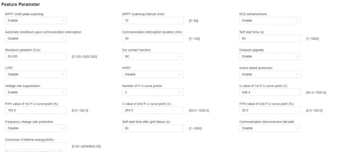

    My question is about full access to the inverter, the installer refused it.
    I have a problem with too high a voltage above 253V.
    Maybe someone will share their knowledge.
  • #889 20191741
    domelek
    Posts: 275
    Help: 10
    Rate: 44
    I will probably give you when you waive the warranty. Who will answer when you rearrange something ...?
  • #890 20192019
    hewen
    Posts: 212
    Help: 5
    Rate: 23
    Ok, only the installer who can do something gave up in advance.
    I am looking for a person who (may be payable) will help with the topic.
  • #891 20192743
    domelek
    Posts: 275
    Help: 10
    Rate: 44
    You can play with the P / U curve, Q / U gives almost nothing, or add a 3-phase heater with control.

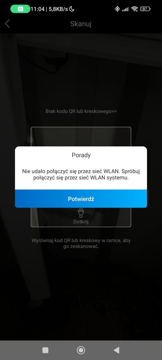

    kravat3
    Posts: 10
    I do not have a dongle and I am logging in via the inverter network, i.e. I logged in because something broke and I cannot connect to the inverter. Does anyone also have this problem? There have been no updates for a year, just checking the monthly yields :-) Huawei SUN2000 Inverter: WIFI Dongle Connection, Firmware Update & FusionSolar
  • #893 20217305
    LordZiemniak
    Posts: 158
    Help: 8
    Rate: 51
    what is this app? use fusion solar latest version
  • #894 20217631
    kravat3
    Posts: 10
    The app is Sun2000, it is also impossible to use fusion solar. In the phone's wifi settings, I chose the inverter network, the app connected to the inverter and there was an option in the "login" app. Now, when I switch the wifi network to the inverter, the phone immediately wants the password to the inverter network, and unfortunately the password does not work. Some time ago I had phone updates for a new android, maybe that's because of it?
    Last login to the inverter is September 4.
  • #895 20218129
    szczukot
    Posts: 820
    Help: 6
    Rate: 82
    Switch off mobile data on your phone just to be sure when you are connected to the inverter via sun2000
    Second topic: there you probably choose whether the user or the installer - maybe not this account is logged in and therefore the wrong password
  • #896 20219812
    kravat3
    Posts: 10
    I also turned off the data for the trial, previously it did not matter and I could log in. I have an installer account in fusion because I did the installation myself. Has anyone tried to connect via the USB port? Because apparently such an option is also possible. I don't want to spoil anything else ...
  • #897 20219900
    LordZiemniak
    Posts: 158
    Help: 8
    Rate: 51
    there is no option that fusion solar does not work, you turn on wifi on your phone (but you do not connect to any network) you run fusion solar in the upper left corner you have a configuration wizard, click there and such a contraption appears to scan, you scan the qr code on the side the inverter info pops up to connect to its wifi network, give you connect then log in as an installer and the pyk works, you do not need a wifi password for the inverter.
    If you have forgotten the installer password, you can reset it

    kravat3
    Posts: 10
    I have the password saved in the switchboard, so I have not forgotten it. The phone tries to connect to the inverter 3 times and sneezes.
    You mean this reset where the AC and then DC power is turned off? If so, the inverter must be reconfigured, or will only the password be changed to 00000a immediately?
