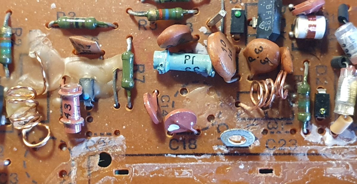

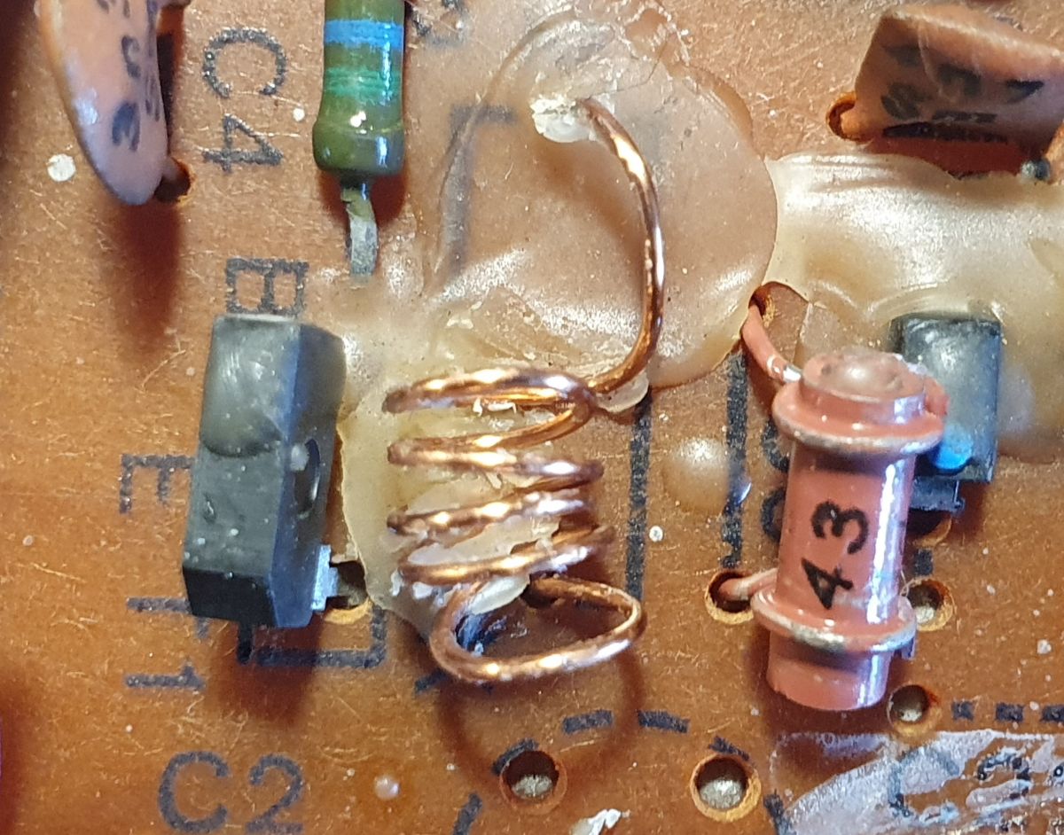

    #72 19621064
    glass2
    Posts: 101
    Rate: 32
    pawelr98 wrote:
    3.5 turns are evident from the documentation of the "Jubilat" radio, which has an identical head (by the way, you can see the cost-cutting such as the absence of a diode at the coil in the heterodyne, although the space is there).
    At 2.5 turns for the CCIR band, the oscillations of the heterodyne at the bottom of the band disappeared.
    After making a new coil, the radio holds the entire CCIR band normally, and the tuning was done without any major problems. However, a capacitor had to be soldered in series with the heterodyne unit (the effect of higher inductance) in order to extend the bandwidth all the way down.

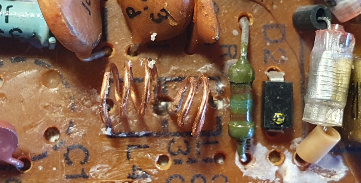

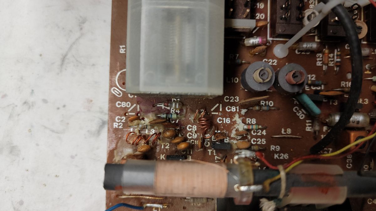

    Hello. I'm joining the discussion because I've just struggled with a Snowball R-207 not so long ago.It's been "buried" so this makes the task more difficult. Currently it is behaving strangely because when I change the frequency of the heterodyne with the rotary capacitor (normal tuning), the frequency from 118.7 MHz goes down nicely, you can hear a lot of stations and then at 102 MHz the heterodyne chokes, stops working and by turning the knob further after about 2cm on the scale it starts working again up to 96 MHz. This is not a rotary capacitor problem because I can move this fade on the scale. I would very much appreciate suggestions as to what could be the reason for this, and I would also appreciate information on how to make coils L2, L3 and L4. They have been rummaged around. I currently have L2 6 coils fi 0.2 by fi 6mm, and L3 and L4 are 2.5/3.5 coils fi 0.4 by fi 5mm. I would be very grateful for any help.
  • #73 19622166
    pawelr98
    Posts: 6464
    Help: 413
    Rate: 1155
    L4 is supposed to be 3.5 turns and half tapped at 1.75 turns, if a colleague looks at what the soldering points are, it will be immediately apparent how to wind.
  • L2 and L4 coil counts identified from photos
    #74 19622421
    glass2
    Posts: 101
    Rate: 32
    pawelr98 wrote:
    L4 is supposed to be 3.5 coils and half tapped for 1.75 coils, if a colleague looks at what the solder points are, it will be immediately apparent how to wind.
    Thank you for your reply. Coil L3 and L4 are like one with a tapping, or two connected together. On the PCB and on the schematic, L3 and L4 are present. My understanding is that: L3+L4 = 3.5 coils with a half-tap. I don't have the original coil but from the photo I looked at it is not a symmetrical winding. L4 has 1 more winding.
    I have just now found the answers to my questions. :D .
    I have documented in the attached photos:
    Interior of an old Polish radio receiver UNITRA Sniezka R-207
    L2 = 5 coils
    L4 = 3 coils + L3 = 2 coils.
    Interior of an old Polish radio receiver UNITRA Sniezka R-207 .
    PCB photos of a head similar to the Snowball (I have no idea from what, as there are no captions)
    I think this thread can be closed.
  • Broken black wire from volume potentiometer splice

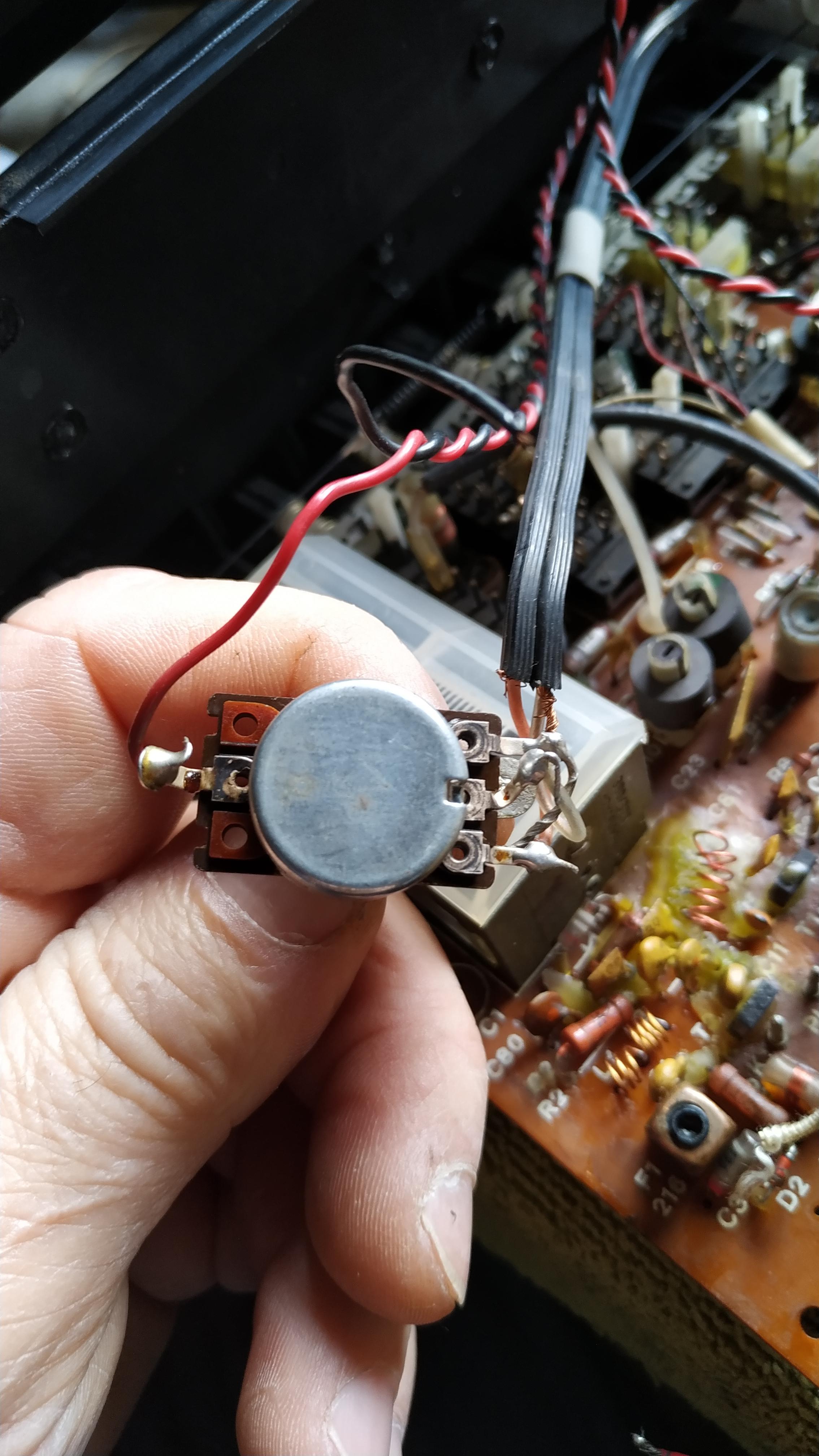

    #75 19660912
  • #76 19661050
    Janusz_kk
    Posts: 5867
    Help: 228
    Rate: 1478

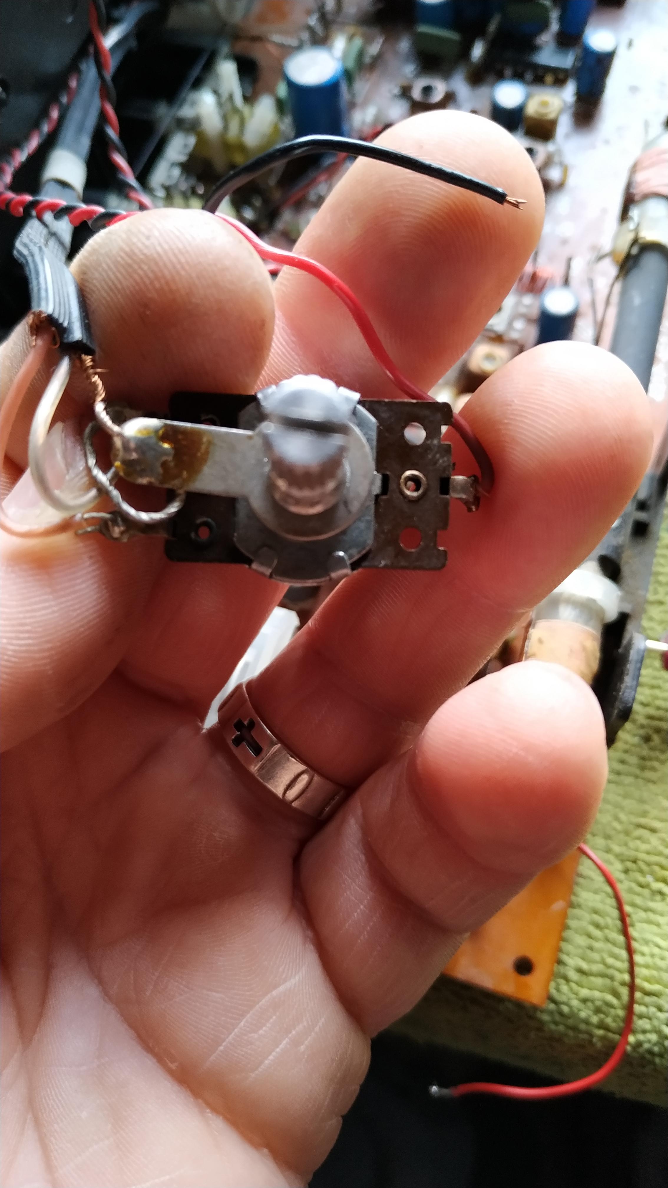

    It looks like ground, so solder it to the third pin of the potentiometer, in the first photo that top pin, where those wires from the cable are not in the screen.
  • #77 19661151
  • Black wire is a shield, soldered only at K23
    #78 19661155
    Tytus Kosiarski
    Posts: 293
    Help: 10
    Rate: 535

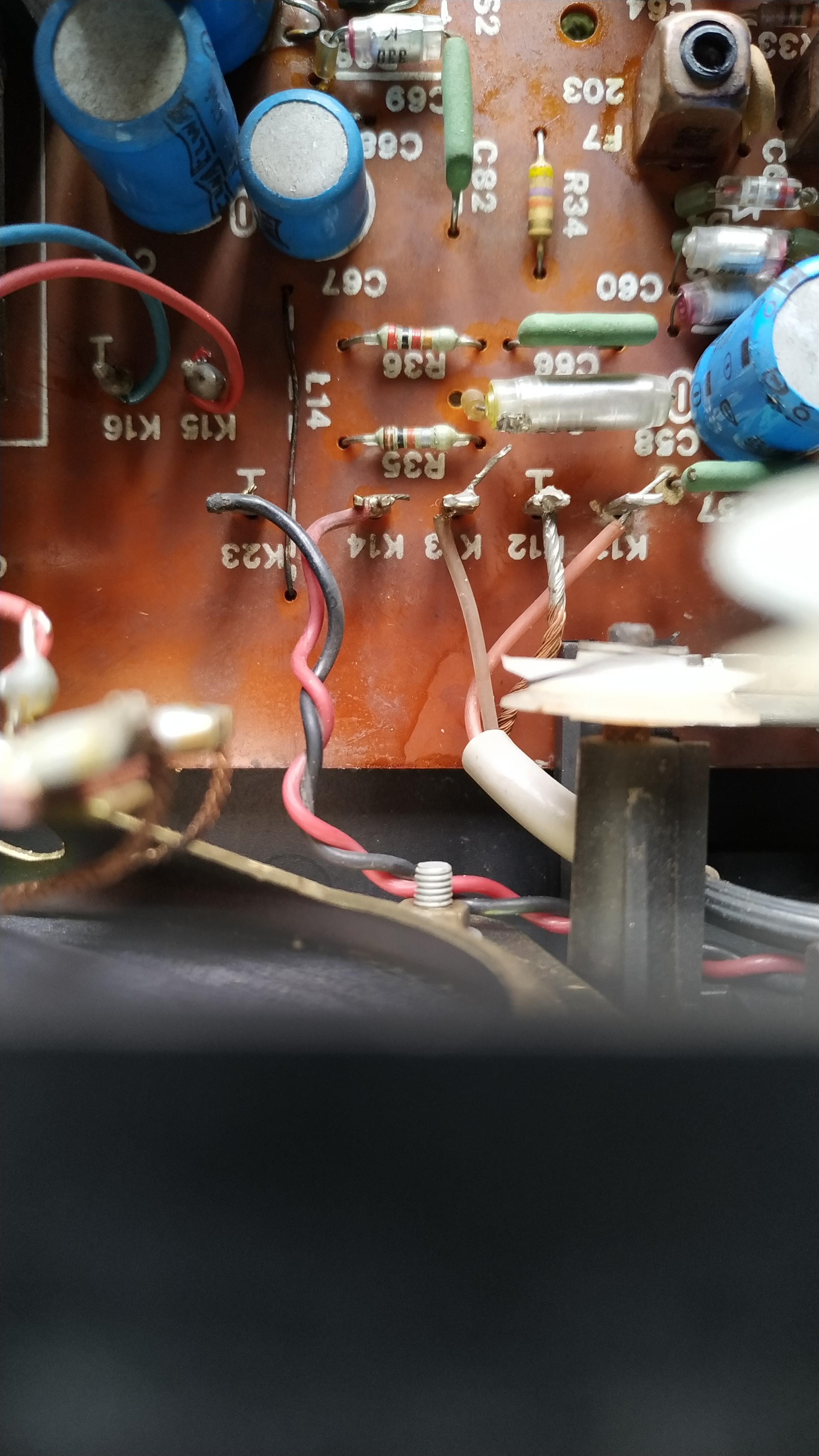

    From what I remember, this black wire was not soldered anywhere at the potentiometer. It acted as a shield for the red wire from the potentiometer tapping and was only soldered at one end to pin K23. Leave it as you have it now, just make sure that the other end of this black wire doesn't come into contact with anything when the potentiometer is mounted.
    Even the schematic diagram from the initial post shows that there are only 4 wires connected to the potentiometer.
  • #79 19661176
    Janusz_kk
    Posts: 5867
    Help: 228
    Rate: 1478
    Actually, the potentiometer is soldered to the screen, I've now matured that, i.e. the black slack wrapped over the red.
  • #80 19661269
  • #81 19661641
    glass2
    Posts: 101
    Rate: 32
    My suggestion is similar to the previous ones. This black wire is the ground and if it necessarily "must" be soldered then to the sheet metal on the potentiometer axis. Where the shield is soldered. It can also be free, because the shield, already makes this connection. Regards.
  • Buzzing likely from electrolytics, not tuning capacitors

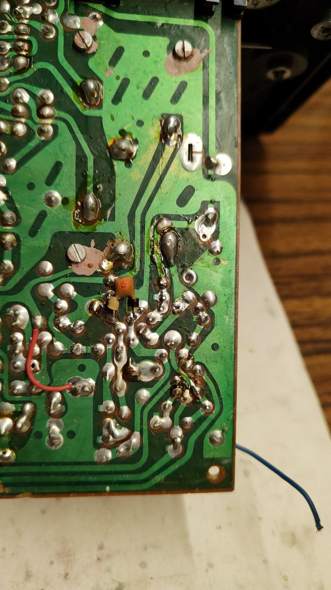

    #82 20215702
    szejker89
    Posts: 260
    Rate: 14

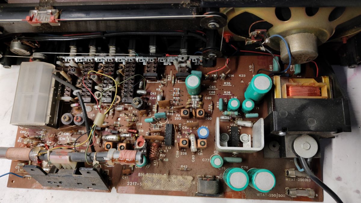

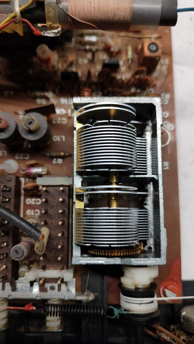

    My father-in-law brought me an R-207 from the "dump" and the radio was just buzzing. After taking it apart, to my surprise, ours was already here ;) The radio is tuned and all I had to do was to repair a track that had broken (cracked laminate). However, it is strangely tuned.... I found a schematic, with capacitor values for the tuning, which differs from what is done in my copy. Capacitor C2 replaced with 15pF instead of 18pF, C8 cut out, C14 is 15pF, C17 cut out. It was screwed with "something" of the F1 description, L1 has no case (unless that's how it is originally), fiddled with coils L3 and L4, and coil L2 stretched at the ends. The air capacitor has two plates slightly bent off. The shield which is glued to the case was not connected.
    The radio receives very well, but buzzes. I wonder if this is the fault of the electrolytes or maybe due to these cut capacitors.
    Interior of an old Polish radio receiver UNITRA Sniezka R-207 Interior of an old Polish radio receiver UNITRA Sniezka R-207 Interior of an old Polish radio receiver UNITRA Sniezka R-207 Interior of an old Polish radio receiver UNITRA Sniezka R-207 Interior of an old Polish radio receiver UNITRA Sniezka R-207 .
    I'm going to get down to cleaning the switches, potentiometer, replacing electrolytes (all of them without exception), and all the cosmetics. Should I leave it alone, or experiment with adding capacitors C8 and C17 which are cut out? Unfortunately I don't have any measuring instruments apart from a multimeter and a digital Chinese oscilloscope with a 1kHz generator.
    • VID20220930174422.mp4 (94.41 MB) You must be logged in to download this attachment.
  • #83 20215718
    Janusz_kk
    Posts: 5867
    Help: 228
    Rate: 1478
    These cut-outs have nothing to do with the buzz, the buzz is caused by dead electrolytics or an amplifier.
    szejker89 wrote:
    The air capacitor has two plates slightly bent.
    Don't touch this, this is the factory tuning for long wave.
  • C8 found as 43 pF on board underside
    #84 20217094
    szejker89
    Posts: 260
    Rate: 14
    It turned out that capacitor C8 is inserted on the other side of the board, with a capacitance of 43pF. Adding C17 makes no difference. The electrolytes are in very good condition, I only replaced 2 pieces which had a higher ESR. The screen on the chassis has to be disconnected because the sensitivity decreases very much when connected. Buzzing has not stopped, but it depends on the antenna and feed cable setting, on some stations there is no buzz and on others there is. Switches cleaned with Kontakt S fluid without taking them apart, potentiometer cleaned mechanically without any chemistry. I wish I had pictures of the radio when I got it.... This is how it looks now :) .
    P. S. after inserting the photos I ran the veneer over with isopropanol to get rid of the dirt, the front was lightly run over with K2 Bono blackener and the scale was polished with Tek P1 polish. It looks like a brand new saloon :) .
    • VID20221001170055.mp4 (83.31 MB) You must be logged in to download this attachment.

Why does FM sensitivity fall when I reconnect the aluminium shield?
The shield can capacitively load the front-end coil, detuning L2–L4 and cutting gain by roughly 3 dB [Elektroda, szejker89, post #20217094] Leave it floating or add a 1 pF standoff to ground.
Quick 3-step method to retune the FM head to 88-108 MHz?
  1. Parallel a 10 pF trimmer to C14 (RF) and a 6 pF series cap in the heterodyne loop.
  2. Stretch L3/L4 until a station appears at 108 MHz.
  3. Compress L2 for equal coverage down to 88 MHz; confirm with RTL-SDR [Elektroda, pawelr98, post #18944089]
What edge case kills oscillator action below 95 MHz?
Some boards left the heterodyne coil at 2.5 turns instead of 3.5; oscillation stops at the band bottom. Re-wind to 3.5 turns with a 1.75-turn tap and add 4.7 pF in series to the varicap [Elektroda, pawelr98, post #18917161]
