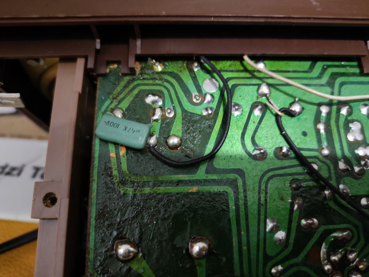

  • Question about 0.47 µF rectifier capacitor in Sudety
    #97 21345573
    szejker89
    Posts: 260
    Rate: 14
    Hey :) It's been 2 years since I saved the R-207 and everything is fine. The only thing is when a radio station starts to receive a little worse, there is a hum. Now I got a Unitra Sudety, tuned but with a problem such that when it plays quietly, the sound seems to want to fade. I think I'll start by checking the capacitors. However, and this surprised me, there is a 0.47uF capacitor added in the Sudety on the rectifier diodes, on the path side. There is no such capacitor in the Snow R-207. Why? Is it worth adding it? And what type of capacitor is it, polyester? And I also have such a question, is it worth reviewing other capacitors in Unitra equipment that get damaged with age? I've heard something about film capacitors causing problems, and many people overlook them. And something else that surprised me is that in the Snowball all the Elwa electrolytics are in perfect condition. The 1000uF capacitors have an ESR of 0.00ohm!!!
    Printed circuit board with a 0.47uF 100V capacitor soldered on the paths .
  • 0.47 µF diode capacitor recommended for interference suppression
    #98 21345583
    kris8888
    Posts: 7101
    Help: 537
    Rate: 1935
    szejker89 wrote:
    What surprised me, however, is the added 0.47uF capacitor on the rectifier diodes, on the path side, in the Sudeten. There is no such capacitor in the Snow R-207. Why? Is it worth adding it
    Such a capacitor suppresses the high-frequency interference that can be generated by rectifying the current at the diode's p-n junction. It is worth adding it. A simple polyester one for 100V will suffice.
