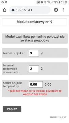

    I have used the WiFi.channel () function before, but I did not go in that direction. I scanned WiFi networks. A little pointless. And as it turned out, the function without parameters returns the channel of the network to which the ESP is connected.
    It was straight ahead. Just not to enter the network credentials in the transmitter configuration, I connect to the AP running in the ESP_NOW receiver. These settings are hard in the receiver code. The condition is that the station must be connected to the WiFi network. Next, configurations of measuring modules.
    In the screenshots, the configuration of the sensor module of the earlier version and the new one.
    LED weather station with NTP clock and calendar
    In the new version, you do not need to know and enter the WiFi channel of the network. Just run the transmitter configuration, set the number and interval and save everything. The message on the module configuration page is just an example. You can do it any way you like. For example, display the channel number again. The new transmitter code is attached. Many thanks to my colleagues krzbor and khoam for inspiration :)

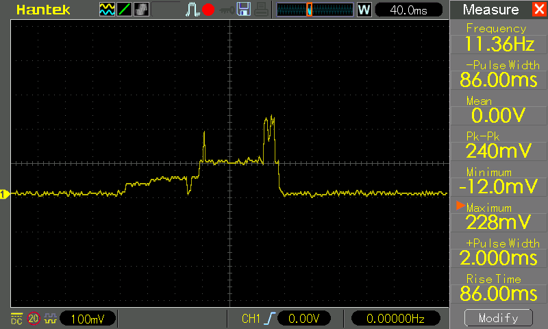

    It's not about power consumption, but about waking up, measuring and sleeping. Integrated memory probably speeds up data exchange. I compared both modules with a similar configuration.
    There is ESP 8266 in the oscillograms.
  • #54 19300502
  • ESP8266 sleep mode timing measurements
    #55 19300513
    efi222
    Level 22  
    Posts: 779
    Help: 12
    Rate: 1221
    This is the transmitter code snippet from this project. I personally checked all the sleep options. The former works the fastest.
    ESP.deepSleepInstant (SLEEP_TIME * inter, WAKE_NO_RFCAL);
    // ESP.deepSleepInstant (SLEEP_TIME * inter, WAKE_RFCAL);
    //ESP.deepSleepInstant(SLEEP_TIME * inter, RF_NO_CAL);
    //ESP.deepSleepInstant(SLEEP_TIME * inter, WAKE_RF_DEFAULT);
    //ESP.deepSleep(SLEEP TIME * inter);
    Measurement module oscillograms. Differences in the way ESP8266 sleeps. These aren't big differences, but still.
    WAKE_NO_RFCAL - 220 ms
    WAKE_RFCAL - 260 ms
    RF_NO_CAL - 230 ms
    WAKE_RF_DEFAULT - 250 ms
    DeepSleep without options - 360 ms
    Interestingly, manual wake-up - module reset with the button, introduces an additional boot delay for all modes, approx. 120 ms
    DeepSleep without options - manual reset - 480 ms
    When waking ESP from the timer by GPIO16 it looks like in the waveforms above.
  • Manual reset adds about 120 ms boot delay
