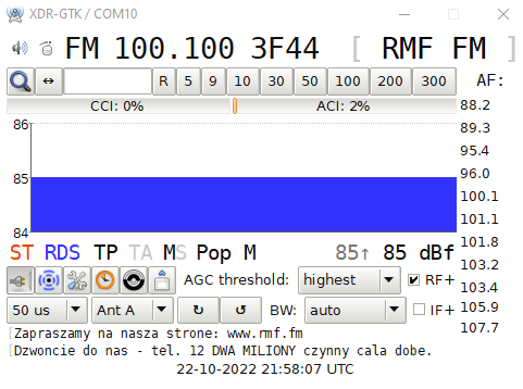

    It worked. Thanks for the help.
    Interface of the XDR-GTK program with RMF FM signal at 100.100 MHz.
    The signal graph in your screenshot looks strange. Anything at all changing? This is how it looks for me.

  • #35 20251213
    dktr
    Level 26  
    Posts: 930
    Help: 45
    Rate: 702
    Board Language: polish
    You must have some very old soft in this atm, the signal level varies by 1 dB, you have no decimal values, and that was done quite a long time ago. Note that in my graph you can see what is happening between 77 and 76dBf.

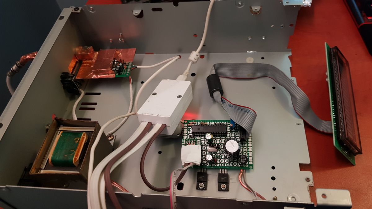

    Nothing, only the housing, transformer and cinch sockets remained from the Denon.
    Decorated front-panel buttons on universal boards, VFD display from a fiscal printer :)

  • #45 20253728
    sq3evp
    Posts: 6334
    Help: 210
    Rate: 833
    It turned out nice :)
    It probably sounds like Denon - ie sensitivity, selectivity and other parameters?
  • #46 20254028
    dktr
    Level 26  
    Posts: 930
    Help: 45
    Rate: 702
    It sounds like TEF6686. Originally the Denon worked, but its parameters were much worse than that of TEF - when it comes to sensitivity and selectivity. In addition, it already had a bright VFD display and almost nothing was visible, so I treated it as a housing donor :)

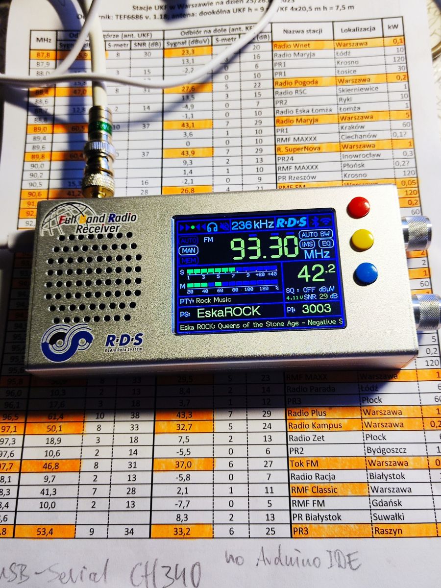

  • #52 20769477
    henryk2f
    Posts: 130
    Rate: 14
    >>19665798 I also have such a radio, after connecting to a 4 x 20,5 m square antenna on 4 masts h=7,5 m I have all-day reception of UKF stations from Gdansk to Krakow (and Krosno also catches). The radio is great. I installed CH340 driver on PC and comp sees this radio. Now I'm just looking for a good software to control the radio from PC - what can you Fellows suggest? In the first photo the TEF6686 radio, in the second photo the current consumption at 5 VDC. I also attach a list of stations heard in Warsaw on this radio connected to the aforementioned antenna.
    TEF6686 digital radio displaying EskaROCK station against a background of radio station list. Current meter display showing 5.15 V and 0.335 A. .
    • Stacje UKF w Warszawie 25.09.2023.xlsx (16.71 KB) You must be logged in to download this attachment.
  • #53 20772110
    sq3evp
    Posts: 6334
    Help: 210
    Rate: 833
    The 4x20.5m antenna is not an antenna for the FM band, better results would be given by an antenna for this band.

  • #56 20772775
    henryk2f
    Posts: 130
    Rate: 14
    >>20772110
    This is how I get reception downstairs - the signal is better from this 4x20.5m antenna - probably because the signal from the omnidirectional UKF antenna (mounted at about 9m high) is split by 3 antenna splitters along the way. Upstairs, as I connect directly to this UKF antenna, the signal is better from the UKF antenna - see the table in my post.
    Added after 5 [minutes]:
    dktr wrote:
    after connecting to a 4 x 20 square antenna,5 m on 4 masts h=7,5 m I have all day reception of UKF stations from Gdansk to Krakow (and Krosno also catches). The radio is great.
    This kind of reception is very difficult without elevated conditions from central Poland on Yagi antennas on the right bands with considerable gain let alone on a piece of wire for KF bands. Someone here is mistaking the truth.
    But such reception I have (and this is not tropo, but continuous reception) - unbelievers I invite you to a site visit :)
    Please compare my performance (--> table !) when connected to the KF antenna downstairs and the performance when directly connected to the omnidirectional UKF antenna (the signal from this antenna reaches the socket downstairs after passing through 3 signal dividers).
