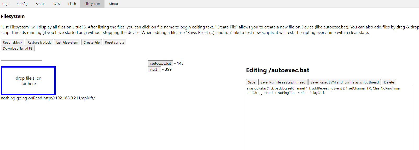

  • Ping watchdog exposed as a change event
    #1149 20368812
    Posts: 14725
    Rate: 12810
    That's a great idea!
    I exposed the ping watchdog time as a change event.
    Setup and test:
    Settings - the "reconnect wifi" timer is set to a large value so nothing happens too early:
    Script:
    alias doRelayClick backlog setChannel 1 1; addRepeatingEvent 2 1 setChannel 1 0; ClearNoPingTime
    addChangeHandler NoPingTime > 40 doRelayClick
    After boot, device waits a bit for things to settle in..
    It pings the device:
    After disabling this device:
    At this point, relay clicks on and comes back to 0:
    You need latest update for that!

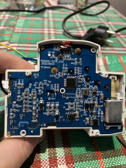

    #1150 20368825
    7825995
    Posts: 9
    Hi all!
    I successfully flashed the WB3S with the OpenBK7231T_UA_1.15.279.bin file in this switch:
    https://www.aliexpress.com/item/1005003696236608.html
    Connected switch to home WiFi and MQTT broker.
    Unfortunately, this switch is not in the list of supported devices.
    Here is the original Tuya firmware
    I want to add this switch to HA using MQTT
    How can I set it up?

    #1151 20368891
    Posts: 14725
    Rate: 12810
    Hello, I can guide you step by step with the configuration, but I need more information.
    The second picture of the board is not attached correctly and I can't zoom it to see what's there.
    I also need the picture of the second side of the board. Photos must be high quality, so I can figure out what's going on there.
    We need to determine:
    - is this a TuyaMCU device or not?
    - what kind of energy metering chip is there?
    - where is relay connect, where are buttons connected, etc (NOTE: in case of TuyaMCU device, that is not needed, because then relay etc etc will be connected to TuyaMCU and not to the WiFi module)
    PS: When posting a device link, also please post device name and screenshot from offer, because this link might expire soon. So, your device model seem to be YCB9ZF-100W CNC 2P :

    #1152 20368970
    7825995
    Posts: 9
    I didn't think the link might stop working.
    You are right, model YCB9ZF-100W CNC 2P
    I tried using this switch through Tyua,
    When the switch is turned on/off, the color of the LED changes.
    The Tuya app showed the voltage in volts.
    It was possible to program at what voltage the switch would turn off.
    Program the on and off according to the schedule.
    There were no power values.
    I think the protection works in the same way as in a conventional circuit breaker, from an electromagnet.
    The small motor turned on the switch.
    Shutdown occurred as if from a spring
    Unfortunately, all microcircuits are varnished. I see that you can read something on them, but I can't read it.
    I need to remove the varnish, but I don’t know how to do it.
    Here is a photo: [BK7231T] My HTTP server, configurator, MQTT support from Home Assistant [BK7231T] My HTTP server, configurator, MQTT support from Home Assistant

    P.S. The MCU somehow determines the actual position of the switch. See photo. When off, the indicator lights up blue, when turned on, red. I wonder how he does it? When there is no load, the color of the indicator also changes.
  • Suggesting an autotransformer test to locate voltage data
    #1162 20370126
    Posts: 14725
    Rate: 12810
    i didn't analyze the packets yet, but I will just note, that for the voltage guessing, it might also help to do a test with autotransformer, if you happen to have one. Or with 230V to 120V transformer because this device most likely runs well on 120V and we could compare packets data then and figure where is voltage data stored.
    Thank you for your contribution so far, that data surely will be useful. I will try to look into the packet contents tomorrow.

    Here is the analysis result:
    ID 22 seems to be Voltage. There are some other variables but they don't seem to change between two tests. I am unable to locate current and power yet.
  • ID22 appears to be voltage, with no power readings
    #1165 20377550
    7825995
    Posts: 9
    I think you are right! ID22 is very similar to voltage. At least one more value must change.
    Turning on/off the Automatic switch (red/blue color of the LED in the photo).
    Here is a video I made before flashing. It is not of very good quality, but it shows what features were on the original TUYA firmware.
    There are no power values, only voltage and a shutdown function when the specified voltage is violated.
    These enable/disables can be configured in HA or NODEred automations
    It seems to me that the main difficulty is to understand what command is sent when the remote turn on / off.
    In the evening, I will try to turn it on / off several times, maybe you will be able to understand what value is changing at the same time

    @p.kaczmarek2 thanks,
    By the way, is there a reason why this script isn't working as before?
    It keeps assigning PinRole 8 Rel & PinRole 9 AlwaysLow even with mqtt online
    It was working fine on previous firmware (.170 ish.. i haven't updated my switch in a while)
    addEventHandler MQTTState 1 backlog setPinRole 8 AlwaysHigh; setPinRole 9 Rel
    addEventHandler MQTTState 0 backlog setPinRole 8 Rel; setPinRole 9 AlwaysLow
  • Using NoPingTime to detect MQTT disconnects
    #1170 20383828
    Posts: 14725
    Rate: 12810
    Are you sure about that?
    Maybe it just remembers the state?
    Maybe you should set an initial one here:
    // set start value
    Still, I tested it and it seems that MQTT TCP connect is very slow when it comes to detecting the dropped connection.
    Maybe there is a better way?
    You can consider using that new Ping time event. Something like:
    addChangeHandler NoPingTime > 10  backlog setPinRole 8 Rel; setPinRole 9 AlwaysLow
    addChangeHandler NoPingTime <= 10 backlog setPinRole 8 AlwaysHigh; setPinRole 9 Rel
    Set the IP of your MQTT server in options.
    More than 10 seconds without ping reply from there would trigger backlog.
    And again, if ping time changes from any high value to 0 again (on ping received) it will execute another backlog...
