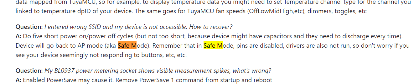

    I flashed OpenBK on a P01-CB3S motion detector. It worked, and I successfully configured the Wi-Fi. It was functioning fine, but after a few restarts, I can no longer see it on my network.
    I tried performing 5 power cycles to bring up the OpenBK Wi-Fi access point, and it worked. However, when I try to connect to the AP, it disappears.
    I have no idea what could be causing this issue. Do you have any suggestions or insights?

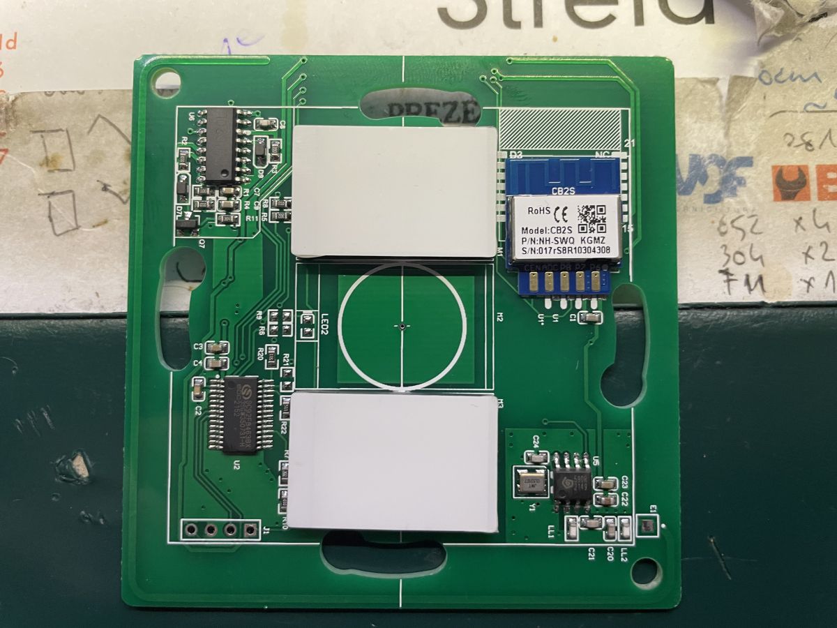

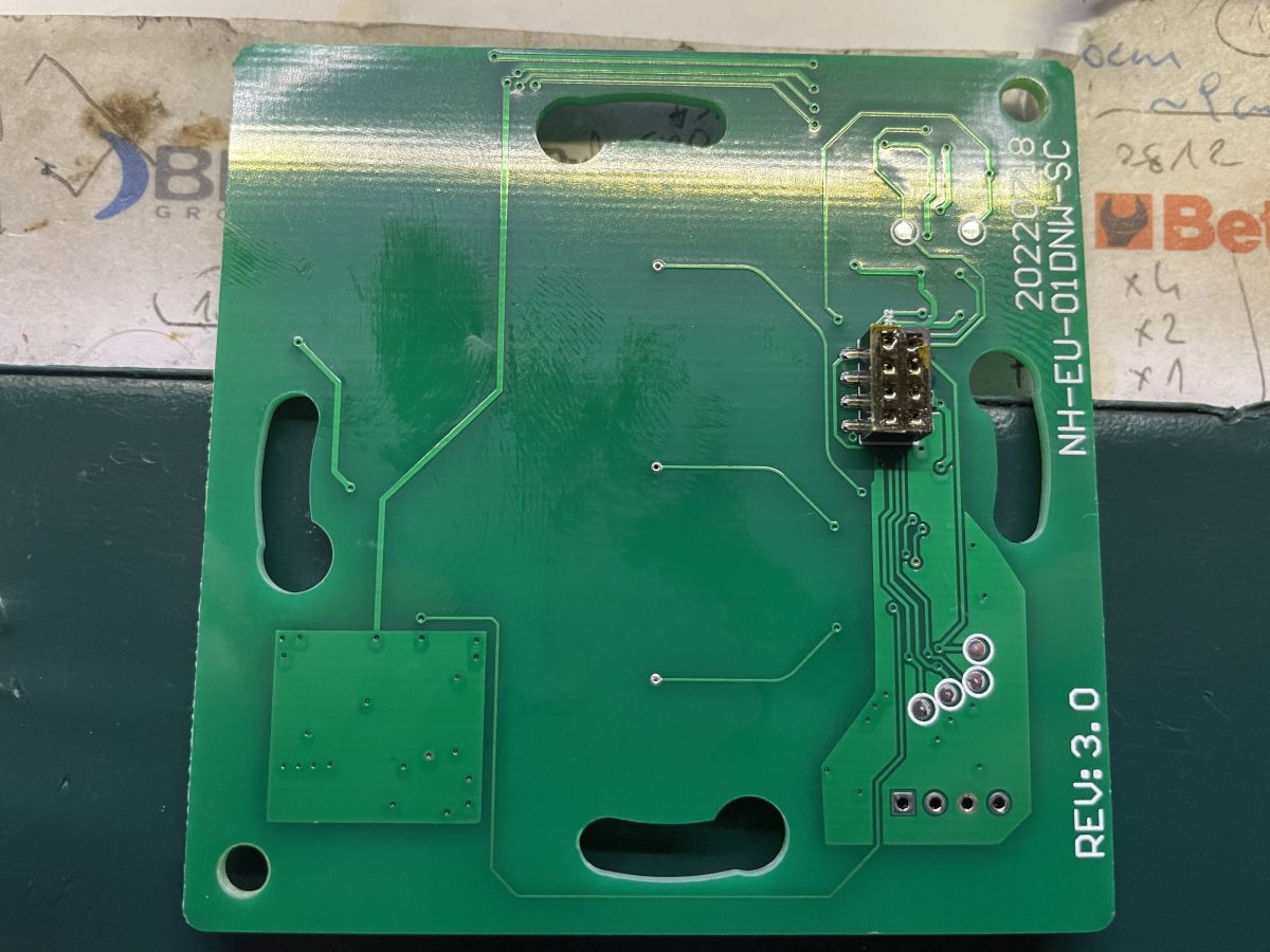

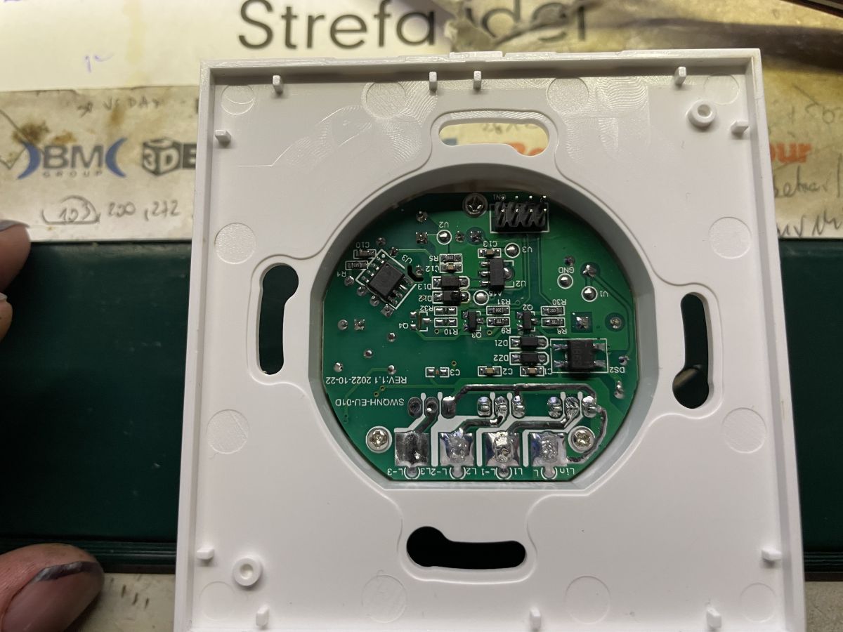

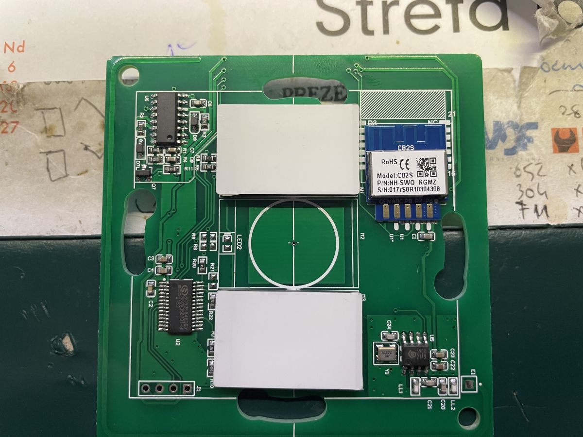

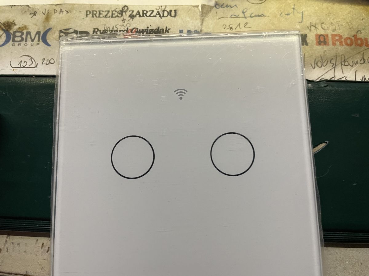

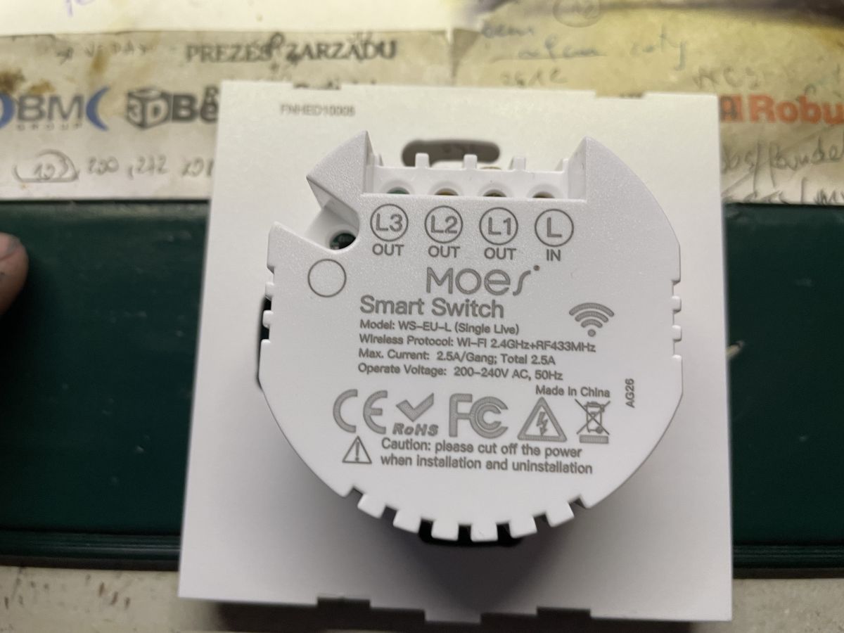

    Testowaliścoie może wersje 2 portowy przełącznik bez N, ale również aktywowany z pilot 422MHz? -będzie to działać?
    Chip CB2S, RX i TX podlaczony do pinów układu SC92F8363BX z którego wyprowadzone są piny ?GND?VCC oraz uklady zh1620h i mniejszy 590R 2149

  • #1233 21571973
    Posts: 14622
    Help: 655
    Rate: 12639
    It's probably TuyaMCU device, we can help you with programming it.
    Start with this guide:
    TuyaMCU flashing, setup and configuration guide - configure dpIDs for Home Assistant
  • #1234 21574774
    rysiulg
    Posts: 28
    >>21571973
    OK. I think there should be more work with it ;(
    I've break RX/TX from CB2S and attach directly to USB FTDI Converter. GUI Flasher do his work, but not found any Tuya/OBK Config and now only plates are light without any WiFi AP, don't react on Remote 433MHz and don't react on touch...
    In direct terminal on 9600/ 19200/38400/57600/115200 there was only some "garbage". Boot loader also should be updated to enable wifi?

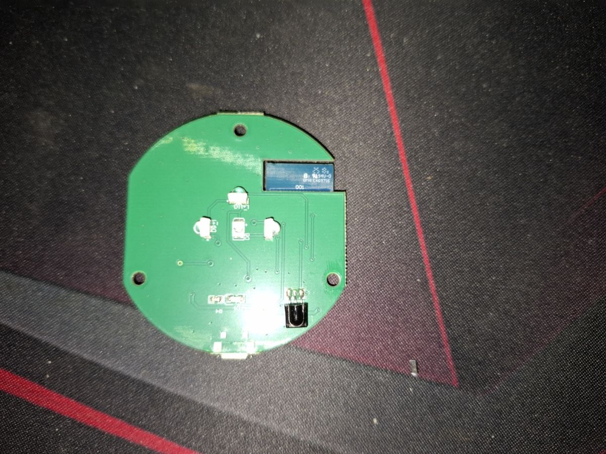

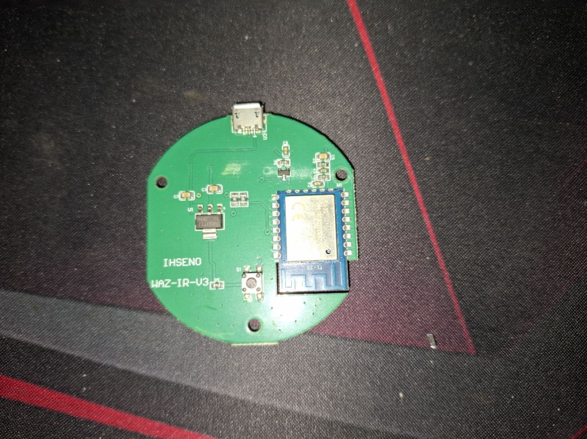

  • #1245 21613018
    Posts: 14622
    Help: 655
    Rate: 12639
    A photo from our user:
    any ideas what it might be?
  • #1246 21613037
    Posts: 5065
    Help: 438
    Rate: 893
    I'm placing bets on BK7231N. Won't it be likely the TXs are in the same place and a log can be captured from one?
  • #1247 21613277
    Posts: 14622
    Help: 655
    Rate: 12639
  • #1248 21613279
    Posts: 5065
    Help: 438
    Rate: 893
    ah. that's an S not another 3 :D
  • #1249 21613282
    Posts: 14622
    Help: 655
    Rate: 12639
    Looks like another BK7231N renamed as T1, I am trying to ask user to take a boot log.

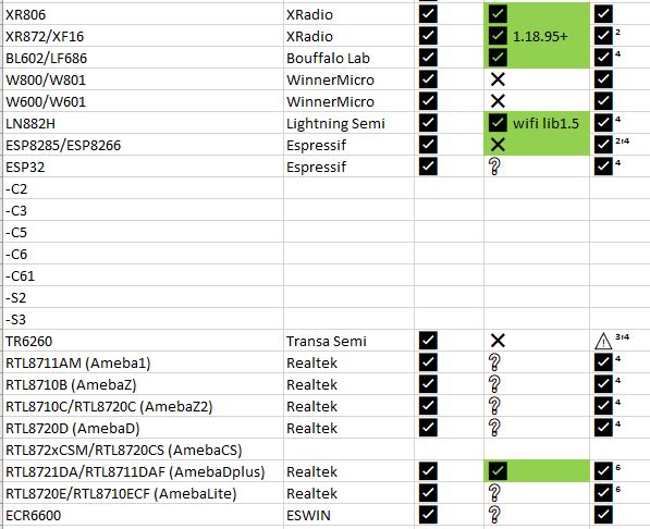

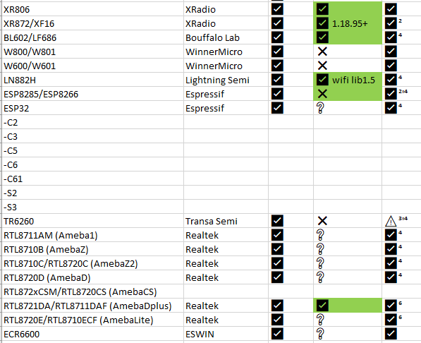

    insmod wrote:
    I think i will expand platforms.md to show pwm, gpio, lfs etc.
    I don't recall noticing this line and did think it needed more when changing it. I'm glad you added more. Anyway. Here are WPA3 updates - WIP.
    Wi-Fi chipset compatibility table for WPA3 and libraries by various SoC vendors
    Should mixed-mode WPA2/WPA3 be checked too or just straight in with WPA3-only AP?
  • #1252 21615283
    insmod
    Posts: 1397
    Help: 164
    Rate: 436
    [postid:e8642bd1d4][/postid:e8642bd1d4]
    For LN882H it doesn't matter what wifi lib, i've just had to add ln_wpa_sae_enable() to connect HAL.
    Mixed mode doesn't matter. If WPA3 is supported - it will connect via WPA3. If not - WPA2.
    Since AmebaDplus supports WPA3, then AmebaLite supports it too.
    On ESP32 WPA3 is disabled. Can be enabled if CONFIG_ESP_WIFI_ENABLE_WPA3_SAE is set to y in sdkconfig.defaults (do not enable OWE - we don't need it)
    I see that on ESP8266 ESP8266_WIFI_ENABLE_WPA3_SAE is enabled by default. If disabled - more free heap will be available.
  • #1253 21615293
    Posts: 5065
    Help: 438
    Rate: 893
    ah ok ok. cool.
    OK. I don't need WPA3 specifically, but was testing what works in general release.
    I'll do it again, but it didn't connect, so...
    Are there any in platforms.md I should try that you're definitely unsure about?

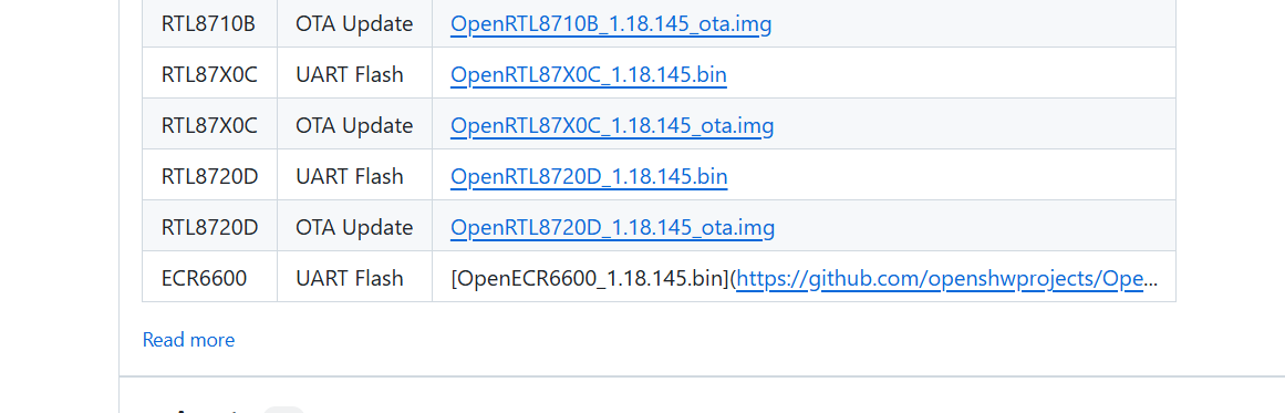

  • #1257 21624577
    Posts: 14622
    Help: 655
    Rate: 12639
    Did something broke in releases tab?
