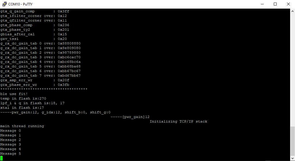

    After flashing with OpenBK7231T_App_UA_1.0.0.bin got this in second uart
    [20:18:08.795]
    V:BK7231S_1.0.5
    CPSR:000000D3
    R0:AFEB93F9
    R1:F6C67B29
    R2:FF7E7AF7
    R3:72EE2B75
    R4:97BBF3D6
    R13:956DBF7F
    R14(LR):F5D9FF3D
    ST:22CEA70E
    J 0x10000
    [20:18:08.895] prvHeapInit-start addr:0x41c790, size:145520
    init log
    The chip seems to be BK7231S

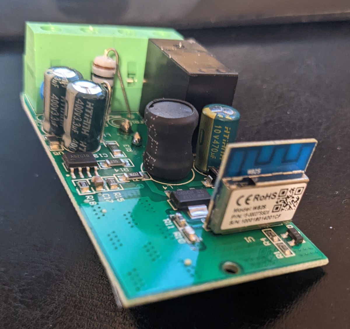

    esanford
    I have some Martin Jerry SS01 smart switches with WB2S, I'd love for them to be included in your upcoming firmware!

    @esanford , thank you for the photos, it looks like your device is already supported, you just have to select proper pin as relay and button in the Configurator. Just like in Tasmota.

    Hi folks,
    I got a bunch of no-name Tuya-compatible WiFi switches, which come with external switch sensing (so you can wire a physical switch and react to it). It's exciting to see that a small community has gathered around freeing these devices from crappy cloud providers! Thanks for all the work done so far.
    These switches feature the BK7231N (not T) as well, sadly. Here are some detailed pictures with references:
    [BK7231T] My HTTP server, configurator, MQTT support from Home Assistant [BK7231T] My HTTP server, configurator, MQTT support from Home Assistant [BK7231T] My HTTP server, configurator, MQTT support from Home Assistant
    Datasheet for BP2525X: (redacted because I "don't have enough points" to include links, wtf)
    The 1117 33 JMA9 is an LDO. Is M7 an LDO as well? OP says "connect 5V before LDO" and on the picture it seems it's on one of the M7 pads. But M7 seems to be 230V as it then goes to BP2525X's drain with according to datasheet is the high voltage 230V "drain".
    As you can see there seems to have test pads on the back of the blue PCB, but to reach them I'd need to unsolder either the blue PCB or the small green square-angle "transport" PCB.
    The main blue PCB also features pins "pwm0" to "pwm5", 3.3V, GND, RX1, TX1, ADC3.
    All in all it looks very similar to the one from OP.
    Where do you think I should wire 5V (or maybe direct 3.3V?) and ground here to start toying? OP says "before the LDO", does that still apply to this circuit?
    I'm very new to electronics so any advice would be appreciated on how to proceed to at least get some console out, then I'll attempt compiling and flashing using the official tuya SDK from GitHub. I already have a TTL-USB with RX, TX and Ground, will need to order another one for programming though.
    Thanks!

    I was running some tests, here's the result
    With wifi_scan_1.0.0_UA.bin I got results on uart2 -> works as planned
    With app_name_1.0.0_UA.bin I got also results on uart2 -> works as planned
    With openbk7231app_UA_1.0.0.bin Tested with 3 different versions of this bin and I even compiled my own. No victory yet.
    Is the other UART sending info? I've seen somewhere in the SDK that it's theoretically possible to choose UART1 for logging.
    If not, try to find the line that prints "init log", and see what happens there and what may be the problem. Adding your own debugging lines in various places might help reveal the exact spot where it hangs.

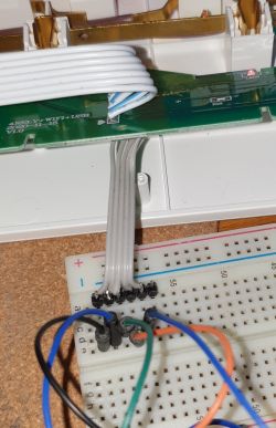

    Calex power strip from Tesco in the UK. Currently on offer at £7.50, reduced from £30.... :).
    Now running Openbk7231app.
    Challenges:
    The unit had never seen my wifi. I dumped the flash using
    python uartprogram -r -s 11000 lead-11000-1ef000.bin -d com4 -l 1ef000
    and then flashed it.
    At first, it died in starting MQTT. Once i'd commented that out, it did not want to start AP mode on the wifi.
    In the end, I solved it by delaying the AP mode start by 5 seconds. I'm pretty sure that 'role_launch' would do all of this for us, including main and backup SSSIDs.
    Anyway, proposed mods on the way, which include one bugfix....
    We will need a little more finesse in the config (like a 'wifi status' LED type, and what to do with that single button - currently controls relay 1)
    Pictures below :).

    boozeman
    Posts: 73
    My setup:
    COM14 programmer tx0 and rx0
    COM10 listener at tx1 and rx2
    All reasonable messages comes to COM10.
    COM14 gives only time when resetting
    [18:11:34.346]

    Thanks for the replies and special thanks to anonymous donor who's sending me Biedronka Light Bulb!
    It's time for more good news.
    Luckily there was also SDK for the BK7231N (not T) and I started fixing it and porting our firmware to it:
    https://github.com/openshwprojects/OpenBK7231N
    Right now, our App compiles well on both platforms:
    Platforms are similiar with some minor changes, more functions arguments for PWM, some header files moved (some typos fixed as well - tuya_hal_storge.h, really?), etc.
    I introduced some #defines, for BK7231N it's PLATFORM_BK7231N and for BK7231T it's PLATFORM_BK7231T. They are set in application.mk:
    # Compile options
    CFLAGS =
    CFLAGS += -g -mthumb -mcpu=arm968e-s -march=armv5te -mthumb-interwork -mlittle-endian -Os -std=c99 -ffunction-sections -Wall -fsigned-char -fdata-sections -Wunknown-pragmas -nostdlib -Wno-unused-function -Wno-unused-but-set-variable
    CFLAGS += -DPLATFORM_BK7231N=1
    OSFLAGS =
    OSFLAGS += -g -marm -mcpu=arm968e-s -march=armv5te -mthumb-interwork -mlittle-endian -Os -std=c99 -ffunction-sections -Wall -fsigned-char -fdata-sections -Wunknown-pragmas
    I hadn't time to test more flashing on BK7231N platform but the compilation certainly works right now.
    Of course, you connect 5V to the input pin of low dropout regulator, 1117 or a simiiliar one, to get a 3.3V on the output for Beken chip...
