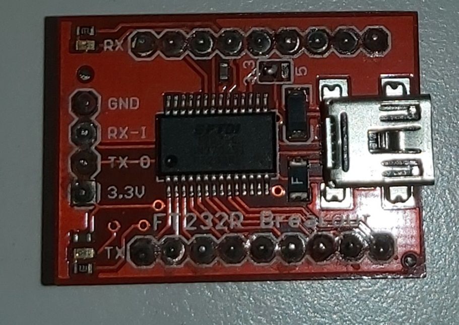

    Mine is Old and Faitfull Sparkfun FT232R. Used many times for flashing esp8266 and esp32 devices and also some ST devices for Blitzortung.org Lightning detectors. In fact it is one of the my old Blitzortung Green station serial adapter :)
    Normal "flashing" connection with VCC,GND, RX, TX White wire is for Gen/I00 to gnd
    The chip is WB2S with connection points similar than posts here.
    I have tested BK7231N abd BK7231 in Beken Writer. Serial adapter discovered by COM10 and baut rates tested 115200 and 921600.
    There's no slower than 115200.
    Edit: Managed to read flash. It is surely voltage drop when connecting vcc when try to write flash.

    #43 19858701
    Posts: 14771
    Rate: 12914
    Congratulations! Welcome to Bekken readers club!
    Were you powering from USB? Did you leave that big, bulk, electrolytic capacitor at 5V rail?
    As I said several times, if you are willing to reset by powering off and on, this capacitor must be removed. Otherwise the large current surge at power on will overload USB port and cause USB device reset.
    I remove that capacitor every time:

  • Erasing flash fails on WB2S module
    #45 19859816
    boozeman
    Posts: 73
    Heh, thanks. No luck for writing yet. Tested with external power source adjusted for 3.3VDC (DC-DC converter with Lenovo laptop powersupply as input).
    I have to butcher the Nedis plug, so for now I am workin with only plain WB2S module.
    Erasing flash:0x00011000 FAIL
    Reading works every time. I start it with VCC, TX, RX, GND and CEN o GND connected to usb-serial converter, start reading and then take off CEN wire
    Is the other settings OK?
  • Trimming firmware to 956 KB avoids erase failure
    #46 19859948
    kuba2k2
    Posts: 120
    Rate: 14
    This also happens to me, on WB2L. Additionally, I can't read anything at all, it just fails at the start.
    What helps for flashing is to simply trim the binary file to about 956KB (1MB - 1048576 bytes, minus the offset). Then, the flasher does not try to erase the area above 1MB and the flashing goes on properly.
    I suspect the bootloader in some devices may be somehow locked so it doesn't allow that erase?
    edit: I'm powering the module on its own original PCB, from 12V from a lab ATX (the board has a switching regulator), so I don't think it could be caused by voltage drops.

    boozeman
    Posts: 73
    Hi,
    I will buy another USB2Serial converter for tomorrow. It is based for CP2101 chip. My current steam powered old and faithful FTDI 1207-C can't handle 921600bps. It was built at a time when the proponent of such a speed would have been burned instantly as a witch :D
    The Nedis WIFIPO120FWT chip looks like this.
    About those Nedis devices, i made "warning" about Tasmota Templates git The older batch comes with esp8266.
    PS: EDM-01-AA-EU KER_V1.6 progress (full teardown will be posted on Elektroda soon):
    Do you have Kicad Symbols for WB2S and WB3S already? I can try to reverse schematic for Nedis device. Not the high voltage section but normal what pin goes where BL0937 etc.
    Edit:
    Successfull write for OpenBK7231T-20220203fx-956kb\OpenBK7231T_App_UA_1.0.0.bin finally. Well, I can't see any wifi network to connect with my phone. I will continue to debug :)
