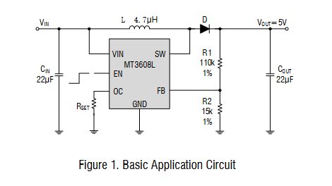

• Sweep span: 2100–2600 MHz, typical 15 kHz sweep rate [Elektroda, Seps111, post #20245722] • Baseline RF power: 5–10 mW; optional 1 W PA boosts range 10× [Elektroda, Seps111, post #20240445] • Step-up output: 5.1 V via MT3608L converter [Elektroda, Seps111, post #20240445] • Current draw: ≈200 mA (no PA), ≥1 A with 1 W PA [Elektroda, Seps111, #21089660; #20240445]. • Minimum battery: 500 mAh Li-ion; 18650 preferred for higher surge [Elektroda, LEDówki, post #20252704]

What voltage should the step-up converter deliver?
Set the MT3608L to 5.1 V measured after the Schottky diode. Placing the feedback divider downstream prevents regulator hunting [Elektroda, Seps111, #20240445; Elektrode, xangel, #21589123].
