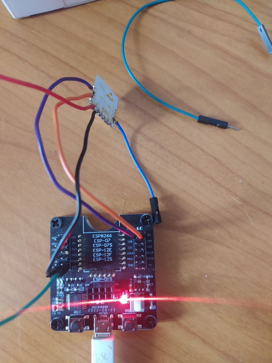

  • Possible EN pin pull-up needed for module startup
    #35 20384620
    Posts: 14743
    Rate: 12839
    What? Impossible, you should get at least a basic log output that happens before OpenBL602 is loaded.
    Are you sure? Can you post a screenshot? Maybe your device is all the time in boot mode?
    Wait, maybe... just maybe... there is some kind of EN pin on the board that needs to be put to VDD with 10k resistor for module to run? Maybe this module is different from what I experienced in the past...
    Please show photo of the setup.
    I might have that module somewhere, I haven't yet tried to play around with it, I must look for that, but I have lots of stuff and I don't remember where I've put it.

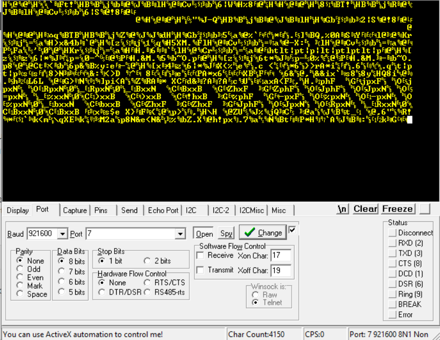

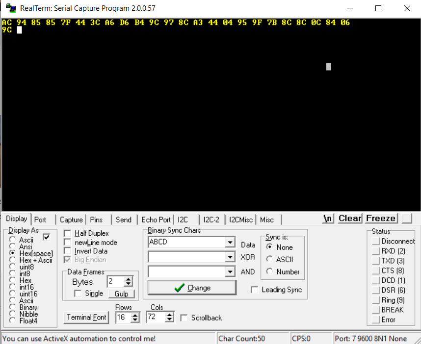

  • Random data appears on reboot after flashing
    #36 20384662
    ionoleinic
    Posts: 48
    I tried again and this time something appeared.
    AC 94 85 85 7F 44 3C A6 D6 B4 9C 97 8C A3 44 04 95 9F 7B 8C 8C 0C 84 06
    9C
    [BK7231N] CoRui TUYA WiFi Smart LED Light Bulb 9W E27 RGBCW
    [BK7231N] CoRui TUYA WiFi Smart LED Light Bulb 9W E27 RGBCW [BK7231N] CoRui TUYA WiFi Smart LED Light Bulb 9W E27 RGBCW
    Added after 59 [seconds]:
    On reboot always appears something new.
    94 85 D4 C4 64 B3 8C 0A 84 84 84 84 84 E6 42 F4 DF AF 5D 5B 44 F7
    B4 C6 8C 04 1E 5E 9C 8C 84 44 D6 DC 8D 9A 45 A0 FD F4 61 0C E4 94 C4
    A4 B4 D4 24 EC A4 E4 1C 94 94 90 0C 98 F6 D6 6E 04 E8 FF AC 59 22 07 C4
    FF
  • #37 20384664
    Posts: 14743
    Rate: 12839
    Now I know what's wrong. Posting screenshots is very helpful.
    Firstly, the debug log output of BL602 is at 2000000 baud rate, not the 9600 you have.
    Secondly, the debug log output is ASCII text. There is no need to display it as HEX. It's a human-readable format.

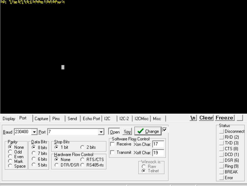

  • #38 20384670
    ionoleinic
    Posts: 48
    I can't find baud 2000000.
    Max 921600.
    Output is also unreadable.
  • #39 20384751
    Posts: 14743
    Rate: 12839
    It's possible to enter any alternatve value in this combobox. That's how you can set any baud rate in RealTerm, even non standard ones.

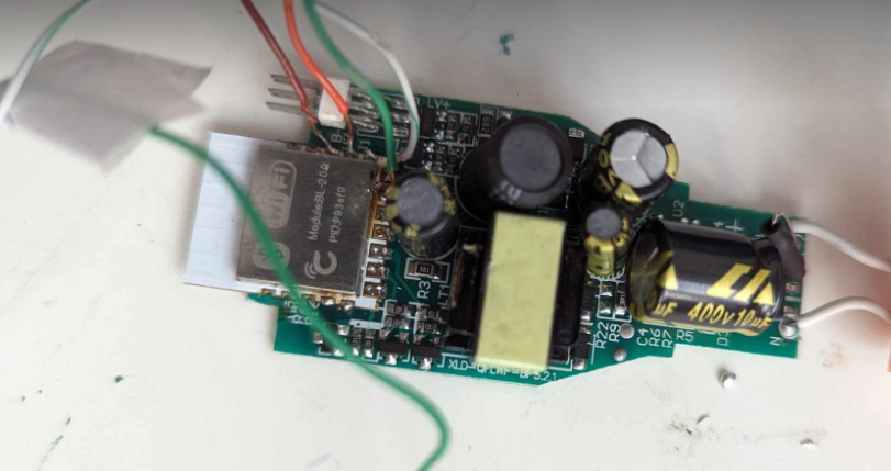

    Posts: 48

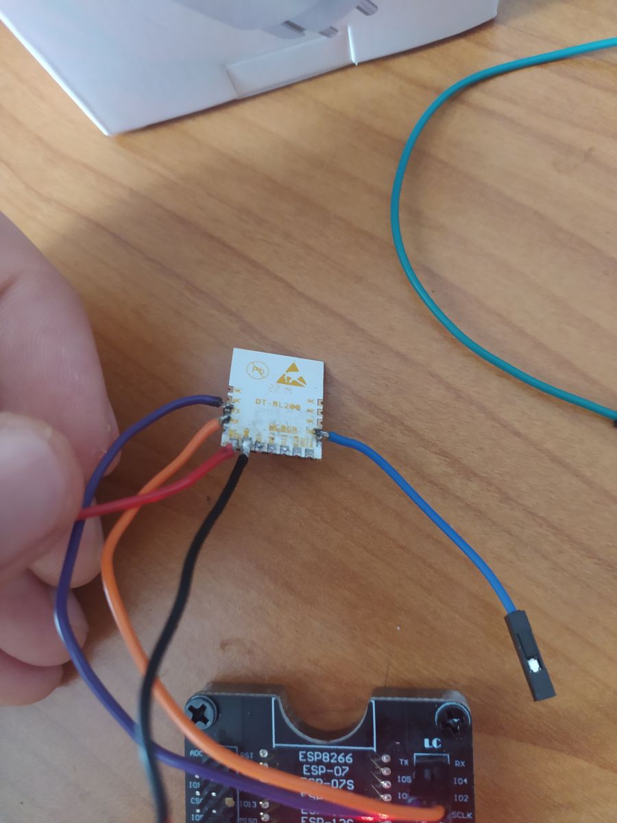

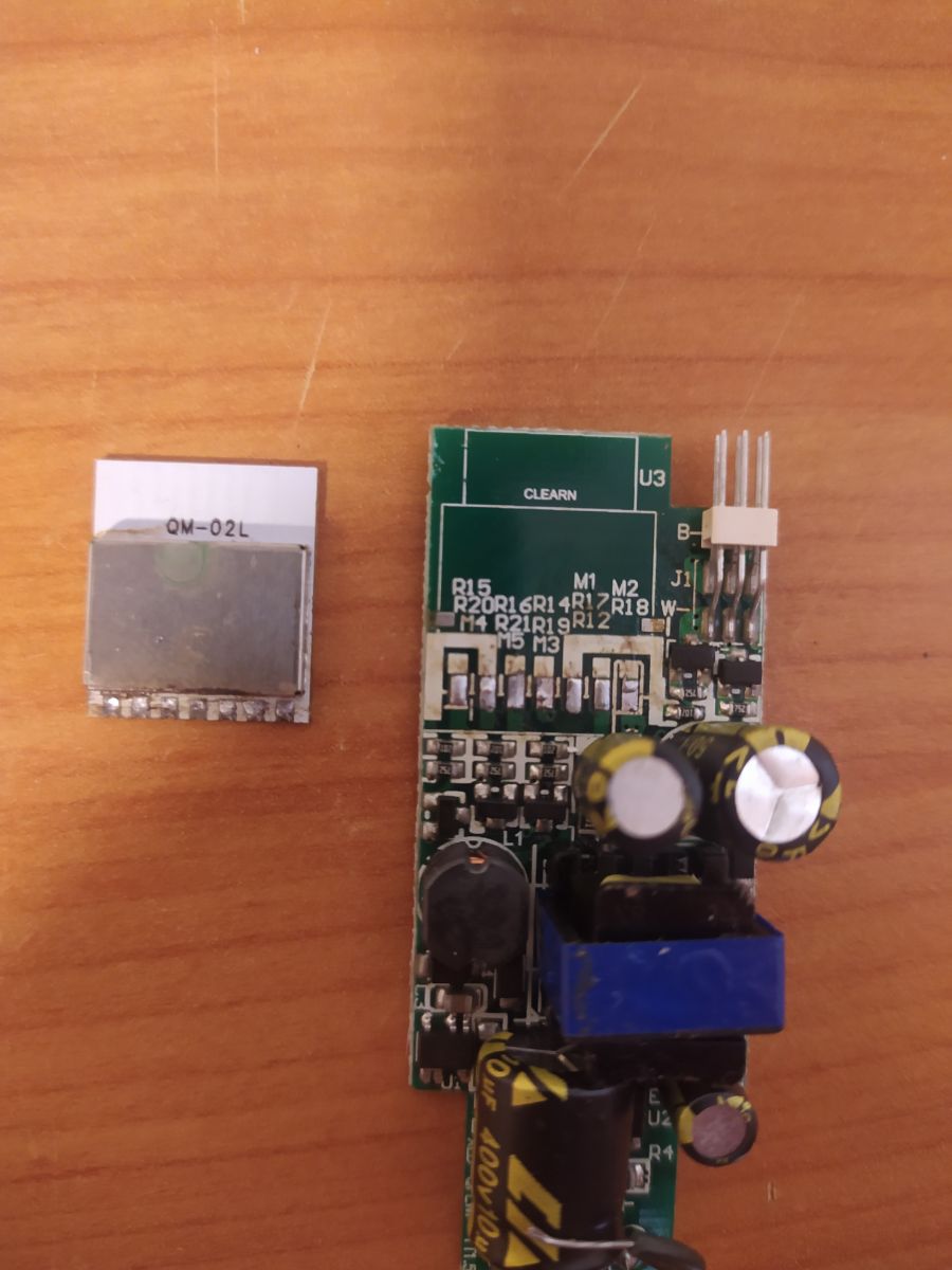

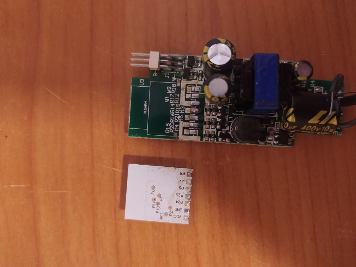

    Another Tuya bulb. Another wifi module...
    What module is this??

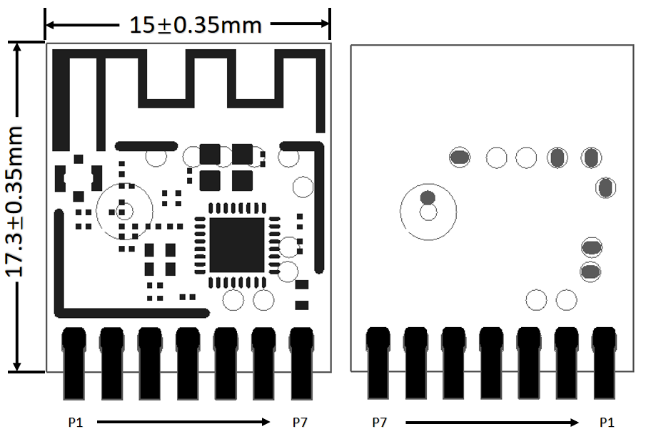

  • #43 20645867
    Posts: 14743
    Rate: 12839
    It looks like CB2L clone. Basic pinout matches. P24, P26, etc.
    P10 may be RX1, and P11 may be TX1. This is UART1. Programming port.
    Those P0 and P1 may also UART2.

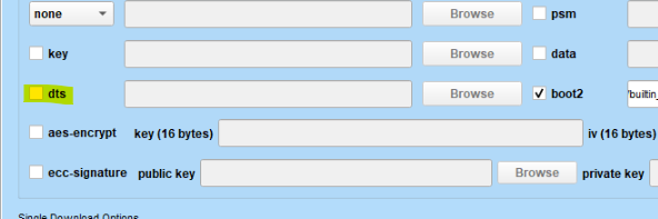

  • Missing Wi-Fi and Bluetooth after flashing BL-200
    #44 20917763
    kamilm20
    Posts: 53
    Rate: 20

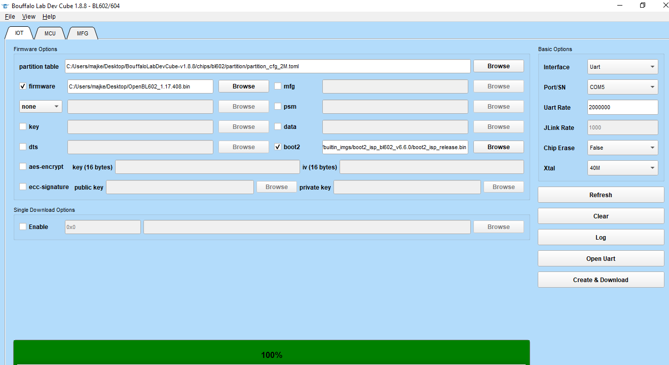

    I started to use software OpenBL602 but I have the same issue like the ionoleinic - everything was wrote to the conrtoller BL-200 without errors but still I cannot see the hotspot from module - do you have any idea where is the problem?
    Circuit board with electronic components, including a Mediatek network module.
    Screenshot of Bouffalo Lab Dev Cube 1.8.8 software interface for configuring firmware options and connection settings.
    If there will be needed something copied from the BL-200 I have not used two pieces so I could download something if you give me advices how to proceed that. I check the logs and I think this is the main issue but I do not know how to solve it : ):
    [ 0][ERROR : hal_board.c: 942] wifi NULL.
    [ 0][ERROR : hal_board.c:1075] bt NULL.
    • terminal_logs.txt (9.83 KB) You must be logged in to download this attachment.

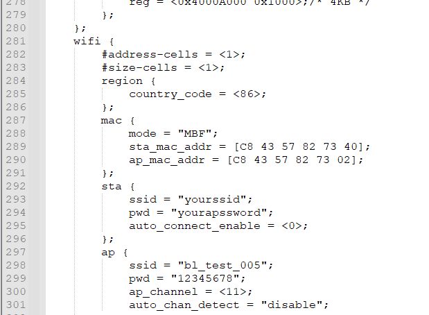

    So it's possible to change MAC via DTS file? I still have bricked BL602 module, maybe flashing with DTS could help?

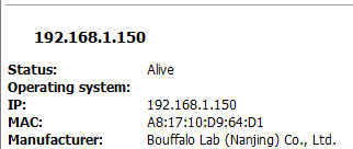

  • BL602 MAC source depends on mac mode order

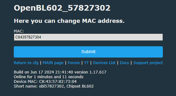

    #47 21263084
    Posts: 5195
    Help: 446
    Rate: 913

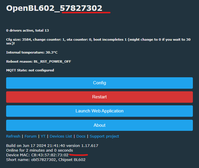

    >>21262327
    To test:
    Flashed BL602 with whole IoT device backup from your repo: Bl602Lamp-4th.bin.bak - single download option
    Boot, paired with Magic Home - mac in IP scan and in boot log:
    Screenshot showing IoT device details with IP address 192.168.1.150 and MAC A8:17:109:641.
    flashed to OBK with standard BLDC selections. dts file with default macs
    AP broadcast name includes original mac (presumably of the dev board as it's always been - 192.168.1.150 I think is always the dev board)
    House icon with the text OpenBL602_10D964D1. Screenshot showing the device MAC address and a short description.
    STA mac is the same as seen in GUI and boot logs.
    So, in summary, without further fiddling, the mac in the dts file does not seem to have an effect.

    look here and some dts files include a command about the meaning of the MBF value
    https://github.com/search?q=repo%3Aopenshwpro...27B%27%3A+efuse%3B+%27F%27%3A+flash&type=code
    I believe it's the order of preference. If you change it so F is the only value then the AP mac in the dts file is used
    User interface of OpenBL602 on a monitor screen showing IoT device status.
    STA mode also uses the AP mac
    Screenshot of an interface with IoT device information showing status, operating system, IP, and MAC address.
    so, yes, you can change the mac, you just have to adjust dts file so the bootloader (?) knows where to look for it.
    Added after 10 [minutes]:
    with "F" mode changing the mac in OBK is only cosmetic. I get the same IP as with previous dts file mac
    Network interface of OpenBL602 with MAC address change option.

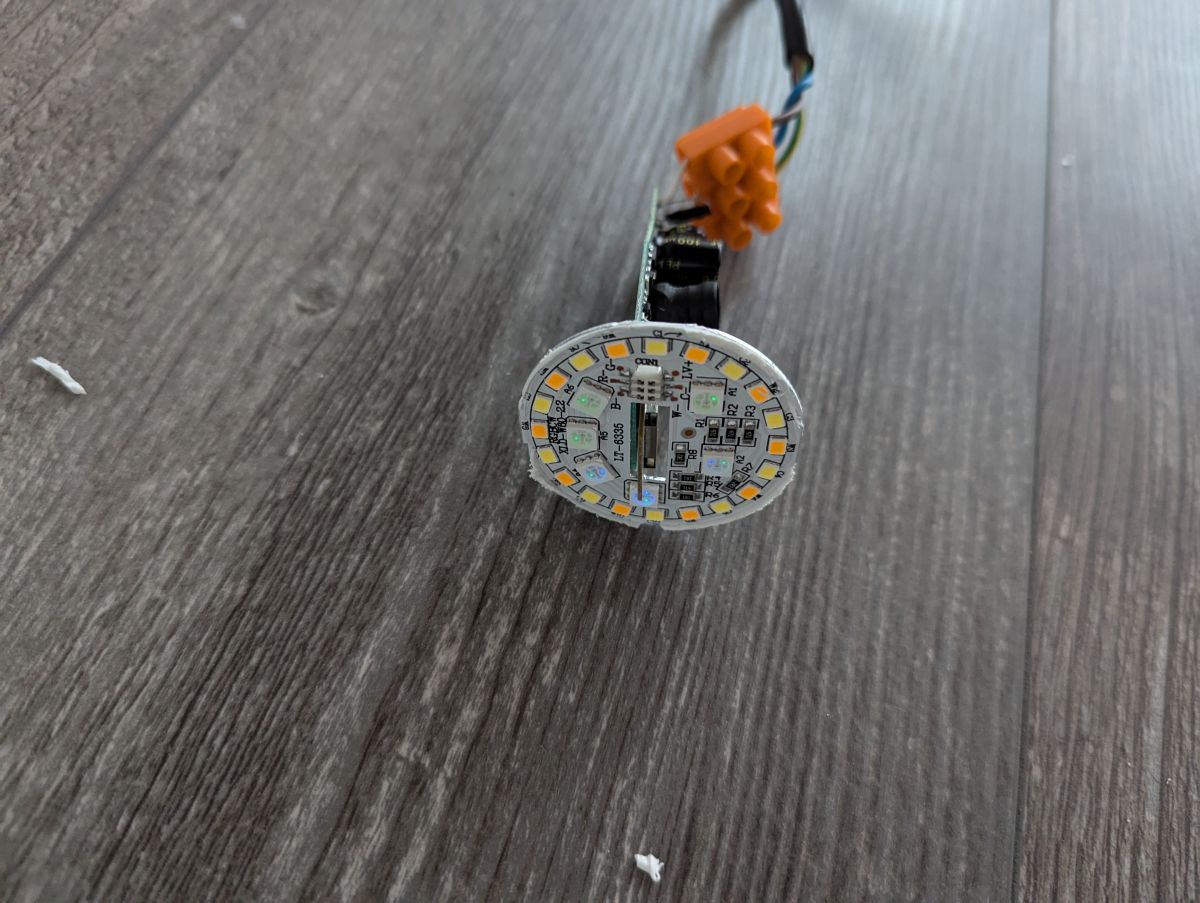

    Round LED board with wires on a wooden floor. .
  • 1M partition allowed OpenBL_602 upload, but hotspot still failed
    #49 21265019
    kamilm20
    Posts: 53
    Rate: 20
    thank you for idea with mflasher but it is too late - I uploaded the chip so I have not possibility to come back to the first state. But many thanks for solution wit your backup!
    I added also DTS but withouth any good resaults. Also there was not possiblity to wrote the data with partition_cfg_2M - I used 1 M and the software was able to upload the OpenBL_602. But still hostspot is not established. By 2M I had the error 45.
