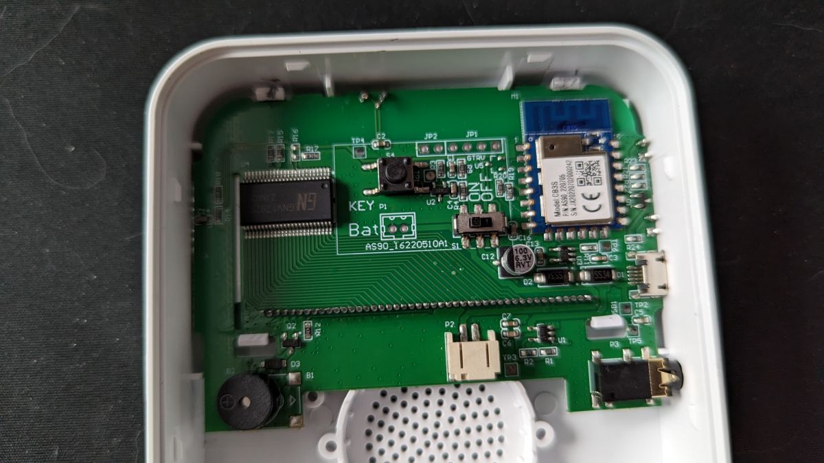

TurkeyMan 16599 52
How can I flash this BK7231N Tuya temperature/humidity monitor with OpenBeken, and what TuyaMCU features and data points does it expose?
Yes—this BK7231N/Tuya temperature-humidity monitor is flashable, but the TuyaMCU controls the CB3S power, so you usually need to isolate the UART (for example by desoldering R3/R4 or cutting the TX/RX traces) and power the Wi‑Fi module manually while flashing [#20326460][#20548730] The battery-life concern is mostly handled in hardware because the Wi‑Fi chip is shut off completely between wakeups, and the report interval is configurable; the default is 120 minutes, but it can be set from 1 to 120 minutes [#20283980][#20737316] A working OpenBeken setup starts `TuyaMCU`, `NTP`, and `tmSensor`, then maps dpID 1 to `temperature_div10` and dpID 2 to `Humidity`; `tmSensor` helps keep the MCU from powering Wi‑Fi off too quickly [#20370395][#20365279] The newer version-00 TuyaMCU packets also show the extra settings: dpID 3 battery, dpID 9 C/F unit, dpIDs 10–13 min/max temperature and humidity, dpIDs 17/18 report intervals, dpID 19 temperature sensitivity, dpID 20 humidity sensitivity, and dpID 21 a switch state [#20737316][#20741402]

    tmSensor is here:
    https://github.com/openshwprojects/OpenBK7231T_App/blob/main/src/driver/drv_tuyaMCUSensor.c
    it is supposed to send data to TuyaMCU telling MCU to do not power off the module yet and request the measurement results.
    https://developer.tuya.com/en/docs/iot/tuyacl...niversalserialaccessprotocol?id=K95afs9h4tjjh
    It was tested with TuyaMCU door and flood sensors.
    We might need to compare if the packets from original firmware are the same as the ones in the code...

    #32 20372249
    TurkeyMan
    Posts: 59
    Rate: 9
    I don't have the original firmware, but my captures from before should have captured those requests, assuming they are always present.
    I think a UART logger would really help; now that it's running OBK, I don't really see the point of hard-wiring and externally scraping UART data, the "UART Tool" should have a raw mode to just dump all TX and RX bytes as hex to an output area... is it possible? I wonder if you can hook the low-level UART functions (which may be used by other libraries/drivers) and intercept the bytes before passing them forward?
    Is the UART interface an SO? Dynamically linked? Can be overridden with your own interception shim? Or perhaps the low level API already supports an intercept feature?

    #33 20398854
    djbenson
    Posts: 8
    Is there any way to get these devices into AP mode or can they only be flased using a cable?
    EDIT: the answer is "yes" - I have no idea how I did it, just kept pressing the button and the WiFi logo switched from a slow cycle through the levels of the icon to a blink - it looks to me like it flashed successfully but the Openbeken SSID isn't showing up.
    ==> Toggle Tuya device's power off and on again 6 times, with ~1 sec pauses in between, to enable AP mode. Repeat if your device's SSID doesn't show up within ~30 seconds. For smart plugs long press the reset button on the device for about 5 seconds. See https://support.tuya.com/en/help/_detail/K9hut3w10nby8 for more information.

  • Clarifying P2 wiring and CB3S power mod
    #37 20532533
    mkmunichmk

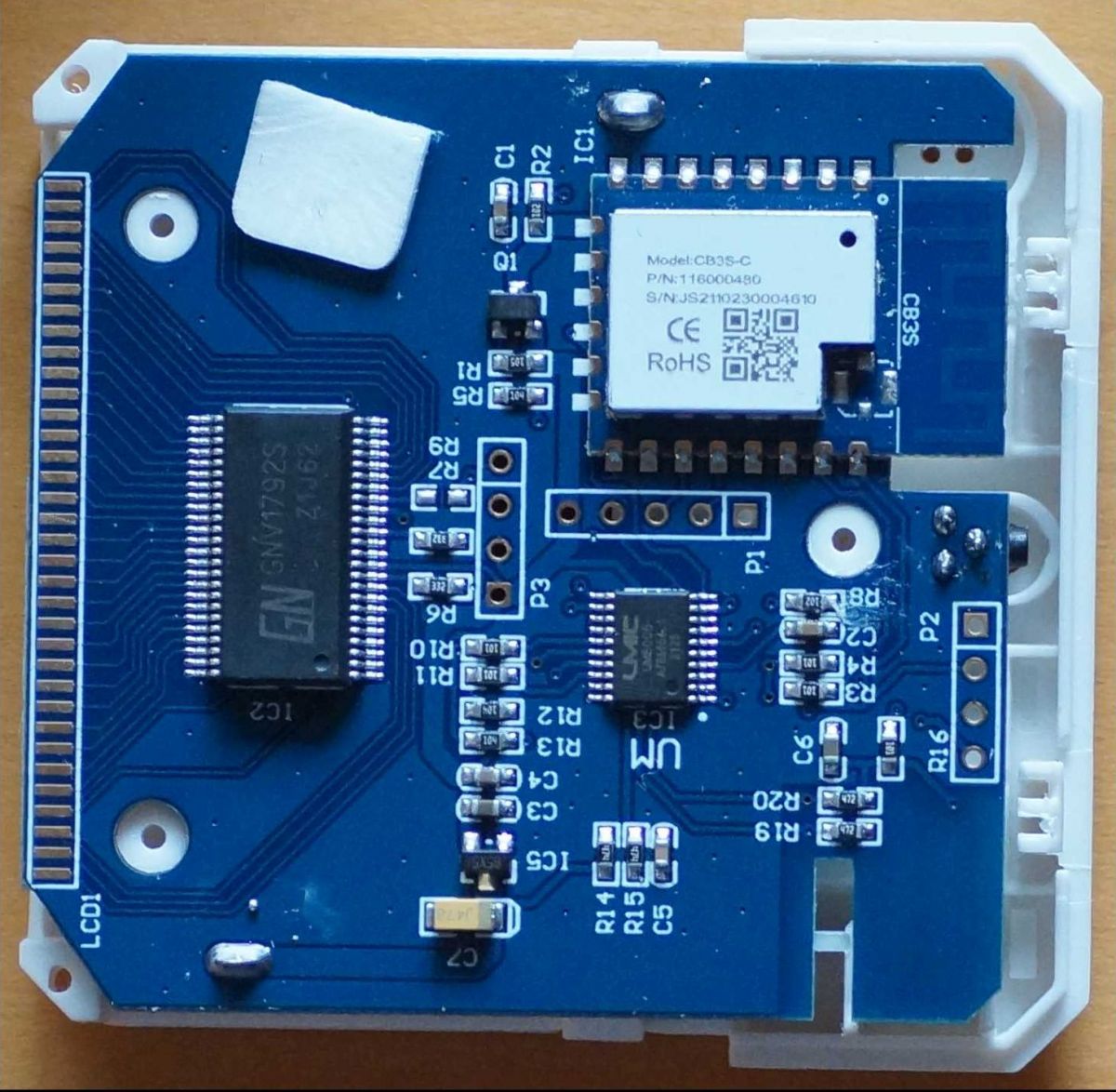

    Posts: 32
    Hi, I´m new to this forum and very interested. As I have a device out of the box with the original firmware, I could help to provide it. Unfortunately it is not yet clear to me how to access the device. There are three connectors labeled P1, P2 and P3. My device has no further labeling printed nearby P2 like your device (VCC, GND, RX and TX). I hope, it is the same wiring as your device.
    I am lost with picture gallery-14&15. Can I assume, that it just shows, how P2 is wired (by PCB) to IC3 and Q1? How did you finally manage it, that CB3S is permanently powered as directly power VCC to CB3S seems not to work? Was it successful after desoldering R3, R4 (as you wrote)? Means, to retrieve the original firmware I'll need to desolder R3, R4 in advance and then use which (Windows) program? Could someone provide the link to the program & online help? This would be great. Happy eastern and Best Regards
  • Need photos to determine BK7231N flashing method
    #38 20532697
    Posts: 14827
    Rate: 13009
    Please provide good quality photos of your device.
    Here's flasher:
    Here are guides:
    Here is firmware repository:
    There are two main tasks you need to do to flash this device:
    1. check is this device using TuyaMCu to power on/off WiFi module (is WiFi module VDD connected through a transistor?)
    2. check how to access RX/TX port (RXD1/TXD1) of WiFI module (TuyaMCU is most likely blocking it, in case of some devices you can just desolder resistors, in case of other devices you need to cut traces)
    It's hard to say more without any photos.
    I have a TH06 humidity & temperature LCD monitor but a USB powered one, where CB3S is by default always powered, and it works for me on OpenBeken, I don't know if battery one will work out of the box, maybe it will need some more debugging and work on the firmware.
  • Component list for BK7231N temperature monitor teardown
    #39 20533604
    mkmunichmk
    Posts: 32
    Hi,
    my device is nearly the same as in this post; except the labeling of P2.
    New picture attached. As the devices are not quite 'readable' I took a lens and wrote down all parts:
    [BK7231N] Tuya Temperature & Humidity Monitor: Teardown, Hackability & Features Explained
    R1 105
    R2 102
    R3 101
    R4 101
    R5 104
    R6 332
    R7 332
    R8 102
    R9 -
    R10 101
    R11 101
    R12 104
    R13 104
    R14 474
    R15 474
    R16 101
    R19 472
    R20 472
    few C1..C6
    C7 J476
    Q1 MOSFET KFH 848
    IC1 CB3S-C
    IC2 LCD Driver GNV 1792S (71J62)
    IC5 Level converter MOSFET? 65X5
    UM IC3 UMIC UM8005 A786854-1 2125 (Ultra-low power consumption 8-bit MCU: 1T8051, 32KB eFlash, 2KB 256B SRAM, 12-bit ADC)
    IC20 AHT20 Temperature & Humidity Sensor (AHT20 210602)
  • UART resistors must be removed for firmware flashing
    #40 20533615
    Posts: 14827
    Rate: 13009
    Your photo is a small device picture on big black background.
    I struggle to see anything there, but it indeed looks like CB3S connects to the MCU via TuyaMCU protocol and there are R3 and R4 resistors on the UART lines.
    You won't be able to change the firmware without desoldering those resistors temporary and then soldering them back.
    The next problem is that this device doesn't have a ready configuration yet. We would need to work together to figure out the config.
    This device is also problematic because MCU seems to control the power of CB3S and can turn on/off it at will, so basically WiFi will go offline when MCU feels like it.
    We can try to use @TurkeyMan UART capture to figure something out...

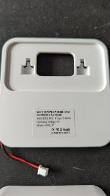

  • Device appears to be an AS90_W after failed update
    #42 20548612
    gabrielklein
    My device looks quite similar AS90_W - It died after a firmware update, it's why I try to "revive it"
    [BK7231N] Tuya Temperature & Humidity Monitor: Teardown, Hackability & Features Explained [BK7231N] Tuya Temperature & Humidity Monitor: Teardown, Hackability & Features Explained [BK7231N] Tuya Temperature & Humidity Monitor: Teardown, Hackability & Features Explained [BK7231N] Tuya Temperature & Humidity Monitor: Teardown, Hackability & Features Explained [BK7231N] Tuya Temperature & Humidity Monitor: Teardown, Hackability & Features Explained

  • Direct serial flashing and Wi-Fi setup on CB3S module
    #47 20640524
    mkmunichmk
    Posts: 32
    I just connected the 4 wires of the serial USB adapter directly to the module CB3S:
    8 VCC P Power supply pin (3.3V)
    9 GND P Power supply reference ground
    15 RXD1 I/O
    16 TXD1 I/O
    Then I downloaded the BK7231Flasher.exe (I got version 1.10b) and had chosen the latest firmware: OpenBK7231N_QIO_1.17.165.bin
    The flasher exe will start flashing (assuming the right PC COM port) after grounding pin
    3 CEN I Enabling pin, which is pulled high internally to be compatible with other modules
    of the CB3S module for ~0.25 seconds. I managed this by hand - may give it several tries ;-)
    After this (this is the trick!) I left the CB3S connected to the USB serial adapter and used the flasher to configure my WAN (Sid+pwd) settings.
    After a reboot, the Tuya Clock/Temp/Humidity device was visible in my WiFi network. and it got an IP address.
    Now, I was able to continue using the Web App ('Launch Web Application' button) and I was able to update the firmware OTA to 1.17.166
    In this Web app in tab Config there is a list of 'Devices:' where I could find Chipset: BK7231N and then my device "Tuya Tuya Temperature & Humidity Monitor [BK7231N]". At least the picture of the device looks like mine.
    I was able to 'Copy Device Settings', but now I'm missing the next step :-(
    Further reading is recommended ;-)

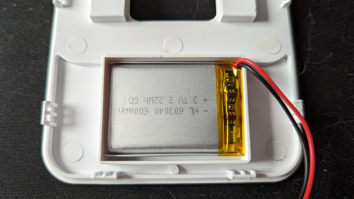

  • Battery wires added to keep CB3S powered
    #48 20641922
    mkmunichmk
    Posts: 32
    Sorry, I wrote in the wrong post - No idea how to move it to post https://www.elektroda.com/rtvforum/topic3914412.html
    as my device is very similar to https://www.elektroda.com/rtvforum/topic3914412.html#gallery-64
    [img-0] [BK7231N] Tuya Temperature & Humidity Monitor: Teardown, Hackability & Features Explained >>20534675
    Hi all, I'm learning ;-)
    some (little) progress...
    In order to power tuyaMcu + CB3S I soldered additional wires to Bat- and Bat+. Now I'm sure that tuyaMcu will not switch off CB3S.
    The result is that there is a better chance to stay connected with WebApp.

    You won't be able to change the firmware without desoldering those resistors temporarily and then soldering them back.
    This device is also problematic because the MCU seems to control the power of CB3S and can turn it on/off at will, so basically WiFi will go offline when the MCU feels like it.
    We can try to use @TurkeyMan's UART capture to figure something out...
