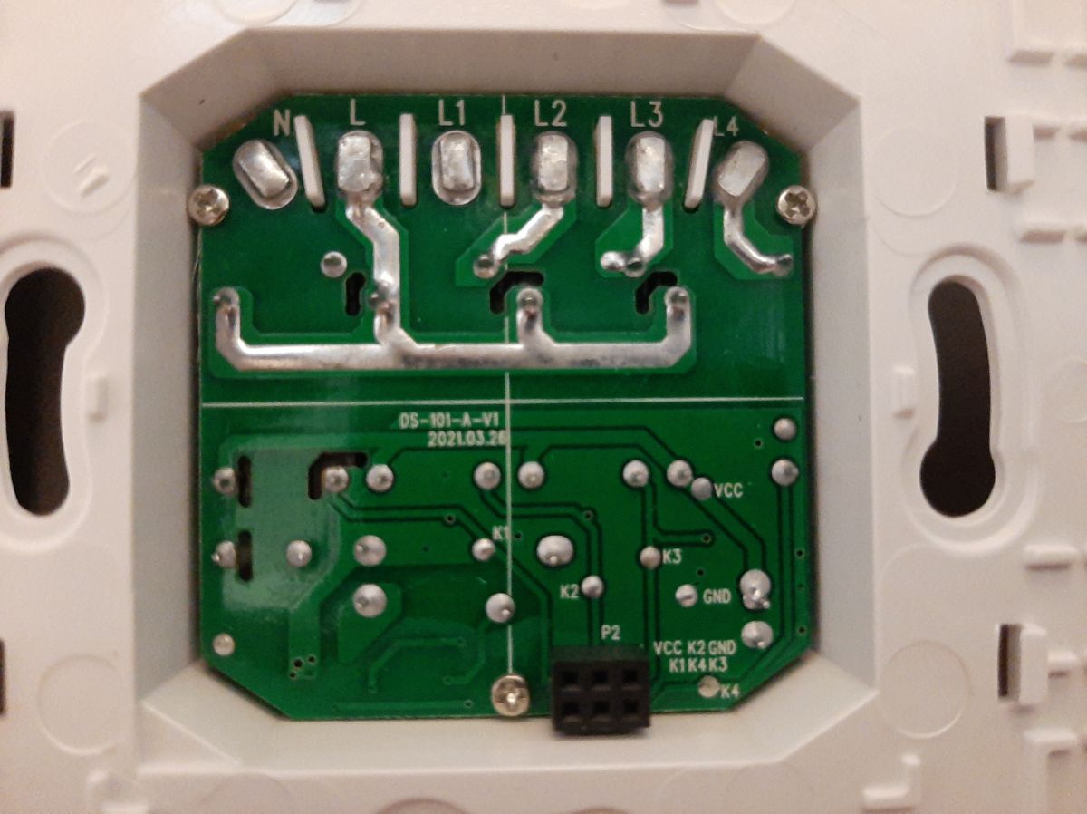

    #31 20379048
    jo_sef
    Hello @jo_sef , it is certainly possible to detach those relays from live wire (then basically there is a separation between relay contacts and coil), but from the photo I am unable to determine if you located the correct place. It even feels like it's not the correct place to cut. I'm afraid that cutting there would cut off the power supply of the device. I would need to see the whole device, where are relays, etc.
    Futhermore, I am confused - what are those two MOSFETs doing there? Those KND3403A...
    Hello @p.kaczmarek2, as I understand that MOSFET 1 is directly connected to L wire and the MOSFET 2 switching low voltage as as you can see it is connected to the SOURCE of the MOSFET 1.
    What I am confused is that not all relays are connected to the L wire, only pins of relay L2 and L3. The pin L1 goes on DRAIN connected to the MOSFET 2.
    So as I am thinking now it would may work if I cut it L track before the cap 0.01nF as I marked on the picture below for the reference. But I am not sure.

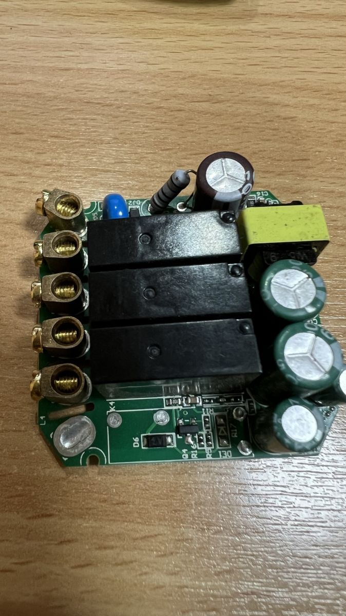

    #46 20576780
    jrhenk
    Posts: 59
    Rate: 8
    >>20321289
    It's pretty wild how different these devices can turn out to be, I just got a three gang DS-101 (in the database it's called DS-103) and instead of a WB3S it has a CB3S chip. I think this should be changed in the database or there should be two versions of the DS-10x devices as people might end up bricking their switch with the wrong firmware. BUT what's more: I can configure the LEDs independently from the relay state which is super cool!
    [BK7231N - CB3S] Generic Tuya Wall Switch Push Button Type 1-3 Gang No Neutral
    This is the link to the product page https://www.aliexpress.com/item/4000532726890.html
    The flashing with cloudcutter was a bit weird but I had this with another switch. The initial exploit works with two times a 10sec press, but for the firmware flashing to work I needed to do a combination of 6x off/on, then hold a button for 10sec for fast blink and then 10sec for slow blink
    The pins are also different than in the database, took quite some time to figure it out, but the PINDOCTOR helped with figuring out the LEDs and Relays which sped up the process, here's the final template
    A little tip for everyone who wants to use the relays independently from the buttons:
    Use the template underneath instead, and in HA you can e.g. for button 1 use the MQTT trigger
    Topic:
    [MQTT_CLIENT_TOPIC}/4/get
    Payload:
    1
    For button 2 use 5 and for button 3 use 6
    What's cool after applying this changed template: your leds will turn up like switches, so via the webui (or mqtt) you can just turn the leds on and off (power 4 to 6) without effecting the state of the relay

    I have a 4 gang DS-101, has anyone flash it before?
    Need photos?
  • #50 20606319
    Posts: 14754
    Rate: 12875
    I think I saw a single gang one. If you have 4 gang version, please consider posting it. Also include Tuya config:
    https://www.youtube.com/watch?v=WunlqIMAdgw
  • #51 20606342
    elektradi
    Posts: 21
    4 gang DS-101
    [BK7231N - CB3S] Generic Tuya Wall Switch Push Button Type 1-3 Gang No Neutral [BK7231N - CB3S] Generic Tuya Wall Switch Push Button Type 1-3 Gang No Neutral [BK7231N - CB3S] Generic Tuya Wall Switch Push Button Type 1-3 Gang No Neutral [BK7231N - CB3S] Generic Tuya Wall Switch Push Button Type 1-3 Gang No Neutral
    Do I need to cut any PCB to flash to extract the info? I'm really noob at this.
