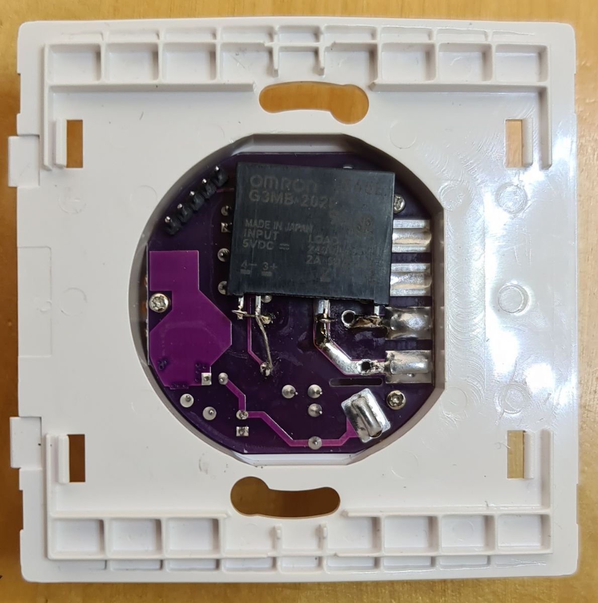

  • #71 21451532
    rk125
    To make switch quiet. With one relay it is pretty easy. SSR G3MB-202P, can get in packs of 5 in aliexpress, make sure it have 5V control voltage.
    View of an OMRON G3MB-202P electronic relay mounted on a PCB with a plastic base.
