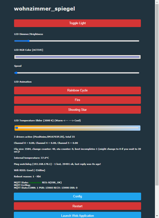

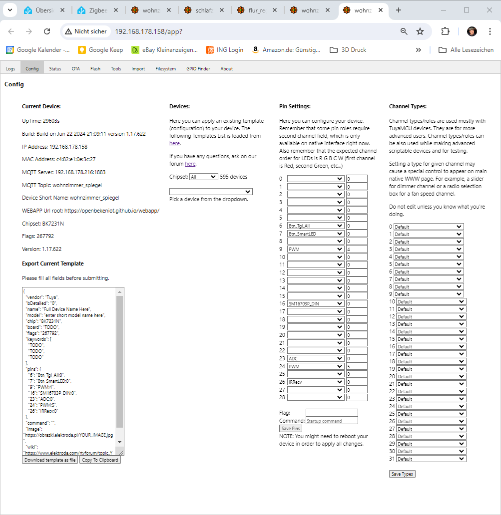

    So, after hours of try'n'error i bring it back to work!
    Don't ask me what i've done, can not say what brings it back. Speed option works clean.
    The only problem i have is:
    If i set first cw or ww and then activate the "Rainbow" effect this works but the white LEDs stays on. I have to activate RGB Mode first, then the white LEDs toggles to off.
    I think these should toggle off if RGB is toggle on.
    Now here are my actually settings.
    User interface for controlling LED lighting with various configuration options. Screenshot of the Tuya device configuration interface showing LED settings. Screenshot of a configuration file editor showing the file /autoexec.bat with saved start commands for drivers.
    I have no idea either, but it works ok now?

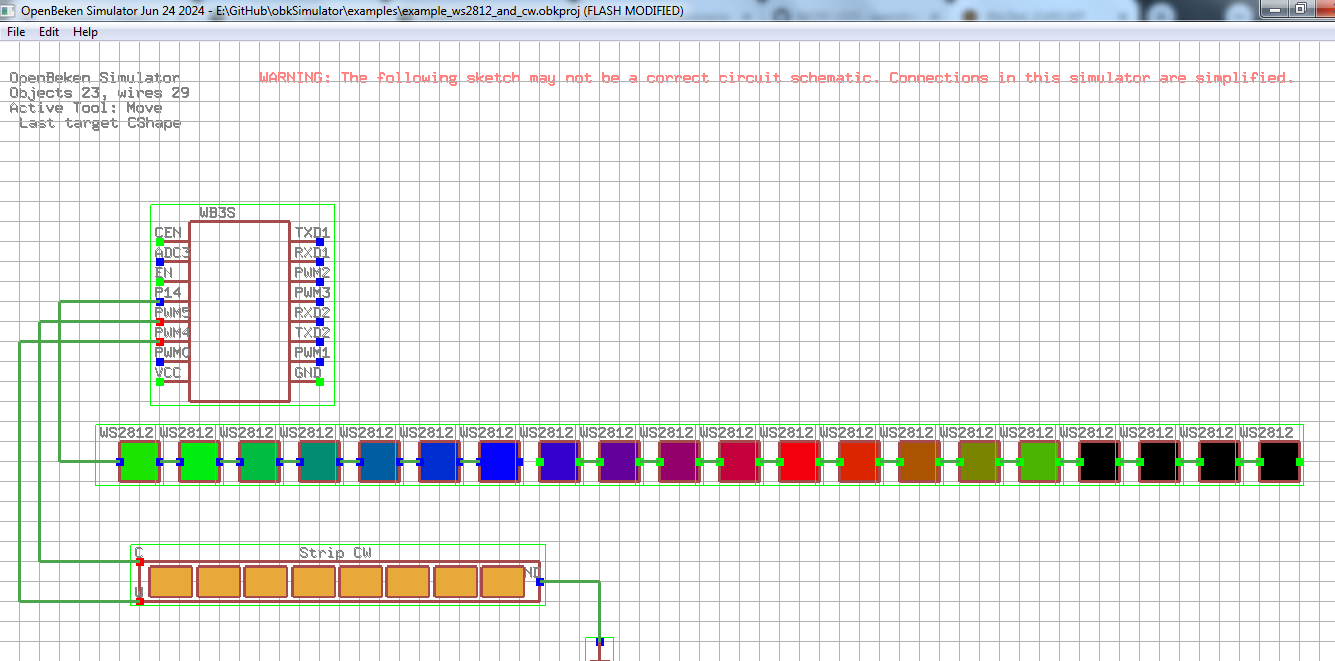

    Oops, you are right, sorry:
    Circuit simulation in OpenBeken with WS2812 LED strip.
    I will try to fix it now

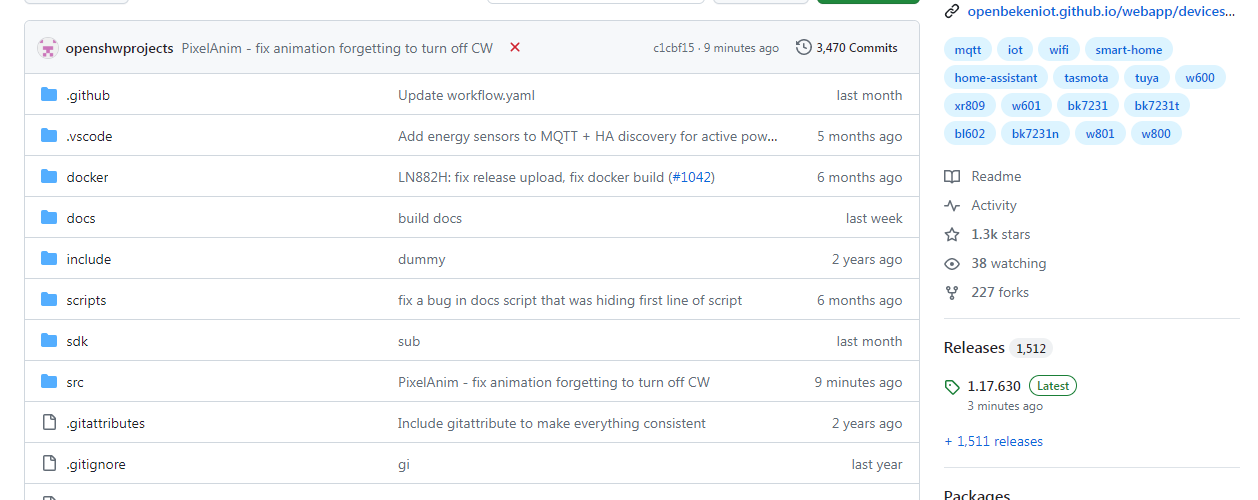

    Ok can you try latest version, do OTA?
    Screenshot of a GitHub repository page showing a list of folders and files for the openshwprojects project.

    I've made an OTA update to version 1.17.630, now it works with CW and WW, PWM 5 at Pin 24, PWM 4 at Pin 9 works for me. but if I will toggle off while PixelAnim is playing the LEDs stay on, only stop moving. to toggle off I have first set to RGB or white, then I can toggle off. it seems PixelAnim makes a pause because if I toggle on again the PixelAnim starts from the position it stops before.
    Maybe there is an error at my pins ?

    I see, one futher check was missing. Please OTA and retry, is the new version better?
  • #69 21140361
    marcolueck1976
    Posts: 32
    Perfect! I can find no errors, switch from everything to everything works perfectly with version 1.17.632.
    Thank you very much!

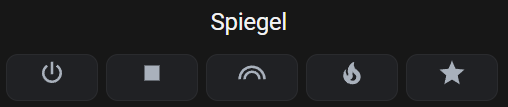

    cmnd/wohnzimmer_spiegel/Anim with payload 0, 1 or 2.
    This works fine for testing, can use all 3 effects and can toogle off/on in Homeassistant, great :-)
    User interface with five function icons.

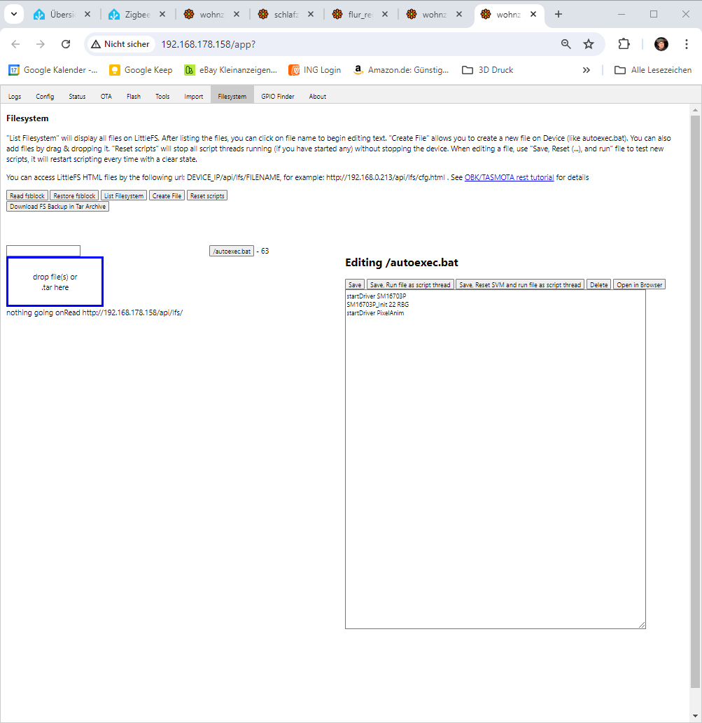

    Code: YAML
    Im think about buttons for brightness ans speed, what are there the options ?

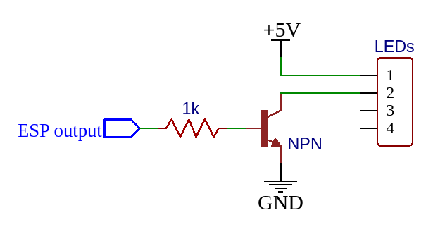

    Hi there! I'm testing with this strip and wled because I broke one controller.
    So I want to build a new controller with an esp8266 D1 mini.
    Colour is working perfect but I can't get the white channels working (gpio 12).
    If I connect the pins to the ESP (gpio 13 & 15) they are both on but I can not control them and the esp becomes very very warm.
    Do you have a tip for me ?
    Close-up of an LED strip with pins labeled with colors and descriptions: +24V VCC, D0, GND, CW, CC.
    Thank you !
    Greetings
    Marco

    You can't power C/W LEDs that way. You need to use the LED driver chips/transistors that were on the device PCB. Transistors are needed because ESP8266 does not have enough pin current capability (nor the voltage) to power such LEDs.
    Sample schematic from google (not verified, you may also need a pulldown):
    Circuit diagram with NPN transistor and LEDs.

    I threw it away :-(
  • #84 21177167
    Posts: 14611
    Help: 654
    Rate: 12623
    I think there are many cheap MOSFETs that could do the job, but they may often be in SMD package and you would need to solder it on a proto board.
