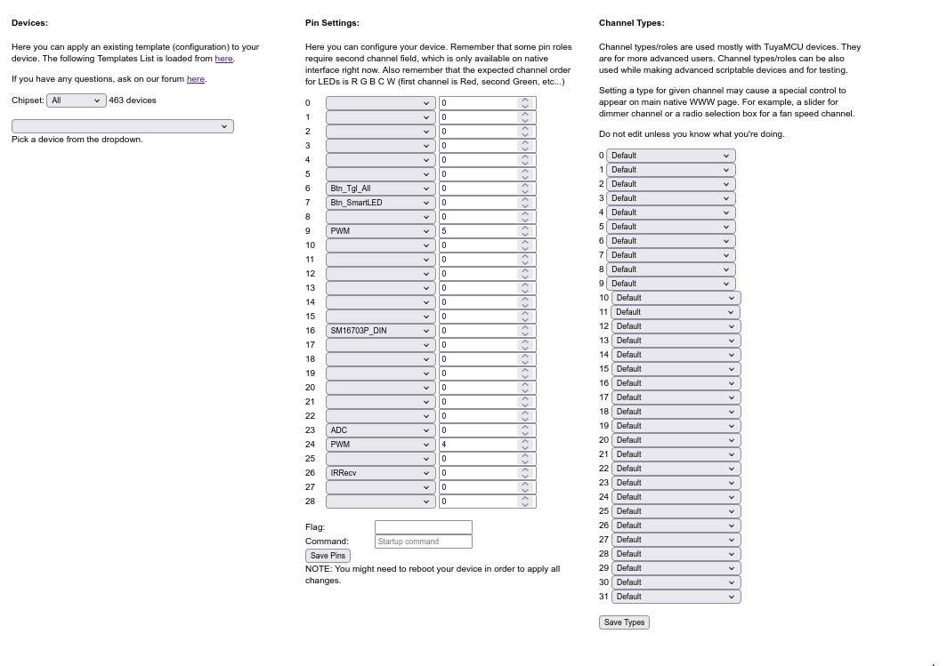

    alfakenzo
    Posts: 32

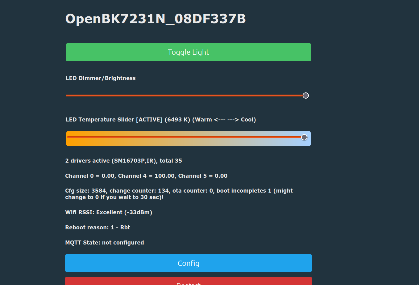

    I tried it with several things to get this running. I can now control the CW and CC and the Button on the PCB also toggle light but only PWM. I don't know where to set the digital input for the driver. I set it like Bacto thought on p16 but nothing happens with your script you wrote on another post. Here are some images to see how I set it.
    Screenshot of device pin settings and channel types. Screenshot of the OpenBK7231N interface showing LED light settings. Screenshot of a text editor with the autoexec.bat file open containing a control script.

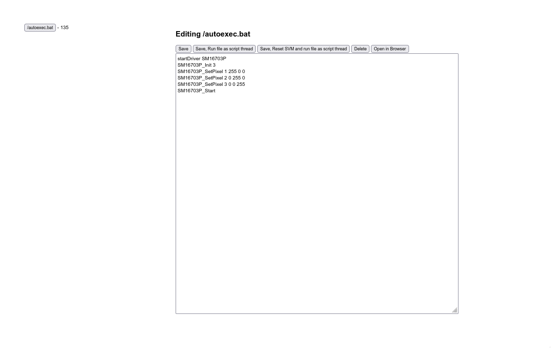

    Ok, I got it. It is sm16703p. I have colors on it.
    But how can I control the rest?
    One stripe is 6 LEDs.
    This is my autoexec.bat:
    startDriver SM16703P
    SM16703P_Init 120
    SM16703P_SetPixel 0 255 0 0
    SM16703P_SetPixel 1 0 0 255
    SM16703P_SetPixel 2 0 255 0
    SM16703P_Start
    So, how can I now set some runnings on it?

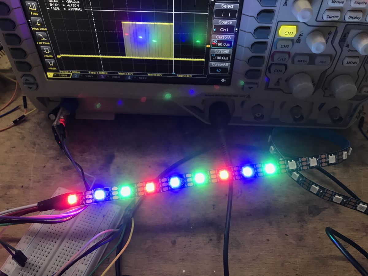

    #36 20894185
    Posts: 14750
    Rate: 12859
    I will add a patch today to firmware. I'm testing LEDs now.
    // start driver
    // use channel 10 as variable to store number of LEDs
    setChannel 10 9
    // initialize the driver
    SM16703P_Init $CH10
    // set iteration variable (channel 11)
    setChannel 11 0
    // loop setting R G B
    again:
    SM16703P_SetPixel $CH11 0 255 0
    addChannel 11 1
    SM16703P_SetPixel $CH11 0 0 255
    addChannel 11 1
    SM16703P_SetPixel $CH11 255 0 0
    addChannel 11 1
    if $CH11<$CH10 then goto again
    // apply changes
    SM16703P_Start

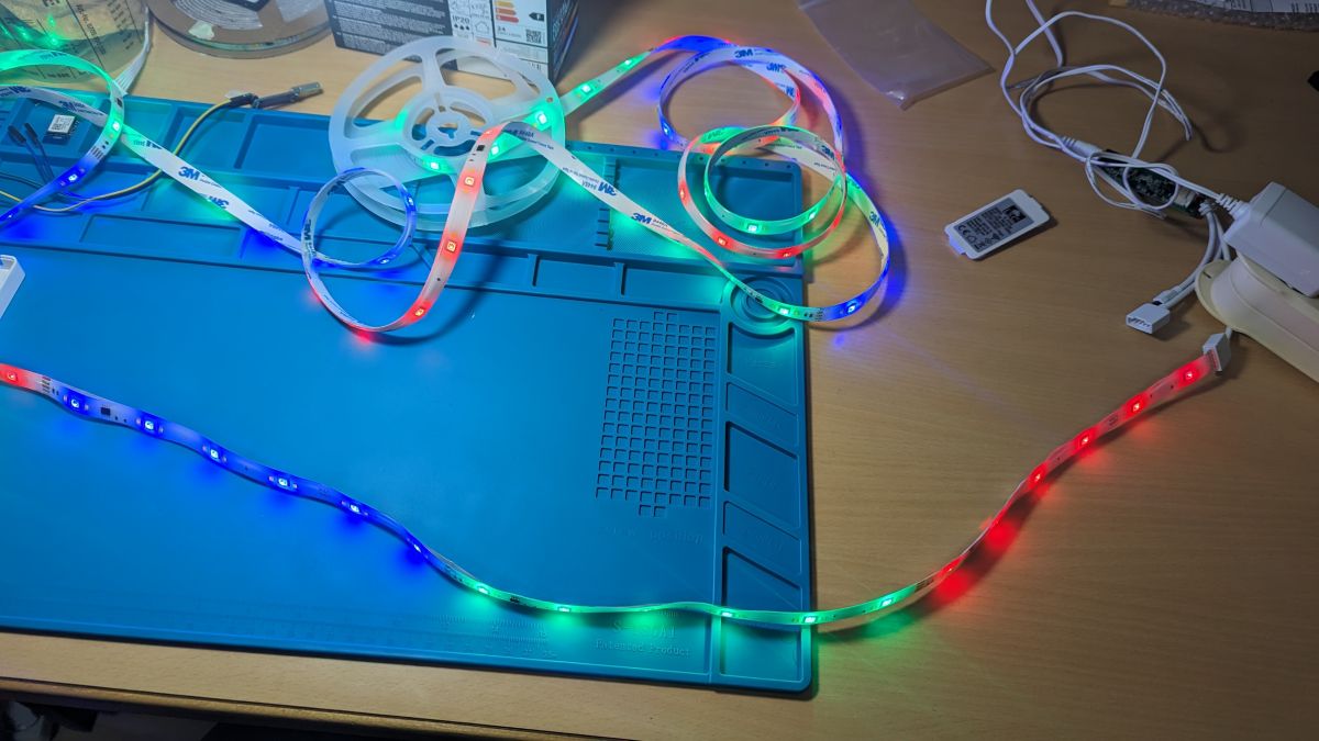

    alfakenzo
    Posts: 32
    I tried to set up your script. Now my device isn't connected to the Wi-Fi anymore. I want to reset it, but it failed. I can only connect in safe mode on 192.168.4.1, but I can't reset the autoexec.bat. Is there a command for that?
    OK, lfs_format did it for me :) Nice to know this option now, and it is added in the FAQ.
    I added the script again and changed the colors for my strip, and now it works. But I still have 6 LEDs in one color.

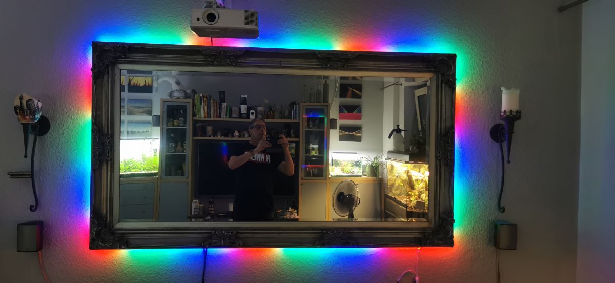

  • #44 21131008
    marcolueck1976
    Posts: 32
    Looks good for the first time!
    Mirror with colorful LED backlighting on the wall.
  • #45 21131094

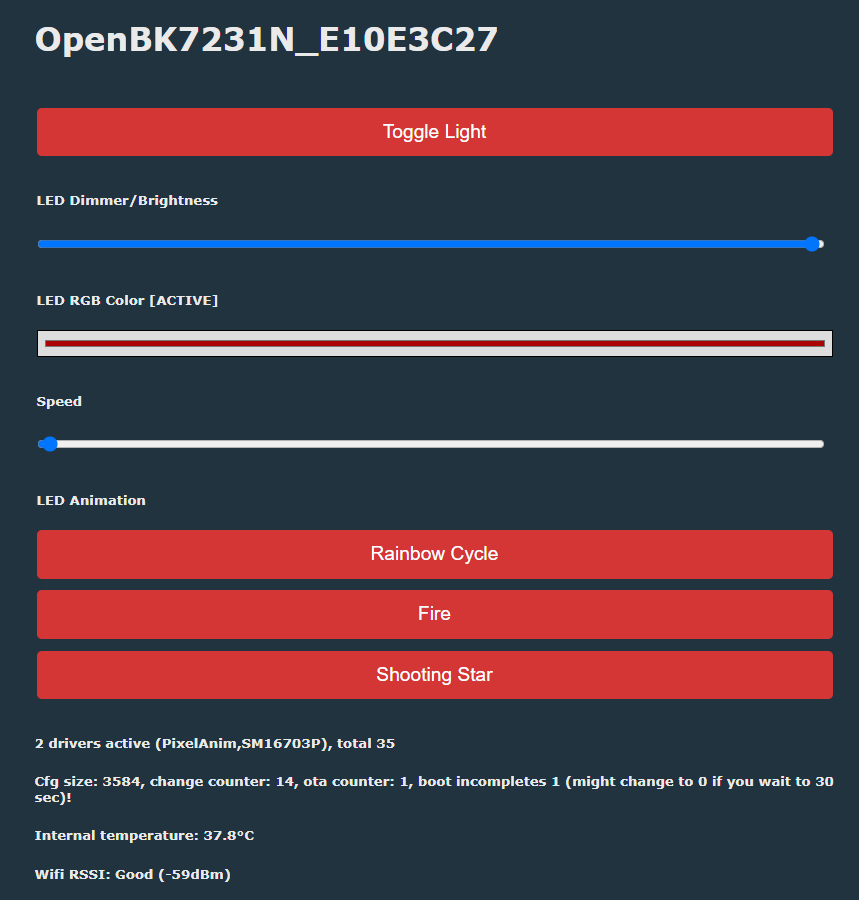

    Posts: 32

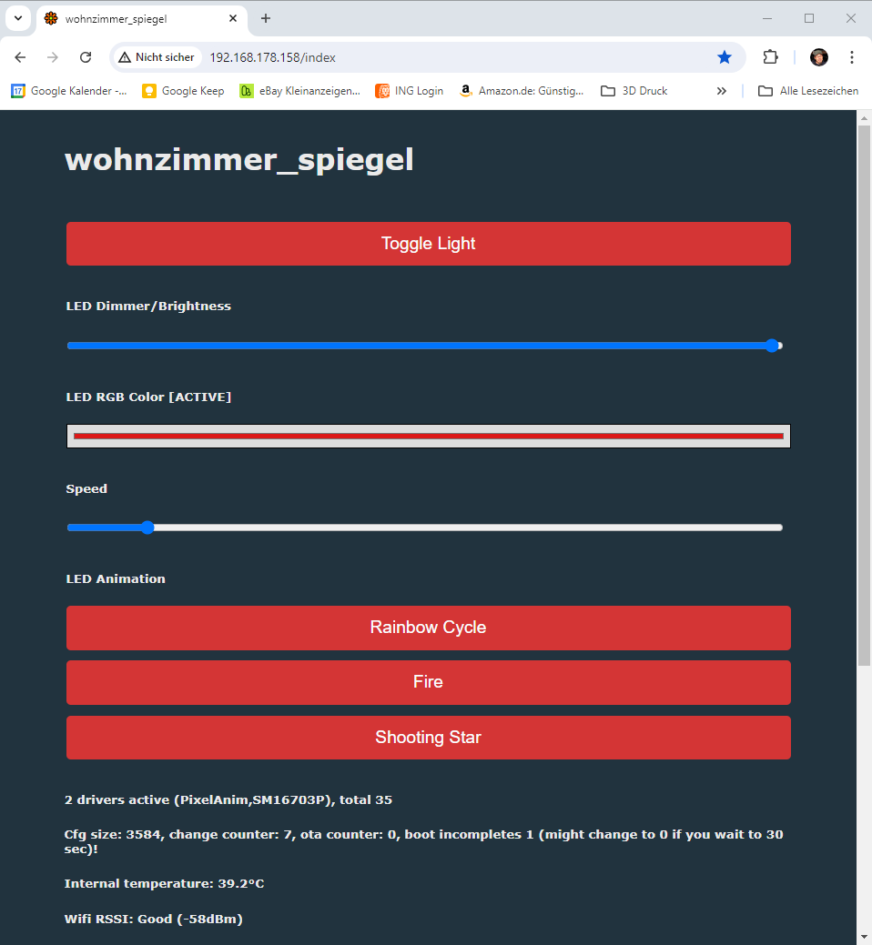

    >>21131171 OpenBK7231N software interface with LED control options.
    Before it stops working i played with the "Speed" Option from Shootingstar.
  • #51 21131200
    Posts: 14750
    Rate: 12859
    It should work after full power off/on. Then you can tell me what kind of setting can crash LEDs so I can prevent it. @divadiow , are you able to crash the driver as well?

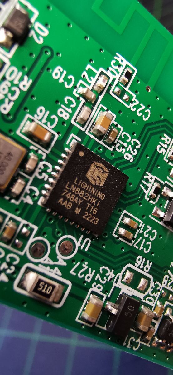

    Good morning :-)
    So i would like to try flashing the new Stripe, opend it an saw there iss a other Chip inside. Now im confused at all...
    A circuit board with a chip labeled LIGHTNING LNB82HK1. Electronic circuit board with various components on a green grid background. Green printed circuit board with technical labels.
  • #57 21132609
    Posts: 5201
    Help: 446
    Rate: 914
    morning. that's exciting. OpenBeken supports Lightning Semiconductor LN882H chips, but the PixelAnim and SM16703P drivers won't be present or tested.
    I don't understand why your other one stopped working...
  • #58 21132614

  • #60 21132674
    marcolueck1976
    Posts: 32
    >>21132640
    divadiow wrote:
    - your original device boots into OpenBeken and you can access the web gui?
    yes
    divadiow wrote:
    - pixelanim and SM16703P drivers are showing as running on the main page?
    yes
    divadiow wrote:
    - does toggling the power button and/or the animations buttons turn them green from red or do they stay red?
    nothing happens, stays "off"
