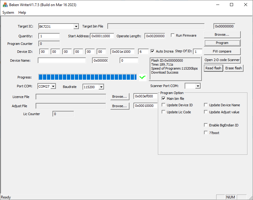

    dump of shipped firmware using BK Writer 1.75
    Screenshot of Beken Writer V1.75 software used for firmware updates.
    Screenshot showing Wi-Fi network name HLK-B30_8D48 with a padlock icon.
    • bk7231s_dump-2024- 4-16-16-56-44.bin (2 MB) You must be logged in to download this attachment.

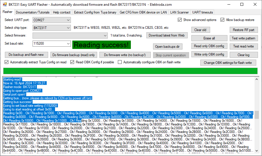

    and a dump using BK Easy Flasher T chip type
    Screenshot of BK7231 Easy UART Flasher software with reading success.
    • readResult_BK7231T_QIO_2024-16-4-17-22-36.bin (2 MB) You must be logged in to download this attachment.

    it should be noted that the BKWriter dump is junk and has partitions in the wrong place or something. BK Easy Flasher dump is OK. I will try flashing back soon.

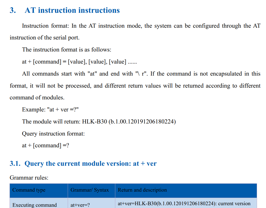

    Does it come with AT command line flashed?
    I have not explored this either. I will
    Added after 15 [minutes]:
    hang on. yes, it must. half the HLK-B30 PDF from Hi-Link goes on about it in relation to whatever the image is they ship these with
    Screenshot of Hi-Link documentation showing AT instructions and an example of querying the module version.

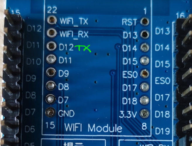

    hi-link factory dev fw (dump in previous post) boot log - D12 = TX log output
    Close-up of a WiFi module with pins, one marked as D12 TX.
    OpenBeken for T just boot loops with
    Added after 37 [minutes]:
    are you able to back original
    Yes. Original fw dump flashes back and boots after erase/flash OBK-T

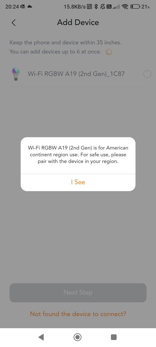

    thanks. I have flashed your dump and the HLK-B30 has booted!
    Added after 12 [minutes]:
    can't find any bluetooth or wifi AP after several resets, which I was hoping would put it in pairing mode. I'm using the Arnoo app too
    Added after 21 [minutes]:
    Ah. AiDot app finds it
    Device addition screen with a message about regional restriction for the Wi-Fi RGBW A19 (2nd Gen) bulb.
