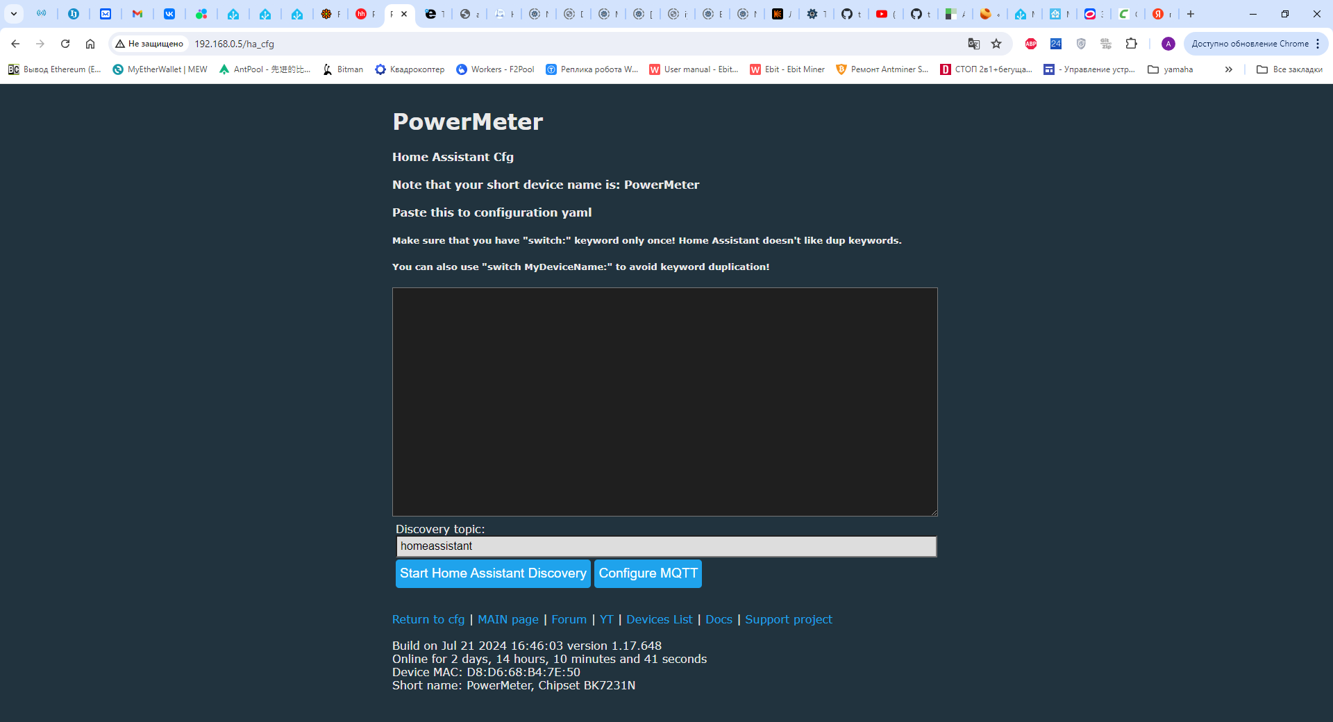

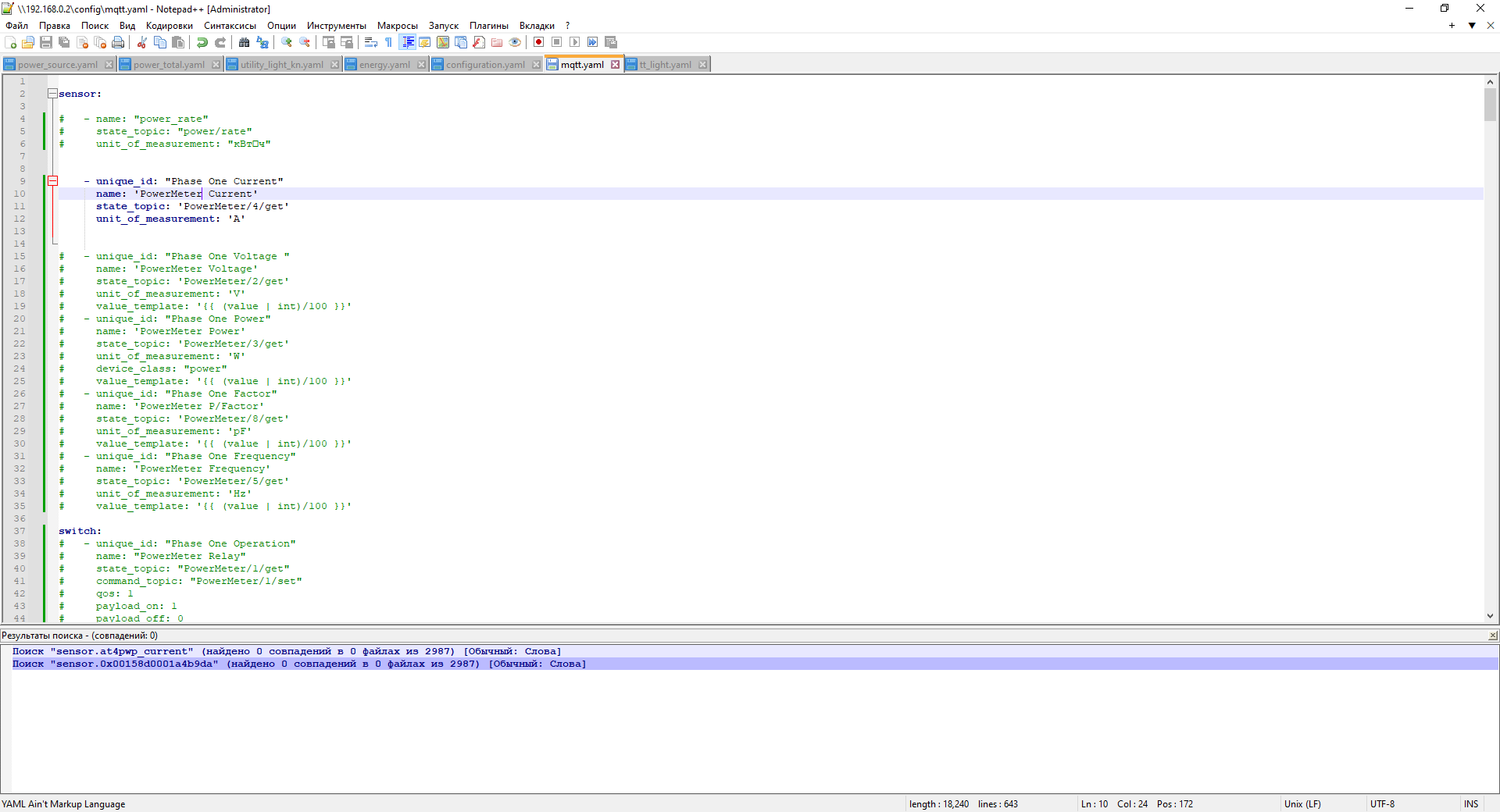

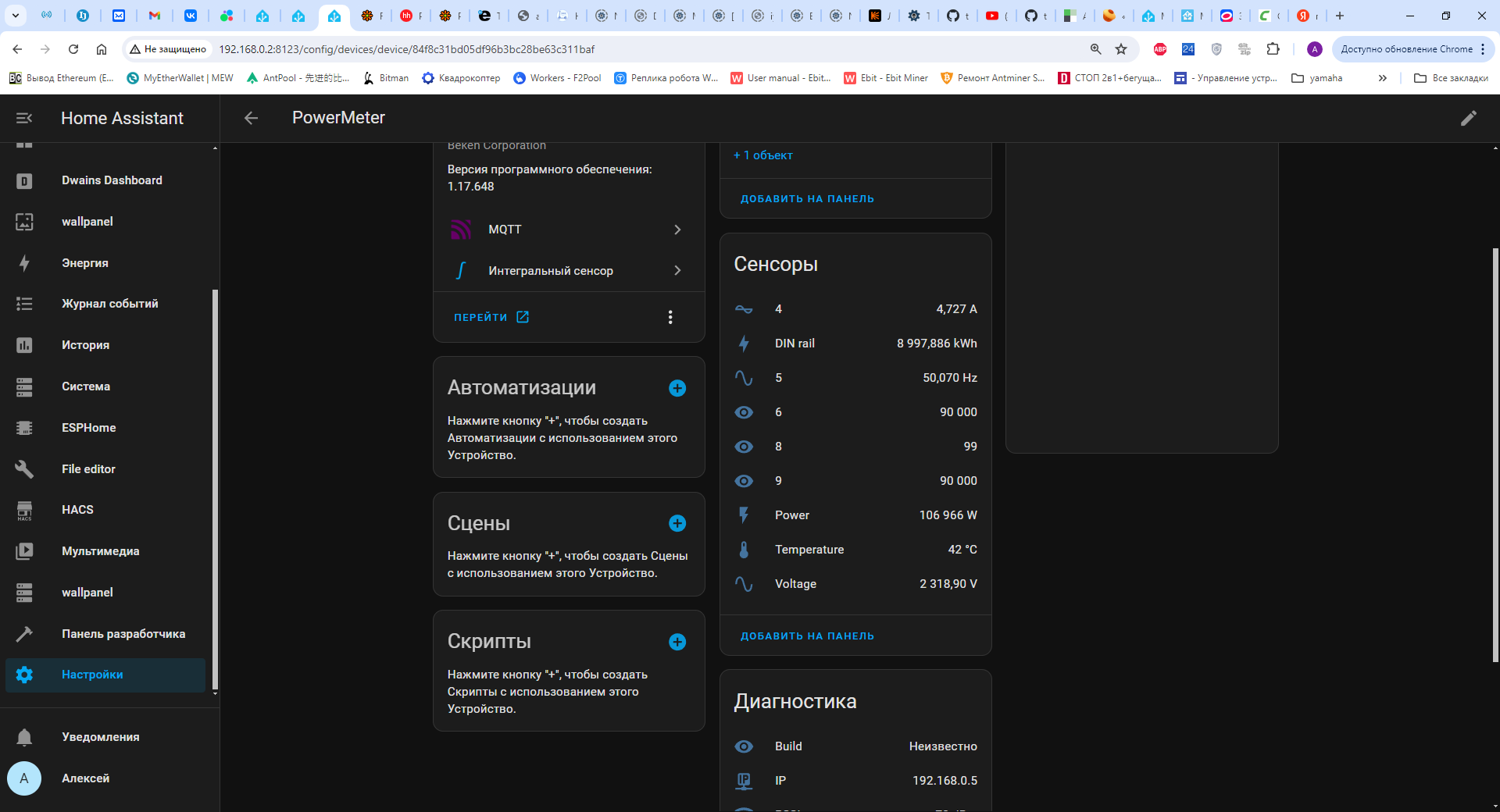

  • Different web UI after flashing Wi-Fi module
    #33 21169725
    pogadaevalecsey
    Posts: 32
    I also bought this device, flashed the Wi-Fi module. added the autoexec.bat. file from the forum. I tried adding lines both to the config file and to a separate Mqtt file, but my window looks different. Screenshot of the Home Assistant user interface showing the PowerMeter device overview. Screenshot of Notepad++ text editor with an open YAML configuration file. Screenshot of PowerMeter interface with Home Assistant configuration options. Screenshot of a browser file editor showing the editing of an autoexec.bat file.
  • Do Discovery for Home Assistant configuration
    #34 21177098
    Posts: 14771
    Rate: 12914
    duycaf wrote:
    @p.kaczmarek2 I didn't do anything to it, so it's just original tuya firmware 1.09
    I had some problem with wifi, remove the device from tuya app and now I am not able to add it again.
    I really like it and I would like to make it work again.
    Disconnect it from power. Wait 5 minutes. Reconnect power. Try to RESET it. If it still does not pair, try reflash 2MB backup (if you have). If still not working, then you most likely have to flash OBK...
    The textfield on screenshot I quoted is not used now for HA configuration. You just need to click "Do Discovery". Please check if that helps, if not, please provide more information about your issue. I will try to help.
  • #35 21177355
    pogadaevalecsey
    Posts: 32
    Thank you for your hard work. the device is working fine, some data points are not displayed correctly in HA. what are the correct flags to set? and is there no such function as the backlog startDriver BL0937 for this device. and one more question, how to set up automatic firmware updates for devices.
