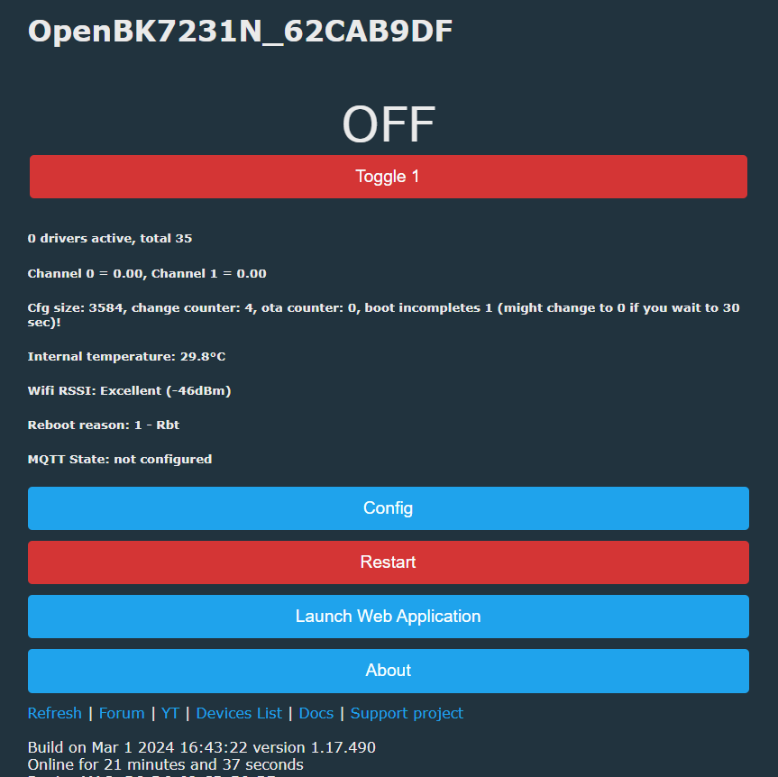

    ok, successfully flashed the firmware.
    OpenBK7231N control panel with status information and configuration options. Screenshot displaying settings of various parameters and their numerical values.
    Now what?
    should I go ahead and remove the wires and re-assemble?
    How/where do I see energy monitoring?
    Sorry, I'm new with these.
    Please advise.

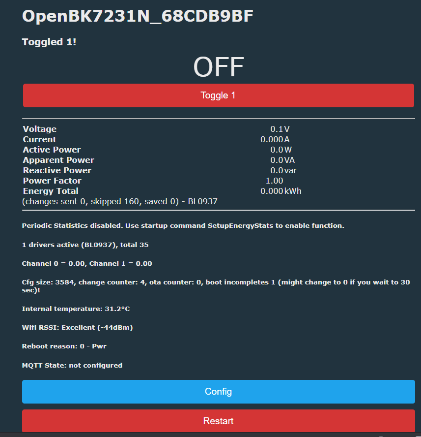

    Update.
    Not sure what happened, but it now shows power monitoring.
    OpenBK7231N user interface displaying device status and monitoring information.
    Maybe the power monitor driver wasn't running. Did you reboot and it came up after?
    Advian1 wrote:
    One question, is there any built in timer? or I need app/mqtt to do that?
    you can get date and time by adding startdriver NTP to your startup command list

    Thanks. Yes, the driver wasn't running for some reason, even after reboot.
    Now it starts fine. No idea what was wrong.

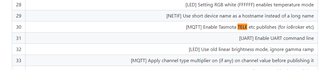

  • #40 21031790
    mugginsjm
    Posts: 9
    Hi I have just managed to re-purpose this device and have been reading the numerous help files. It's all a bit bewildering. I was hoping to emulate Tasmota (I have many of these devices) This Beken plug just swamps me with MQTT power information. I simply want by MQTT to power on/off (which I can do) and to get power consumption on request.
    thanks
  • #41 21031836
    Posts: 14796
    Rate: 12953

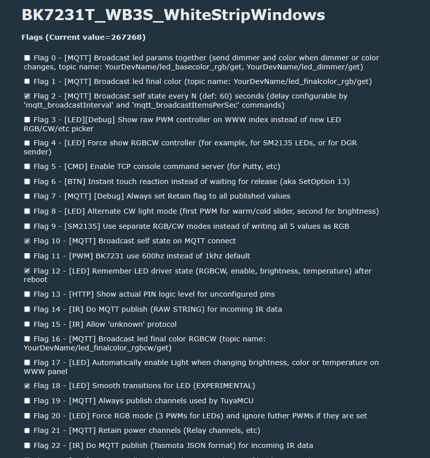

    Hello, have you tried flag 30? It may not be perfect but this will add a bit more of Tasmota format:
    Screenshot of documentation on flags in the OpenBK7231T_App project, showing descriptions of various options including Option 30 for Tasmota TELE.
    Added after 9 [seconds]:
    https://github.com/openshwprojects/OpenBK7231T_App/blob/main/docs/flags.md
  • #42 21031855
    mugginsjm
    Posts: 9
    Thanks for that, but this project is HUGE.... where do I access this flag menu

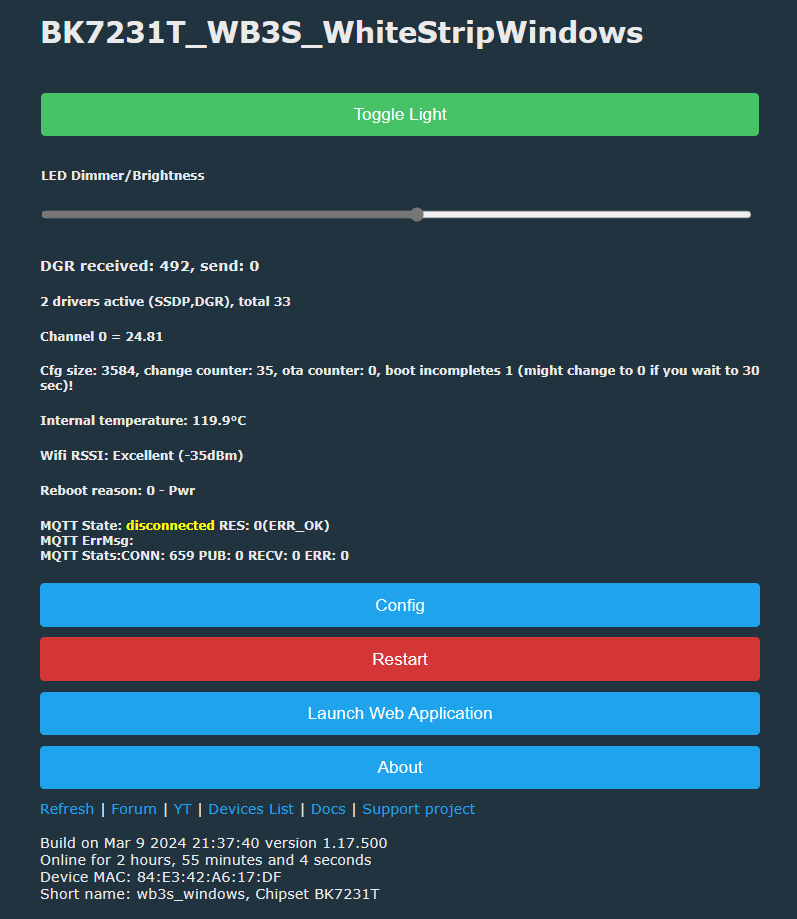

    In order to access OpenBeken flags menu, first open your device web panel:
    Screenshot of the BK7231T device control panel with configuration options.

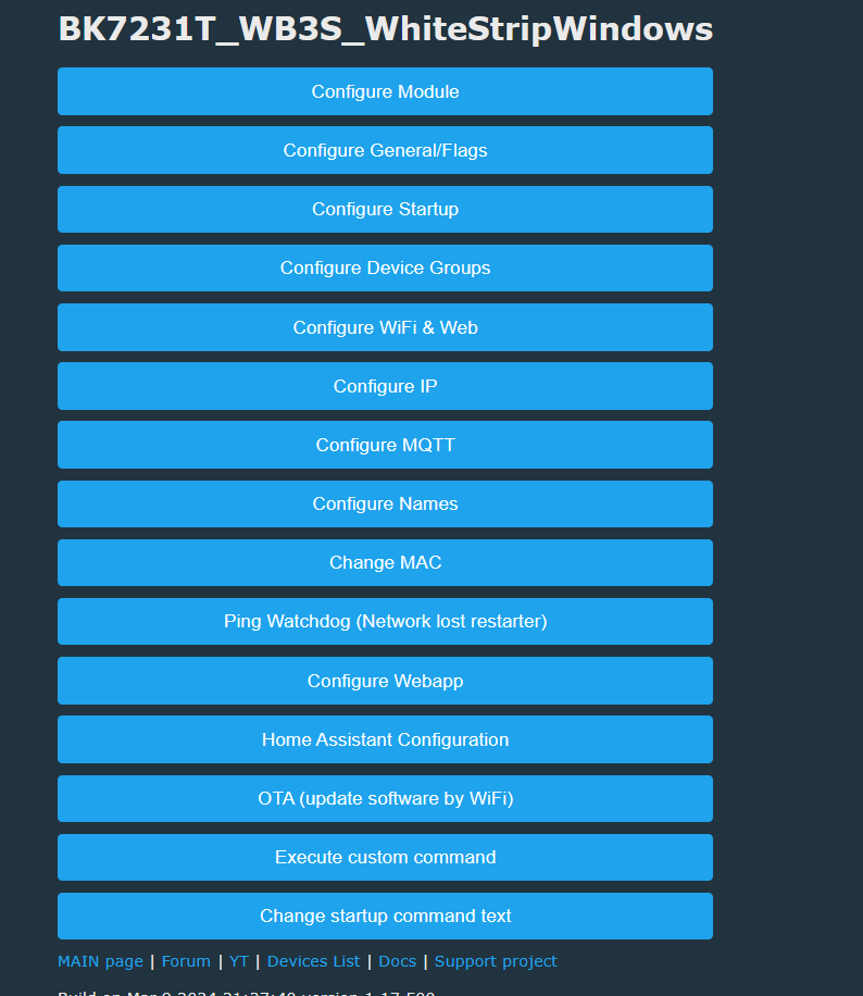

    Then open Config tab:
    Screenshot of the OpenBeken management panel with a list of configuration options.
    Finally, clicking on the "Configure General/Flags" will open a flags menu for you:
    Configuration flag list for the BK7231T_WB3S_WhiteStripWindows device.

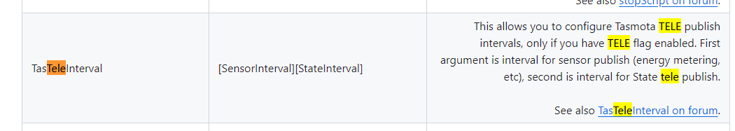

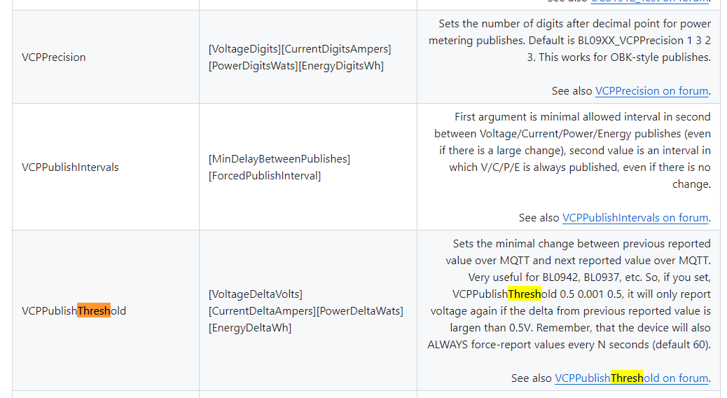

  • Commands to reduce MQTT publish frequency
    #47 21031976
    Posts: 14796
    Rate: 12953
    If you want to reduce the number of MQTT publishes, you can refer to our commands documentation:
    There are some related commands for those purposes:
    Documentation table for MQTT commands highlighting VCP settings.
    There is also a command for TELE: TasTeleInterval
    Table showing configuration commands for TasTeleInterval in Tasmota.
    You can try all those commands out, however, I am not sure how much they will be useful for you. You are basically the first person who reports that publishes are done too often, usually users just don't care about that.

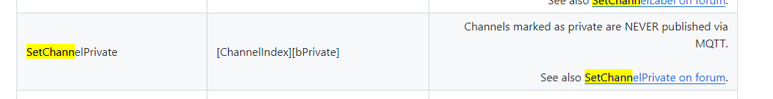

    Rate: 12953
    I'm happy to help whenever it's needed, you can also look into SetChannelPrivate command that can be run in autoexec.bat:
    Screenshot of a table with the SetChannelPrivate command highlighted in yellow.
