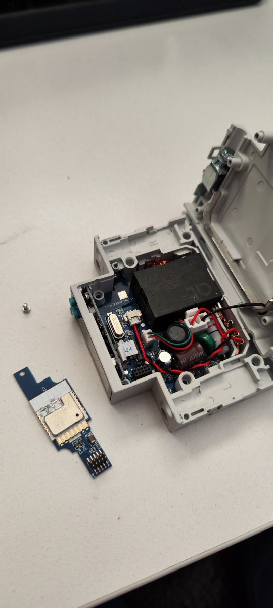

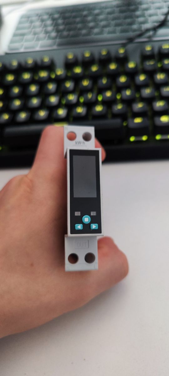

  • Hello everyone, I recently bought this fuse in DIN format with the option of measuring kWh consumption. This is the TO-Q-SYS-JWT model, a version similar to TO-Q-SY1-JWT, but with a built-in display where you can make changes to the fuse settings (undervoltage, overvoltage, temperature, power protection, etc.). In the photo below we can see the device (the front itself after the disassembly phase).
    DIN fuse with display, held in hand, against a keyboard background.
    I looked on the forum for this fuse model, but to no avail (it`s a total novelty on the forum, so I decided to write this entry).

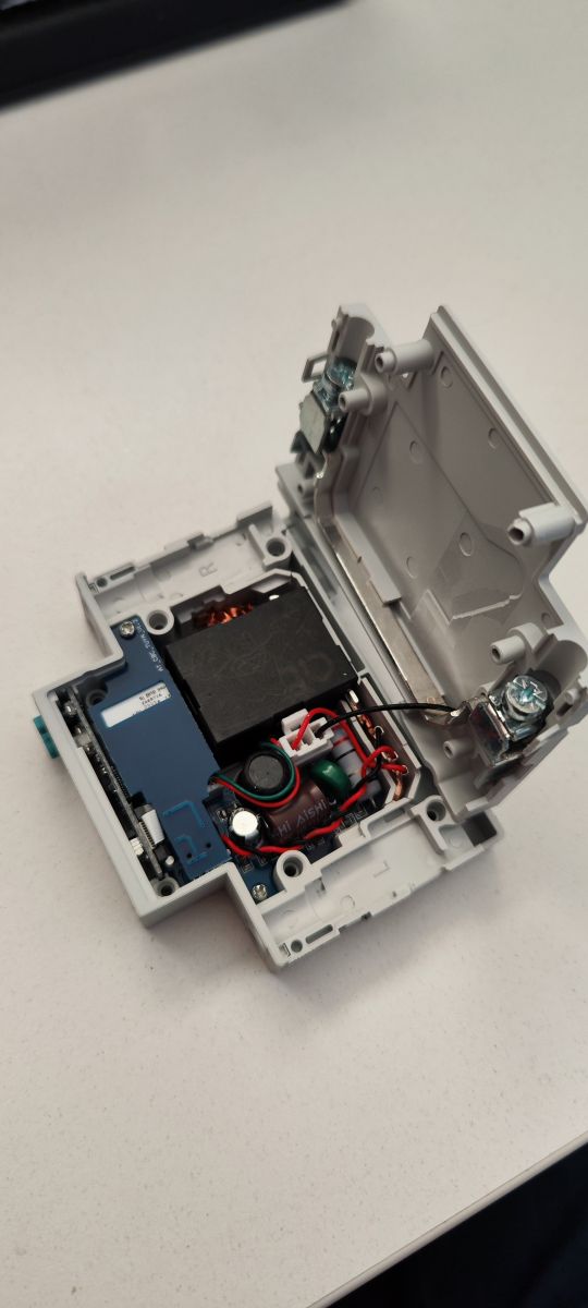

    Let`s start from the basics, to disassemble the fuse itself, you need to "pick out" the metal pins that hold it together (there are six of them and the side we start from is not important because it is important to bend the edge of the pin inward and then gently knock out the rod), I am writing about this step because I was looking for quite a long time how to disassemble this type of MCB fuse. Once we have removed all the rods (they are gold, so they are easy to see), gently pry off the latches visible on the top of the housing. After these steps, you should now have the MCB switch open.

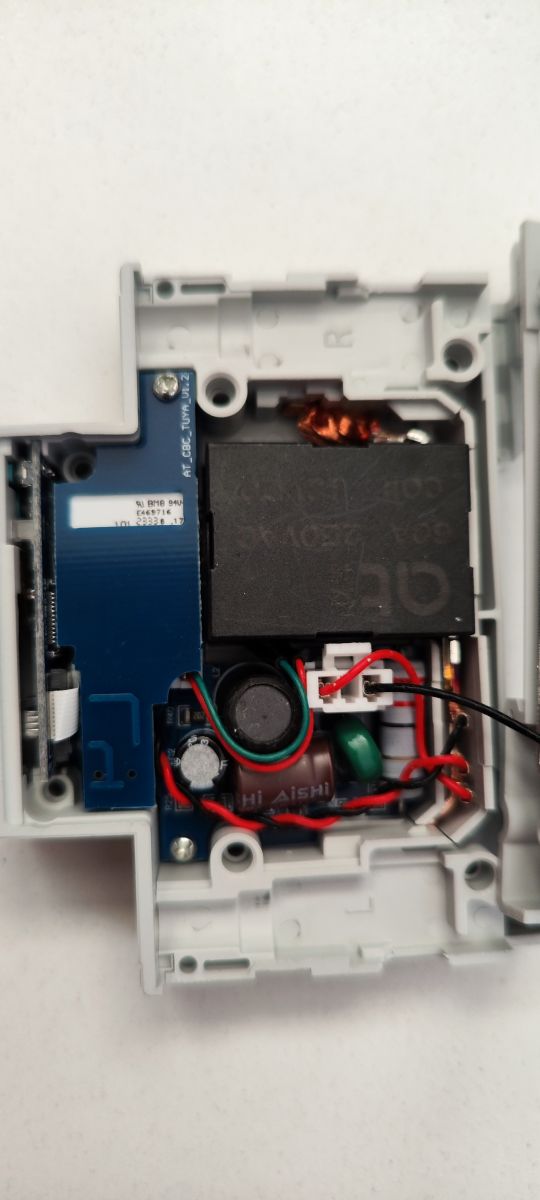

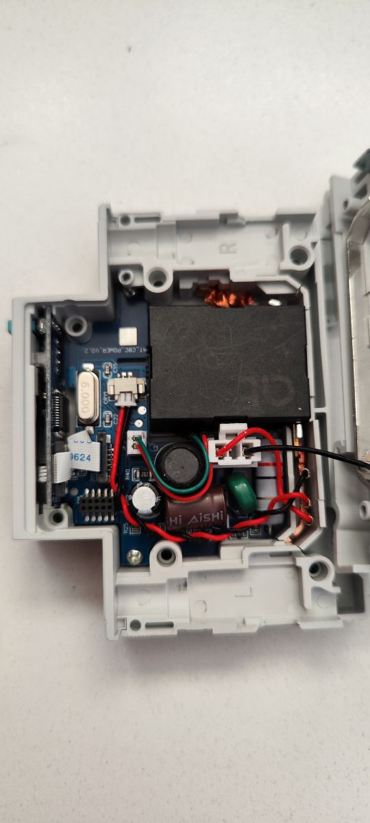

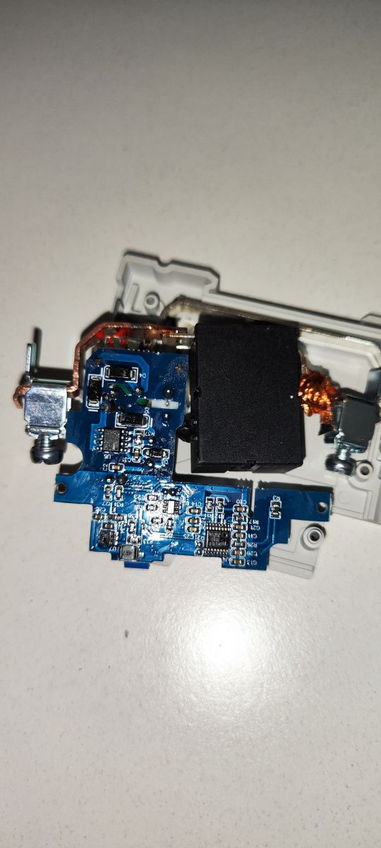

    Now let`s move on to the most interesting stage, i.e. the interior, which looks like this:
    Open DIN circuit breaker with visible electronic components Interior of a disassembled DIN circuit breaker with electronic components.
    We can see here (as I assume correctly, a 60A 250V relay from "AT"[?]) and quite tightly packed integrated circuits. The whole thing consists of three PCB boards. The first one can be easily removed by unscrewing the screw in the upper right corner of the PCB (with the left side of the MCB facing us). After removing it, the whole thing looks like this:
    Open relay with visible electronics inside the housing. Interior view of a DIN format circuit breaker with visible components.

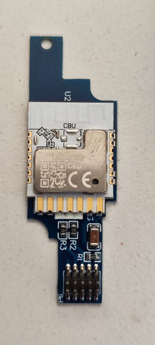

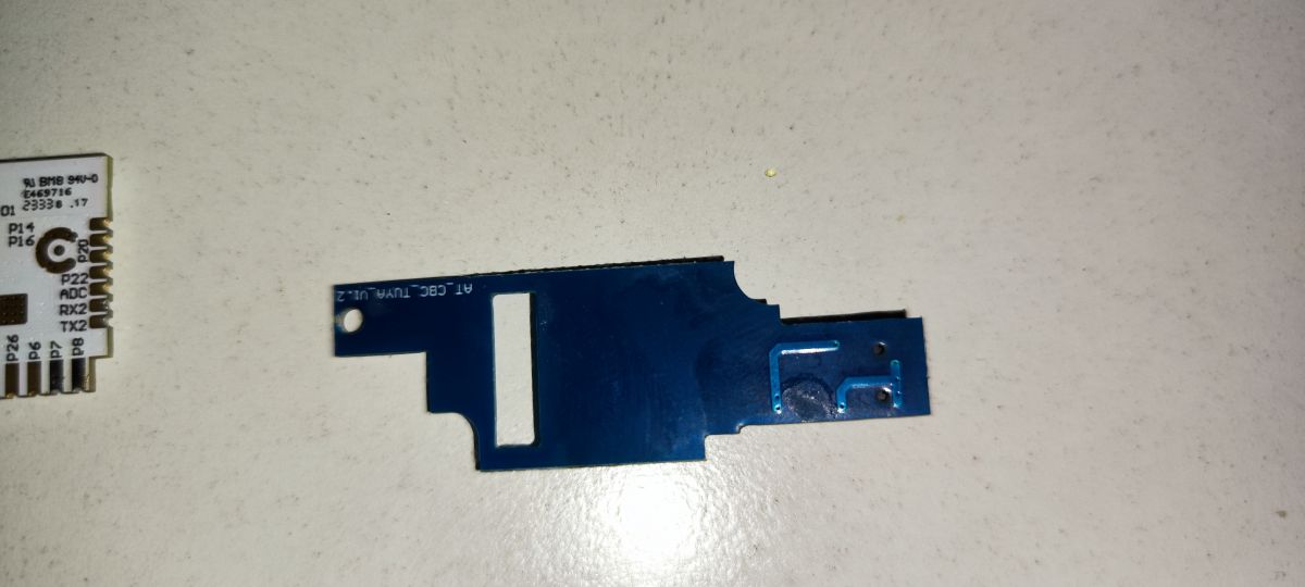

    The board that comes out first is the one that interests us the most because it is responsible for WiFi connectivity. In fact, we could stop at this stage of disassembling the MCB, but since this device is not available on the forum yet, we will take a closer look inside.
    The BK7231N board itself looks like this:
    WiFi module BK7231N on a blue PCB with several components.

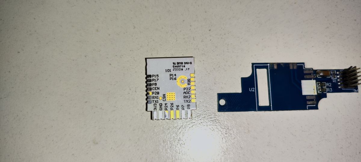

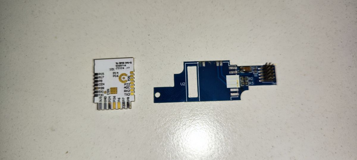

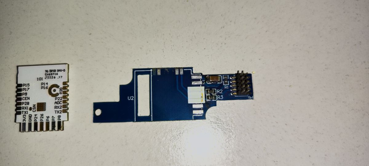

    In order to upload the OpenBeken software, I had to unsolder the white board from the blue board, which actually only connects the E469716 board with the rest of the MCB. Everything after desoldering looks like this:
    Two PCB boards with the BK7231N module viewed from above. Two PCB boards, one white with pin labels, the other blue with electronic components. Close-up of two PCB boards, one white with pin markings and another blue with U2 connector. PCB boards related to the MCB fuse.

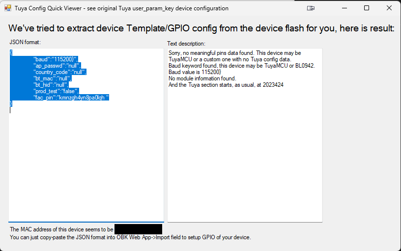

    The board with the WiFi module seems to be a normal board, but after reading the software we will get the following result of the tuya config analysis:
    Screenshot from Tuya Config Quick Viewer showing device configuration.

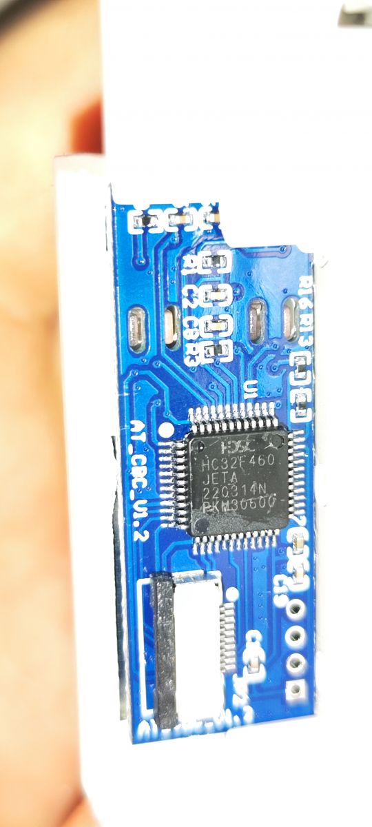

    The flashing software suggests that it is probably TuyaMCU, but I do not agree with this conclusion, such a poor config is simply due to the fact that the WiFi module is only responsible for communication with WiFi and data transfer in this MCB, it does not directly control anything and he only performs (or rather delegates) the tasks entrusted to him through commands. These tasks are transferred to the HC32F460 microcontroller, which is located on the board with the display (OLED?) and controls it. The display board looks like this:
    Circuit board with HC32F460 chip on a blue background.
    HC32F460 is apparently a clone of the more famous stm32f103c8t6 and according to the datasheet it has i2c connectors for communication with an OLED display or other peripherals (of course, there are many more protocols and I am mentioning the ones that concern us here), and a UART bus which is used to communicate with WiFi module (baudrate is probably 115200 because it is set in the WiFi module configuration, but I may be wrong and it concerns something else). The uC itself also has a built-in EEPROM memory, so there are no EEPROM chips on the other boards (probably not, as I wasn`t able to read the markings of one of the chips on the PCB - photo below).
    Close-up of a PCB with electronic components.

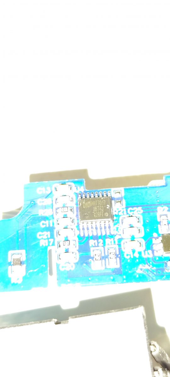

    The second die that we can find on the board (HT7017?):
    Close-up of a PCB with an HT7017 integrated circuit.
    This die looks like a die measuring energy consumption.

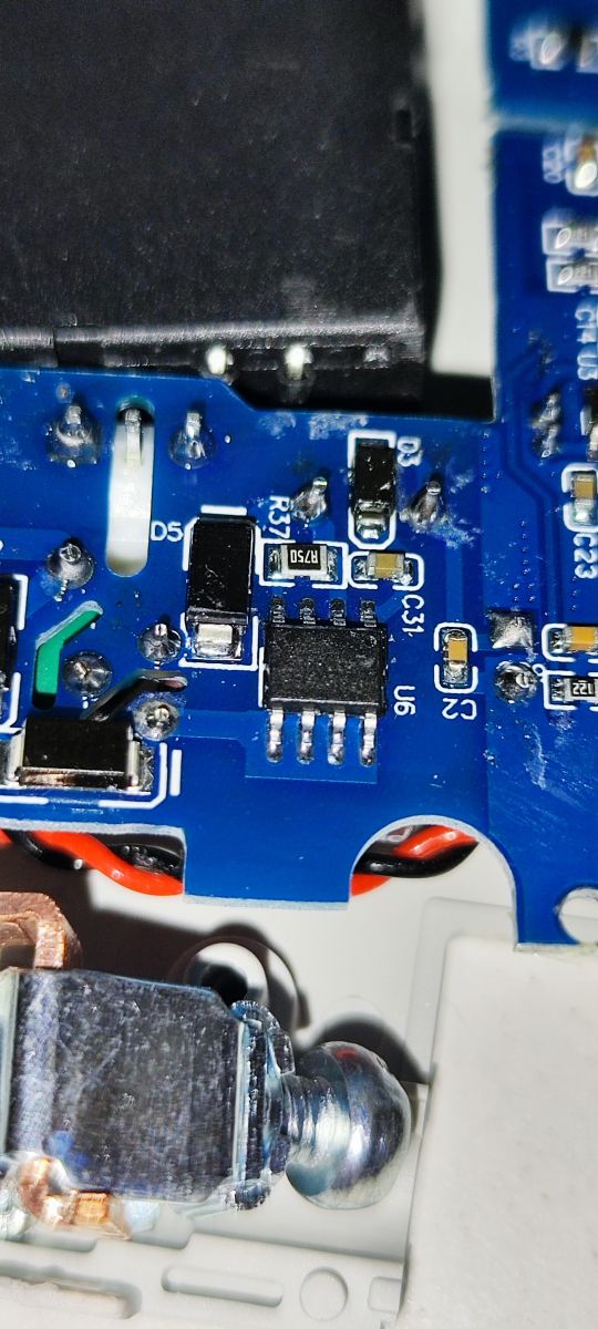

    I will add one more interesting fact... the relays in these devices are probably bistable - there is an interesting full-bridge circuit for controlling the relay in the sot23-6 housing - I have something similar in the phase selector - I think this is an advantage, in static operation they do not consume current - check if the logic turns off the relay when the power is turned off, there is enough energy in the selector for this.
    In the SO8 housing you have a DC/DC converter, the main power supply is probably 12V, in the part with the measuring system there is a second converter for 3.3V logic power supply.
    Generally, there are more and more of this type of Chinese inventions.

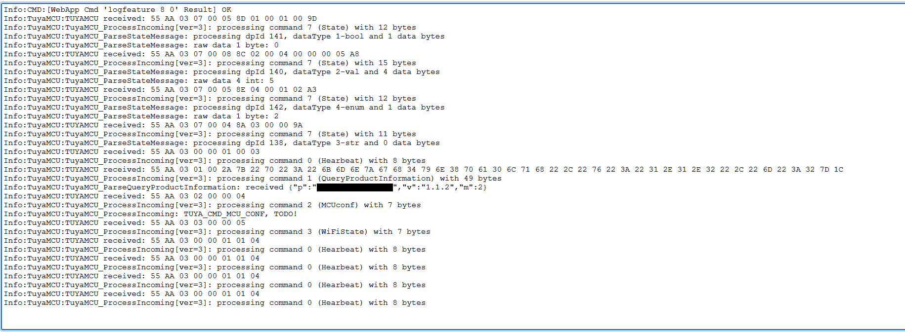

  • TuyaMCU dpId identified from console output
    #11 20938576
    Selfdrivers
    Posts: 35
    Rate: 12

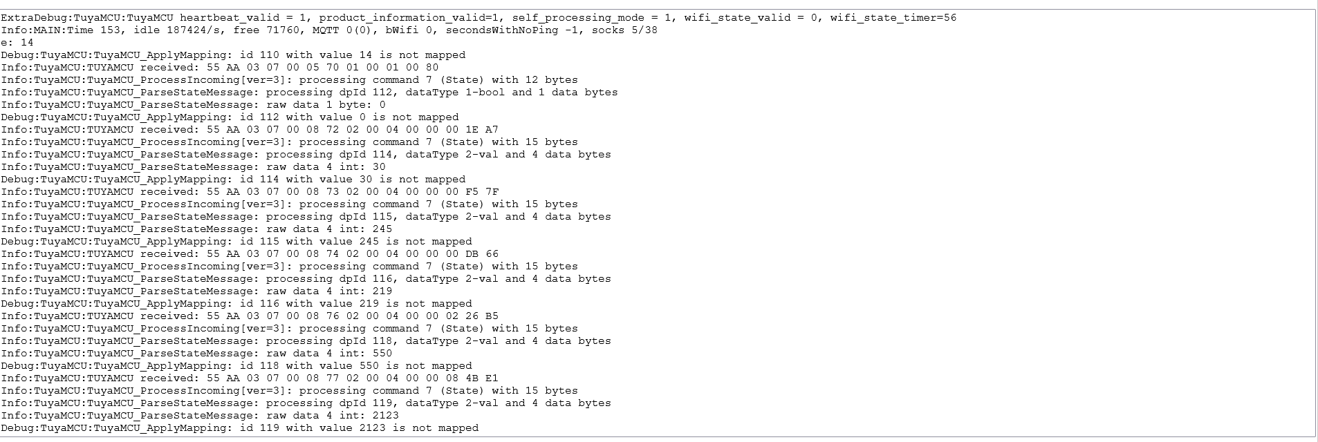

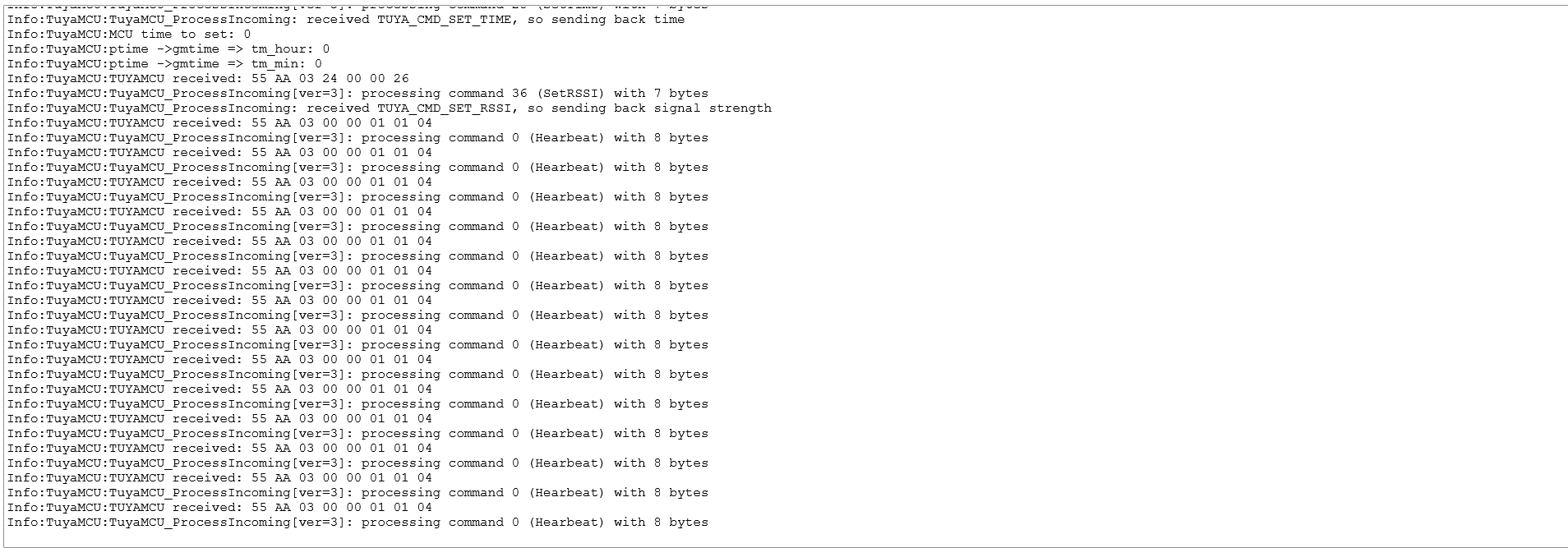

    Console logs related to TuyaMCU startup and command processing.

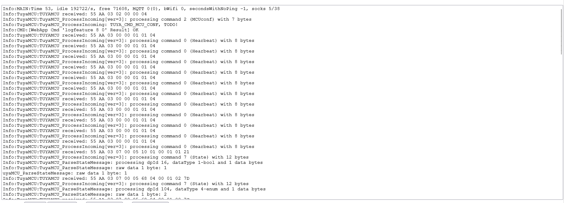

    This is what I received in the console after starting TuyaMCU (I completely forgot about it yesterday when I wrote the post), it looks like the dpId is given in the above message (I just read your post about TuyaMCU and played around with it), so far I`m trying unsuccessfully to at least drive the relay to it worked as it should (on/off). When it comes to setting the WiFi status, the above commands actually configured the WiFi status correctly (it is now ON). As soon as I manage to work out/determine something, I will write it.
    I`m also planning to buy a few new IoT devices for smathome in the near future, so maybe I`ll be able to add something new, it will always lead to some further development of the project, which I greatly respect and admire and would like to contribute to it to some extent. :) .
  • Relay control via dpID 141 bool mapping
    #12 20938603
    Posts: 14771
    Rate: 12914
    Post all IoT devices you have, but please do not duplicate existing topics, we want to reach 500 devices soon:
    I`m afraid to check how many of them are my topics. I`m sure I broke some record here.
    Your screenshot shows that communication is working, although I don`t like the situation with dpID 138 followed by "35 unwanted non-header bytes", could there be an error in the parser? Or maybe it`s a one-off disruption? For this reason, it is sometimes worth intercepting communication using the original firmware, but maybe we can do it without it.
    However, dpID 141 of the boolean type can be a relay.
    If so, the new autoexec.bat looks like:
    // Start TuyaMCu driver
    startDriver TuyaMCU
    // set TuyaMCU baud rate
    tuyaMcu_setBaudRate 115200
    // set TuyaMCU default wifi state 0x04, which means "paired",
    // because some TuyaMCU MCUs will not report all data
    // unless they think they are connected to cloud
    tuyaMcu_defWiFiState 4
    // set channel types for OBK GUI (and Hass Discovery)
    setChannelType 1 toggle
    // linkTuyaMCUOutputToChannel dpId verType tgChannel
    linkTuyaMCUOutputToChannel 141 bool 1
    While dpID 141 of the bool type is actually the state of the relay, and the WiFi module can change the state of the relay (no, it is somehow read-only), the above code should allow you to control this relay from the OBK panel. After performing HASS discovery, there should also be control from the HA level.

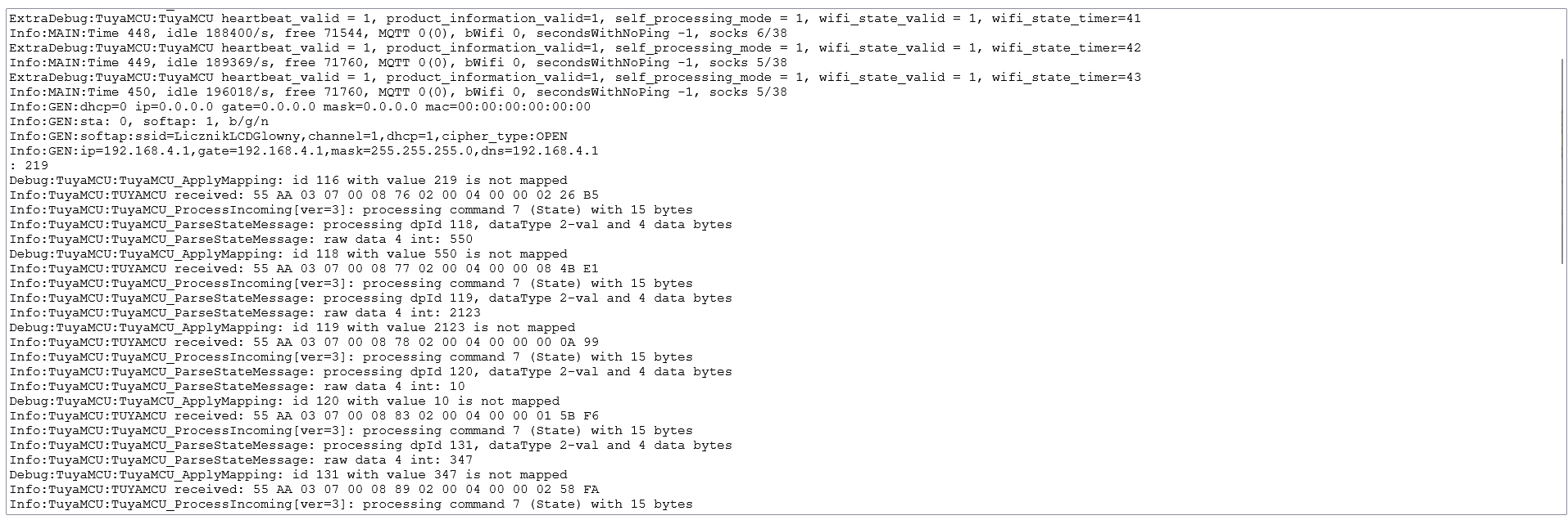

    I managed to determine that the relay has dpID 16, (but e.g. dpID 11 turns off the relay without the possibility of turning it on again, it looks a bit like it is a "safety" signal), now I am trying to determine where the energy consumption values are, etc. I don`t know why but when changing the relay state using the button, there is no change in the device state by dpID 16, but the toggle itself detects this change and shows the correct and current state of the relay. I don`t know why, but it doesn`t matter, what matters is that he sees the relay status.
    This is what TuyaMCU`s response looks like right after running it:
    The image shows logs of TuyaMCU messages on a computer screen.
    This is the effect of executing the command tuyaMcu_sendQueryState : :
    aMCU:TuyaMCU_ApplyMapping: id 118 with value 1000 is not mapped
    Info:TuyaMCU:TUYAMCU received: 55 AA 03 07 00 08 77 02 00 04 00 00 07 D0 65
    Info:TuyaMCU:TuyaMCU_ProcessIncoming[ver=3]: processing command 7 (State) with 15 bytes
    Info:TuyaMCU:TuyaMCU_ParseStateMessage: processing dpId 119, dataType 2-val and 4 data bytes
    Info:TuyaMCU:TuyaMCU_ParseStateMessage: raw data 4 int: 2000
    Debug:TuyaMCU:TuyaMCU_ApplyMapping: id 119 with value 2000 is not mapped
    Info:TuyaMCU:TUYAMCU received: 55 AA 03 07 00 08 78 02 00 04 00 00 00 0A 99
    Info:TuyaMCU:TuyaMCU_ParseStateMessage: processing dpId 120, dataType 2-val and 4 data bytes
    Info:TuyaMCU:TuyaMCU_ParseStateMessage: raw data 4 int: 10
    Debug:TuyaMCU:TuyaMCU_ApplyMapping: id 120 with value 10 is not mapped
    Info:TuyaMCU:TUYAMCU received: 55 AA 03 07 00 08 83 02 00 04 00 00 01 55 F0
    Info:TuyaMCU:TuyaMCU_ParseStateMessage: processing dpId 131, dataType 2-val and 4 data bytes
    Info:TuyaMCU:TuyaMCU_ParseStateMessage: raw data 4 int: 341
    Debug:TuyaMCU:TuyaMCU_ApplyMapping: id 131 with value 341 is not mapped
    Info:TuyaMCU:TUYAMCU received: 55 AA 03 07 00 08 89 02 00 04 00 00 02 58 FA

    Interestingly, I keep receiving the following messages (especially after setting the WiFi status to 4, i.e. connected):
    Info:TuyaMCU:TUYAMCU received: 55 AA 03 34 00 01 04 3B
    Info:TuyaMCU:TuyaMCU_ProcessIncoming[ver=3]: processing command 52 (Unknown) with 8 bytes
    Info:TuyaMCU:TuyaMCU_ProcessIncoming: unhandled type 52
    I don`t really know what it means and what data it is intended to transfer, it`s probably not the energy consumption value because when the load is turned on, the value does not change.

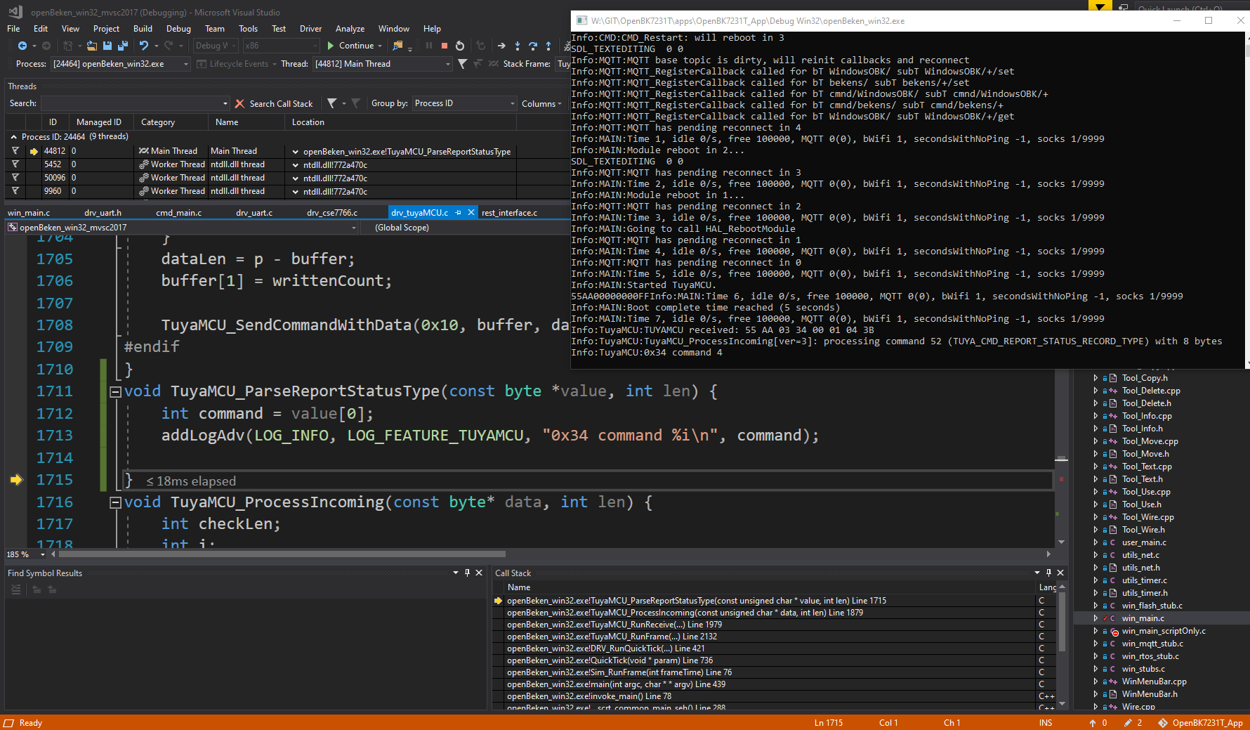

    According to above code (translated from Chinese to English):
    Code: C / C++
    it is:
    Code: C / C++

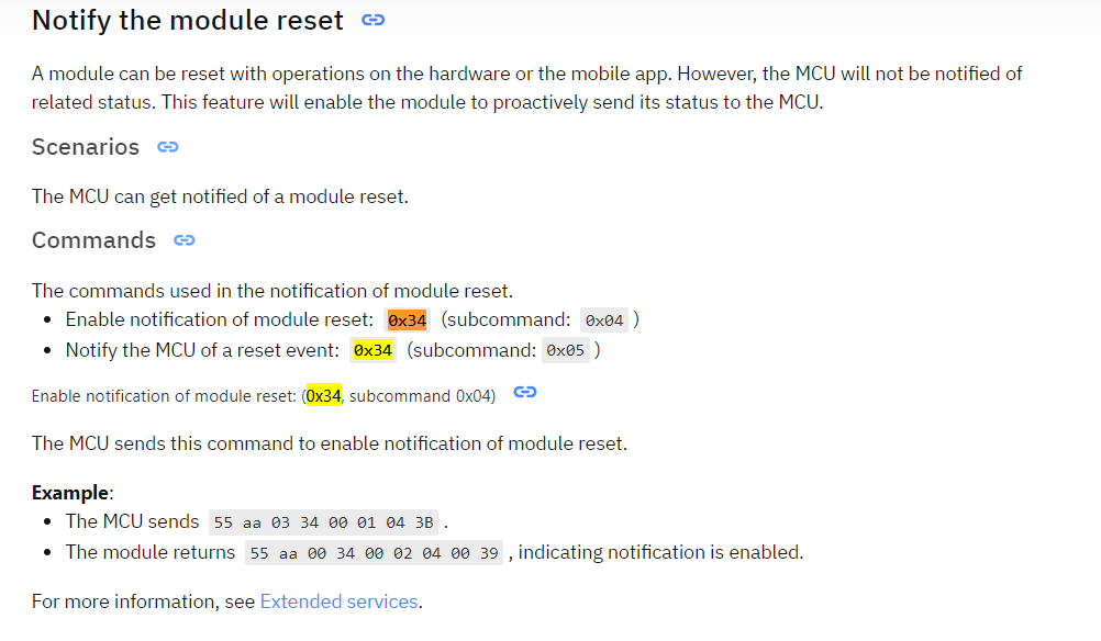

    Unfortunately, even the found code does not show how to handle 0x04, and in our case 0x04 does not have the length 0x02, but I at least added the basis for parsing this package:
    Screenshot of Visual Studio with debugging console and Tuya module source code.
    https://github.com/openshwprojects/OpenBK7231...mmit/e9493e5520f29d765d2eeb6bee2b3225880a70fa
    However, there is something more in the Tuya documentation:
    Screenshot of documentation regarding module reset notification.
    It looks like the WiFi module should respond 55 aa 00 34 00 02 04 00 39 but I don`t see that it would bring us closer to collecting the measurements... I can try to implement this answer, as long as there is nothing useful in other packages

    Sometimes it is simpler, sometimes more difficult, dpIDs are not standardized at Tuya. When I was developing another device with @xury, the measurements were immediately available.
    Are you not sending any dpID type? raw be string ?
    Selfdrivers wrote:
    I haven`t found anything else yet, and I have no ideas on how to detect these dpIDs because even changing the values manually (directly on the relay) or changing the state using toggle or sending a command that shows the device status does not help.
    In many devices this was enough, but in your art something must be implemented differently.
    It is definitely recommended to often perform TuyaMCU capture on the original software:
    TuyaMCU analyzer - UART packet decoder for Tuya devices - dpID detector
    I can also add the answer to 0x34 to the code.

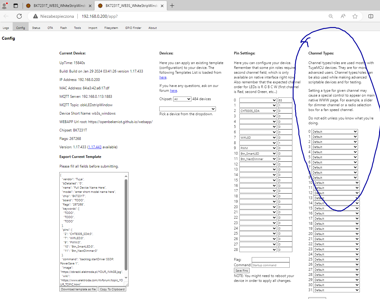

    A different question now, how can I delete a channel? I currently have channel 10 set as textField (but I don`t use it) and I would like to remove it completely or hide it, I looked in the documentation but I couldn`t find anything.
    In Web App:
    Screenshot of a web interface for configuring the BK7231T device.

    1. play with tuyaMcu_sendQueryState and look at what is being sent, maybe there is a RAW (bytes) or String (ASCII text) packet? For example, some dpId that sends at least 12 bytes, 4 bytes for current, voltage and power? This happens in some devices
    2. according to Tuya documentation, the answer to 55 AA 03 34 00 01 04 3B is 55 aa 00 34 00 02 04 00 39 by default, I entered it in the code in this PR:

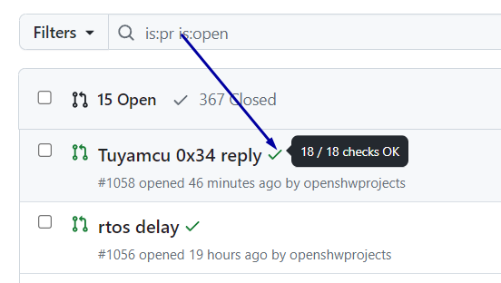

    https://github.com/openshwprojects/OpenBK7231T_App/pull/1058/
    you can try to download a new binary from this PR, run an OTA and check what happens
    3. as a last resort, you can restore the Tuya flash (BK7231GUIFlashTool in the backup and flash option makes a 2MB copy of it) and perform packet capture, this will solve any doubts

    the logs look like this after execution uartSendHex : :
    Screenshot showing logs after sending the uartSendHex command for the Tuya Microcontroller.

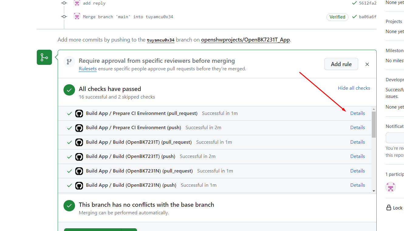

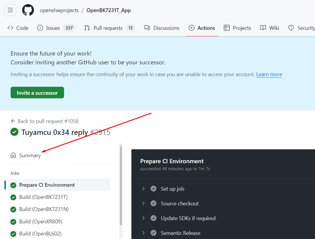

    OpenBeken has an automatic compilation system based on Github workflow, which means that each new version is automatically compiled for all supported platforms. Apparently, each PR and commit is automatically compiled, to download the compiled binaries you need to click the "tick":
    Part of the GitHub panel showing a list of open pull requests with details of one of them.
    Then in details:
    Screenshot showing the results of an automatic compilation on Github for the OpenBeken project.
    Then in summary:
    Screenshot of the Github interface with the Actions tab for the OpenBK7231T_App project with the Summary link highlighted.

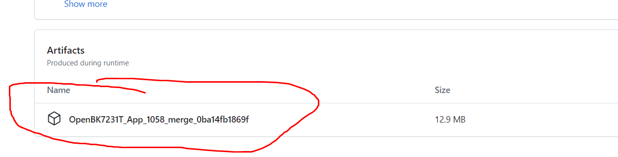

    After scrolling down you will find a package with compilation results:
    Screenshot of the Artifacts section on GitHub, containing a compiled package.

    I think I already know what the problem is, but I don`t know how to get around it, I noticed that sometimes it shows me dpID from 16 upwards (it then cuts off e.g. 130 and higher) and sometimes it gives me values 116 up and it is possible that it also cuts off the upper range somewhere.
    Example:
    I executed the device status command and received the following data:
    Screenshot of Tasmota log showing command processing and debug information for dpID.
    notice that at the very top there is information from Debug that id 110 has not been paired with anything, but id 110 and its value do not appear in the log, my theory is that there are so many devices that it overflows the buffer and hence we are not in able to see values that are responsible for e.g. energy consumption, voltage, current. Do you have any ideas on how to handle this? Maybe a dump to a .log file?
    Added after 4 [minutes]:
    Another example:
    This time it was cut off at the "height" of 116 (debug is there, but not the value itself, i.e. it sees it but does not show it in the console):
    System log screenshot regarding TuyaMCU devices with message and status processing.

How do you disassemble the TO-Q-SYS-JWT DIN rail kWh meter and remove the housing pins without damaging the case?
You open it by removing the 6 metal rods first, not by forcing the plastic shell. 1. Bend the visible edge of each gold-colored pin inward. 2. Gently tap each rod out; the starting side does not matter. 3. After all 6 rods are out, release the top latches and lift the housing apart. The author called this step out because standard MCB-style cases hide the pins well, and prying first risks breaking the clips. [#20937367]
Why does flashing the BK7231N on the TO-Q-SYS-JWT seem to require desoldering the module, and what baud rates were reported to work afterward?
Flashing worked reliably only after desoldering the BK7231N from the carrier board. The original poster said in-circuit flashing failed, while later confirmation showed read and write worked “like a charm” once the module was removed. Reported working speeds were 115200 baud and even 1500000 baud after desoldering. That makes this device a poor candidate for casual pogo-pin flashing unless you verify the board does not load TX/RX lines. [#21089661]
What is TuyaMCU, and how does it differ from a setup where the BK7231N directly controls the relay and display?
TuyaMCU here means the Wi‑Fi chip exchanges serialized commands with a separate controller instead of driving hardware directly. "TuyaMCU is a UART-based device architecture that sends dpID state packets between a Wi‑Fi module and a main MCU, rather than exposing direct relay or display GPIO control." In this meter-switch, the HC32F460 handles the display, buttons, and relay logic, while the BK7231N mainly handles Wi‑Fi transport. That is why the display still works after flashing OpenBeken. [#20937367]
What does dpID mean in TuyaMCU devices, and how do you figure out which dpIDs control relay, protection settings, and measurements on the TO-Q-SYS-JWT?
A dpID is the device-property identifier that labels each TuyaMCU state or command field. The thread identified dpID 16 as relay control, 114 as overcurrent, 115 as overvoltage, 116 as undervoltage, 118 as overtemperature, 119 as overpower, and 131 as processor temperature. Users found them by sending tuyaMcu_sendQueryState, toggling settings, and comparing returned values like 245, 219, 550, and 2123 to what the display or UI showed. The fallback method is restoring stock firmware and extracting full dpIDs from Tuya’s developer portal. [#20942478]
Which OpenBeken autoexec.bat lines were used to get the TO-Q-SYS-JWT relay control, voltage, current, power, and protection thresholds working?
The working setup used TuyaMCU at 115200 baud, mapped dpID 16 to a toggle, dpID 6 to raw V/I/P decoding, and linked threshold dpIDs 114, 115, 116, 118, 119, and 131 to channels. The final script also labeled channels and added addRepeatingEvent 2 -1 tuyaMcu_sendQueryState for periodic refresh. Key lines included startDriver TuyaMCU, tuyaMcu_defWiFiState 4, linkTuyaMCUOutputToChannel 6 RAW_TAC2121C_VCP, and linkTuyaMCUOutputToChannel 16 bool 1. That combination exposed relay, voltage, current, power, and protection values in the panel. [#20943360]
How can you identify whether dpID 6 on this device is the raw voltage-current-power packet and map it with RAW_TAC2121C_VCP in OpenBeken?
You identify it by matching the raw 8-byte payload against known VCP packet structure and real load changes. A 13–14 W load produced bytes ending with 00 00 0D, while a 4 W load produced 00 00 04, which aligned with power. The developer then matched dpID 6 to the existing TAC2121C-style raw frame and recommended linkTuyaMCUOutputToChannel 6 RAW_TAC2121C_VCP. That automatically created channels for voltage divided by 10, current divided by 1000, and power. [#20943234]
Why were the TuyaMCU logs getting cut off during tuyaMcu_sendQueryState, and how was the larger log buffer used to reveal all dpIDs?
The logs were getting truncated because the returned state list was larger than the visible or buffered log path could hold. Once the buffer was enlarged from 1024 to 8192 bytes in a test build, full dpID output appeared, including ids 1, 6, 11, 13, 16, 101–120, 131, 137, 140, 141, and 142. The thread also checked for another failure case: two browser tabs can split WebApp logs between tabs. In this case, only one WebApp instance was open, so the larger buffer exposed the missing entries. [#20943018]
What is command 0x34 in TuyaMCU communication, and why did replying with "55 aa 00 34 00 02 04 00 39" stop the repeated unknown query messages?
Command 0x34 is an extended Tuya module service packet that OpenBeken initially logged as unknown. The repeating frame 55 AA 03 34 00 01 04 3B kept appearing after Wi‑Fi state was set to 4, and replying with 55 aa 00 34 00 02 04 00 39 stopped the spam immediately. The developer linked 0x34 to Tuya’s extended module functions and then added support so the main firmware would answer it automatically. That calmed the logs, although it did not directly reveal energy measurements. [#20942168]
How can you capture original Tuya UART traffic safely on a mains-powered device like this if the power supply may be non-isolated?
You should revert to the original firmware, then capture UART only with isolation in place. The thread explicitly warned that the internal converter may be non-isolated, so a plain USB-UART hookup is risky on a live mains device. The recommended path was to restore the saved 2 MB flash backup, power the unit safely, and use a UART isolator while recording packets during normal app and button actions. That method avoids guesswork and recovers hidden dpIDs cleanly. [#20942614]
TO-Q-SYS-JWT vs TO-Q-SY1-JWT: what similarities and differences were noted in hardware layout, relay behavior, and TuyaMCU mapping?
They look closely related, but the TO-Q-SYS-JWT adds a built-in display and local settings menu. The original poster described it as a version similar to TO-Q-SY1-JWT, and another developer said both device families had seen bistable relay behavior. Both were treated as TuyaMCU-style designs with BK7231-based Wi‑Fi modules and MCU-side relay control, which means dpID mapping matters more than GPIO templates. The practical difference in this thread was the display board and HC32F460 controller in the TO-Q-SYS-JWT. [#20938495]
