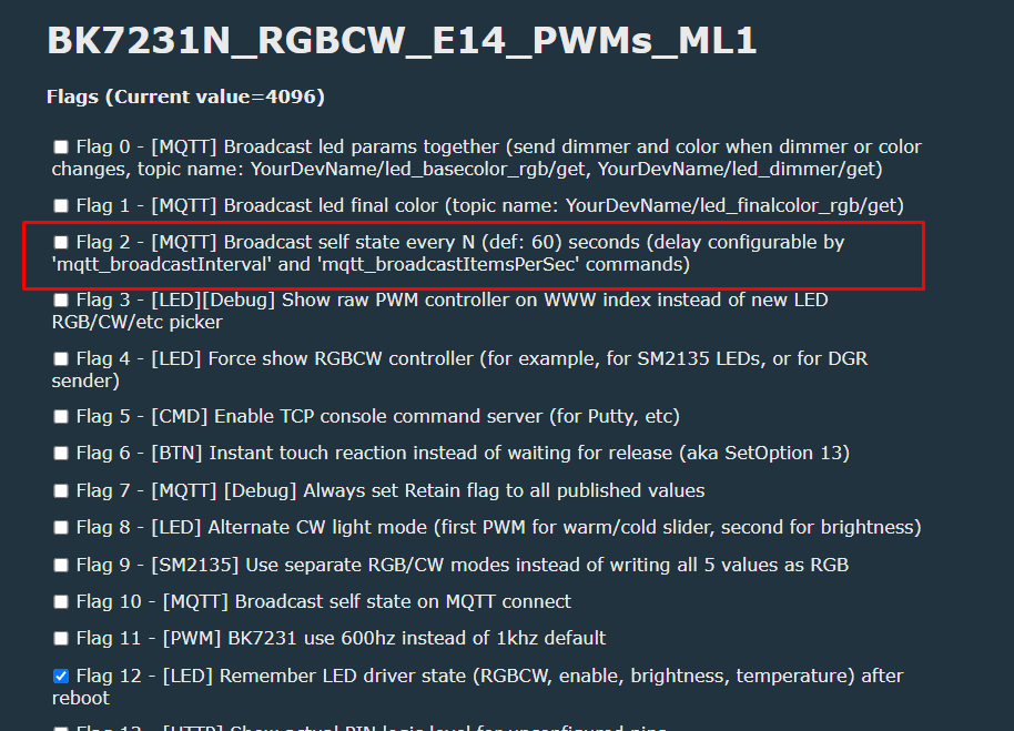

    To publish state every minute use:
    [BK7231T/WBLC5] How to attach SHT30 sensor to smart Tuya LED?
    You can also put:
    mqtt_broadcastInterval SECONDSNUMBER
    in autoexec, replace SECONDSNUMBER with for example 120 for 120 seconds.

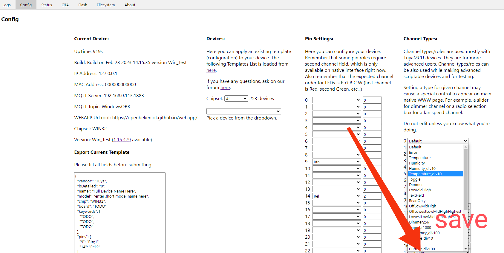

    1. data via mqtt can only be received until the module is rebooted, after rebooting it is necessary to enter the channel type again, for some reason they are not saved.
    Where do you set channel types?
    Then in autoexec do:
    setChannelType 0 Temperature_div10
    setChannelType 1 Humidity

    I changed the flag type data via the web interface. After that, I pressed the save button, and the data was saved only after 3-4 reboots.

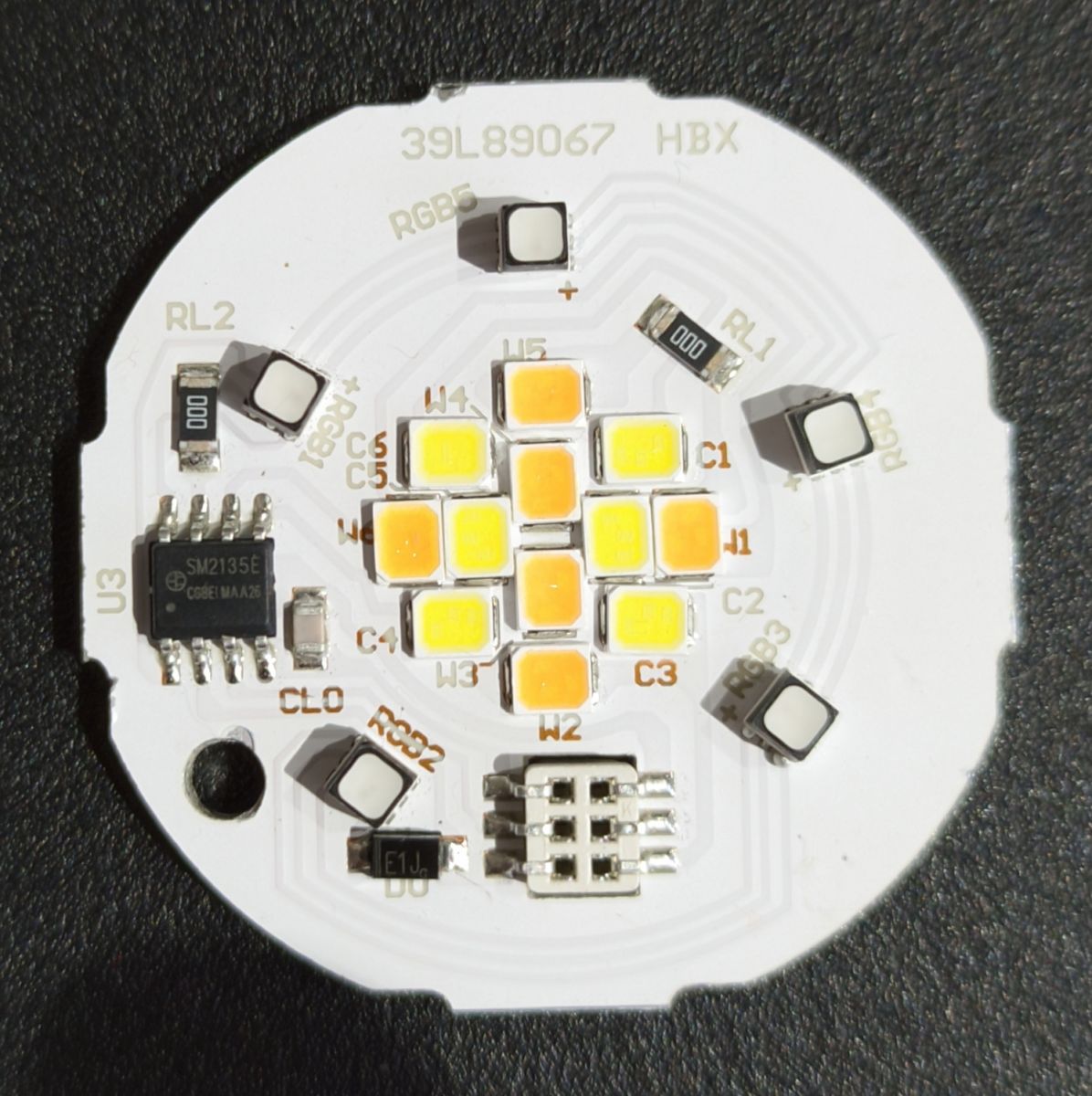

  • Request to trace SM2135 CLK and DAT pins on PCB
    #35 20456624
    Posts: 14805
    Rate: 12972

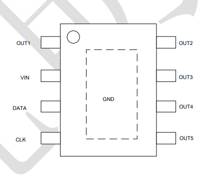

    Your device is using SM2135 LED driver. This LED driver supports 5 channels, so RGBCW is possible, but only requires 2 lines to work - SDA and SCL. It's using modified I2C protocol.
    Here is the pinout:
    Communication is using DATA (SDA) and CLK (SCL) pins.
    Your wifi module, on other hand, has those pins:
    3PWM4I/OHardware PWM pin, which is connected to the P24 pin on the internal IC
    4PWM5I/OHardware PWM pin, which is connected to the P26 pin on the internal IC
    5PWM0I/OHardware PWM pin, which is connected to the P6 pin on the internal IC
    My question: can you take a look at the PCB traces or check with multimeter where the CLK and DAT are connected? To which Px of WiFi module?
    Of course, disconnect power before doing that!
  • #36 20456657
    yuretskor
    Posts: 52

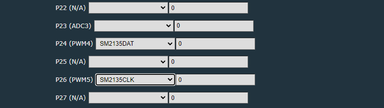

    CLK -- PWM5, DATA(SDA) -- PWM4. If I now connected sht30 to Rx1 and Tx1, then it will not work to control the led?
  • #37 20456669
    Posts: 14805
    Rate: 12972
    SHT30 won't hurt for LEDs. It should be ok.
    Ok, so now, in pins config:
    and reboot...

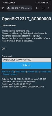

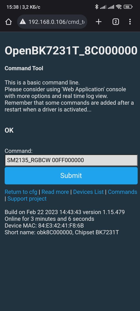

    Please test the LED driver directly by using the SM2135_RGBCW command.
    So something like:
    SM2135_RGBCW FF00000000
    and then:
    SM2135_RGBCW 00FF000000
    etc.
    The following command writes to LED directly and skips channels.
  • #42 20457747
    yuretskor
    Posts: 52
    Not work( [BK7231T/WBLC5] How to attach SHT30 sensor to smart Tuya LED?

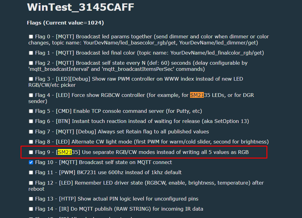

    Maybe select this:
  • Need to map SHT30 to temperature and humidity channels
    #50 20458108
    yuretskor
    Posts: 52
    I turned on flag 9, the main LEDs started working and I entered the code for full-fledged work
    SM2135_Map 1 0 2 4 3
    only after applying the flag, the RGB LEDs began to shine dimmer, but within the normal range, I like it. I remove the flag, they do not become brighter. It will do for me anyway, this is for statistics) how now to make the temperature sensor SHT30 work as well? Maybe it needs to be transplanted to another channel, for example 5 temperature, 6 humidity? How to do it?

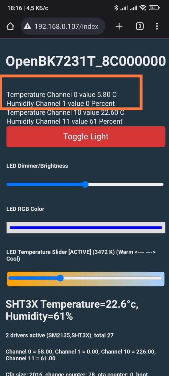

    Can you try to change SHT channels to something unused, like 10 and 11:
    Also keep in mind that you need to change your old indices 0 and 1 in autoexec as well.

  • Shared I2C globals causing LED and sensor conflict
    #55 20459212
    Posts: 14805
    Rate: 12972

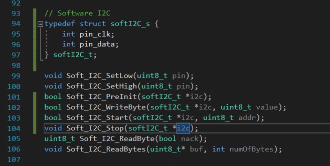

    The issue is because we're in a middle of transition to shared soft I2C code (because at first we had I2C code duplicated in each driver, btw, surprisingly, Tasmota still has that code duplication), but the:
    int g_i2c_pin_clk = 0;
    int g_i2c_pin_data = 1;
    are still shared and global. And I2C LED can be called from other thread than I2C sensor...
    I will change the I2C code to use a local variable with a struct with two pin indices so there are no global variables anymore.
    @dheenhasty will you be able to test my changes later today?

    They were here only temporary, I was in process of moving them to drc_soft_i2c.c, which are they now since several hours.
    I am finalizing the transition right now:
    Added after 1 [hours] 17 [minutes]:
    @dheenhasty I have first tested my changes on BP5758 LED driver, they seem to work, so I pushed my changes to the main tree. Is the SHT still working for you?

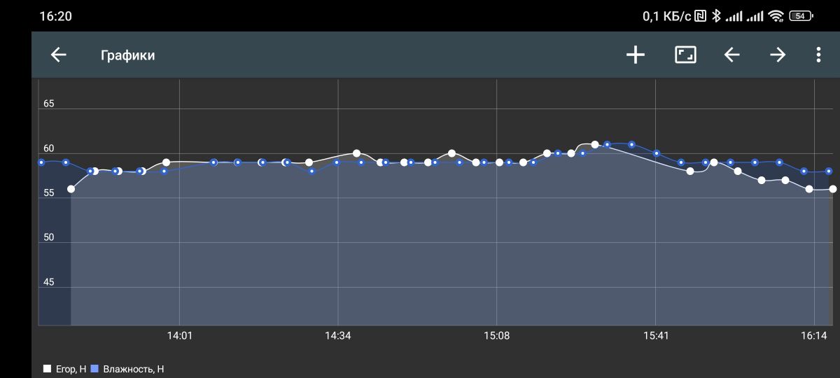

  • MQTT channel remap fixes LED and SHT30 readings
    #60 20459873
    yuretskor
    Posts: 52
    @p.kaczmarek2 yes. Now everything works as it should. Both the LED module and the sht30 sensor, just to send the readings correctly via mqtt, you need to change the channels, I set 10 and 11. Now everything is fine. Thanks a lot. So the firmware will be perfect. Still, now the rgb color change by temperature and the tm1637 display and then there will be a bomb in general. Cool guys, thanks very much!
    Tell me how to remove the data in the square?[BK7231T/WBLC5] How to attach SHT30 sensor to smart Tuya LED?

Free pins are P6, P24 and P26. Most users place SDA on P24 (RX1) and SCL on P26 (TX1). Software I²C works on any of them after setting pin roles in the web UI [Elektroda, p.kaczmarek2, post #20452701]
Can I keep full LED functionality while running the SHT30?
Yes. Map SDA/SCL to UART1 pins for SHT30 and keep PWM4/PWM5 driving the SM2135 LED chip. Firmware ≥ 1.15.499 fixed the I²C conflict; update if LEDs go dark after sensor reads [Elektroda, p.kaczmarek2, post #20459181]

How do I make OpenBeken publish MQTT data every 60 s even when values don’t change?
Set persistent interval broadcasting:
mqtt_broadcastInterval 60
mqtt_broadcastItemsPerSec 2
This forces a publish every 60 s per channel whether or not the reading changed [Elektroda, p.kaczmarek2, post #20455491]

LED colours are swapped; how do I remap SM2135 channels?
Run SM2135_Map r g b c w, replacing each letter with the desired index (0–4). Example for RGB-CW order:
No reboot required; move any slider to view the change [Elektroda, yuretskor, post #20458108]
