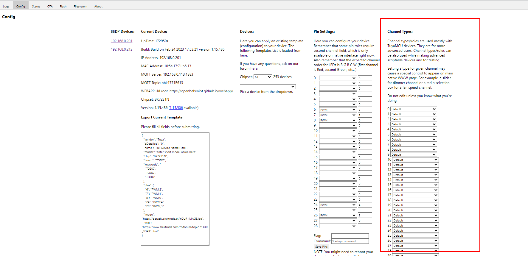

    You can use either console commands or a Web Application wrapper.
    You need to set default type for those channels, because they are marked as temperature/humidity.
    Here:

    Through the webapp, I set the default value and it works until reboot. Then it goes back again. I did both from my phone and computer. The SetChannel 0 default command does not work or I do not understand it correctly ( Led control from a computer is 100%, all functions work as they should. At work, depending on the temperature, I see the following algorithm: Temperature from 0 to 10 color blue, temperature from 10 to 20 color yellow temperature from 20 to 30 color red. And all this would work in the time range from 7.00 to 21.00. something like this.
  • #63 20460168
    Posts: 14805
    Rate: 12972
    Okay, I can see now what's wrong. The autosave was missing for this particular API.
    Please update to version 1.15.507 or later and try using Web App again. It will be saved now.

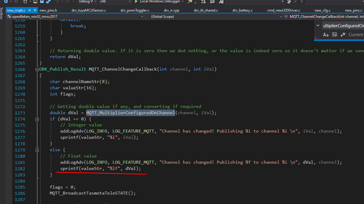

    This is most likely because we have started with TuyaMCU compatibility, which forces integer values (no fractional point) for everything, including temperature.
    See:
    https://www.elektroda.com/rtvforum/topic3942730.html
    TuyaMCU stores temperature as value times 10, so we had channel type:
    Temperature_div10
    all to be compatible with TuyaMCU standard.

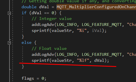

    I am not sure about that part:
    given with a resolution of 0.000001
    but you might be just referring to sprintf rounding?
    Most likely rounding has to be added here:
    [BK7231T/WBLC5] How to attach SHT30 sensor to smart Tuya LED?
    but we need to make sure that rounding respects channel type.
    And to get 2 decimal places standard, we would need to introduce:
    Temperature_div100
    and handle it accordingly.
    @dheenhasty , would you be interested in doing the decimal places fix?
    You need to go to MQTT_ChannelChangeCallback, an alter MQTT_MultiplierConfiguredOnChannel to return the number of decimal places required, and then add sensible rounding here:
    Another thing to do would be to introduce that Temperature_div100 with channel type and everything and in driver check which resolution user wants.

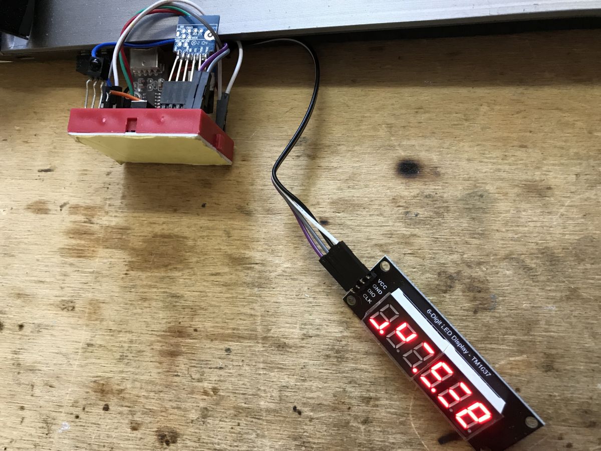

  • #73 20466222
    Posts: 14805
    Rate: 12972

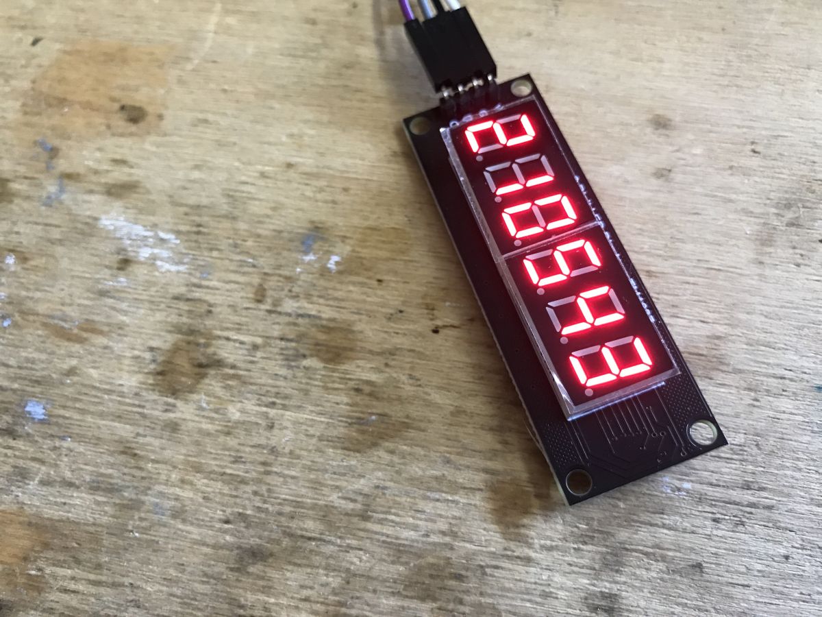

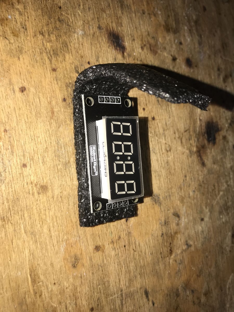

    My TM1637 displays has arrived. I have started writing driver for them:
    [BK7231T/WBLC5] How to attach SHT30 sensor to smart Tuya LED? [BK7231T/WBLC5] How to attach SHT30 sensor to smart Tuya LED?
  • #74 20466224
    yuretskor
    Posts: 52
    Very good news. Will it work for 4 digits? And if there is time, then always with dots and blinking. It greatly changes the perception of the device.
  • #75 20466562
    Posts: 14805
    Rate: 12972
    I have 4 digits as well, they are virtually the same from the implementation standpoint.
    We will have to script them... but it should be very simple.

  • TM1637 driver test command and pin setup
    #77 20469144
    Posts: 14805
    Rate: 12972
    The driver is ready but there is no tutorial yet, but you can test it by updating the firmware, setting the CLK and DIO pin roles for two chosen IOs, and then by using:
    TM1637_Print 0 0 123456
    command, where first argument is offset in display and second is character limit (0 for none).
    To print a channel value, you can try:
    TM1637_Print 0 0 $CH10
    etc etc
    You can try it out now or wait for the documentation/tutorial
  • #78 20842388
    yuretskor
    Posts: 52
    Hello. I haven't been here for a long time. How are things going now? Tm 1637.
  • #79 20842508
    Posts: 14805
    Rate: 12972
    TM1637 support is implemented, we've did it with @DeDaMrAz , would you like to try running it?
    I even done an article on that in Polish:
    https://www.elektroda.pl/rtvforum/topic3961943.html#20468593
  • #80 20842697

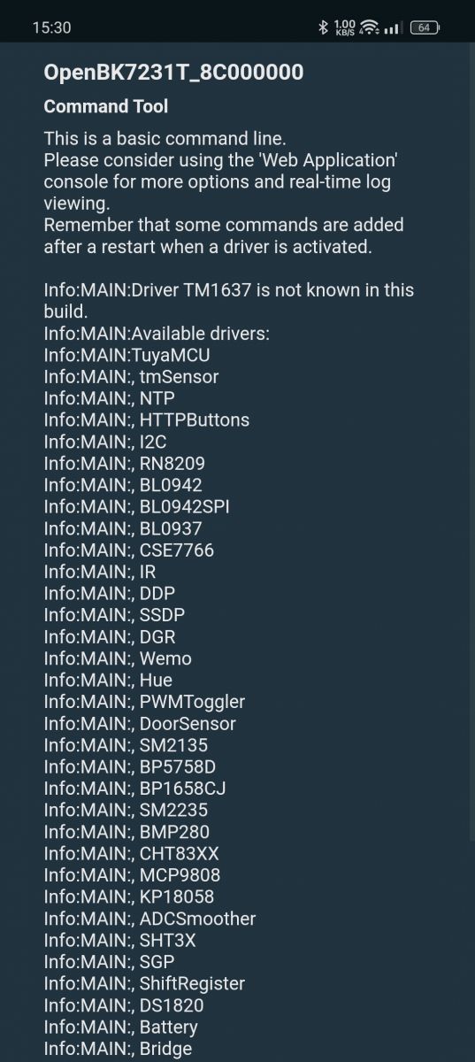

    Hi, I'm trying to run the driver. ТМ1637 and after the commands startDriver TM1637 I see the following on the screen. I also have a question: are the pigs free only with UART2_TX and UART2_RX. Can I hang on them CLK and DIO TM1637?
    Screenshot of the OpenBK7231T Command Tool showing driver information.
    Added after 53 [minutes]:
    I realized that I need to make a firmware with the library included displays. Can you help me with something? I have a problem with that. Гитхаб I can't figure it out. Thanks.
    Added after 3 [hours] 40 [minutes]:
    Nothing works. It's very difficult to master. Maybe there is some video?
  • UART2 pins may support TM1637 with custom firmware
    #86 21202562
    Sure, we have tutorial about that:
    https://www.elektroda.com/rtvforum/topic4033833.html#20946719
    Also related:
    https://www.elektroda.com/rtvforum/topic4056286.html

Is TM1637 display supported and how do I wire it?
Support is merged; flash a build with #define USE_TM1637. Assign DIO and CLK pins in Web App, then print:
TM1637_Print 0 0 $CH10 ;temperature
Use TMGN_Map to correct digit order if needed [Elektroda, p.kaczmarek2, post #21205344]
What if TM1637 digits appear out of order?
Send different TMGN_Map permutations until TMGN_Print 0 0 1234 shows 1234. Typical common-anode modules use TMGN_Map 32104567 [Elektroda, p.kaczmarek2, post #21205344]
