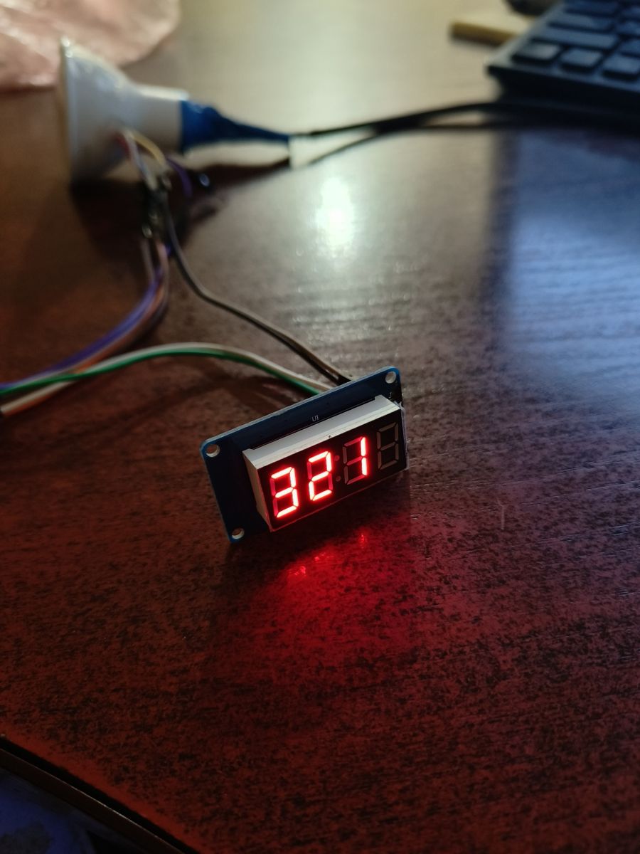

    @p.kaczmarek2 Seriously, wouldn't it have been easier for you to give me a file with the TM 1637 driver included? I don't quite understand what I'm clicking on the site to create the firmware and I still have to wait for your approval. It's long and complicated. If anything, I'm sorry.
    Added after 24 [minutes]:
    Somehow I connected it, there is a shift of one sign. How to fix it?
    Added after 47 [minutes]:
    When I enter the command TMGN_print 0 0 1234 On the display I see what is in the photo below.
    LED display showing the number 321 on a wooden desk.

    Posts: 14805
    Rate: 12972
    If digits order is not standard, then you need to try one of many TMGN_Map combinations.
    Start with:
    TMGN_Map 01234567
    TMGN_print 0 0 1234
    check result, of course do print on screen after doing map command.
    If still wrong, try:
    TMGN_Map 32104567
    TMGN_print 0 0 1234
    etc, etc.
    Here are docs:
    This is because the order of digits is not standarized in those modules.

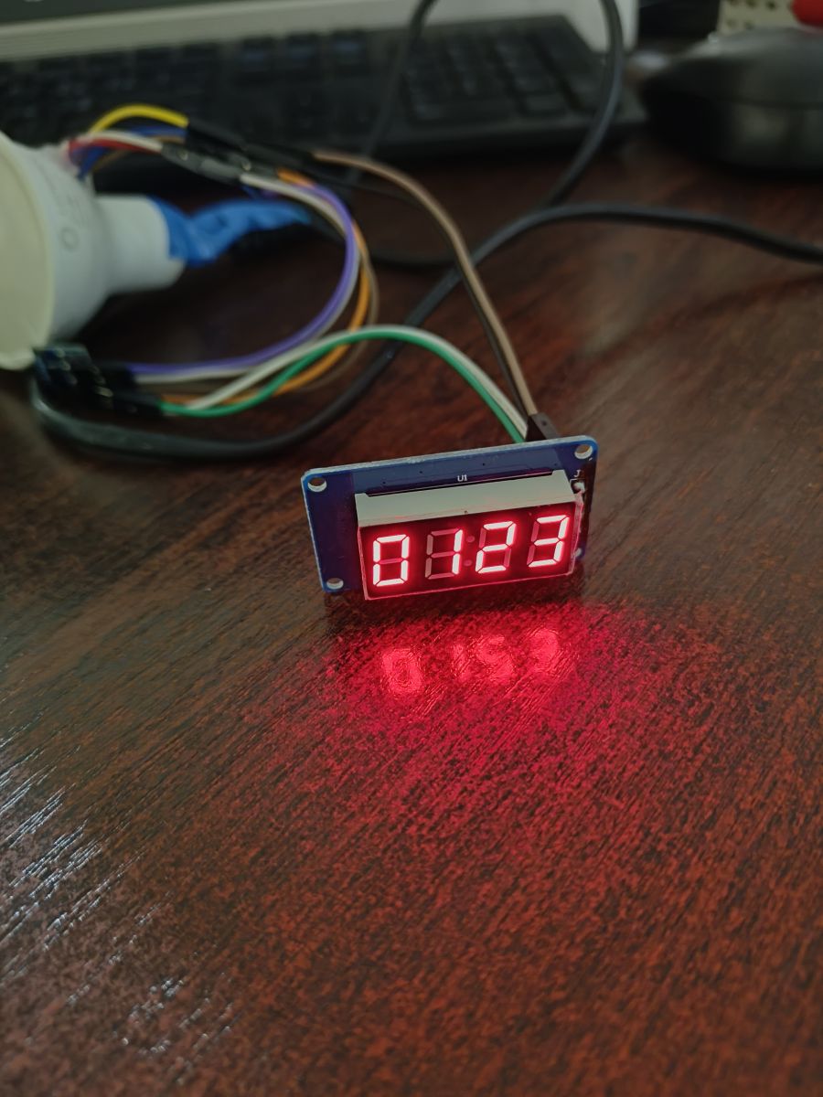

    #94 21208643
    yuretskor
    Posts: 52
    @p.kaczmarek2 I don't know what the problem is, but the TMGN_map command doesn't work for me, or rather, with different combinations, the display changes from 321 to 32 and that's it. And if the TMGN_test command, it displays 1234 correctly and each time the command is sent, it shifts by three digits 3456 then 6789 and so on in a circle. And if I send the TMGN_print 0 0 1234 command, I see what's in the photo above.
    LED display showing the numbers 0123 on a wooden table.

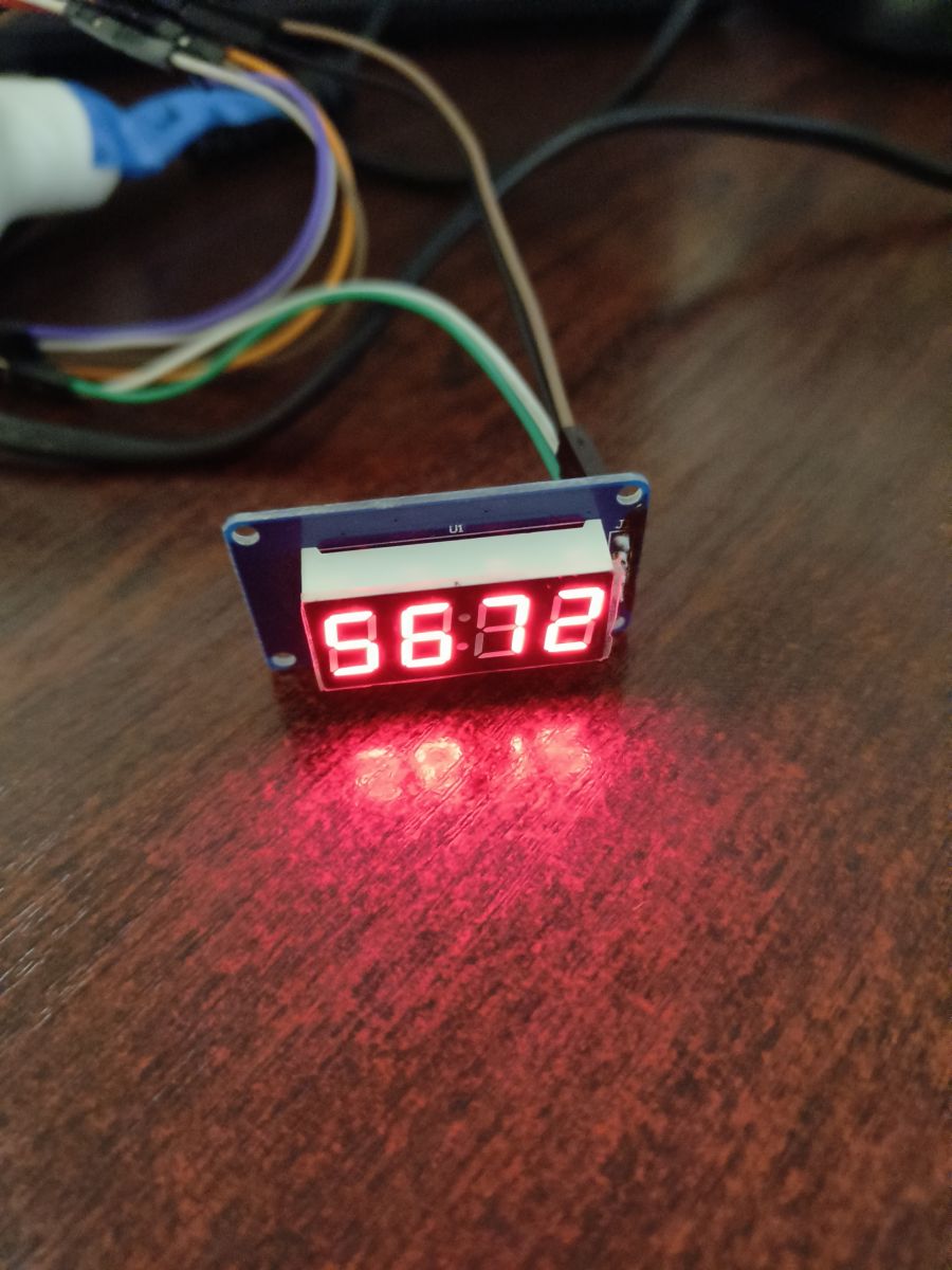

    @p.kaczmarek2 and if I send the command TMGN_print 0 0 7654321 then I see 5672 on the screen Segment display showing the number 5672.

    Posts: 14805
    Rate: 12972
    You should not use TMGN_test for production. Just use:
    TMGN_Map 32104567
    TMGN_print 0 0 1234
    Find the TMGN_Map that makes TMGN_print show 1234 correctly, I've seen you did that?
