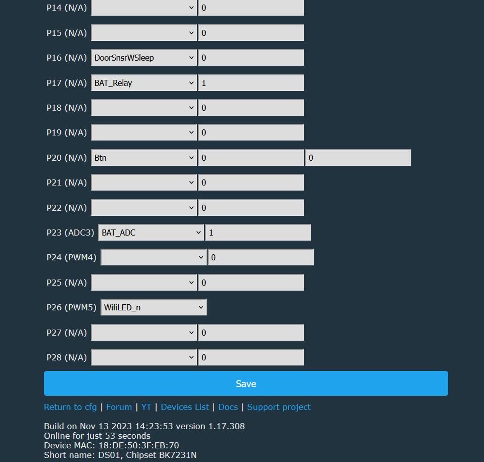

    >>20638363
    P16 DoorSnsrWSleep_nPup
    P20 Btn
    P23 BAT_ADC
    P26 WifiLED
    Add P17 to make battery voltage work
    P17 BAT_Relay <------------------
    P20 Btn
    P23 BAT_ADC
    P26 WifiLED

    These settings are the only ones that work, and the sensor goes into a deep sleep, so it doesn't eat up the batteries in 10 hours.
    16 DoorSnsrWSleep_nPup 1
    17 BAT_Relay 1
    20 Btn 2
    23 BAT_ADC 1
    26 WifiLED_n 0

    For me, it works too with the following settings:
    16 DoorSnsrWSleep 0
    17 BAT_Relay 1
    20 Btn 0
    23 BAT_ADC 1
    26 WifiLED_n 0
    It seemed to be important that battery settings are on another channel than the sensor/LED/btn.
    Also, I added 'backlog dstime 30' as a startup command, so the sensor puts itself into deep sleep after 30 seconds from the last state change and only wakes up when the door is opened/closed. With all these settings, there is no battery drain for me, and it works perfectly until now.

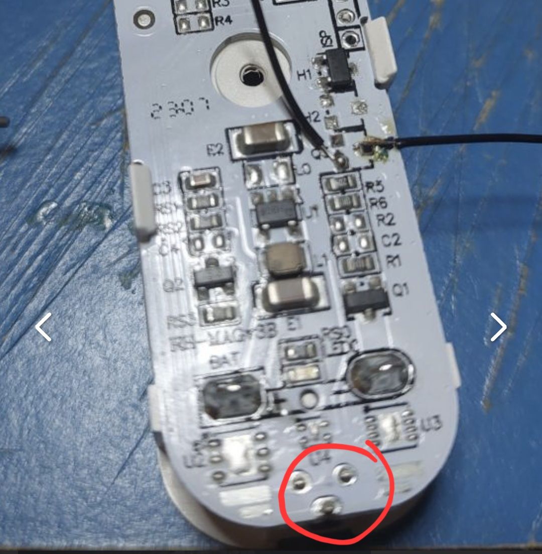

    Anybody can help me to identify pins to simulate open/close instead of a magnetic bar? Thanks.
  • #44 20733922
    Posts: 14767
    Rate: 12909
    Have you tried to do Tuya config extraction?
    It can be done two ways:
    - via BK7231 flasher, if you read 2MB backup
    - via already flashed OBK, that way: https://www.youtube.com/watch?v=WunlqIMAdgw
  • Reed switch pins identified for physical replacement

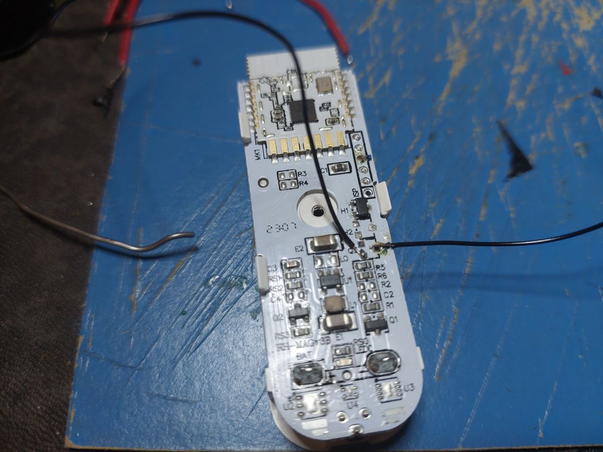

    #45 20734226
    calomx
    Level 4  
    Posts: 7
    Hello. I think I didn't explain well what I intended. The idea was to physically replace the magnet that operates the opening and closing with a physical switch. So what I needed was to know the pins where the reed is located, which changes its state as you approach the magnet.
    Added after 6 [minutes]:
    I tried this.. works but drain battery!

    On your board, H1 is the Hall sensor, this method is used to determine whether door is open or closed.

    I think if you use a multimeter to follow the traces of the pins that I suggested, you would probably arrive at the points that react on the magnet... another option would be, to use the button as physical switch or replace the button with the switch you prefer..!?

    But don't have any button. Weird for me is I can't see any reed as I can see on others door sensors.
    If I put a switch on H1 pins (like my picture with wires) I can simulate open/close door but drains battery in one day when it's on close state!
    Thanks

    As stated above, there is no reed in this door sensor. Some other sensors are reed-based, but this one is based on hall sensor.
    calomx wrote:
    If I put a switch on H1 pins (like my picture with wires) I can simulate open/cose door but drains battery in one day when its on close state!
    H1 is a hall sensor, it is used to detect whether door is open or closed. You can replace it with any other kind of sensor you want, also with a mechanical button. You can also connect mechanical button to any other GPIO of BK7231 and just configure it in the firmware to suit your needs.
    Even the factory version of this device requires the deep sleep usage, which is already well supported by OpenBeken. Have you configured your device to use deep sleep?

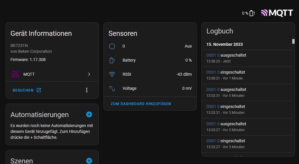

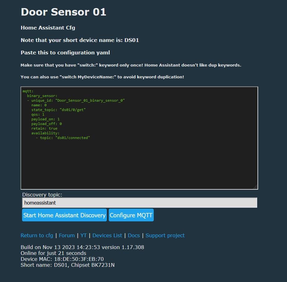

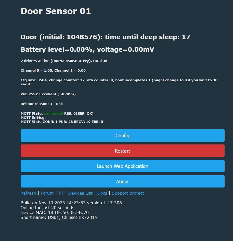

  • Door sensor channel briefly toggles then reverts to 1
    #58 20816323
    atomphil
    Posts: 31
    Rate: 17
    Thanks to this topic here, I was also able to successfully flash my Wifi door sensor with OBK.
    However, it shows a strange behaviour: When I place or remove the magnet in front of it, the status of channel 0 only changes for a short time from 1 to 0, only to jump back to 1 immediately afterwards.
    You can see this clearly in the HA log.
    How can I integrate the sensor as a door contact (open/closed) and without this voltage in HA?
    Here is my config:

      "pins": {
        "16": "DoorSnsrWSleep;0",
        "17": "BAT_Relay;1",
        "20": "Btn;0",
        "23": "BAT_ADC;1",
        "26": "WifiLED_n;0"
      "command": "backlog dstime 30",
    View of the user interface for managing the BK7231N sensor. Screenshot of a door sensor interface showing connection status, battery level, and other technical data. Device configuration page with various pin settings and states. Screenshot of door sensor configuration in Home Assistant

    I have set the channel type "OpenClosed" for channel 0 via the web application. So it shows the status correctly in firmware, closed with magnet and open without magnet. But for this, flag 42 needs to be checked. Also make sure to put the magnet in the correct position. It occurred to me that if the magnet is too close, it won't be recognized. If you use the original magnet that came with the sensor and place it centrally around 1 cm from the sensor, it should be stable. If you still have trouble with the magnet, maybe it's worth trying with the original Tuya firmware and see if you have the same problem, then it could be hardware related. If you don't want the battery voltage, just set the BAT_ADC and BAT_Relay pins back to blank, and reboot.
    In HA, you can then choose the "Door" option in the entity config, and it will give you a nice icon and looks great, I think =)
    Screenshot of a web app showing device configuration and setting the icon to Door.
  • #60 20817009
    atomphil
    Posts: 31
    Rate: 17
    That's the solution! Thank you very much.
