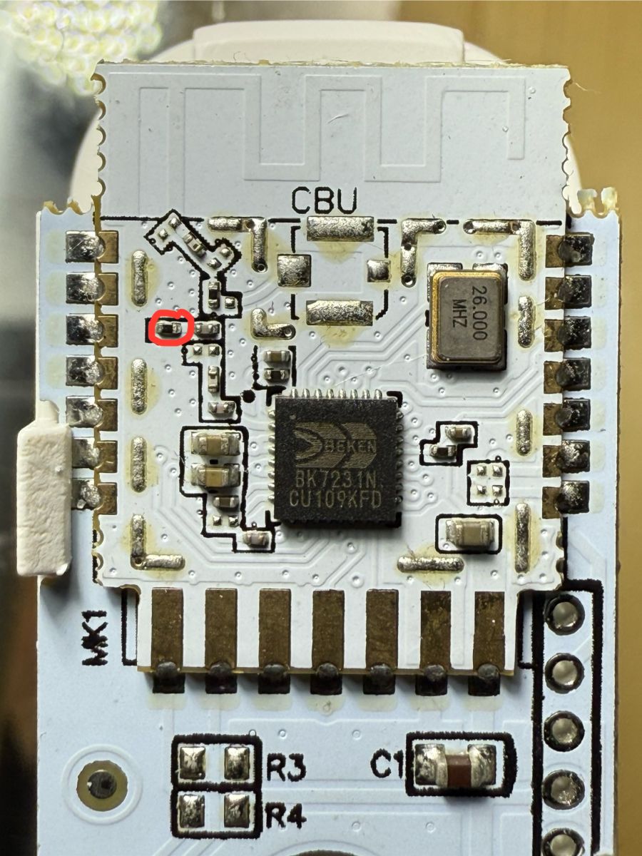

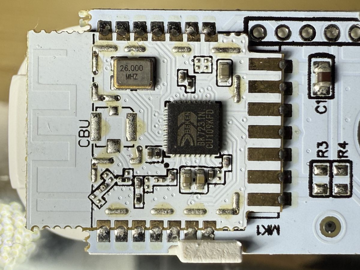

    Sure, here it comes:
    Close-up of electronic module with integrated circuit and 26 MHz crystal oscillator.
  • #92 21639526
    Posts: 14767
    Rate: 12909

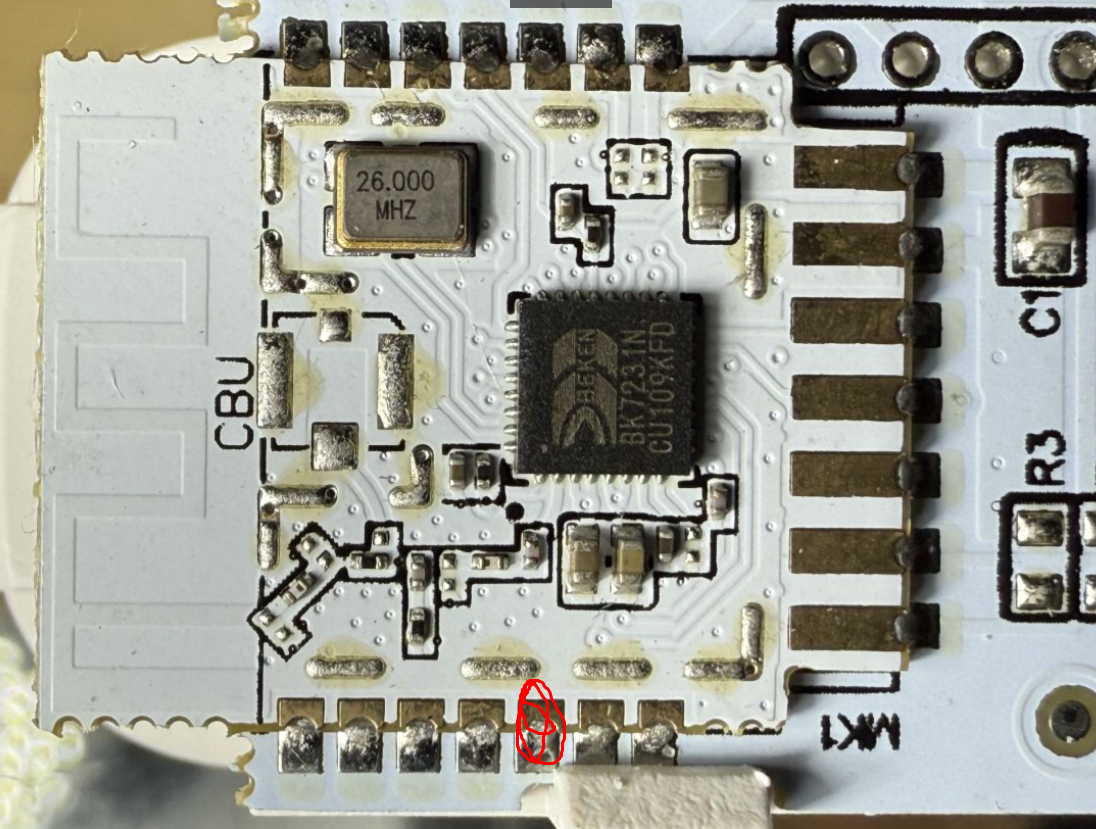

    So ADC is here:
    Highlighted area on a PCB showing ADC trace connection to two resistors
    To which two resistors does it connect?
  • #93 21639569
    gramais
    Posts: 48
    >>21639526
    Just to be sure: would this one be a resistor?
    Electronic module PCB with small SMD component marked in red
  • #94 21639578
    Posts: 14767
    Rate: 12909
    The ADC divider circuit is not on the CBU module, it's on device board.

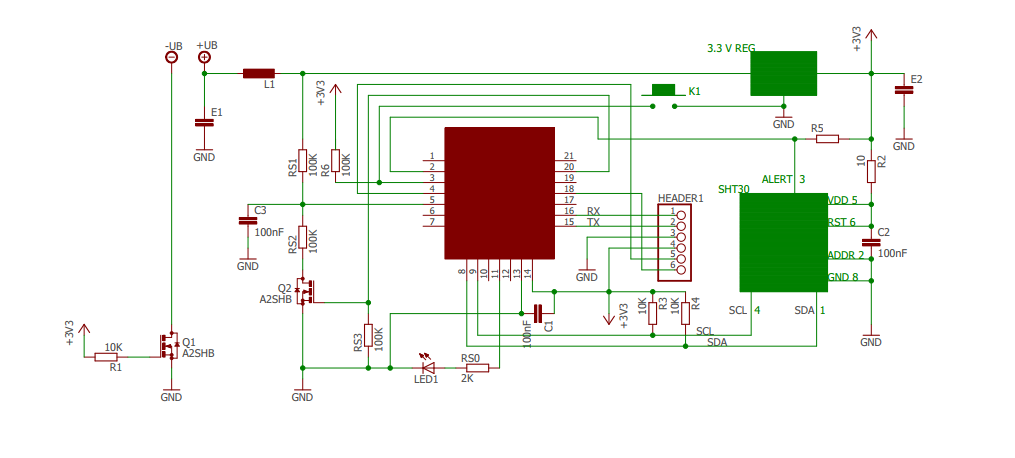

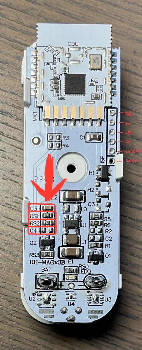

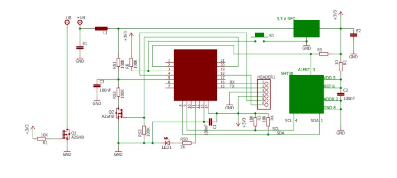

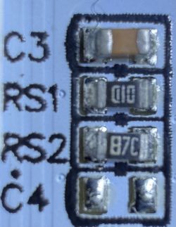

    Those resistors are marked RS1, RS2 and RS3, like in our tutorial:
    Schematic with 100k resistors RS1, RS2, and RS3 connected to microcontroller
    Q2 also matches.
    But what are the values of those resistors? Can you make a clear photo of smd markings or remove batteries and check with multimeter?
  • #99 21639881
    gramais
    Posts: 48
    >>21639877
    Hope this is clear enough?
    Close-up of SMD parts labeled C3, RS1 (01D), RS2 (87C), and C4 on a white PCB
    So if I understand correctly:
    RS1 = 01D = 100 kΩ
    RS2 = 87C = 78.7 kΩ

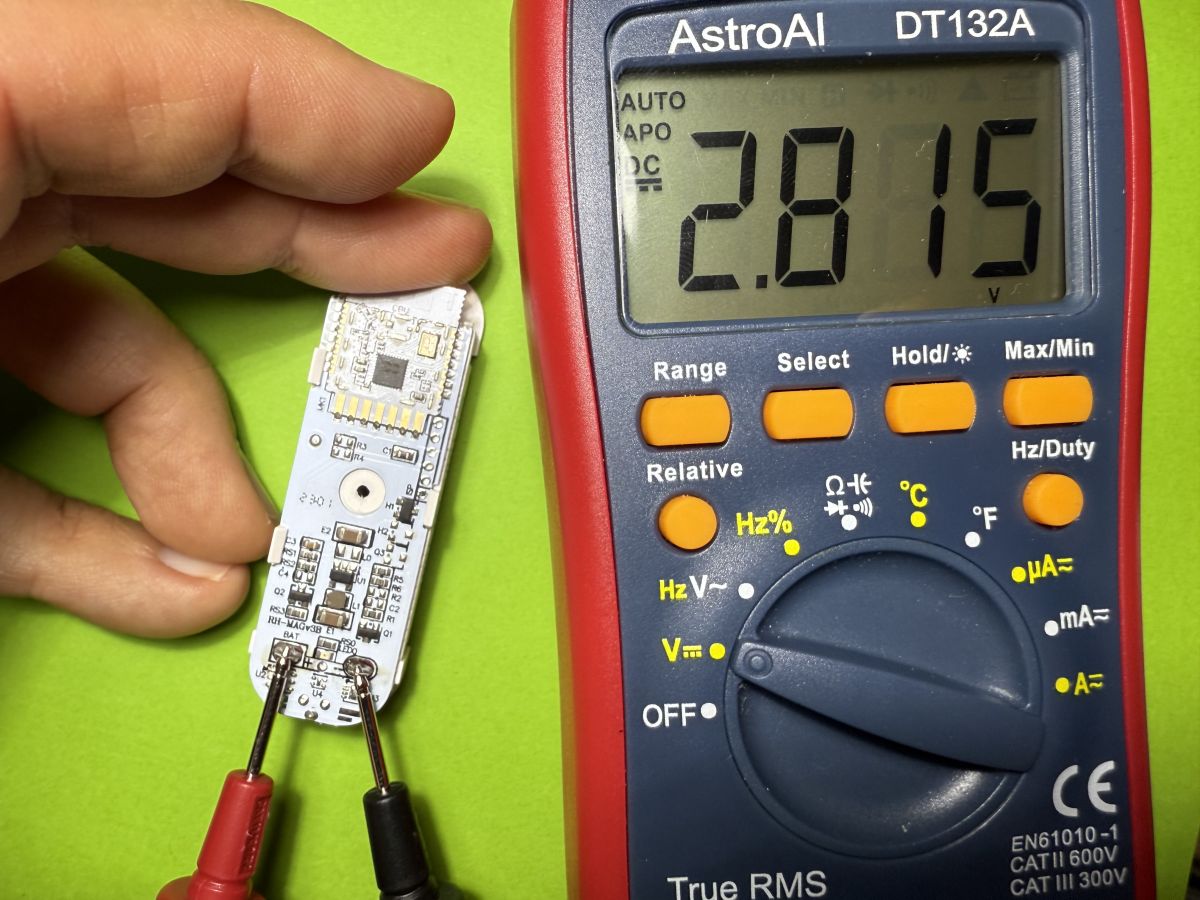

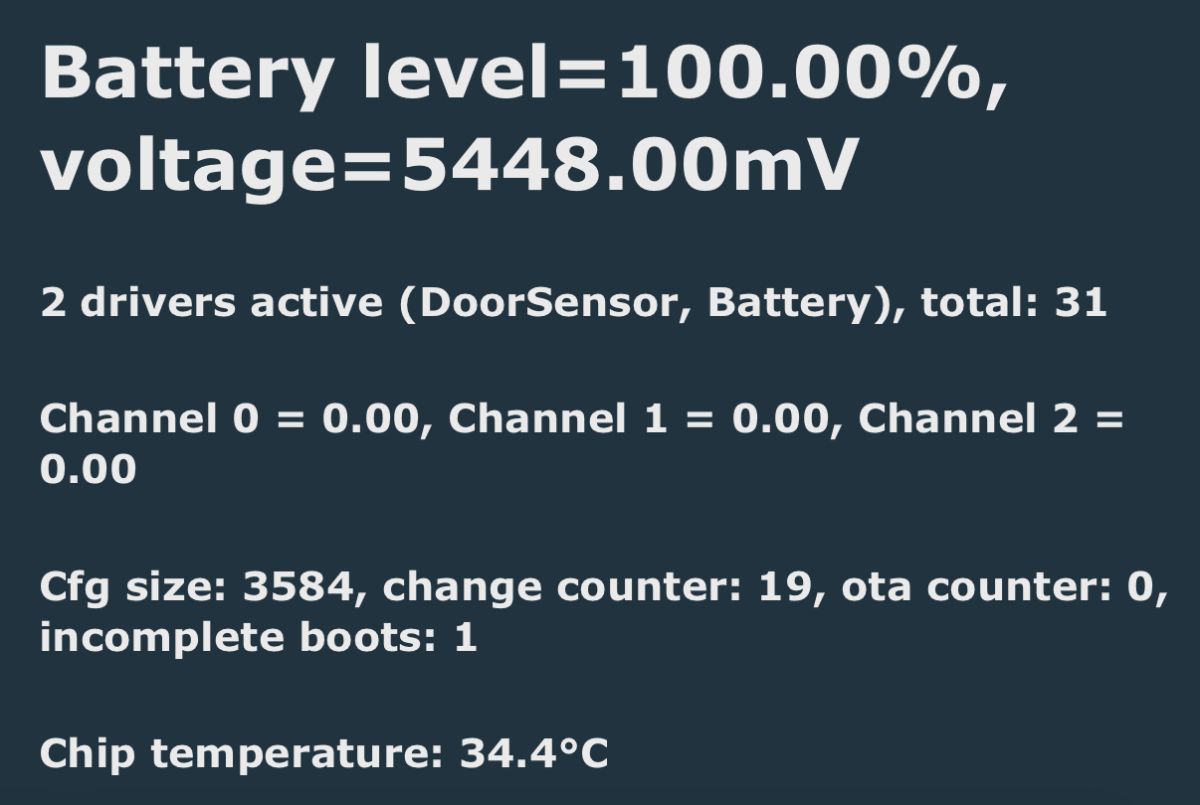

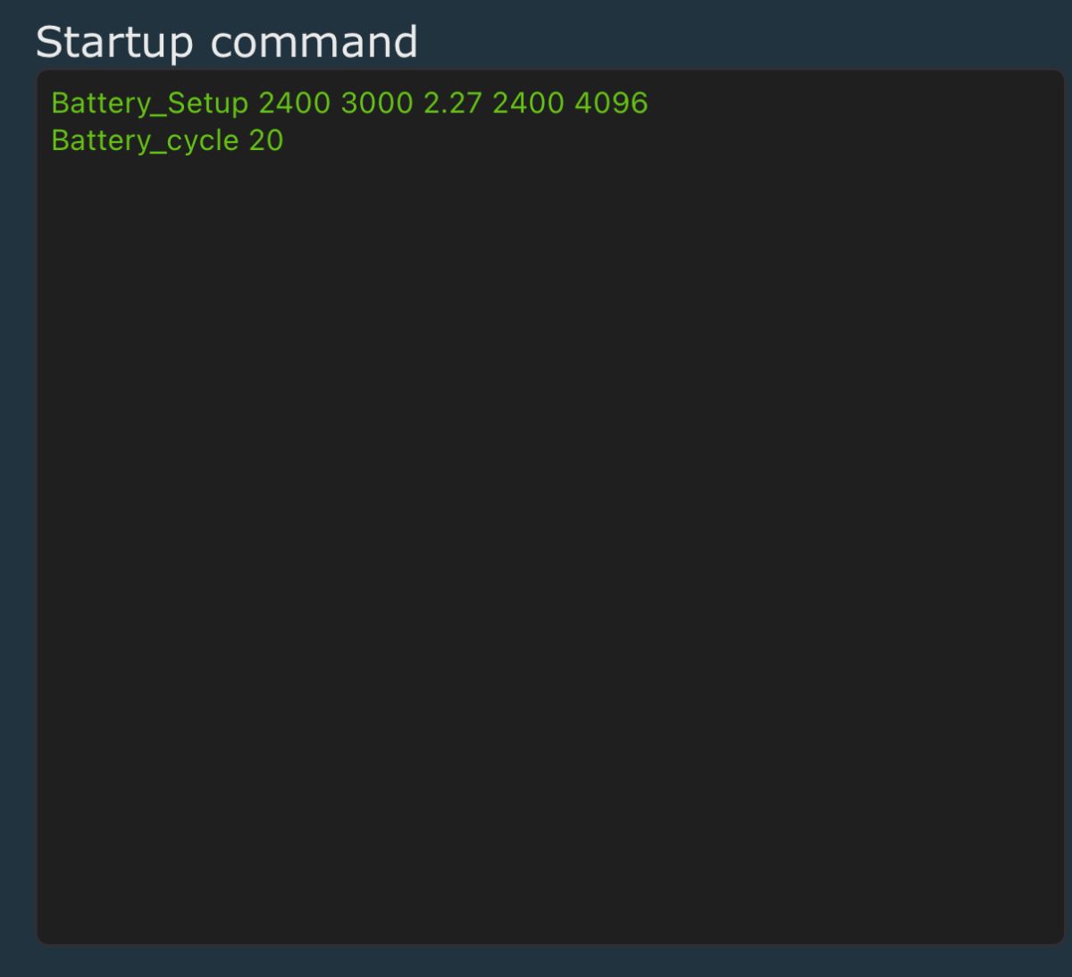

    Okay, I'm really at a loss. If I'm not mistaken in my previous post (>>21639881)...
    RS1 = 01D = 100 kΩ
    RS2 = 87C = 78.7 kΩ
    .... and ElektrodaBot is right (>>21640228), then the voltage divider should actually be correct:
    78.7 / (100 + 78.7) ≈ 0.441 → multiplier ≈ 2.267
    But, I found out, that regardless of the correctly calculated voltage, the voltage displayed by OBK does not change at all when I apply different voltages between 3.0 and 3.2. Or does it not change because it is beyond the defined maximum?
    Or maybe PINs I found out earlier here (>>21634433) are incorrect?
    P14 : BAT_Relay = Channel 1
    P23 : BAT_ADC = Channel 2
    Uaaaah
    Added after 5 [hours] 27 [minutes]:
    Does nobody have any idea what else it could be? Have I misread or miscalculated? Do you have any tips on what could be changed or any other advice?
    I'm really sorry to keep bothering @p.kaczmarek2 and @divadiow with this, but I'm really at a loss...
    Even with a voltage between the defined limit values, I still get a completely wrong value in OBK:
    Screenshot showing Battery_Setup and Battery_cycle commands in OBK configuration
    OBK system display showing voltage 5448.00 mV and battery level 100.00%
    Multimeter showing 2.815 V while measuring an electronic board

  • Wrong battery relay pin caused the issue
    #110 21641581
    gramais
    Posts: 48
    @p.kaczmarek2 / @divadiow
    Yesssss: it was the wrong Battery Relay PIN!!
    (=> see quoted yaml-extraction below)
    Yipeee: works like a charm now.
    One very last question remains: Does the
    min_V:2200
    refer to the device's Minimum voltage to be operated? And if so, wouldn't it be wise to set the battery driver to a value around or even to avoid "deep-sleep-wake-up"-issues? What would you eventually suggest?

    #113 21706916
    gramais
    Posts: 48
    @p.kaczmarek2
    Hi!
    The 25 sensors have been running reliably for about 4 weeks now. However, I have noticed some strange behavior: the battery charge drops to a maximum of about 70-80% and then the devices go offline. When I measure the battery voltage because I notice that they remain offline, the batteries are significantly discharged.
    Do you have any idea what could be causing this?
    I bought special Li-ion batteries to maintain the 3V as reliably and for as long as possible.
    P.S.: It can't actually be the batteries (alone): I tested them in my model railway, which I ran for several hours and measured repeatedly. There, they discharged as expected, very slowly and not as suddenly as in the sensors...
