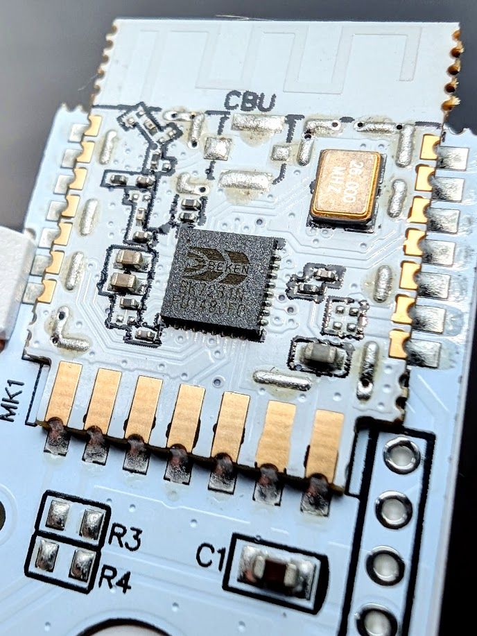

[BK7231N/CBU] Door sensor without TuyaMCU - how to connect to UART RX/TX
gramais 18831 112
How can I connect to the BK7231N UART RX/TX on this Tuya door sensor without desoldering the chip or module?
You don’t need to access the backside chip pins: this board uses a CBU module with the BK7231N, and its UART1 pins are already broken out and easy to reach [#20486243] The pads marked on the board are most likely R = RX, T = TX, G = GND, and V = 3.3 V; RST is reset and SWS is the serial-wire/debug pad [#20486243] The reply also points out that TX1 and RX1 are the relevant accessible UART pins on the CBU module, so you can use those for flashing/serial access instead of desoldering anything [#20486243]

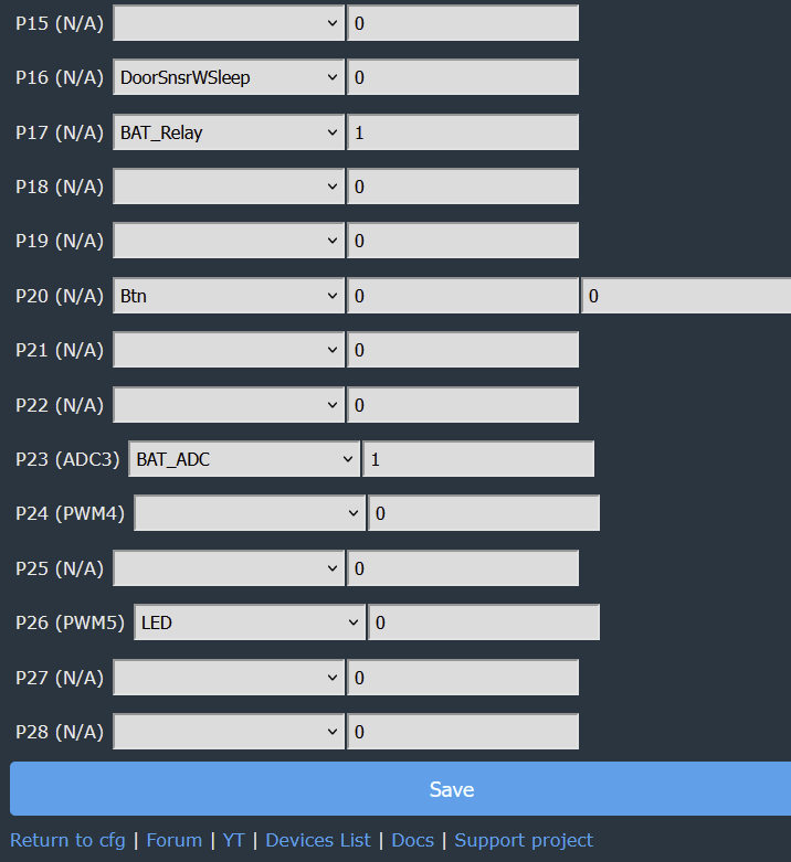

    Okay, so I have set
    BAT_Relay
    to channel and to channel in module config section. And I am pretty sure startup command syntax is incorrect (see screenshot below) as get these supposedly incorrect values:

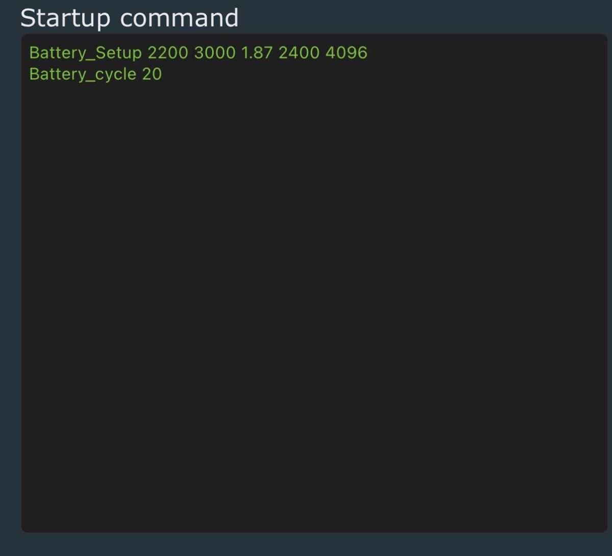

    Startup commands: Battery_Setup and Battery_cycle with numeric parameters
  • Incorrect battery voltage reading with Battery_Setup 2200 3000 1.87 2400 4096

    Here's what I've set up so far:
    “BAT_Relay” (Channel1)
    “BAT_ADC” (Channel2)
    Startup command:
    Battery_cycle 20
    Unfortunately, I am getting incorrect values:
    Battery level =100.00%,
    voltage=4488.00mV
    What can I change to measure the battery voltage correctly?
    I would appreciate any help!

  • Check ADC divider and battery driver first
    #86 21638979
    Posts: 14767
    Rate: 12909
    Maybe you got incorrect vdivider value? Maybe you can check with multimeter how is ADC connected.
    It is usually recommend to first get Battery driver working withou configuring deep sleep, and then move to deep sleep.
    Still, I don't have that much experience with WiFi battery powered devices. WiFi isn't too efficient in general (even with Tuya firmware), probably Zigbee is safer when it comes to battery-powered devices.
    The issue with devices not booting is known, but we don't have final solution yet. Of course, restoring flash backup should work. Otherwise we might need to try to reproduce it ourselves, maybe with variable power supply and investigate which part of flash breaks, exactly. Do you have variable power supply, @divadiow ?

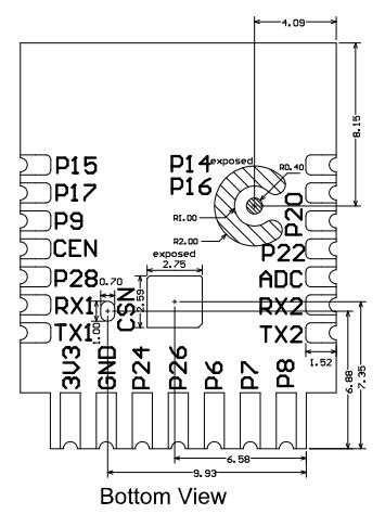

    Hm can you make a photo of your board? How is your ADC connected? How it corresponds to the schematic from tutorial topic?
    If you have the version as in this topic, then here is CBU pinout:
    Bottom view of a module with labeled pins including ADC, RX, and TX
    Does it connect to two resistors?
    I think you can change MAC in OBK for Beken but you will still have imperfect RF calibration (taken from another device)
