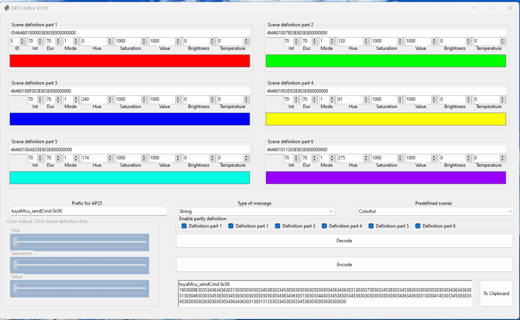

    As you can see, the header is still HEX, but the Tuya message is ASCII coded.
    19: DP25
    03: String type
    0036: Lenght (54 char)
    303434363436303230303738303345383033453830303030303030303436343630323030373830334538303030413030303030303030
    decoded: 04 46 46 02 0078 03E8 03E8 0000 0000 46 46 02 0078 03E8 000A 0000 0000
    I wrote a tool for encode/decode scene messages...
    DP25 Editor V1.03 software interface with scene definitions.

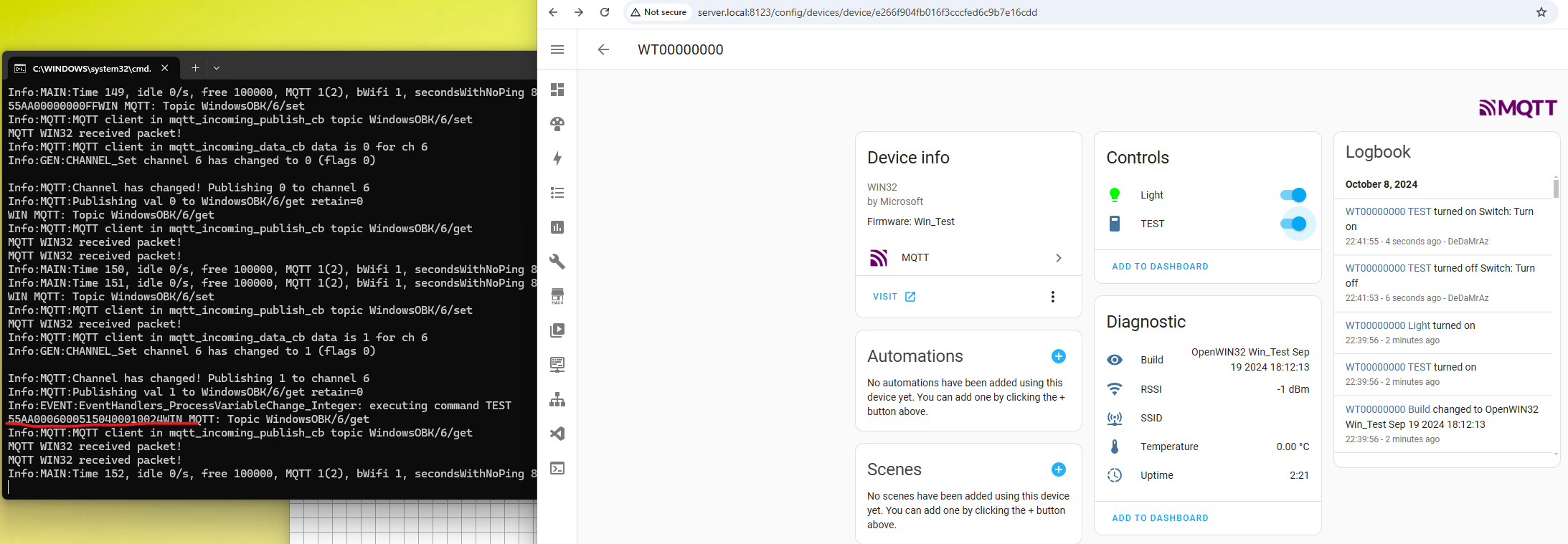

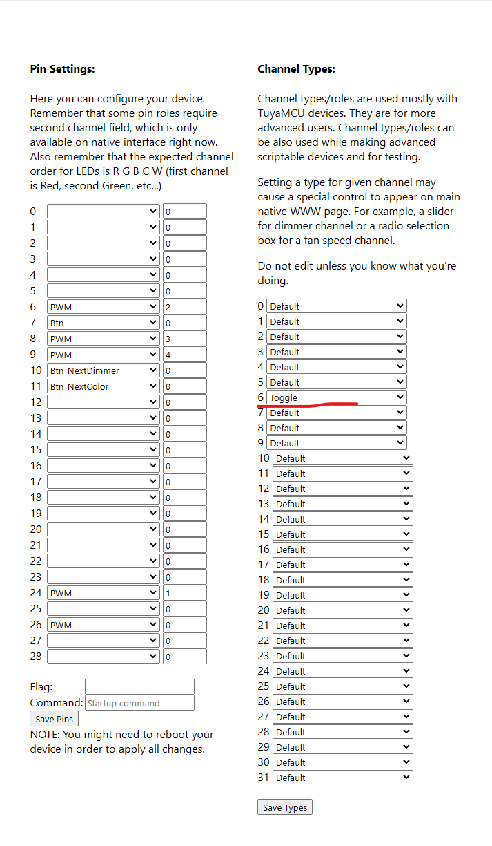

    @theosoft
    This is a general idea that you can expand on.
    startDriver tuyaMcu
    alias TEST tuyaMcu_sendCmd 0x06 1504000100
    setChannelLabel 6 TEST
    publishChannel 6
    addChangeHandler Channel6 == 1 TEST
    To set the CH6 to Toggle go to webapp/config.
    Screenshot of the configuration of pin settings and channel types in a TuyaMCU device.
    There are other ways to do this, it is just one example of course, and idea to play around with.
    Screenshot from the simulator of TEST toggle.
    Screenshot showing CMD console on the left with MQTT information, and a device configuration panel in a web app on the right.
    Remember after these changes delete the device from HA and do rediscovery.
    Let us know if that worked for you.

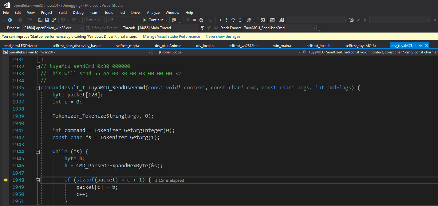

  • #49 21257161
    Posts: 14615
    Help: 655
    Rate: 12631
    The limit is 128 bytes packet and you reach 58 bytes it seems:
    Screenshot of Visual Studio editor with a source code file open.
    Code editor window in Visual Studio with a C language code snippet.
    I've tried to replicate your problem with a self test, but is passes correctly both when run from command interface, and also when run from LittleFS....
    https://github.com/openshwprojects/OpenBK7231...mmit/f5d8d602c4526363e31af5309fab2704306de597
    @DeDaMrAz can you check on any device whether this command really sends what we expect on UART?
    Expected result is:
    55 AA 00 06 00 3A 19030036303035413030303130303738303345383033453830303030303030303030303030313030303030303030303030303030303030303030 18
    spaces added only for clarity, treat it as hex string (remove spaces)

    theosoft
    Posts: 37
    >>21257161
    I found a buffer with the size of 128 in the autoexec.bat part. Made a quick search :-)
    file: src/cmnds/cmd_main.c Line 940.
    commandResult_t CMD_ExecuteCommand(const char* s, int cmdFlags) {
    const char* p;
    const char* args;
    char copy[128];
    Is the line in the autoexec.bat to long to be executed correctly?
    Edit: I checked the string inside of autoexec.bat and it is exectly at pos 128 where the string is cutted. So i think the buffer to copy the command as string is to small.
    With the long messages for scenedefinitions i reached that limit. Is it possible to increase the buffer char copy[128] up to 1024? Or dynamic?
    regards

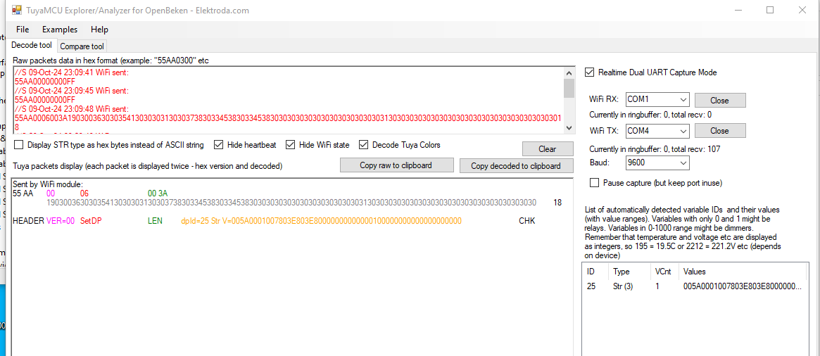

    This is the result I got from this command on a CBU module
    tuyaMcu_sendCmd 0x06 19030036303035413030303130303738303345383033453830303030303030303030303030313030303030303030303030303030303030303030
    Screenshot showing the TuyaMCU Explorer/Analyzer for OpenBeken with raw packet data in hexadecimal format.
    @theosoft
    That is not the case, each character in your command is a single byte, for example 30 is a hex converted to byte it is 1 byte or 8 bits (00110000) so in theory for you to oversaturate that buffer you will have to send 256+ hex characters. Or at least this is what I think as I didn't look into the code for any other checks and conditions.
    You can also see that in the output where converted to 005A0001007803E803E80000000000000100000000000000000000 you are only sending 54 bytes.
    EDIT: it is maybe because it is unclear that tuyaMCu_sendCmd is using HEX and that is causing confusion.

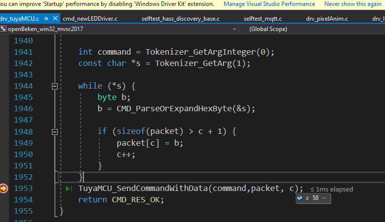

    Posts: 14615
    Help: 655
    Rate: 12631
    Are you using latest OBK?
    Code: C / C++
    This buffer is only used to store command name, not arguments. Check the whole code. Futhermore, as I said, self-test with UART passes correctly, so I would rather suspect that Beken UART queue is at fault.
    This won't change anything due to the reason said above.
    I will repeat what I said in my previous post.
    I've tried sending this message from autoexec.bat and from alias in self-test:
    Code: C / C++
    All those tests are passing correctly. So either problem is somewhere else or is platform-specific, but buffer sizes are the same on all platforms?
    Maybe you have wrong trail and you meant that http button has limited buffer?
