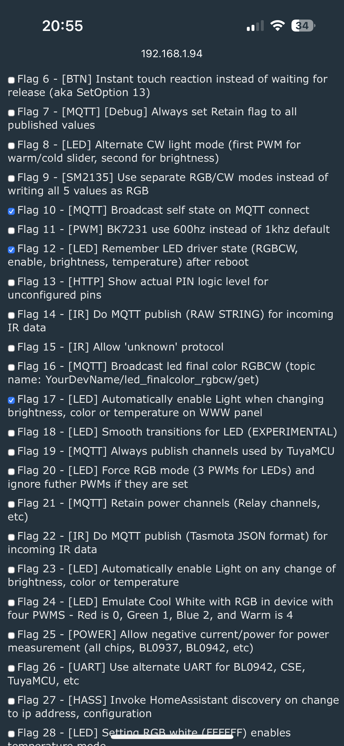

    I cannot reproduce it. I have switched the Flag 12 and 17 off and on again. I don't know what happened the first time.
    But with Flag 17 it is not possible to switch on with Smart Button when the LED is off and you press directly long the button. You know what I mean?

    mplum wrote:
    But with Flag 17 is Not possible to Switch on with Smart Button when the led is off and you Press directly Long the Button. You Know what i mean?
    Ah ok, I understand now! This is because this flag is only for WWW, and you want it for Smart Button as well? Or maybe in general to make that work... it makes sense, I think! Let me see....
    https://github.com/openshwprojects/OpenBK7231...mmit/d441a9d9685cb3ba56840c739d3ab3cf863e2d64
    Done, it should work that way, can you check next release?

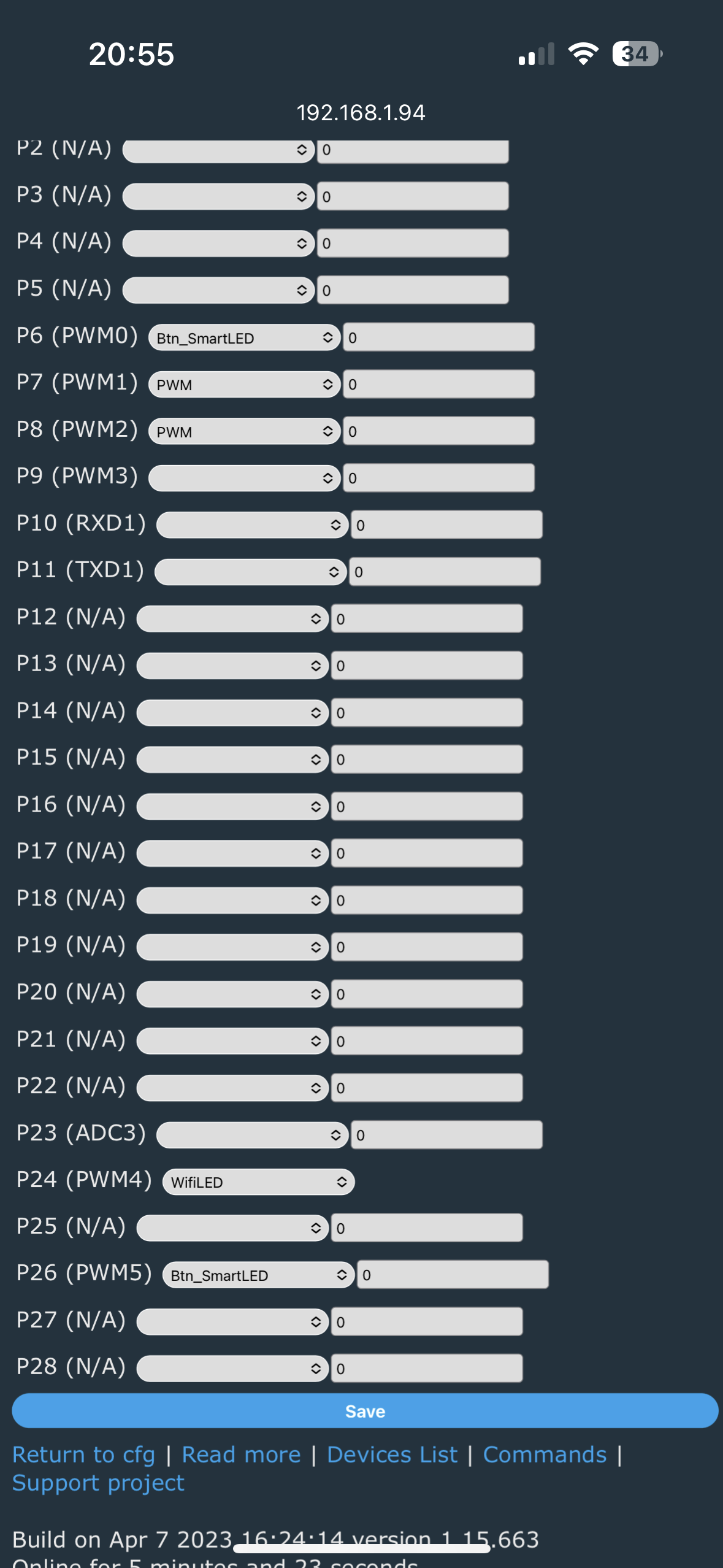

    now i have the same problem again. no matter what I do. if I switch on flag 12, then I can't control the LED either via the buttons or via the website. Channel always remains 0
    I have P6 and P26 as BTN script only
    P7 and P8 as PWM Channel 0
    P24 WiFi LED
    In the configuration, if I turn flag 12 off and turn on flag 17, I can dim and switch again, but when the LED is off and then long press to dim, the LED doesn't go ON.
    If I take a Smart Btn then it works, is that possible?

    But there are Problems with the flags.Flas 12 and 17 is on.
    On the first device Flag 12 and 17 is on.
    The remember of the LED driver state is ok.
    But the led go not on when the led is off and i press long the button.
    That is only working with smart_BTN
    And the 2nd Device.
    When i activate Flag 12 i cant use the unit. I cannot switch on or off. not with the button, not in the Web portal.
    I have restart again and again, but its not working.
    when i deactivate the flag it is working, but without save the Dreiver state

    Other question. I have use Flag 12. To save the state when you switch off.
    But i see in the log that all Change off the Channel will be saved. Is this a Problem whith the write cylen?
    When i use BtnHold with Add_Dimmer then every step will be saved.
    For exampel is it better to save when you Release the Button.
  • #45 20554657
    Posts: 14584
    Help: 654
    Rate: 12608
    You have raised a good concern, but our flash memory system is very flexible, when it comes to saving state. We are doing multiple flash writes per single erase cycle, thanks to the system designed by a contributor. At the current state of things, unless I'm much mistaken, the sector size is 4096 bytes and we write 64 bytes (or so?) per cycle, so 4096/64, so we have 64 cycles per erase.... furthermore, flashvars reside over two sectors, so the wear is also 2x slower.
    Futhermore, BK7231 identifies as EN25QH16B , which has minimum 100k endurance cycles.
    And with our system (doing 64 writes per one erase, or even 128 if you count two sectors), then we have 128 000k save states until flash wears out...
    even if we assume it's an order of magnitude lower, it's still much
    Maybe I am optimistic here, but I think there is no need to worry about that.
    Still, we are considering to make a change to our system and for example only save LED state every 10 seconds when it's marked as modified, but this may also have drawbacks, if user changes LED state and turns off power quicker.. what do you think?

    I think I found the problem with flag 12.
    If you activate the Flag12, then submit, then save and if you then restart directly without having sent an LED command once, it won't come out of there anymore.
    If you set Flag12 submit and save and then dim back and forth a bit and then restart. Then everything works.
    And another problem with the command:
    ClampChannel 0 5 100
    I have it in my autoexec.bat script and my LED always goes on when I restart. Should that be so? I thought that just sets the limits.
  • #54 20559673
    Posts: 14584
    Help: 654
    Rate: 12608
    Hmmm flag 12 only saves LED state on change so it is basically expected. But we assume that users set flag 12 at the beginning of configuration so it's not the big deal that first state after setup is not saved, is it?
    Or do you mean there is another problem?

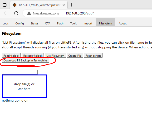

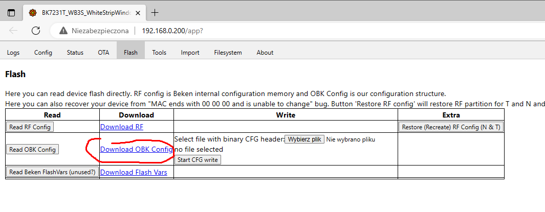

    The recommended way to copy configuration is download OBK config and then upload it again:
    Miboxer FUT036w and CB3s Issues: Flashing Firmware, WiFi Connectivity, and Button Control
    This will copy everything except MAC address which must be unique and except LFS.
    For LFS (files, autoexec.bat) you can download TAR backup (archive) here:
