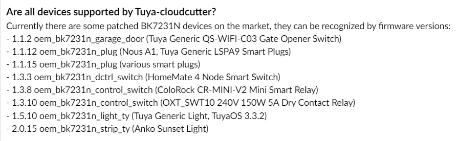

    According to this:
    https://www.elektroda.com/rtvforum/topic3979215.html
    1.3.5 is not marked yet as patched:
    List of firmware versions of devices supported by Tuya-cloudcutter.
    The log indicates that exploit has ran:
    Found access point name: "GRID-23A4", trying to connect...
    Device 'wlan0' successfully activated with 'redacted'.
    Connected to access point.
    Waiting 1 sec to allow device to set itself up...
    Running initial exploit toolchain...
    Exploit run, saved device config too!
    output=/work/configured-devices/jpw2un7yZBw6.deviceconfig
    Saved device config in /work/configured-devices/jpw2un7yZBw6.deviceconfig
    is device still with Tuya? Do you have that deviceconfig file? Can you share it?
  • #41 21064293
    kennelloggia0r
    Yep, I had two, bricked one, and returned to the shop and got a new one. So I have two again, one not in the app and one that is still in the Smart Life app. How do I grab device config files there?
  • #42 21064537
    Posts: 14611
    Help: 654
    Rate: 12622
    Well, according to the log you posted, the config was saved on your computer:
  • #43 21064541
    kennelloggia0r
    I learn something new every day...
    Assuming you didn't need the other bits.... here is the crux of it.
    "chip_family": "BK7231T", "profile_name": "1.3.5 - BK7231T / oem>
    Interesting that I also had this one which had failed on 1.1.8
    "chip_family": "BK7231N", "profile_name": "1.1.8 - BK7231N / oem>
