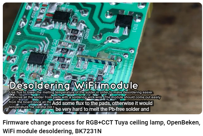

    TLDR: it looks like a high state on TXD1 at reboot time breaks OTA?
    I can try with both version, I'll start with the originals first.

  • #52 21036090
    Posts: 14750
    Rate: 12866
    Even if you have to remove the CB2S/WB2S from the unit, it's not usually a big a problem. We have some guides showing that process. All you need is a soldering iron, some flux, some Pb solder, and soldering wick wire. Check out this CB2S-based lamp flashing guide:
    Close-up of a circuit board with a WiFi module being prepared for desoldering.
  • CB2S/WB2S removal with solder wick

    gen_mheloy
    Posts: 11
    >>21035769
    Hi,
    I have 1 of the version T and 4 of the version N... 3 out of the 4 are working fine witht the use of cloudcutter... the 4rth is doing solid red and have opened it to try to flash manually but no luck. now 1 of the N version is not working as well... no lights and also the relays arent responding when I pressed the button on top...
    So as of now I 1 T version working with OpenBeken and 2 N Version with OpenBeken
    Thanks kaczmarek2, yup waiting for the wick to be delivered so I can remove it correctly
