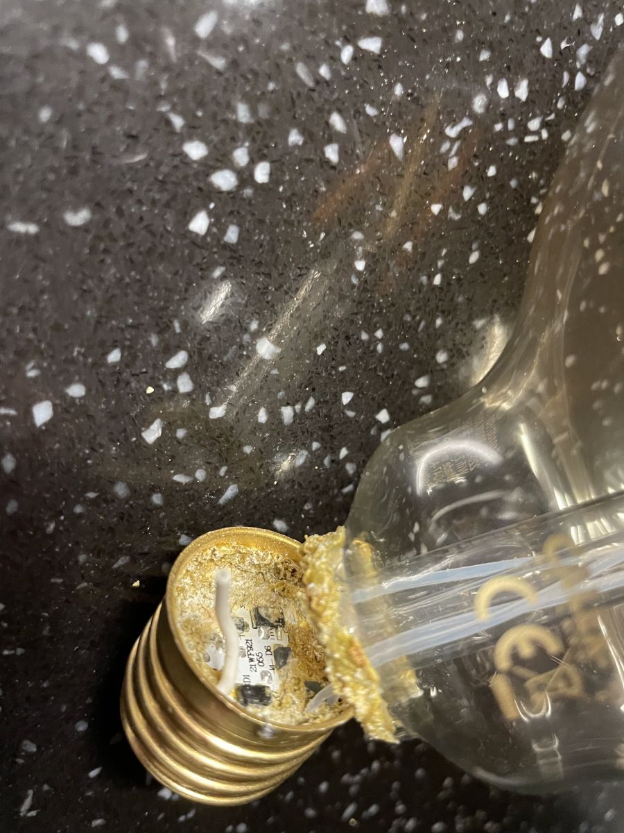

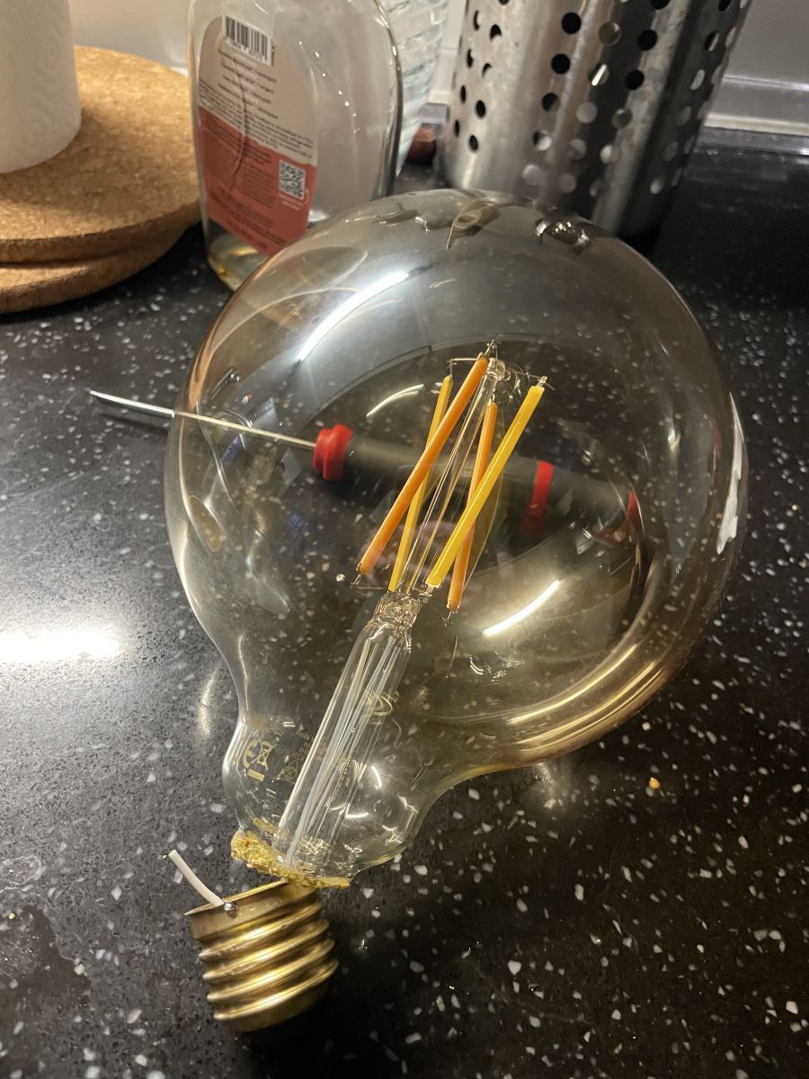

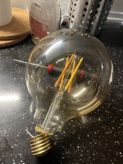

    Teardown
    Wrapped a folded paper towel around the socket and applied a light force all around, twisting it to crack the adhesive. Shortly after, I was able to non destructively open it. The bulb part is completely sealed and all the electronics are located inside the socket
    [BK7231N /CBLC5 ] Calex Smart Globe G125: LED Lamp, Tunable White, Dimmable, WiFi E27

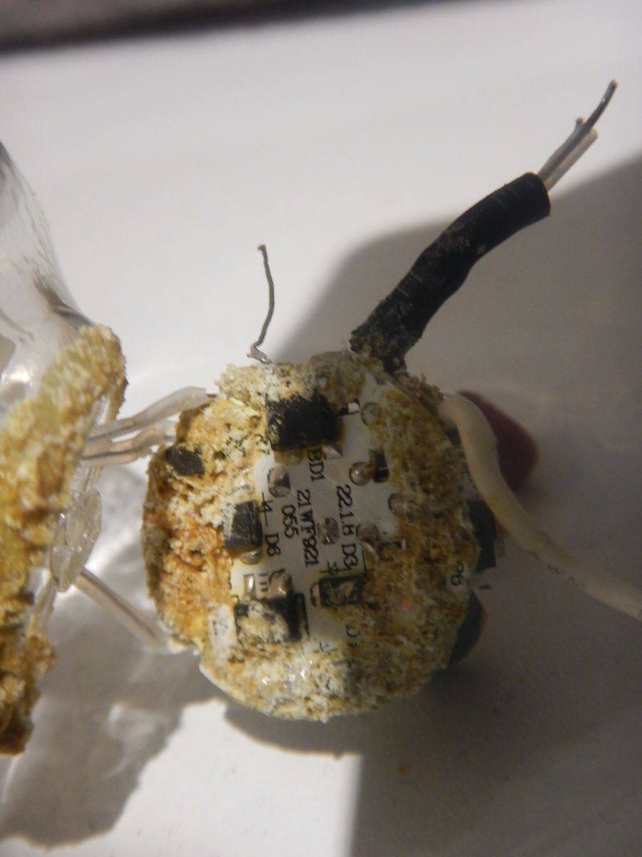

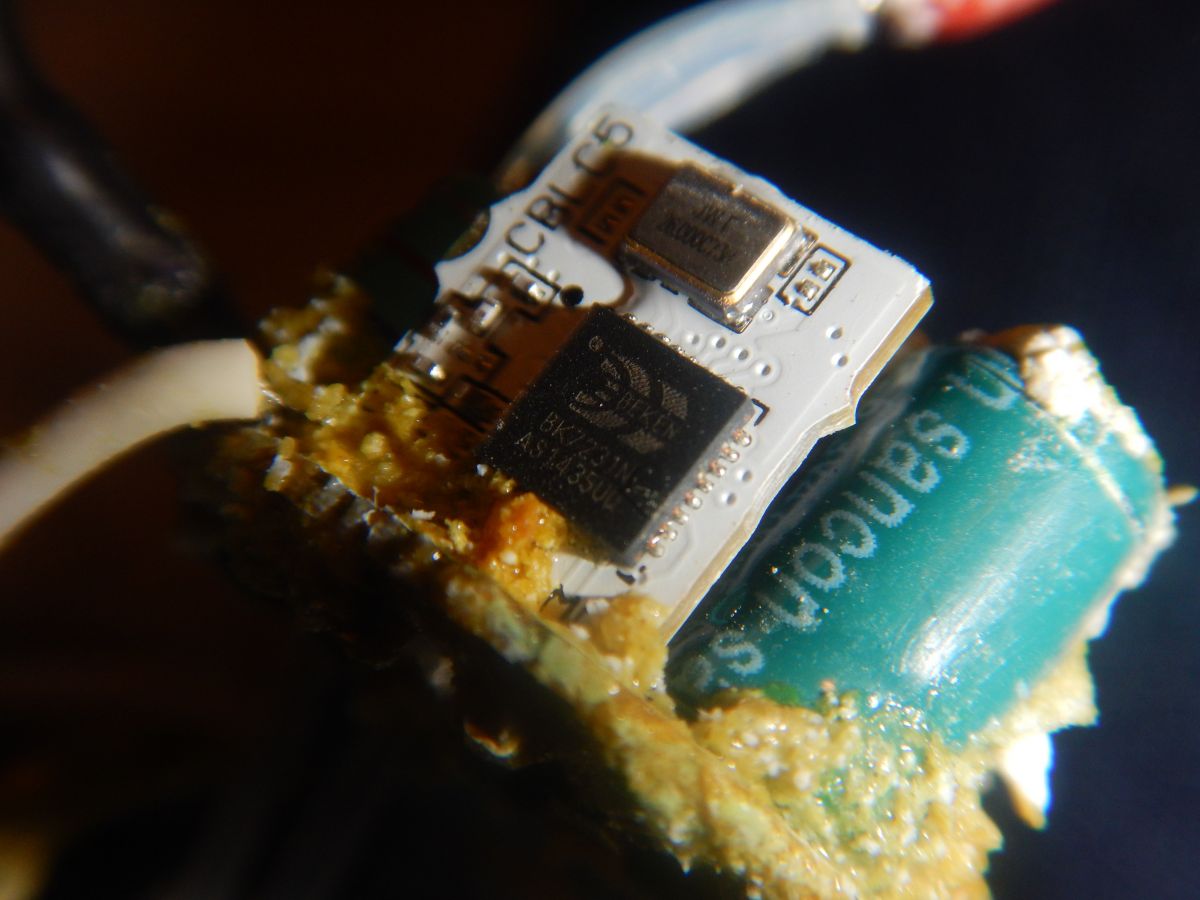

    After a lot of prying, I was able to get the board out and have a look at the CBLC5 module
    I was actually able to reassemble it and glue everything back together, but I would not recommended trying

    CBLC5 is very tiny, but it is still impressive that they managed to fit it inside the thread.
    How does the light from this bulb looks in reality?
