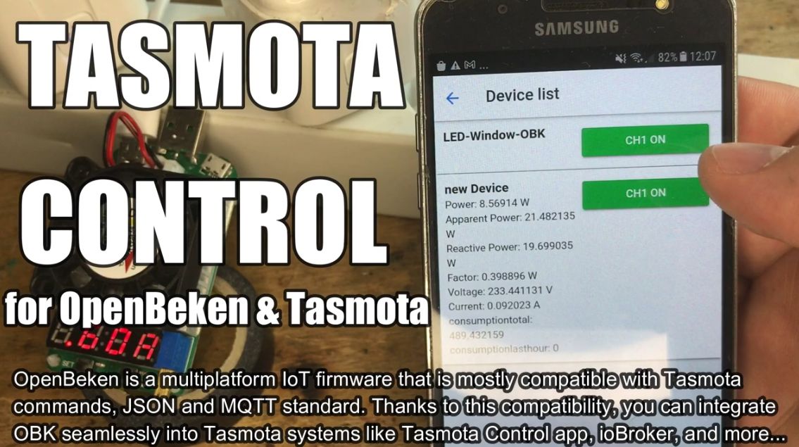

  • Tasmota Control app from Google Play controls Tasmota and OpenBeken devices on a local network without any external server.
  • It sends HTTP commands through the Tasmota REST JSON interface, and OpenBeken works because it matches the Tasmota JSON format.
  • The approach supports BK7231N, BK7231T, BL602, W600/W601, W800/W801, and XR809 devices.
  • Each device needs a static IP before pairing, then the app provides serverless control without Home Assistant.

    Here's a short presentation showing how to use Tasmota Control app from Google Play to control Tasmota and OpenBeken devices. Tasmota Control allows you to control TAS/OBK devices on your local area network without any external server. No Home Assistant is needed. Tasmota Control works by sending HTTP commands via Tasmota REST (JSON) interface to Tasmota devices. OpenBeken is compatible with Tasmota JSON format, so it works with Tasmota Control as well. All you need to do is set static IP for your device and add it to the app, here's full guide:
    Following approach works for all supported platforms, and since OpenBeken is now multiplatform, it works for BK7231N, BK7231T, BL602, W600/W601, W800/W801, XR809, etc.
    Keep in mind that OBK is also compatible with Home Assistant, so if you prefer HA approach, watch this video instead:
