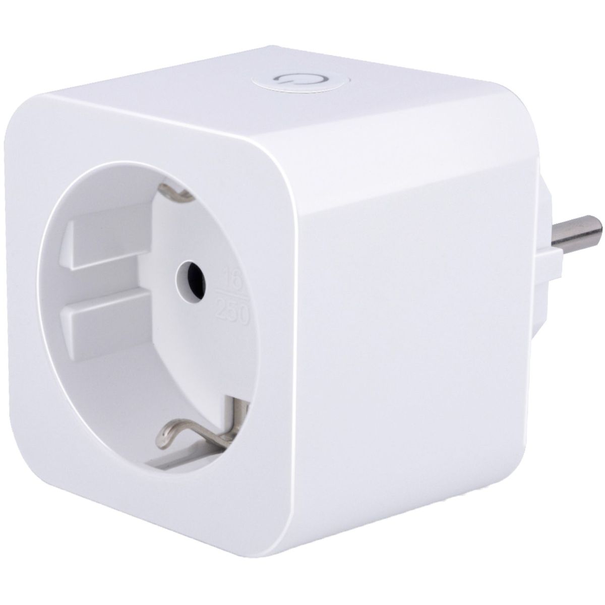

    The Wifi Smart Socket EU (SPL-W-TY-PM-EU-RY-L) by Sky-Lighting has been available under various brand names since around August 2022, for example at Action DE, Amazon.de and Calex. There is a variant with 10A at a maximum of 2500W and another with 16A at a maximum of 3680W, which are usually integrated into the smart home using the Alpina Smart, Calex Smart, Hema Smart, LSC Smart Connect or Smart Life app.
    White smart plug with power button on top and socket in front OpenBeken for Wifi Smart Socket EU (SPL-W-TY-PM-EU-RY-L) by Sky-Lighting with CB2S and BL0937
    ManufacturerSky-Lighting
    Model nameWifi Smart Socket EU
    Model numberSPL-W-TY-PM-EU-RY-L
    PCB nameWF02GE, WP02GE, WP02GE-F, WP02GE-F
    PCB date2021-08-23, 2021-06-06, 2023-08-04, 2024-07-21
    Products
    Brand nameAlpina Smart HomeAlpina Smart HomeAntelaCalex SmartHema SmartLSC Smart Connect
    Product nameSmart Wi-Fi PlugSmart Wi-Fi PlugWiFi Smart PlugPower Plug?Smart Power Plug with Energy Monitoring
    Product number2654526546AN-EU-Plug-TD2022065201000300??
    GTIN-13 (EAN-13)87112522654528711252265469?871287916131887203543130538712879159025
    Article number871125226545871125226546?429198.2?20.07.0001?3202087
    Principle of operation
    The plug type is E+F and the socket type is F, while energy measurement is performed using a BL097. The connection to the Tuya cloud is carried out using the CB2S radio-frequency module by Tuya, which has a BK7231N microcontroller by Beken.
    Firmware flashing
    It is not possible to disconnect from the Tuya cloud using CloudCutter, as the pre-installed firmware version 1.1.17 with class oem_bk7231n_plug has already been patched against the known vulnerability.
    Therefore, OpenBeken must be flashed via the serial interface (GND, 3V3, TX1, RX1). Here you will find instructions and pictures on how to open the case as well as flash the firmware.

    Firmware difficulties
    Am I correct in understanding that the calibration depends on the model, or does it have to be done individually for each device? If someone has determined generally applicable values, would they be willing to share them?
  • #2 21773629
    Posts: 14768
    Rate: 12909
    Thanks for sharing! Don't forget powersave 1 in startup command.
    Calibration is recommended to be done per piece, just like with Tasmota.
