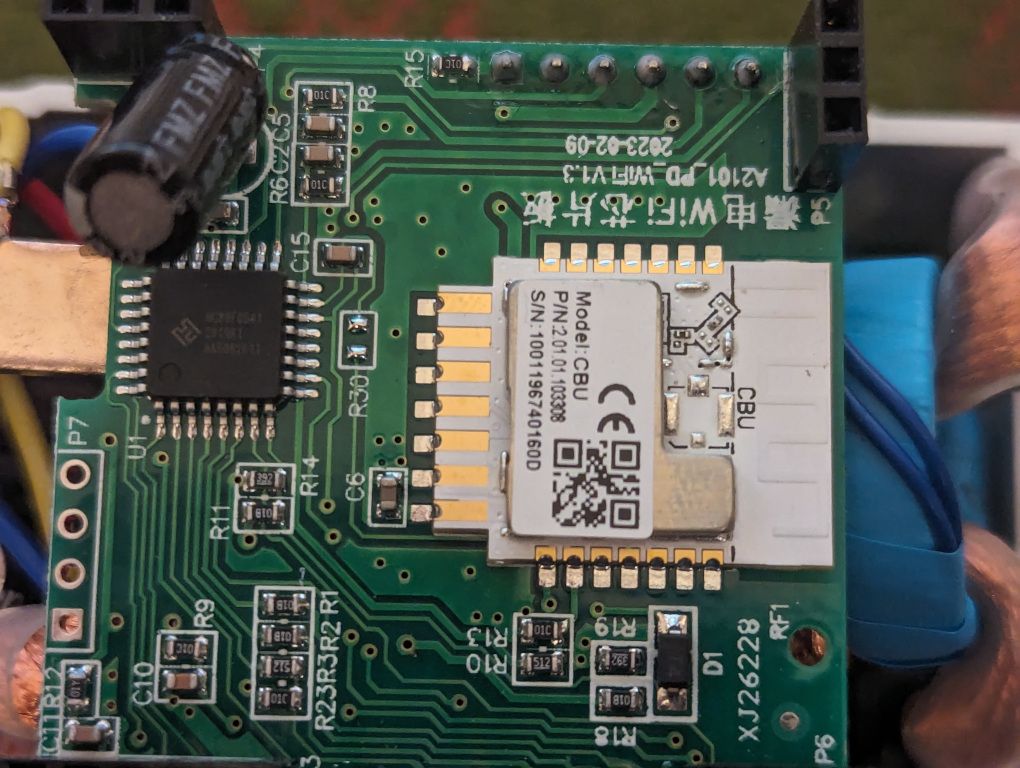

    njhuiz
    Posts: 10
    Close-up of a circuit board with electronic components, including capacitors and an integrated circuit.
    I've just got a brand new device with a colored display. It seems to be the same like the other one on page 2 from November 2023.

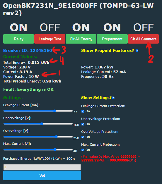

    Angel0fDeath wrote:
    @morgan_flint Any news on testing?
    Hello and sorry for the delay!

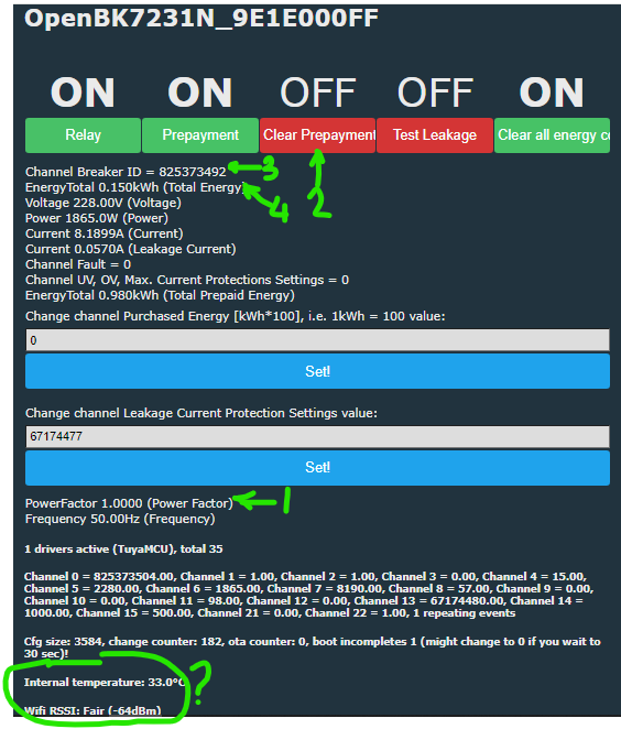

    In general, everything seems to go well, but there are some label/scale errors, as you can see in the following images with the comparison between the standard OBK and the improved one :
    Screenshot of the OpenBK7231N interface with marked areas needing label and scale corrections. Screenshot of the OpenBK7231N user interface with errors in displayed data.

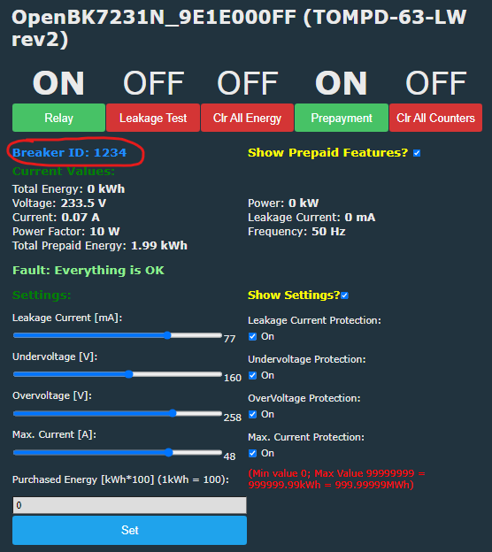

    1: The power factor is wrong by a factor of 10 and should have no units (shows 10 W and should be 1.000 (in the device's display it has 3 decimals, so that must be the real resolution, although 2 decimals could be good enough)
    2: The button labeled "Clr All Counters" in the improved one only clears prepaid energy, so it should be "Clr Prepaid Energy" (the one labeled "Clr All Energy" clears both, so this label is Ok but could also be "Clr All Counters")
    3: Breaker ID in the app was only 1234 (see here). Also, 825373492 that shows in the OBK for that DpID translates to 31 32 33 34 hex so 1234 in ASCII. This must be because this field in this device is half the size of the same one for the other device.
    4: The total energy counter is out by a factor of 10, as it shows 0.015 kWh while in the display is 0.1, and in OBK it shows 0.15. From the DpID value, I think the real resolution is 2 decimals
    Also, OBK interface shows SSID; if it's not too complicated, it would be good to have this also in the improved one, possibly only if "Show settings" is activated. I also see a temperature shown in OBK's interface... @p.kaczmarek2 : Where does it come from? Maybe an internal sensor in BK7231? Because it's not between the DpIDs and, although the Tuya App had a page with 4 temperatures, all of them showed NaN

  • #99 21004367
    Angel0fDeath
    Posts: 118
    Rate: 33
    @morgan_flint Ok. Will make the corrections. What about dpID 21. Did you isolated it or now everything is ok?
    Breaker ID - your response (DP command) for this dpid returns "1234("B" (see your previous post). However from raw answer (in the same post) I can see tuyaMCU sends only 31 32 33 34 and then makes integer. This means we have again wrong parsing or maybe not zeroing the array. @p.kaczmarek2 Can you please check this issue?
  • #100 21005072

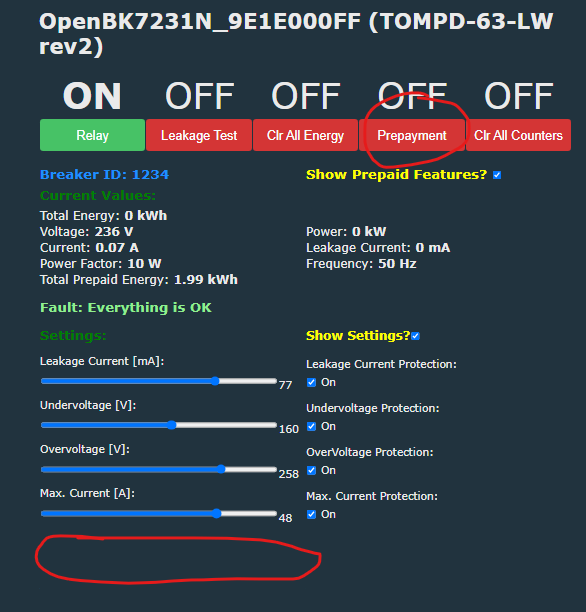

    Rate: 60
    DpID 21 (test leakage) works well, and also DpID 12 (clear prepaid energy counter).

    Clr All Counters10122
    In OBK's original web interface, all of them, except for the last one, seem to work as expected (change status when clicked). In the case of DpIDs 12 and 21, they only perform the associated action when changing from 0 (red) to 1 (green) and nothing happens in the opposite transition, as we could expect. In the case of the last one (DpID 101), after resetting the device it appears in red but, once clicked, it stays at green forever, but even in this case, clicking on it clears counters as it should.
    In the improved web interface, there's a difference on DpIDs 12 and 21 (Clr prepaid and test leakage), as clicking on them performs the corresponding action but they stay red. I think We commented on this before and it is intentional, as it avoids having to toggle back them to 0 manually. It would be nice a nice feature if they "blinked" to green momentarily, to have visual feedback when clicked, but it's not mandatory.
    DpID 101 "strange" behavior is a bit perplexing; I don't think it's a problem neither in OBK nor in the improved web, but probably a bug in the device's FW... What do you think?
    This is BK7231 internal sensor and it's available on all BK7231 devices.
    Can you provide more information on the issue or at least tell me which dpType I should investigate?
    Maybe TuyaMCU sends a string without NULL terminating character so I need to add that manually?

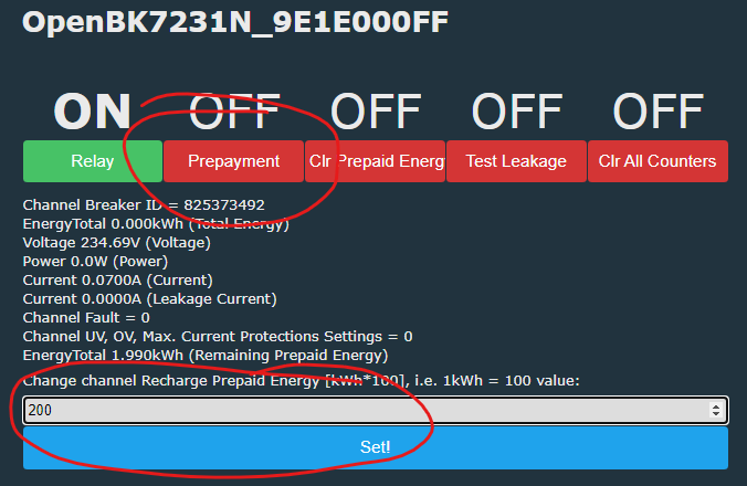

    Screenshot of the OpenBK7231N user interface with energy settings and values.
    >>21004367
    @angelofdeath, another suggestion for the improved web page, if you consider it right: The box to add purchased energy disappears when "Prepayment" is off:
    Screenshot of the OpenBK7231N interface with visible settings and buttons.
    I understand you did this on purpose, as loading prepaid energy only makes sense if you're using the prepayment function, but I find it interesting to be able to load this counter before switching prepayment on. For example, if you have cleared counters and then switch prepayment on, the relay switches off until you load prepaid energy. In the same situation, with the standard OBK interface, you can load prepaid energy before switching prepayment on, thus avoiding the momentary blackout:
    Screenshot of the OpenBK interface regarding prepaid energy functionality.
