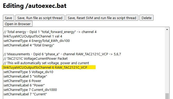

    I'm attaching my actual autoexec.bat for this device:
    Added after 17 [minutes]:

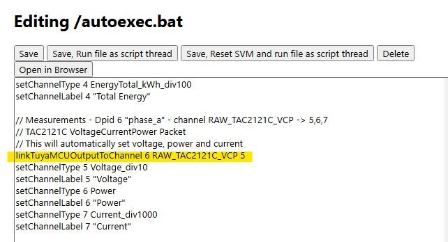

    @p.kaczmarek2 :
    I've found a misfunction in this device after upgrading OBK: voltage and current stopped working, and also the relay switched on by itself after switching off from the web interface.
    I noticed this when updating to OpenBK7231N_1.17.808; then went back to previous versions I had in my HD and saw it worked again OK with OpenBK7231N_1.17.769.
    Then, I started a dichotomic search to find out which was the version where the error started and found it was OpenBK7231N_1.17.796: with 795 everything went well but, after flashing 796, voltage and current values showed 0 while they were 230 V and 0.08 A with 795 (power was 0 for both, but probably it was because of its low value and/or resolution/rounding in 795).
    In Github's releases page, changes for version 1.17.796 states: "support multiple RAW_TAC2121C_VCP channels for devices with 3 phases, etc (6e176a3)", so it seems the changes to RAW_TAC2121C_VCP don't go well for this single phase device... This doesn't directly explain the auto-resetting of the relay but could be a side effect.
    This is the part of the autoexec.bat where I call RAW_TAC2121C_VCP, just in case the syntax should be changed to work with ver. 796:
    // Measurements - Dpid 6 "phase_a" - channel RAW_TAC2121C_VCP -> 5,6,7
    // TAC2121C VoltageCurrentPower Packet
    // This will automatically set voltage, power and current
    linkTuyaMCUOutputToChannel 6 RAW_TAC2121C_VCP
    setChannelType 5 Voltage_div10
    setChannelLabel 5 "Voltage"
    setChannelType 6 Power
    setChannelLabel 6 "Power"
    setChannelType 7 Current_div1000
    setChannelLabel 7 "Current"
    EDIT: Checked it also with TOMPD-63-WiFi, with the same results: Version 1.17.796 showing V, I, P as 0, and reconnecting relay by itself when switching off from the web or even from the device. Version 1.17.795 works OK

    #125 21364013
    morgan_flint
    Posts: 251
    Rate: 63
    >>21363783 Thanks, I'll try the fix ASAP.
    I had already found after reading your post here that, if I added the voltage channel to the syntax of RAW_TAC2121C_VCP, in my case:
    linkTuyaMCUOutputToChannel 6 RAW_TAC2121C_VCP 5
    (added 5 at the end of linkTuyaMCUOutputToChannel 6 RAW_TAC2121C_VCP)
    Then the problem with the switch dissapeared, and it started showing the correct voltage, but the values for power and current weren't good:

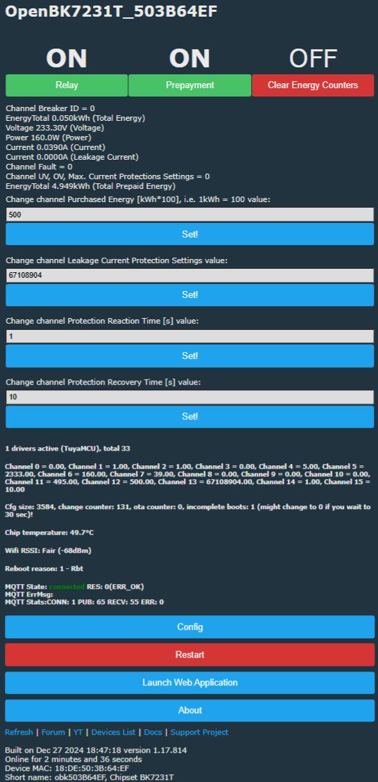

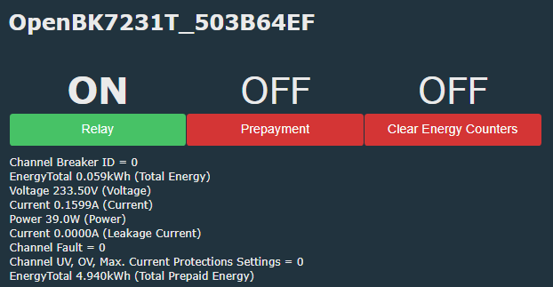

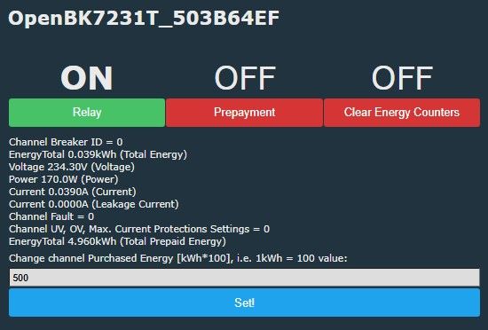

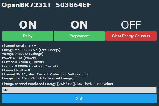

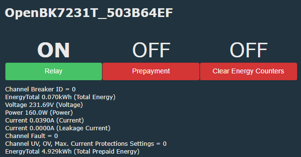

    Screenshot of the OpenBK7231T interface displaying electrical energy data. View of OpenBK7231T interface with buttons and measurement data. User interface displaying voltage, power, and current data for the OpenBK7231T device. OpenBK7231T user interface displaying various energy parameters.
    The first image is ver. 795 with "old" autoexec (without channel number at the end), the second, ver. 812 with old autoexec (shows 0 witha ll measurements), the third, ver. 812 with autoexec corrected (shows correct voltage, but higher power and current). The last one is to check if the new syntax works OK with old version (795), which apparently does, but it would be better for the new versions to work without the channel number after "linkTuyaMCUOutputToChannel 6 RAW_TAC2121C_VCP", to avoid having to update the autoexecs after updating versions. All of them are for TOMPD-63WIFI.
    I'll check the behavior of the fix with these issues. Thanks again!

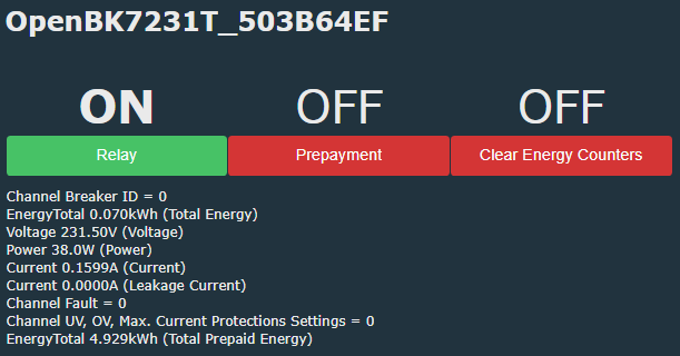

    Added after 6 [hours] 27 [minutes]:
    >>21363783
    Ok, tried ver. 813 with the same results as 812...

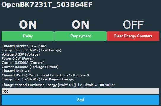

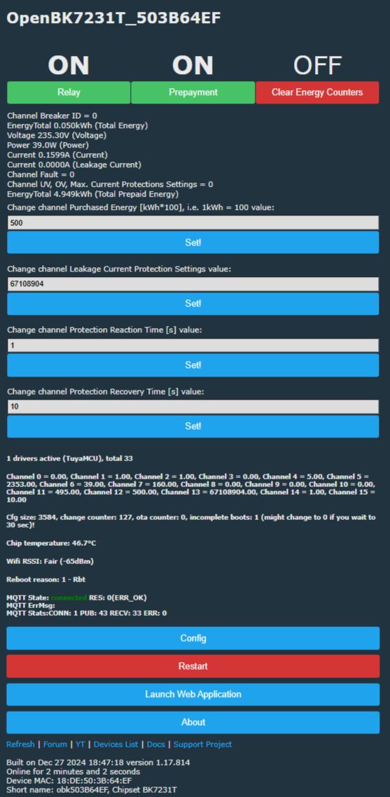

    User interface displaying electrical energy information and relay settings. OpenBK7231T_503B64EF user interface with voltage, power, and current information.
    Ver. 813 with "old" autoexec (without channel number afer linkTuyaMCUOutputToChannel 6 RAW_TAC2121C_VCP) gives 0 for voltage, current, and power, and restarts relay, while adding channel number after it gives correct value for voltage but wrong values for current and power (.4 A instead of .2 and 170W instead of 40; Im using a 40W lamp as load and old versions values match with the device's display), but relay doesn't restart when switching off

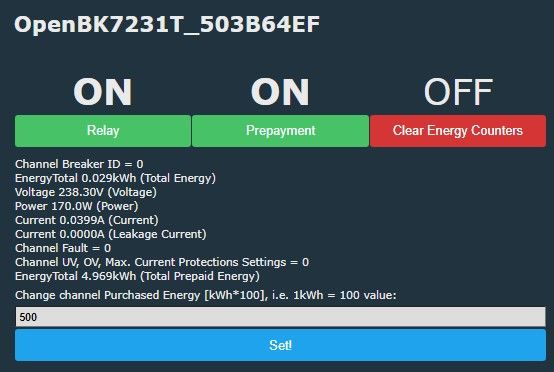

    >>21364564

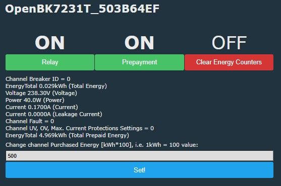

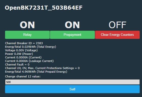

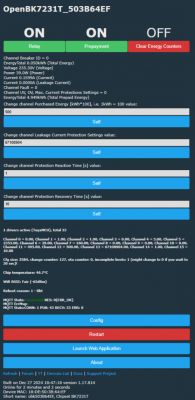

    I tested ver. 814 and I'm afraid there's still something wrong...
    Ver. 814 and old syntax for RAW_TAC2121C_VCP works well:
    Screenshot of the OpenBK7231T_503B64EF software interface with various settings and information. Screenshot of editing an /autoexec.bat file with highlighted code.
    But, if I add "5" after RAW_TAC2121C_VCP to chech the new syntax, it shows again wrong values for P and I:
    Screenshot of OpenBK7231T user interface displaying energy consumption data.Screenshot of the autoexec.bat file editor with a highlighted script line related to the RAW_TAC2121C_VCP 5 command.
  • #128 21365272
    Posts: 14770
    Rate: 12913
    It's VCP, as in title, Voltage, Current, Power. You seem to have Voltage, Power, Current order. So Current value goes to Power and Power goes to Current.
  • New TuyaMCU syntax swaps power and current channels
    #129 21365381
    morgan_flint
    Posts: 251
    Rate: 63
    >>21365272 True!! 🤦‍♂️

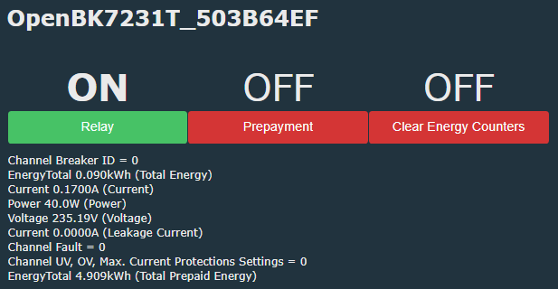

    EDIT: Cheched that:
    1.- works OK with:
    Display of OpenBK7231T_503B64EF interface with energy information
    2.- P and I seem to be interchanged after adding "5" behind:

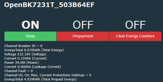

    OpenBK7231T control panel with energy information.
    3.- Works OK again after changing channel order of P and I:
    setChannelType 6 Current_div1000
    setChannelLabel 6 "Current"
    setChannelType 7 Power
    setChannelLabel 7 "Power"
    OpenBK7231T user interface with energy information and switches
    4.- In the latter, if I delete the 5 after RAW_TAC2121C_VCP, it continues working good:
    Electrical panel with voltage and power information
    CONCLUSIONS:
    1.- With the old (single phase) syntax (no number after RAW_TAC2121C_VCP), it seems to put power and current in the corresponding type channel, regardless if channel order is V-C-P or V-P-C.
    2.- With the new syntax (ready for multi phase), if V-C-P order is not respected, it shows current in the second channel and power in the third, regardless the channel type.
    3.- This behaviour is good, in the sense older autoexecs with bad order will continue to work; in new autoexecs for multi-phase devices, it's not tolerant to errors in the order, so attention should be paid to put channels in the correct one (which shouldn't be a problem).
    Many thanks to @p.kaczmarek2 for all his work!

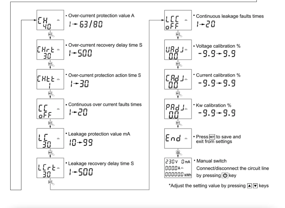

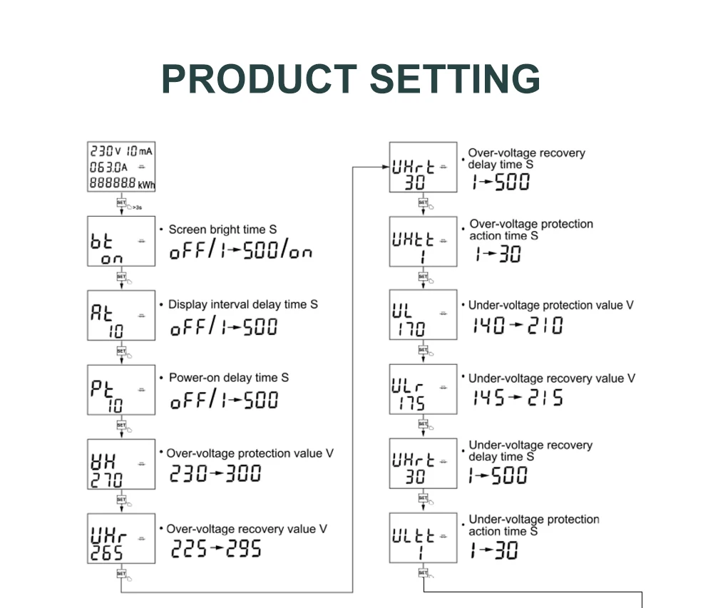

    First, I'd try illuminating the screen from outside with a flashlight, as some LCDs can be seen this way well enough to navigate to the corresponding setting. This probably would work with the first version of this device ("black and white" LCD). I've tried with the colour one and it doesn't work, probably because it's OLED and not LCD.
    If that doesn't work, after powering off and on (so the device is in a known state), I'd try navigating blindly to the setting (very easy in this case, as it's the first one), and change it. The sequence would be: long press of the set key, ten or more arrow up short presses (more than 10 seconds of light on), and long press of the set key again. Once this has worked, set it to the time you want (or permanently on, after 200 seconds).
    EDIT: The setting menu from Aliexpress' ad:
    Settings menu diagram with voltage protection and display timing parameters
    Settings menu for circuit protection device showing current, leakage, calibration options

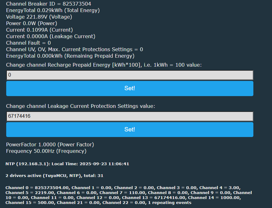

  • Questions on OpenBeken channel calibration and current offset
    #133 21697860
    sergeysobolevskiy
    Hi all! New version of TOMPD-63-LW with CBU module inside and color screen was purchased. OpenBeken v. 1.18.177 was flashed successfuly, but I have some questions:
    1. Is it possible to fix default "Current" channel data? No load connected, but channel data are about 170, it doen't look like breakers's inside power consumption.
    2. I can't understand how to calibrate VCP channels, division is only divider of channel data, but how to fix it to real measurement, for example with 40W bulb?
    3. Is it possible to change channel 13 data?
    Screenshot of interface showing electrical readings and protection settings
