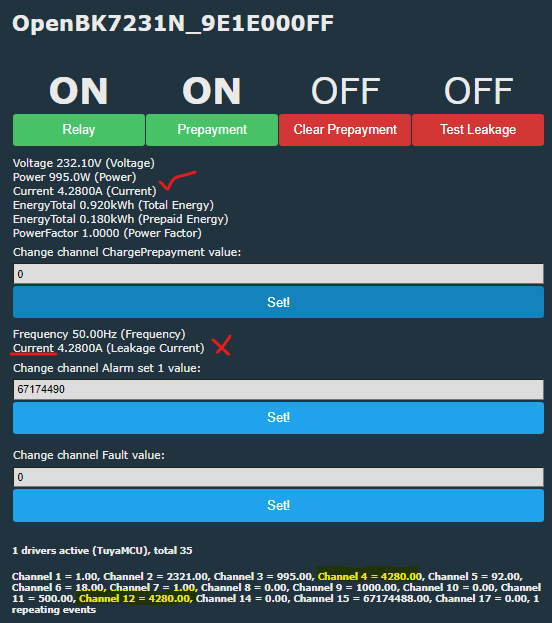

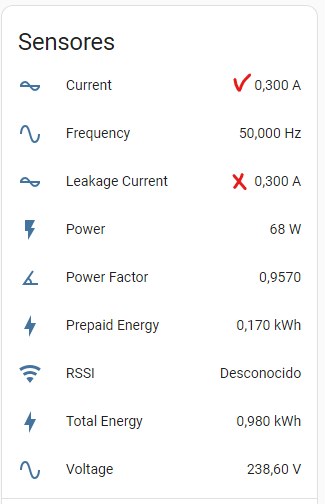

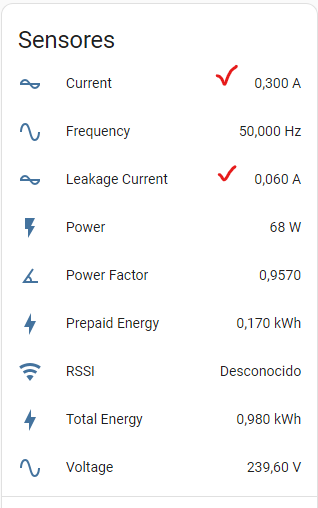

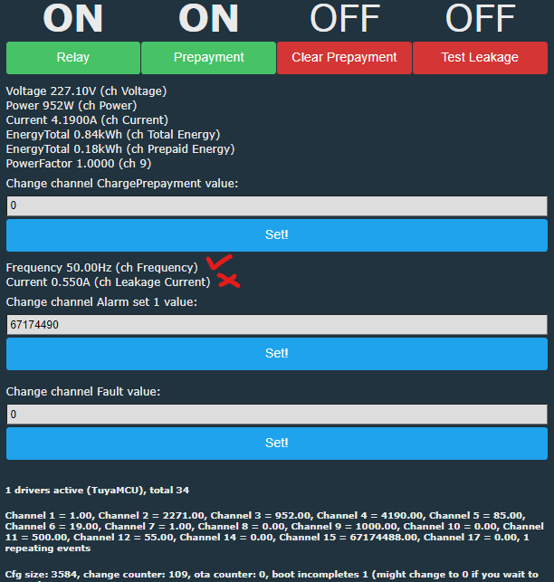

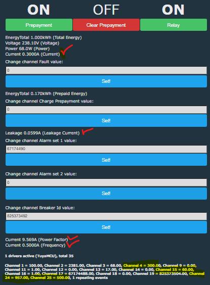

    Today I updated to 1.17.356 and I see I have now channel type frequency_div10, so now the displayed frequency is correct:
    Screenshot of an electrical data management interface showing frequency and current channels.

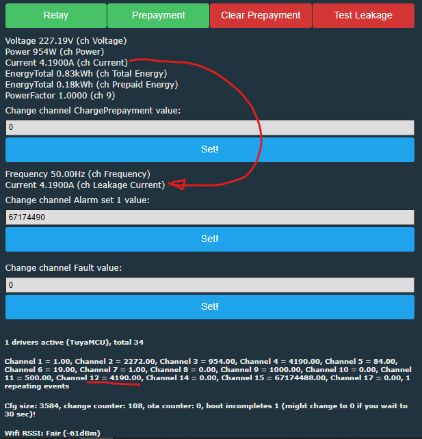

    But leakage current (channel 11) is still bad by a factor of 10, and this is because I have channel type Current_div100 instead of Current_div1000, as it should be. The problem is that if I set that channel as Current_div1000, then it copies the value of channel 4 (which corresponds to the total current and comes from linking Dpid 6 "phase_a" to channel RAW_TAC2121C_VCP):
    Screenshot of an interface displaying voltage, current, energy, and frequency values with a noted issue in leakage current.
    I think this is an issue with RAW_TAC2121C_VCP that, apparently, "hijacks" channel types "Voltage_div10", "Power", and "Current_div1000" for its exclusive use. I had already commented this problem at the end of this post.
    I have seen that there's already a pull request related to this problem, but still not merged.
    Another solution would be to create a new channel type for leakage current, for example, Current_milliamps, but it would be better to solve this "hijacking", as there may be devices that need more than one channel of these types (for example, a three-phase meter, as I said in this post).
  • #62 20866354
    Posts: 14622
    Help: 655
    Rate: 12638
    Ok, you have conviced me, I will merge that PR.
    Still, I've also added LeakageCurrent_div1000, in case that's needed
    I will also check this on my side, and then let me know what next is needed

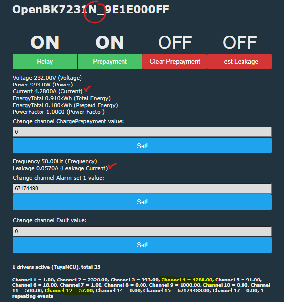

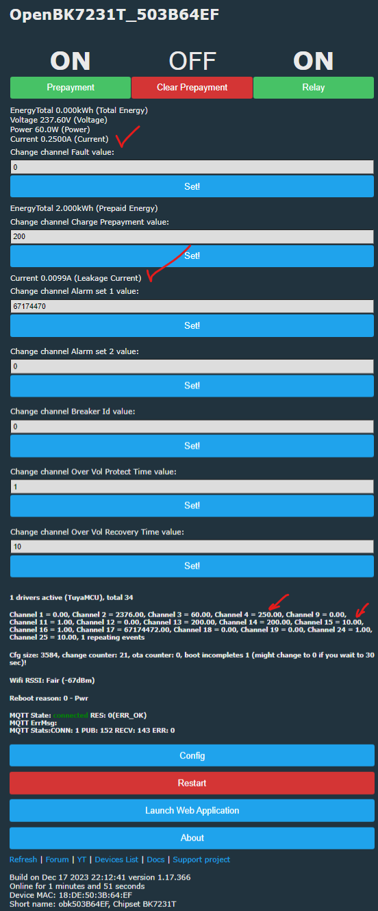

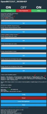

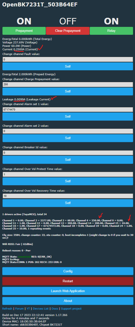

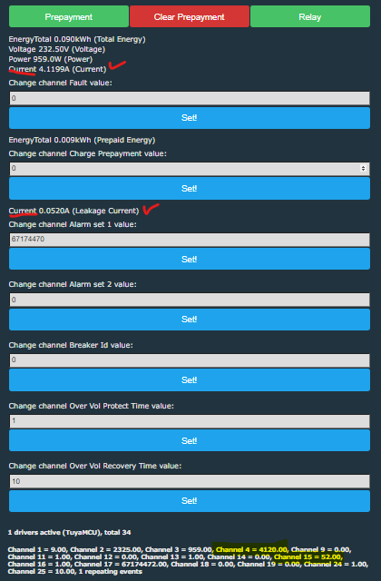

    I tested it on the second device I was waiting for (pending its own thread) and it works well, showing the real value for leakage current both with the new type "LeakageCurrent_div1000" and with "Current_div1000" shared with channel 4 but now without "hijacking", as you can see in the following image:
    Screenshot of a software interface for monitoring current and other parameters.

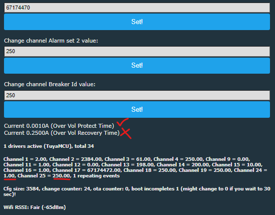

    But when I tested it in the old one, the new type worked OK, but with "Current_div1000" I still have the same problem:
    Screenshot of a user interface for BK7231N device showing current, voltage, power, and frequency values. Screenshot of OpenBK7231N interface displaying various electrical parameters.
    I'm a bit puzzled about it... Could it be because the new device is BK7231T (the old one is N) and the last changes were not included for BK7231N? Or maybe because of the order the channels are set in the autoexec.bat?

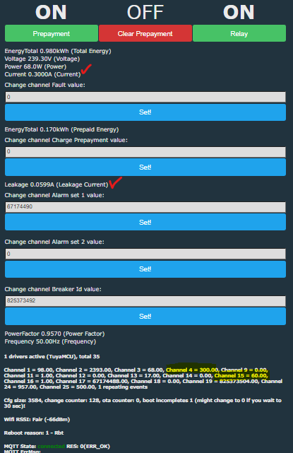

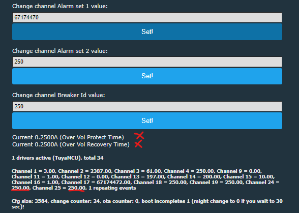

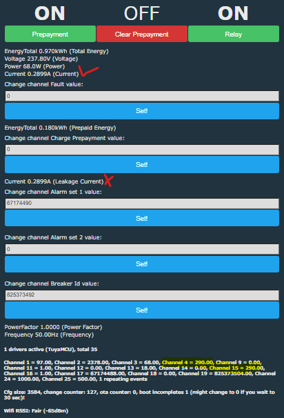

    To discard any other possibilities, I reset all the types to default, then copied the autoexec.bat from the other device in this one, just adapting the two DpIDs that are different (104 and 105):
    Code: Java
    But, after rebooting, no luck:
    User interface showing current and voltage values. A widget displaying data on various electrical parameters such as current, frequency, leakage current, power, and more.
    Then, if I change channel 15 type to "LeakageCurrent_div1000"
    Screenshot of a configuration panel with current, voltage, and power readings. Measurement data list from a device showing values like current, frequency, power.
    Then it shows correct values (except for RSSI in Home Assistant, that worked OK in the other device 🤔)

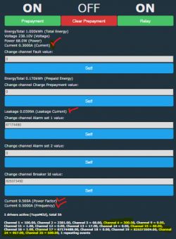

    EDIT: I did another experiment: setting power factor and frequency channels to Current_div1000 shows coherent values (apart from the scale) and their channels (24 and 25) are not overwritten by channel 4, while channel 15 does as soon as I set it to Current_div1000 (2nd image):
    Screenshot of an interface showing electrical parameter readings with values like total energy, voltage, and current. Screenshot of an interface with energy management settings and channels.

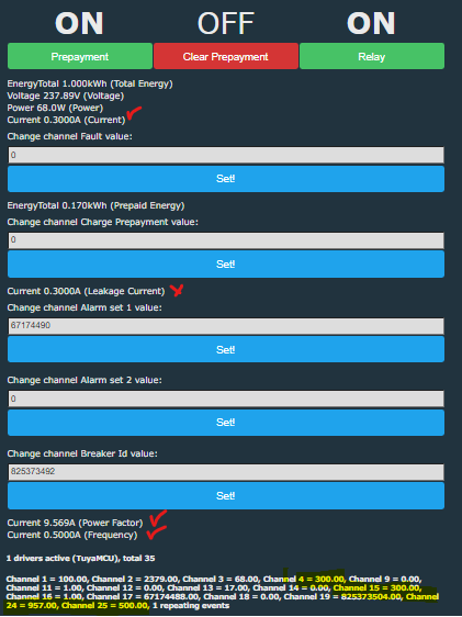

    It seems we have misunderstood each other. This currently works as expected. This is because you are supposed to use Leakage_Current channel type for leakage...
    That's OK, I understand LeakageCurrent_div1000 is best suited for leakage but, as is a"val" type DpID (and it's a current, anyway) it should also be possible to use Current_div1000 without interference from another channel (in this case, channel 4 that came from RAW_TAC2121C_VCP). In fact, as per the "experiment" of the last two images in my former post, it seems it's possible to use Current_div1000 with other DpIDs of the "val" type, just the label before the value won't be correct (and the scale, if the divXXX is not what it should be) but, apart from that, the numbers reflect the value of the channel.
    It's just when I try it in the BK7231N device that channel 4 overwrites channel 15, but not others sharing Current_div1000. I've cheched again in the BK7231T device and, in this case, works well (no overwriting):
    User interface screen of OpenBK7231T showing various current and energy parameters. User interface displaying electrical energy data and device configuration options.
    Effectively, it's a very strange behavior, but it doesn't seem to happen only to me, as the author of PR863 seems to have the same problem. If you don't see any collateral effects of accepting it, I could try the result on both devices and see what happens.
    Just made a new experiment with the BK7231T device, changing the last two DpIDs to Current_div1000 with even more puzzling results: They should show 1 and 10 (divided by 1000), but now, sometimes, both copy the value of channel 4 and other times the first one shows the correct value, oscillating between both 😮:
    Screenshot showing a user interface with channel values and set buttons. Screenshot of a device interface showing settings and channel values with incorrect labels.
    I remember seeing the value changing also in the other device, but as I wasn't able to capture it I thought it was my imagination...
    Excuse me for being so fussy with this; both devices can go well without changes just using LeakageCurrent_div1000, but I think it is good for the project to emerge these strange things, just in case they affect more negatively to other devices. Thank you very much!

    This is 100% normal because the order of dpIDs sent is not deterministic, so there is a race condition and the winner sets the second current field.
    Still, I've accepted and merged the pull request you linked. Starting from the next release, the VCP special packet will only set the first current channel, i.e. the one with the lowest index.

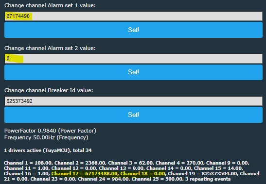

    The first one is related to DpID 18 (Alarm set 2), which doesn't show any value in the corresponding channel despite being very similar to DpID 17 (Alarm set 1) which works OK. This is the autoexec.bat section related to both of them:
    Code: Java
    This is the screenshot for both:
    Screenshot showing incorrect display of values in the Alarm set 2 channel.
    And these are the logs for both DpIDs:
    Info:TuyaMCU:TUYAMCU received: 55 AA 03 07 00 08 11 00 00 04 04 01 00 5A 85
    Info:TuyaMCU:TuyaMCU_ProcessIncoming[ver=3]: processing command 7 (State) with 15 bytes
    Info:TuyaMCU:TuyaMCU_ParseStateMessage: processing dpId 17, dataType 0-DP_TYPE_RAW and 4 data bytes
    Info:TuyaMCU:TuyaMCU_ParseStateMessage: raw data 4 int: 67174490
    Info:TuyaMCU:TUYAMCU received: 55 AA 03 07 00 10 12 00 00 0C 01 01 00 0A 03 01 00 FA 04 01 00 D2 18
    Info:TuyaMCU:TuyaMCU_ProcessIncoming[ver=3]: processing command 7 (State) with 23 bytes
    Info:TuyaMCU:TuyaMCU_ParseStateMessage: processing dpId 18, dataType 0-DP_TYPE_RAW and 12 data bytes
    Info:TuyaMCU:TUYAMCU received: 55 AA 03 07 00 08 01 02 00 04 00 00 00 6C 84
    Info:TuyaMCU:TuyaMCU_ParseStateMessage: processing dpId 1, dataType 2-DP_TYPE_VALUE and 4 data bytes
    Info:TuyaMCU:TuyaMCU_ParseStateMessage: raw data 4 int: 108

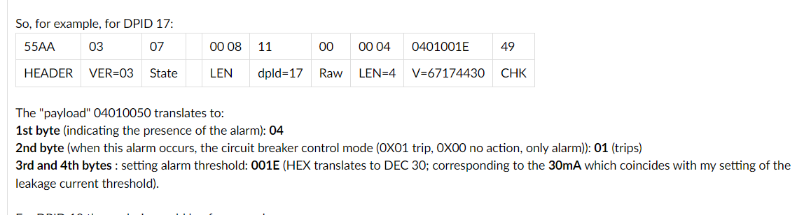

    DpID 17 is correctly detected and processed and the "payload" 04 01 00 5A is translated from hex to dec and shown in the web interface as 67174490. DpID 18 is detected but the payload (01 01 00 0A 03 01 00 FA 04 01 00 D2) is not processed, maybe because it's too long. It also gives an error in TuyaMCUAnalyzer, as I reported here.
    The meaning of these DpIDs was explained here.
    Enough for now ;-) ... Will write about the other suggestions in following posts.
    Again, thank you very much for your hard work with OBK!

    So basically you need a dedicated channel type (or driver) that can parse and display this:
    Screenshot showing a data table for DPID 17 and a description of the payload translation.
    (following screenshot is from the post you linked)
    Futhermore, you also need to be able to send the same data to the MCU?

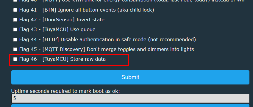

    Angel0fDeath wrote:
    Also will need the answer of Dp command (IP/cm?cmnd=Dp)
    Remember that you need to enable a flag for that first:
    Configuration options list with Flag 46 for storing raw data highlighted.
  • #79 20956136
    Angel0fDeath
    Posts: 118
    Rate: 33
    I added setflag 46 1 to autoexec.bat in order not to have mistakes :). He is probably using the same autoexec (with minor modifications) for this device since data types should be as on the other device.

    Info:TuyaMCU:ProcessIncoming[v=3]: cmd 7 (State) len 15
    Info:TuyaMCU:ParseState: id 17 type 0-raw len 4
    Info:TuyaMCU:ParseState: int32 67174490
    Info:TuyaMCU:Received: 55 AA 03 07 00 10 12 00 00 0C 01 01 00 04 03 01 00 F5 04 00 00 00 3A
    Info:TuyaMCU:ProcessIncoming[v=3]: cmd 7 (State) len 23
    Info:TuyaMCU:ParseState: id 18 type 0-raw len 12
    Info:TuyaMCU:Received: 55 AA 03 07 00 08 01 02 00 04 00 00 00 02 1A
    Info:TuyaMCU:ParseState: id 1 type 2-val len 4
    Info:TuyaMCU:ParseState: int32 2
    Info:TuyaMCU:Received: 55 AA 03 07 00 08 0F 02 00 04 00 00 00 00 26
    Info:TuyaMCU:ParseState: id 15 type 2-val len 4
    Info:TuyaMCU:ParseState: int32 0
    Info:TuyaMCU:Received: 55 AA 03 07 00 0C 06 00 00 08 09 23 00 00 46 00 00 00 95
    Info:TuyaMCU:ProcessIncoming[v=3]: cmd 7 (State) len 19
    Info:TuyaMCU:ParseState: id 6 type 0-raw len 8
    Info:TuyaMCU:Received: 55 AA 03 07 00 08 68 02 00 04 00 00 03 E8 6A
    Info:TuyaMCU:ParseState: id 104 type 2-val len 4
    Info:TuyaMCU:ParseState: int32 1000
    Info:TuyaMCU:Received: 55 AA 03 07 00 08 69 02 00 04 00 00 01 F4 75
    Info:TuyaMCU:ParseState: id 105 type 2-val len 4
    Info:TuyaMCU:ParseState: int32 500
    Info:TuyaMCU:Received: 55 AA 03 07 00 05 0B 01 00 01 00 1B
    Info:TuyaMCU:ProcessIncoming[v=3]: cmd 7 (State) len 12
    Info:TuyaMCU:ParseState: id 11 type 1-bool len 1
    Info:TuyaMCU:ParseState: byte 0
    Info:TuyaMCU:Received: 55 AA 03 07 00 08 0D 02 00 04 00 00 00 00 24
    Info:TuyaMCU:ParseState: id 13 type 2-val len 4
    Info:TuyaMCU:Received: 55 AA 03 00 00 01 01 04
    Info:TuyaMCU:ProcessIncoming[v=3]: cmd 0 (Hearbeat) len 8
    From the missing DpIDs, I managed to get two in the logs by forcing certain situations; 9 after a fault, and 101 after togging the corresponding channel:
    Info:TuyaMCU:Received: 55 AA 03 07 00 08 09 05 00 04 00 01 00 00 24
    Info:TuyaMCU:ParseState: id 9 type 5-bitmap len 4
    Info:TuyaMCU:ParseState: int32 65536
    Info:TuyaMCU:Received: 55 AA 03 07 00 05 65 01 00 01 01 76
    Info:TuyaMCU:ParseState: id 101 type 1-bool len 1
    Info:TuyaMCU:ParseState: byte 1
    Following the same logic as with 101, I tried toggling DpID 12 (clear prepaid energy), setting a value for DpID 14 (charge prepaid energy), and toggling DpID 21 (test leakage). All of them worked as expected, but no info appeared in the logs.
    So, to answer your question, here are the extracted logs for dpID 101, 104 and 105, as I couldn't get anything for 21:
    To end this long post, three curious facts about this device.
    First, as I had mentioned elsewhere, the update period is very long: Every 5 minutes it reports DpIDs 6, 15, 104, and 105, and every 10 minutes, the previous ones and 1, 11, and 13. SO, activating "addRepeatingEvent 5 -1 tuyaMcu_sendQueryState" or something similar is going to be needed.
    Second, once I toggle "clear all energy counters", it changes automatically to "1", even if I try to set it to 0 (channel type toggle or textfield is the same). It's not a problem as it only clears the counters in the transition from 0 to 1, so the counters work well even if DpID 101 is high. This doesn't happen with DpID 12 that performs the same function but only for prepaid energy.
    And third, I managed to capture the following in the logs:
    Info:TuyaMCU:Received: 55 AA 03 01 00 40 7B 22 50 22 3A 22 75 30 63 78 6F 78 74 66 65 6C 79 73 33 75 66 78 22 2C 22 76 22 3A 22 31 2E 30 2E 30 22 2C 22 6D 22 3A 31 2C 22 6D 74 22 3A 31 30 2C 22 6E 22 3A 30 2C 22 6C 6F 77 22 3A 30 7D CA
    Info:TuyaMCU:ProcessIncoming[v=3]: cmd 1 (QueryProductInformation) len 71
    Info:TuyaMCU:ParseQueryProductInformation: received {"P":"u0cxoxtfelys3ufx","v":"1.0.0","m":1,"mt":10,"n":0,"low":0}
    It looks like the same info I had captured on other devices with TuyaMCUAnalyzer, but I don't remember seeing it in the logs, maybe it's simply because it's rarely broadcasted or maybe because it was introduced in a newer version
  • #81 20956599
    Angel0fDeath
    Posts: 118
    Rate: 33
    @morgan_flint Ok. Thanks. I think this is enough. Don't worry about dpID21. We have dpID101:
    101: 55 AA 03 07 00 05 65 01 00 01 01 76
    So I assume 21 will be something like;
    21: 55 AA 03 07 00 05 15 01 00 01 ST CS
    ST- state
    CS - check sum
    It is enough to start reworking the script... of course not right now - it is Sunday evening :)
    I think we will clear everything about dpID21 during testing
    About product information - I don't think this is important. I have seen this to be broadcasted in other device also. The string after 'P' is unicode (UTF-16 probably) and eventually code table is Chinese. However don't know which of them - mandarin, etc.. If you are really interested - you can find it out - you have the capture from tuya developer website, now you need to compare the pictures :) . But really I don't think this is mandatory
    In the other device dpID12 as in this device returns back to 0 after set it high. Probably dpID101 makes the same but more time is needed. Don't know.
    Let me rework the script, which is more reliable than native control page and then we ca disscuss
