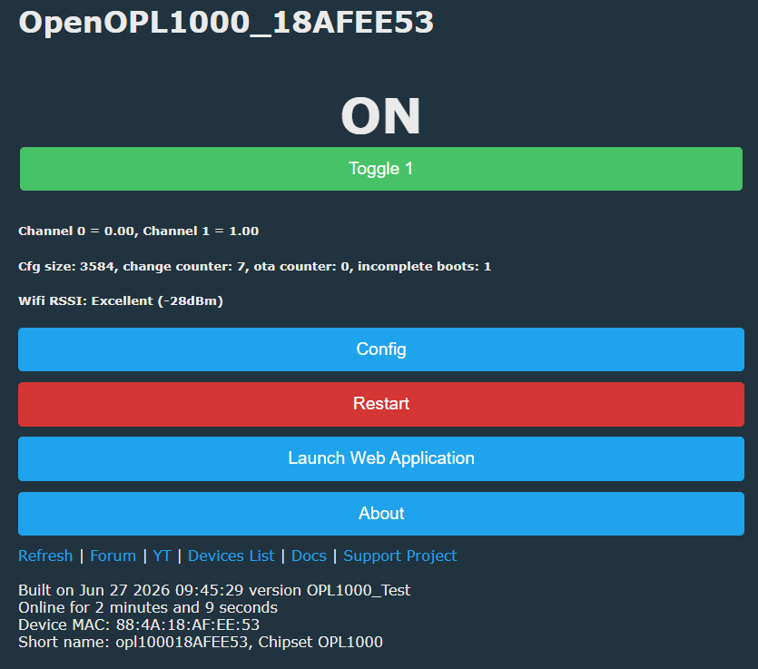

    looks pretty but nothing much enabled. offline build. Button IO registering on DW2 and presumably LED will work when I determine IO
    OpenOPL1000 interface screen with Config, Restart, and Launch Web Application buttons.
    uses 15k of ram extension. first 1kb reserved/in use.
    FIM cfg save
    no AP

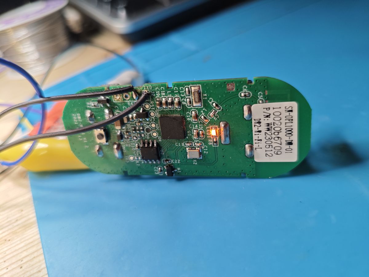

    slimmed-down REST enabled (no OTA, LFS)
    IRAM1: 169616 used / 170848 total and SHM: 14524 used / 15360 total, so only about 1232 bytes IRAM and 836 bytes SHM free
    tight

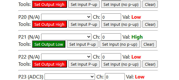

    web app ok:
    Screenshot of a control UI for pins P20–P23 with buttons and High/Low value indicators.
    LED is P21
    Green PCB with wires, ICs, and a lit orange LED on a blue work mat

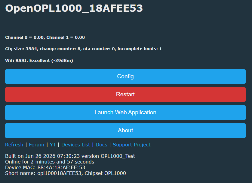

    it's saving pins, startup command and now saved cfg wifi is source of wifi truth. defaults currently to connecting to OPL1000_AP / 1234abcd. subsequent changes are saved and persist.
    current state: https://github.com/divadiow/OpenBK7231T_App/actions/runs/28285204741
    boot, menu navigation, save flags change, press button to light LED:

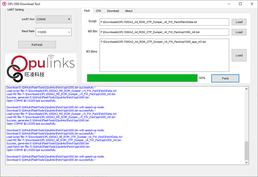

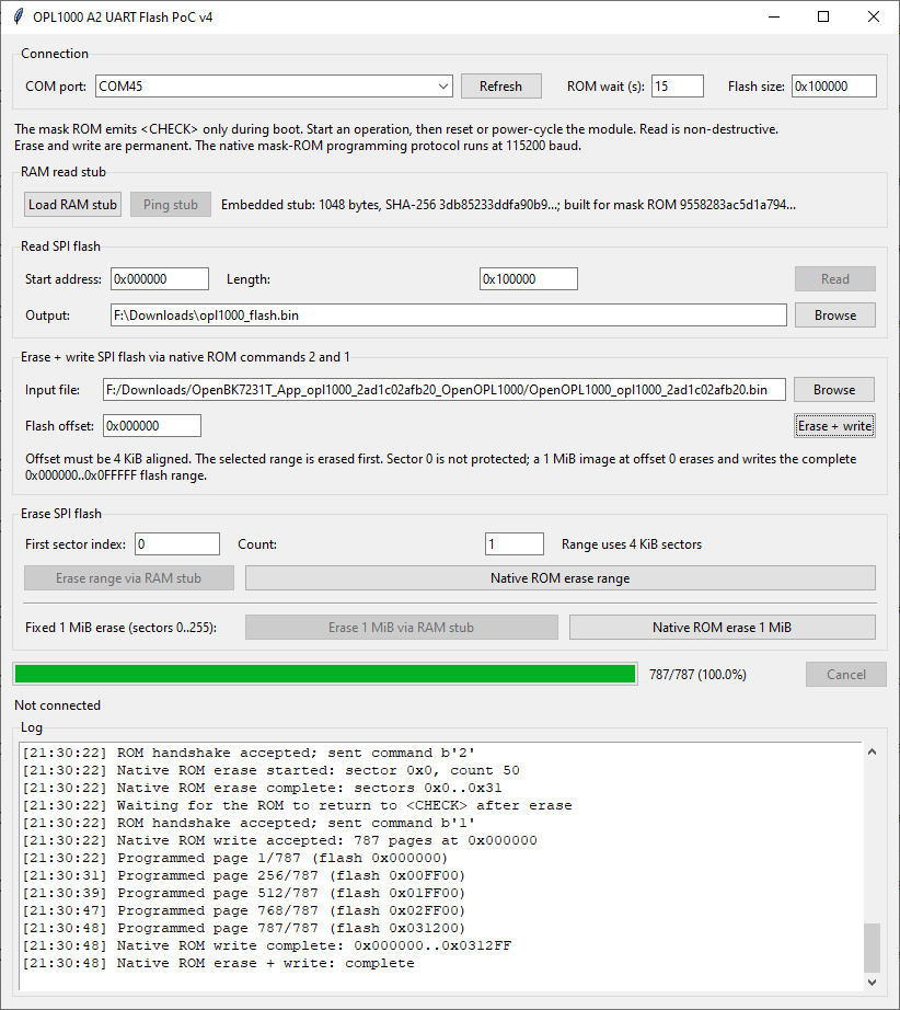

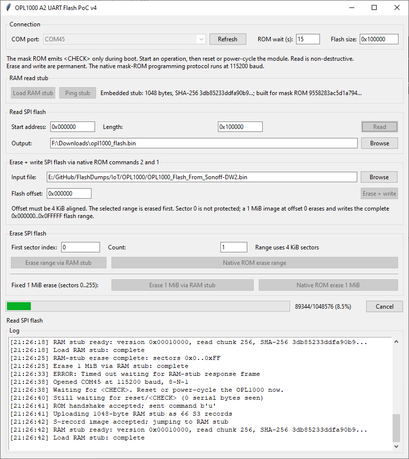

    proof-of-concept OPL1000 uart flash writer, reader, eraser. uses small RAM stub to read
    Screenshot of OPL1000 A2 UART Flash PoC v4 showing SPI flash tools, log panel, and 8.5% progress
    have written DW2 firmware back and it boots.
    also a python version of the Opulinks patchData.txt+m0+m3 packer to produce single binary on build ready for flashing https://github.com/openshwprojects/OpenBK7231...mmit/2ad1c02afb20496755abeae18e0c561f8c7df560
    Screenshot of OPL1000 A2 UART Flash PoC v4 showing SPI flash write progress and an operation log.
    rom only supports 115200 baud write, no baud change command in rom.
    • OPL1000FlashPoC_v4.zip (22.4 KB) You must be logged in to download this attachment.

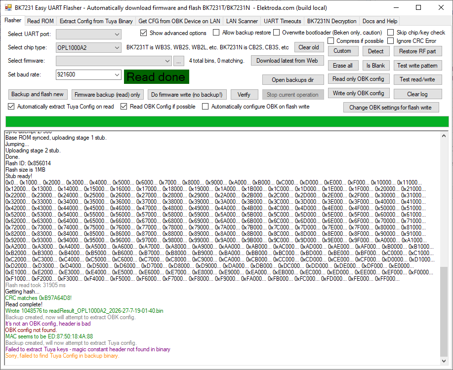

    Since stub uses M3 core, do you want to port ECR stub?
    There are sha256 funcs in M3 rom.
    p.s, since majority of the code is in rom, why app binary is so big?
    Added after 4 [hours] 8 [minutes]:
    I've decided to do it myself
    SHA256 is too slow, i've decided to use ROM CRC32 function.
    Since stub upload is rather slow, i've decided not to use compression.
    Got baud change/flash id/erase/read/write/crc
    Debug uart max baud rate is about 1430000, so limiting it to 921600.
    Added after 1 [hours] 46 [minutes]:
    https://github.com/openshwprojects/BK7231GUIFlashTool/pull/159

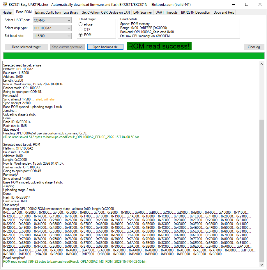

  • ROM analysis shaved 32 kB off IRAM usage
    #106 21937998
    Posts: 5220
    Help: 449
    Rate: 918
    great!!
    Screenshot of BK7231 Easy UART Flasher showing “Writing done” and a detailed operation log
    I was wondering about flash ID next.
    hmm. maybe I should rename OpenOPL1000 to OpenOPL1000A2
    Added after 1 [hours] 33 [minutes]:
    seem to have shaved 32kb off iram with further work after rom analysis. v72
    https://github.com/divadiow/OpenBK7231T_App/c...476c3a8d0e7dfa1f4ed67adeb76bbe1fe43d719fe35b3

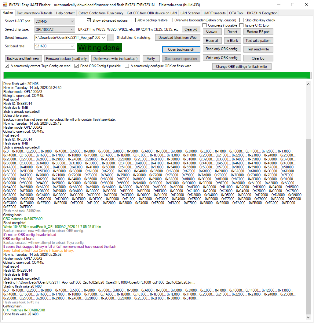

    Fixed merge conflicts, and added efuse(otp) and m3 rom read.
    Can you get rid of shm_data then?
    And did you figure out a way to add it to heap?

    Added after 8 [minutes]:
    cool.
    no M0 ROM?
    Screenshot of BK7231 Easy UART Flasher showing “ROM read success!” and ROM read log output.
