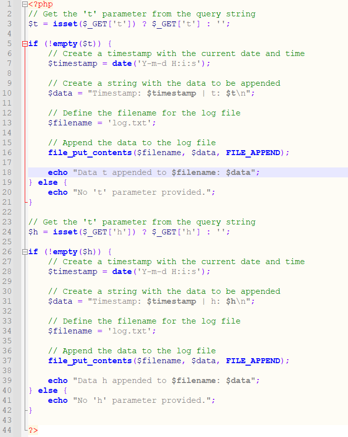

    PHP script snippet for logging data from the TuyaMCU sensor.

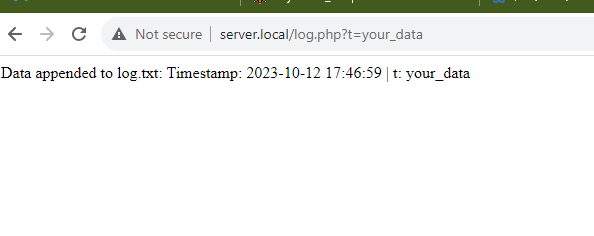

    You can test the script just by accessing it's URL in your web browser:
    Screenshot of a webpage showing a message about data appended to a file.

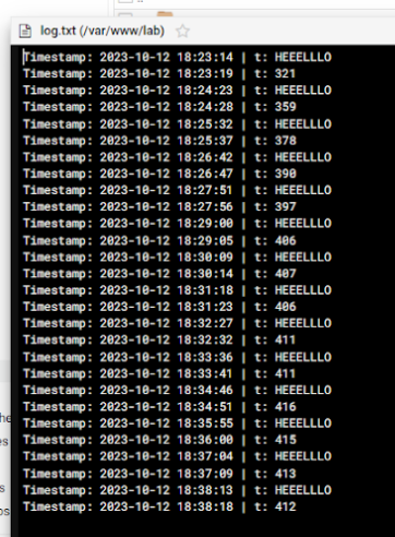

    Now let's run our setup for some time. Here are sample results:
    Screenshot of a log file showing timestamps and measurement results.
    Everything seems to be working!

    PHP script also needs to be updates:
    PHP code for logging temperature and humidity measurements

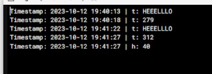

    Now it looks like this:

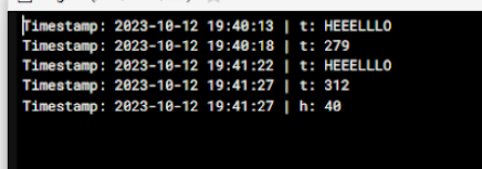

    Screenshot showing temperature and humidity measurements sent by TuyaMCU.
    Here are results collected over time:
    Timestamp: 2023-10-12 19:40:13 | t: HEEELLLO

    Some things to note:
    - TuyaMCU sends temperature as an integer, you need to divide it by 10 to get correct result in this case
    - TuyaMCU seems to report only data when there is a change, so not always all measurements are sent
    You can also report the battery state in the same way.
    Summary
    This way you can report data directly to HTTP server and then process it in PHP (or any other) script any way you like. All required files are available on Github:
