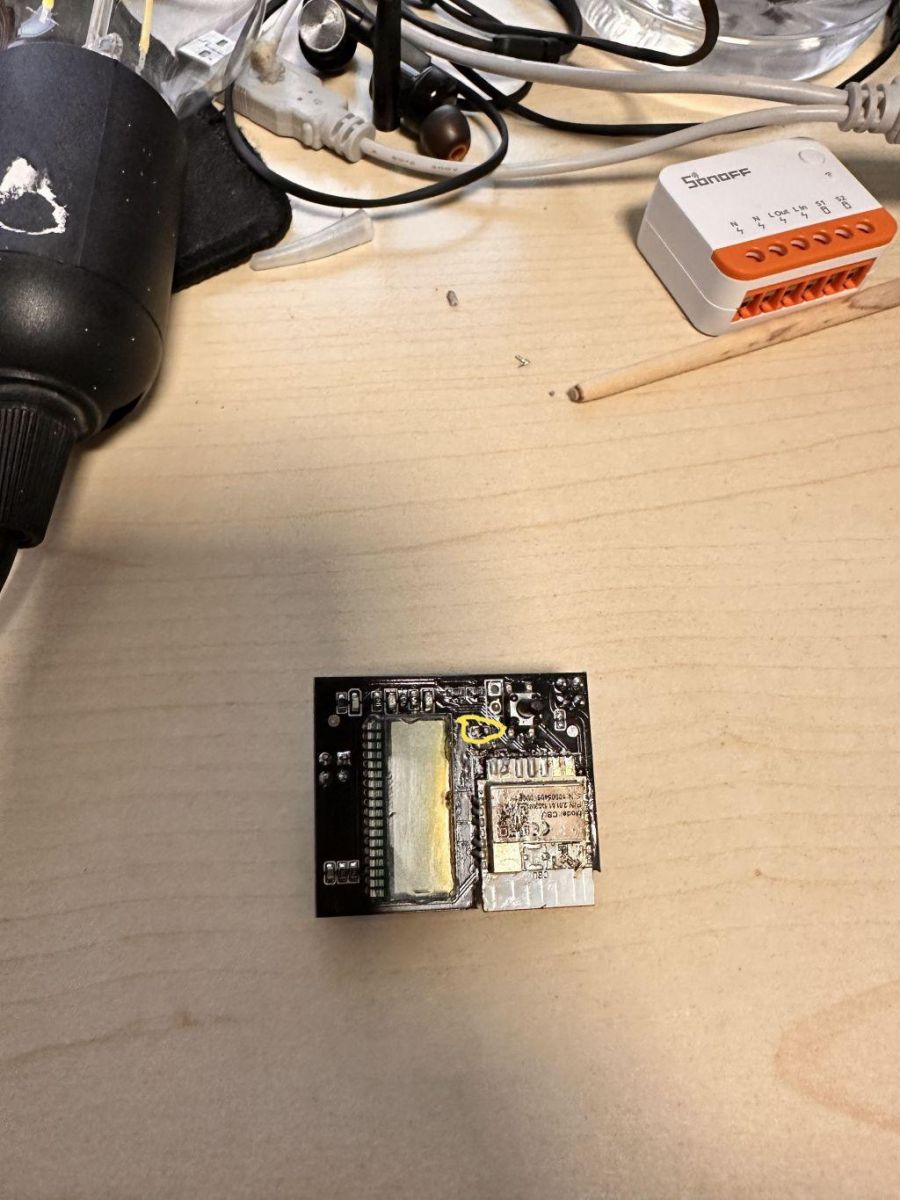

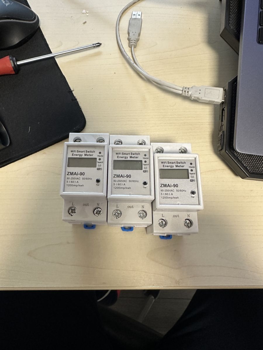

How can I flash a BK7231N-based ZMAi-90 smart energy meter with OpenBeken and configure its meter/relay connections locally?
First check whether your ZMAi-90 is a TuyaMCU design; if it is, OpenBeken can talk to the MCU and you can identify dpIDs either with TuyaMCUAnalyzer or by using Tuya’s own developer/device logs [#20815719][#20821311] For this BK7231N CBU version, the 2 MB dump must be read from the Wi‑Fi module, not the RN8209C, and the recommended tools are BK7231GUIFlashTool / the newer flasher because bkWriter 1.60 is not reliable on BK7231N [#20821174][#20827069][#20838678] To actually write firmware, the RN8209C must be desoldered because it is wired to the Wi‑Fi UART and blocks programming; a read-only trick with VDD floating can work, but it failed for writing [#20838678][#20838936] After flashing, the discovered GPIOs were P14/P16 for the bridge relay pair, P7 for the pair button, P6 for the WiFi LED, and P26 for the tipped LED [#20838775] The RN8209 energy-meter support was being added in OpenBeken: voltage and power could work after calibration, but current still needed more driver work, and Home Assistant discovery needed the driver started before discovery [#20839061][#20865267]

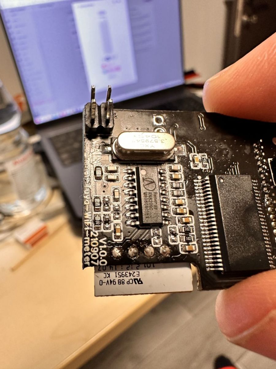

    Hello @lionboy , is your Zmai-90 the same as the one in this topic? Is it using RN8209C? I am asking because there are at least three separate versions of ZMAI-90 around...

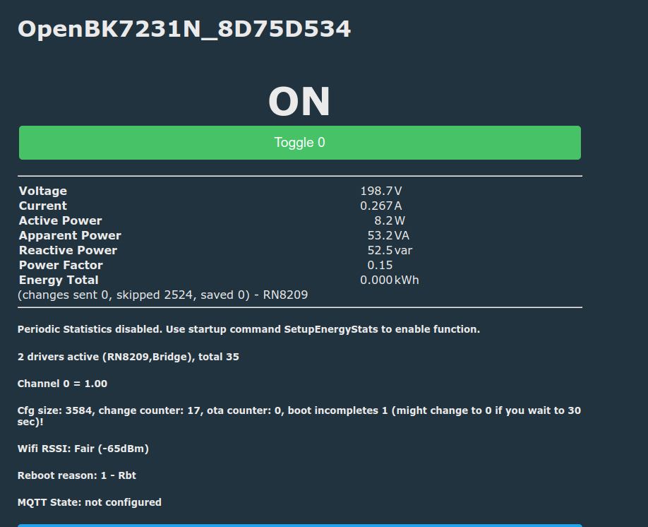

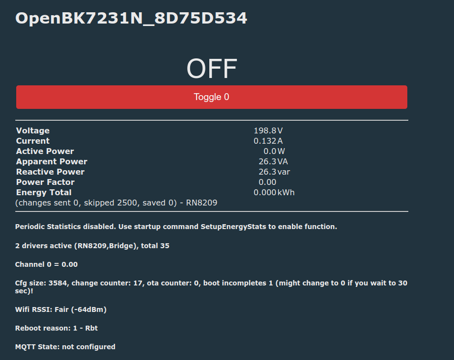

  • Requesting help to test current measurement fault
    #34 20857010
    Posts: 14754
    Rate: 12875
    I have autotransformer that can change AC voltage from very low to 250V or so, so I can check measurements.
    Calibration is always required, just like with Tasmota.
    I have a problem with current measurement, something is wrong, I may be missing something.
    Can someone, maybe @thebeardeddragon or @lionboy , help me testing? I would like to know if current measurement problem happens also on your pieces, maybe my one is special or faulty, etc....
    I can tell you how to run current version step by step if you are interested

    There is no pinout for power monitor. You just do:
    startDriver RN8209
    preferrably as a startup command, then wait 3 seconds (it's a test version of driver, updates are SLOW, I will improve it later) and use calibration to calibrate with a 60W bulb load connected, just like in Tasmota...
    on my side, once calibrated with 60W bulb, power and voltage measurement works but current is still incorrectly measured so I wonder what am I missing

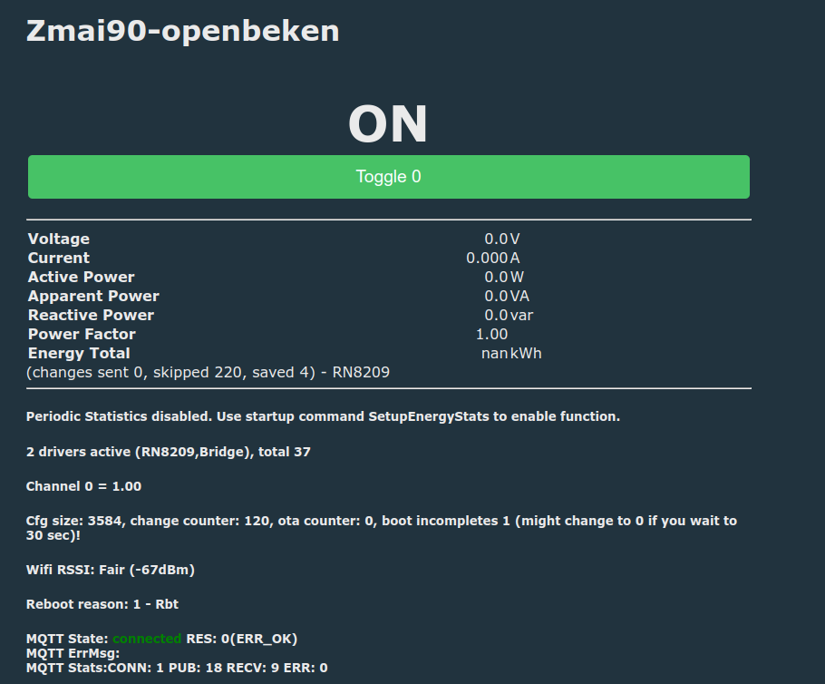

    #37 20857100
    lionboy
    Posts: 69

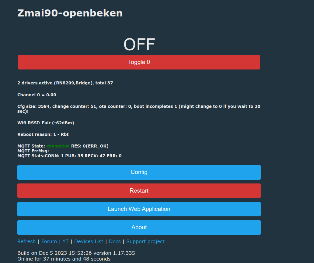

    Hmm at me is not working after i start that driver:
    Screenshot of the ZMAi90-openbeken interface showing driver and MQTT connection information.
    But i saw something when i start driver BL0937 but for this i need pinout
    I attach my dump 2 MB
    And log after i start RN driver:
    Info:MAIN:Started RN8209.
    Info:CMD:[WebApp Cmd 'startDriver RN8209' Result] OK

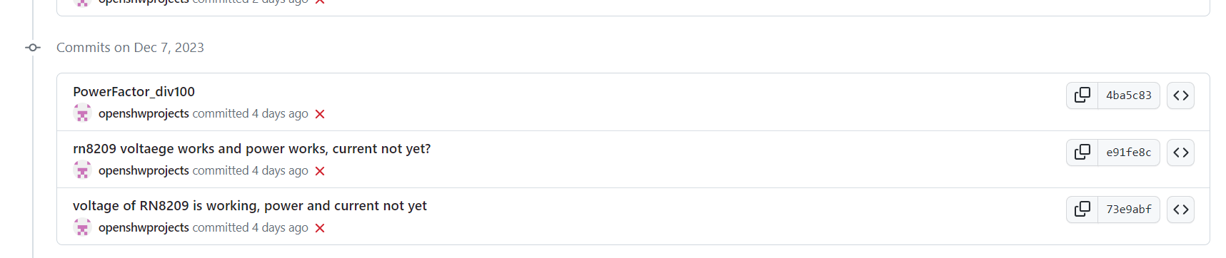

  • #38 20857157
    Posts: 14754
    Rate: 12875
    Your version is from Dec 5, my one is Dec 7, you have old version:
    Screenshot showing a list of project commits on GitHub from December 7, 2023.
    I will get build for you, RBL, wait
    try i will remove it later:
    https://github.com/openshwprojects/OpenBK7231T_App/releases/tag/1.17.340
  • CRC errors prevent watt and current readings
    #39 20857189
    lionboy
    Posts: 69
    Now it works but it doesn't show me anything on Watts or Current:
    Log:

    Warn:EnergyMeter:V 0, C 0 0, P 0 0
    Info:MAIN:Time 70, idle 186403/s, free 75112, MQTT 1(1), bWifi 1, secondsWithNoPing -1, socks 3/38
    Info:GEN:dhcp=0 ip=192.168.2.41 gate=192.168.2.1 mask=255.255.255.0 mac=38:1f:8d:58:4b:00
    Info:GEN:sta: 1, softap: 0, b/g/n
    Info:GEN:sta:rssi=-68,ssid=Smart,bssid=da:21:f9:24:35:46,channel=5,cipher_type:CCMP
    Warn:EnergyMeter:CRC BAD, expected 221, got 34
    Info:MAIN:Time 71, idle 179530/s, free 75328, MQTT 1(1), bWifi 1, secondsWithNoPing 1, socks 2/38
    Zmai90-openbeken interface showing lack of energy measurements.
  • #40 20857206
    Posts: 14754
    Rate: 12875
    How do you get bad CRC all the time? Are you really sure your Zmai is on the same chip?
  • Lost capacitor may explain CRC errors
    #41 20857220
    lionboy
    Posts: 69
    I told you it's CBU with the same black board like yours, but I don't know how I get that CRC BAD.
    I will open it again to check exactly what it is, and I will take some pictures. The only problem was when I desoldered the CBU, I lost a capacitor from the board :D I don't know if that is the problem. I have another one, but that Zmai is now powered on one 3 phase from my house.
    Added after 9 [minutes]:
    Close-up of a black electronic circuit board held in hand with components, including a quartz crystal and pins. Printed circuit board on a desk with a missing capacitor marked with a yellow symbol.
    This is mine, and that mark with yellow I lost when I tried to desolder the CBU.
  • #42 20857663
    lionboy
    Posts: 69
    Do you think that's the problem because I lost that SMD capacitor?
  • #43 20857809
    Posts: 14754
    Rate: 12875
    I don't know, it depends where that capacitor was connected. Was it just betwen VDD and GND or somewhere else? I have tested my code only on one Zmai so far - on my one - and it worked well for voltage and power. Futhermore, there was no bad CRCs, and in your case, every packet yields bad CRC
  • Capacitor location may explain CRC errors
    #44 20857830
    lionboy
    Posts: 69
    I don't know, it depends on where that capacitor was connected. Was it just between VDD and GND or somewhere else? I have tested my code only on one Zmai so far - on my own - and it worked well for voltage and power. Furthermore, there were no bad CRCs, and in your case, every packet yields a bad CRC
    I saw that communicate with RX or TX, I don't remember exactly, and this is the reason why I removed it, but I lost it when I tried to solder it back :D
    I will try it on the one from my phase house to see if it works.
  • #45 20857903
    Posts: 14754
    Rate: 12875
    If the lost capacitor was on RX/TX line then the likelihood of it affecting communication with power metering cicuit has now significantly increased.

  • Desoldering the RN chip makes flashing easier
    #51 20864129
    lionboy
    Posts: 69
    Another 3 of zmai, can you explain how you successfully flash without desoldering the chip?
    Three ZMAi-90 devices lying on a desk next to a screwdriver and a USB cable.
    Thanks
    Added after 11 [minutes]:
    Thanks
    So much easier to flash is to desolder the RN chip from the back and solder it back after flashing. I will try this tonight with all of them and then I can help with calibration to see if it's okay or not at me
  • #52 20864210
    thebeardeddragon
    Level 4  
    Posts: 19
    We need to see inside the device. There are different models using different chips.
    If all those 3 use CBU, then you need to desolder RN chip before flashing.
  • #53 20864300

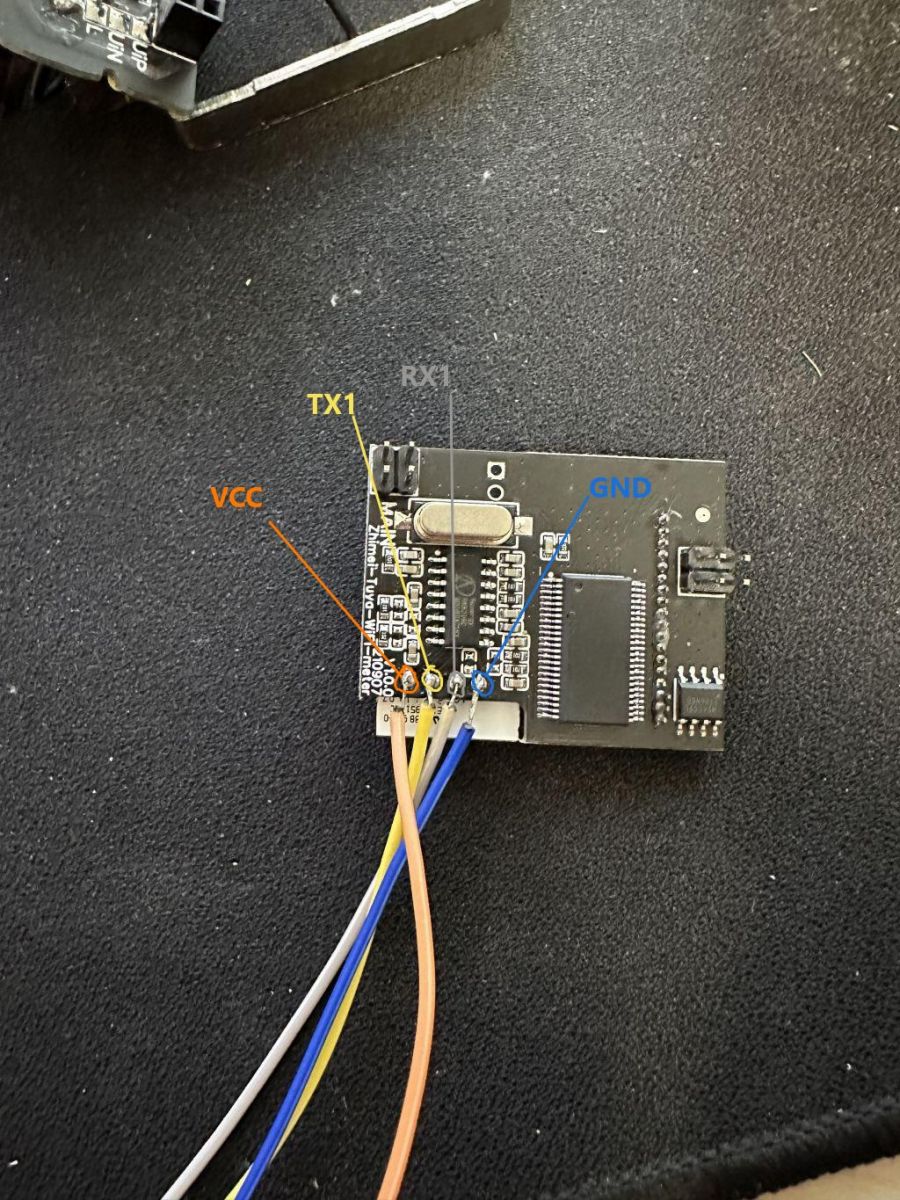

    Do you remember if it's okay with this pin?
    Electronic module with labeled pins VCC, TX1, RX1, and GND.
    I am a bit lazy to take and measure again :d

    For me, without light on and with a bulb of 8 W on.
    OpenBK7231N device user interface showing energy data. Status screen of OpenBK7231N device displaying voltage, current, and power data.
