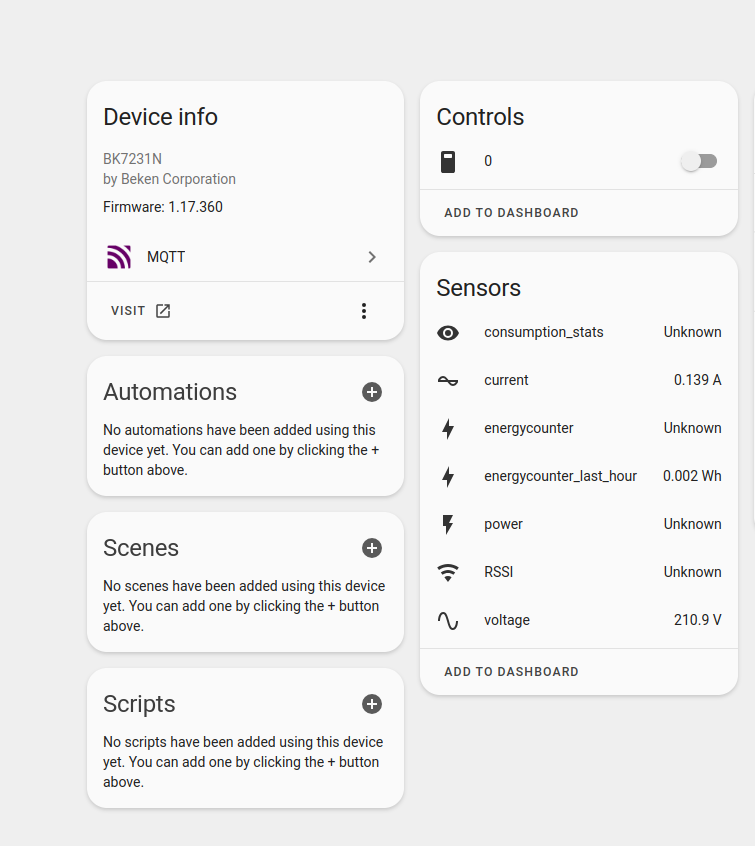

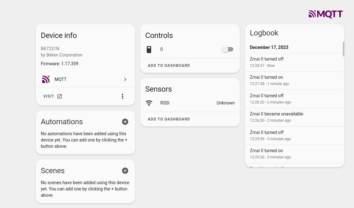

    Well, there is not much choice, when you look at the boad, there is CBU, there is that RN chip for power metering, and the only other big chip is for screen. It's just it's not marked in my piece, so it's hard for me to tell which chip it is.
    So do you know how i can publish this RN value in Home Assistant? because with MQTT not show
    Warn:EnergyMeter:V 1933333, C 2697 0, P 81222 0
    Info:MQTT:Publishing val 8.24 to zmai90/power/get retain=0
    Info:MQTT:MQTT client in mqtt_incoming_publish_cb topic zmai90/power/get
    Warn:EnergyMeter:UA 0
    Warn:EnergyMeter:UA 216
    Warn:EnergyMeter:CRC OK
    Warn:EnergyMeter:UA 29
    Warn:EnergyMeter:UA 211
    Warn:EnergyMeter:UA 5
    Warn:EnergyMeter:UA 230
    Warn:EnergyMeter:V 1954565, C 2697 0, P 81222 0
    Info:MQTT:Publishing val 224.2 to zmai90/voltage/get retain=0
    Info:MQTT:MQTT client in mqtt_incoming_publish_cb topic zmai90/voltage/get
    Warn:EnergyMeter:UA 10
    Warn:EnergyMeter:UA 111
    Warn:EnergyMeter:UA 100
    Warn:EnergyMeter:V 1954565, C 2671 0, P 81222 0
    Warn:EnergyMeter:UA 220
    Info:MQTT:Publishing val 0.221 to zmai90/current/get retain=0
    Info:MQTT:MQTT client in mqtt_incoming_publish_cb topic zmai90/current/get
    But nothing in Home Assitant

  • #62 20865119
    Posts: 14754
    Rate: 12875
    I will look into it, it may be not just enabled yet. The more important problem is that it seems you have the wrong current measurements as well, right? That means I need to look into the communication algorithm more. Something must be missing from my implementation.

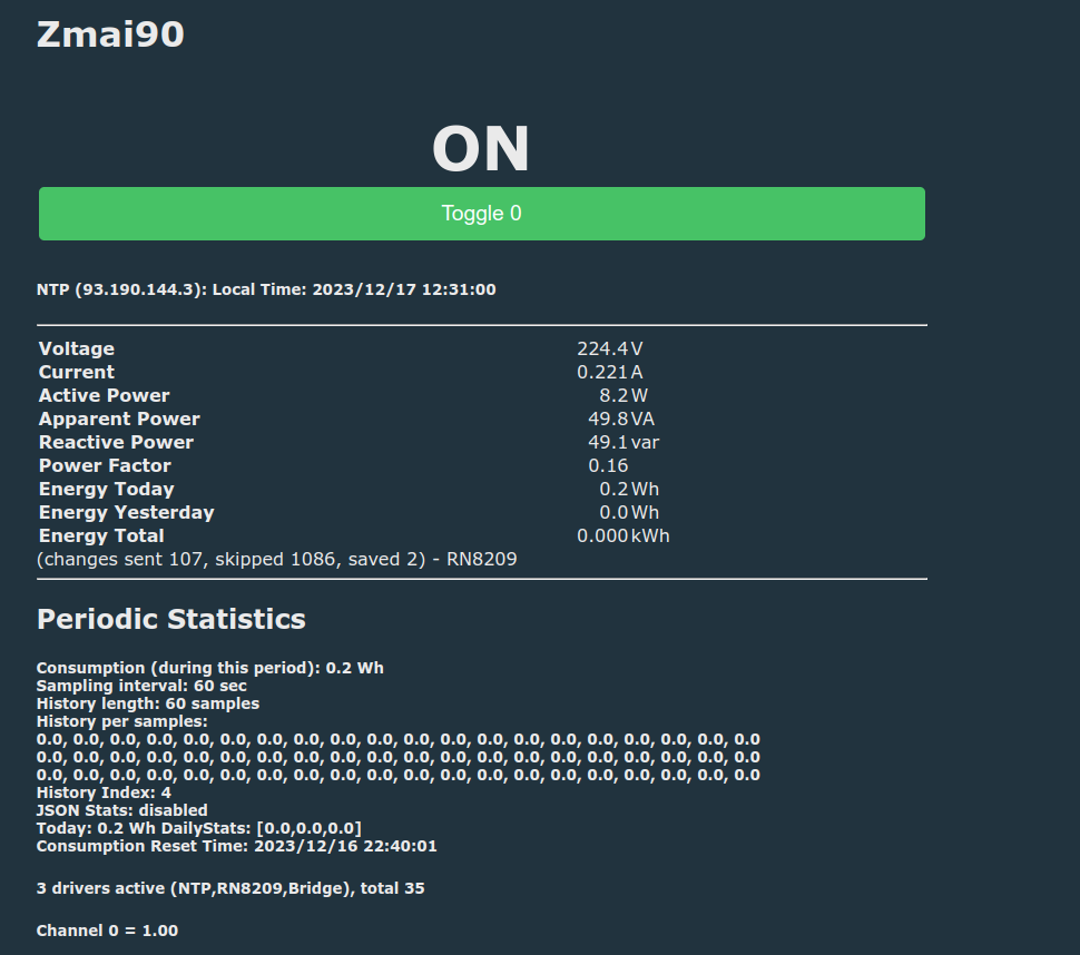

    #63 20865141
    lionboy
    Posts: 69
    Yes, there are some mismatches in current, but not so big. If you calibrate from current, it is okay. You can set the value exactly for power.
    Screenshot of the Zmai90 user interface showing voltage, current, and energy data.
    I will wait until the problem with MQTT is fixed because these three are not my zmai and I need to put Beken on them. After that, I need to use them on the neighbor's house. But for now, it is on a test to find a solution and fix this Zmai 90.

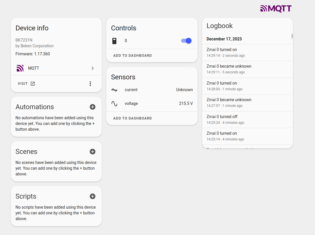

  • #64 20865267
    Posts: 14754
    Rate: 12875
    The driver check was missing. I have added it now:
    https://github.com/openshwprojects/OpenBK7231...mmit/235a26ad2d466072bb20128e190e8b0bb9031609
    Can you start the driver now, then do Home Assistant Discovery, and then check are measurements getting discovered correctly?
    NOTE: Always start driver first, then do HASS discovery.
  • #65 20865336
    lionboy
    Posts: 69
    It shows only current and voltage:
    Screenshot of MQTT interface showing device info, controls, sensors, and a logbook.

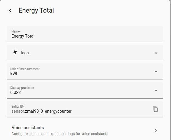

  • Energy Total sensor appears in HASS display chip check
    #68 20867145
    lionboy
    Posts: 69
    What I saw now is Energy Total, which is a counter sensor in HASS:
    Screenshot showing the configuration of a sensor named Energy Total in Home Assistant, with units in kWh.
    Did you manage to check if that is a chip for display from the previous message?
