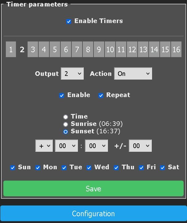

  • Request for sunrise/sunset variables and 30-minute offset
    #42 20878116
    ilengyel
    Posts: 20
    Rate: 9
    Many thanks @rickbronson and @p.kaczmarek2 for this feature.
    I updated the firmware for my lights and appears to be working for me also. I updated the setup script for my timers to include the sunset event, but was looking for a way to get the expected next sunrise/sunset values to allow setting the initial state of the light. Sample script:
    PowerSave 1
    ntp_setServer 192.168.1.12
    startDriver ntp
    ntp_timeZoneOfs 11
    ntp_setLatlong <lat> <long>
    alias high_lights backlog led_temperature 300; led_dimmer 30; led_enableAll 1; echo lights_set_high
    alias low_lights backlog led_temperature 500; led_dimmer 5; led_enableAll 1; echo lights_set_low
    alias off_lights backlog led_enableAll 0; echo lights_set_off
    addClockEvent sunset 0xff 1 high_lights
    addClockEvent 21:00 0xff 2 low_lights
    addClockEvent 23:00 0xff 3 off_lights
    waitFor NTPState 1
    // Set initial light state to match the above clock events
    // sunset - 21:00   lights set to high
    // 21:00 - 23:00    lights set to low
    // 23:00 - sunset   lights turned off
    if ($hour>$sunset_hour||($hour=$sunset_hour&&$minute>=$sunset_minute))&&$hour<21 then high_lights
    if $hour>=21&&$hour<23  then low_lights
    if $hour>=23||($hour<$sunset_hour||($hour=$sunset_hour&&$minute<$sunset_minute)) then off_lights
    Another thing, would there be a neat way to delay the sunset event by about 30mins to mimic the Civil sunset mode in tasmota ?

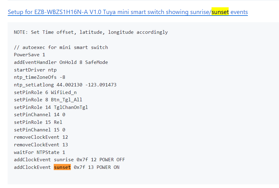

    Hello, have you checked our autoexec examples page?
    Some of the samples there may be useful for you:
    Screenshot of autoexec examples for Tuya mini smart switch.

    Would this work for
    https://www.elektroda.com/rtvforum/topic4015180.html
    on its relay 2
    // autoexec for mini smart switch
    PowerSave 1
    addEventHandler OnHold 8 SafeMode
    startDriver ntp
    ntp_timeZoneOfs -8
    ntp_setLatlong 44.002130 -123.091473
    // pins are defined for my device already
    // setPinRole 1 WifiLed
    // setPinRole 24 Btn_Tgl_All
    // setPinRole 14 TglChanOnTgl
    // setPinChannel 14 0
    // setPinRole 15 Rel
    // setPinChannel 15 0
    removeClockEvent 12
    removeClockEvent 13
    waitFor NTPState 1
    addClockEvent sunrise 0x7f 12 POWER2 OFF
    addClockEvent sunset 0x7f 13 POWER2 ON
    Thanks!

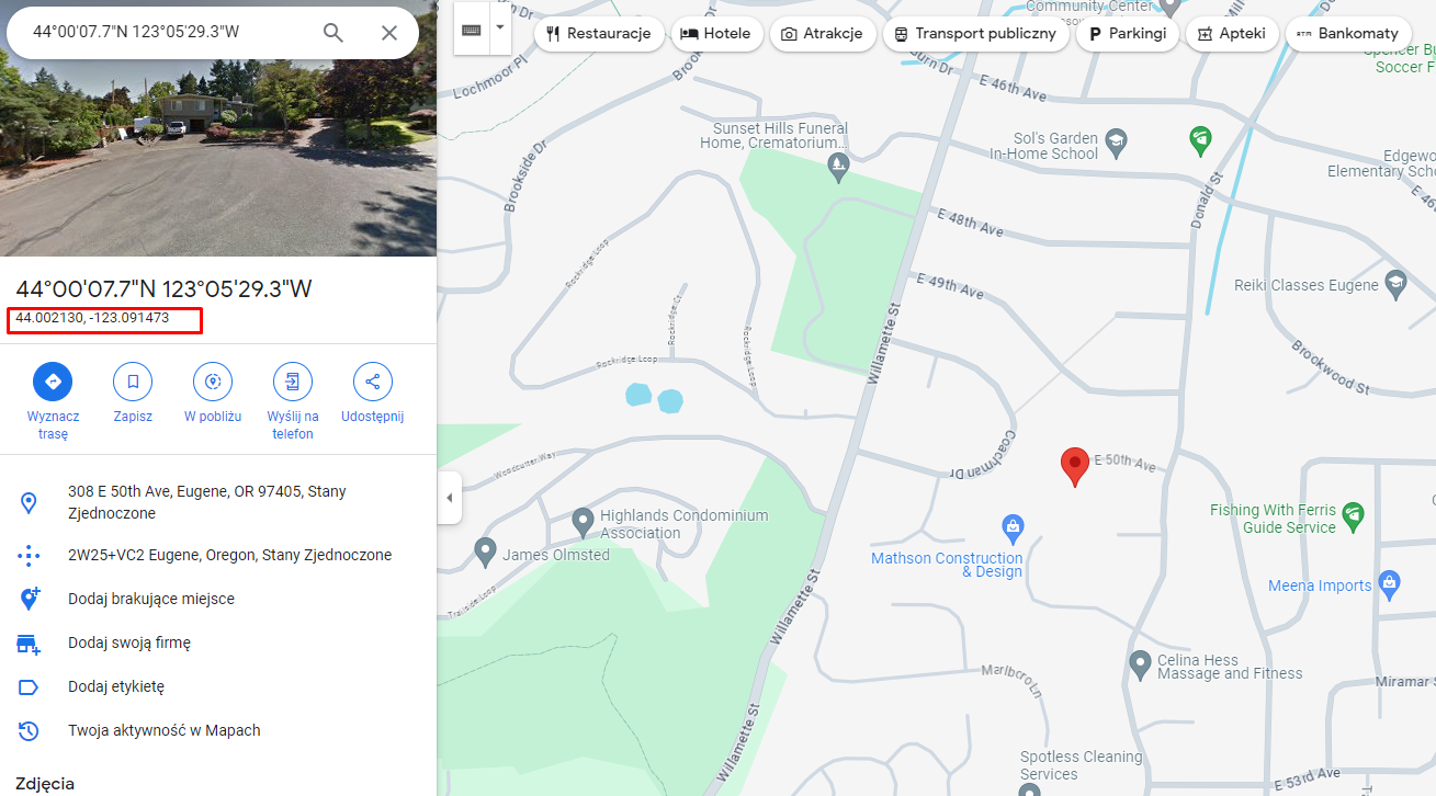

    I think you also need to update this line:
    unless, you happen to live there:
    Screenshot from Google Maps showing a location in Eugene, Oregon with geographical coordinates 44.002130, -123.091473.
    You need to insert the correct lat/long coordinate of your home location so our mathematical formula can calculate correctly the time on sunrise and the sunset.
    Futhermore, are you sure that you have correct time zone set?
    ntp_timeZoneOfs -8
  • #55 20950255
    omniron
    Posts: 114
    Yes, of course I will update those, didn't want to publish my location...
    I will try it out now.
    Thanks

    Here is the current autoexec.bat
    // I'm the entrance/Hallway switch with 2 relays, Hallway(1) and Balcony(2)
    // short press means turn all on
    // 2 second press means turn all off
    // adjust button timing for hold, from 4 seconds to 2 seconds
    SetButtonTimes 20 3 3
    // program all on and all off actions
    addEventHandler OnClick 24 startScript lights_on.bat
    addEventHandler OnHold 24 startScript lights_off.bat
    // turn off/on Balcony by Sunrise/set
    PowerSave 1
    startDriver ntp
    // must be corrected
    ntp_timeZoneOfs -8
    removeClockEvent 12
    removeClockEvent 13
    waitFor NTPState 1
