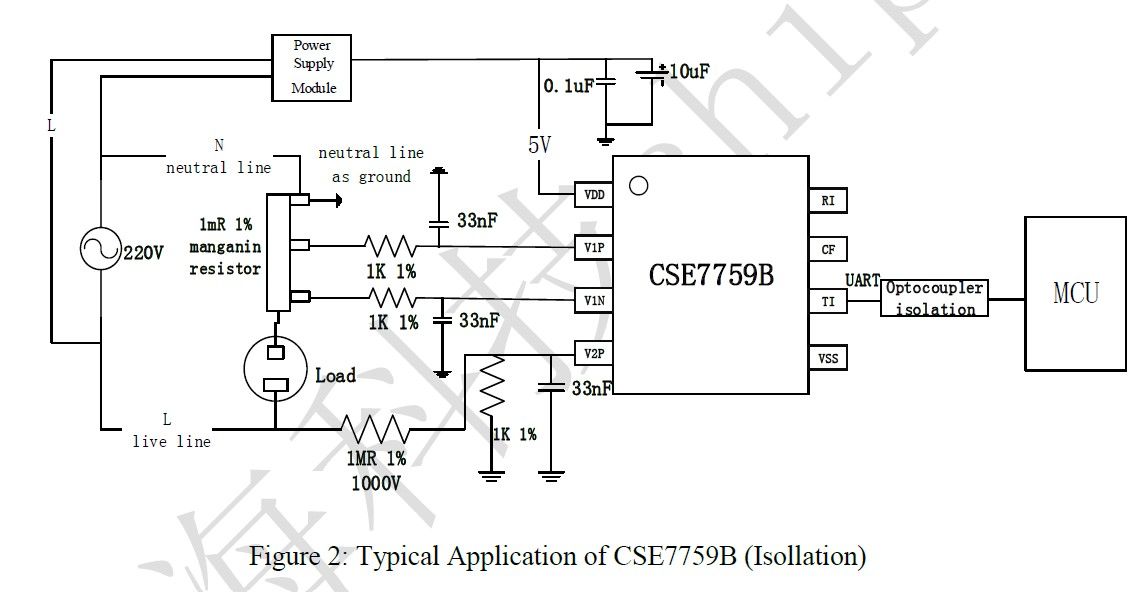

    Hi cdtdsilva, you mean something like this:
    Typical application schematic with CSE7759B chip.
    . . . and put the wifi with the Arduino. That design requires a 3.3V power supply for the BL0420 and another power supply for the Arduino.
    I believe the reason for the (recommended) non-isolated design is because it saves the cost of a CT current sensor and a ZMPT101 voltage sensor. They just use resistors instead. If you are going to use a CT current sensor, because you don't want to rewire your AC power cabling, then you only save the cost of the ZMPT101 voltage sensor and you lose that cost with the extra power supply and optocouplers. The people who built the CSE7759 meter (shown in my posts above) have realized this and that's why they prefer to use the isolated chip design. I have found the CSE7759 meter to be very accurate and sensitive. I doubt that the BL0420 will work as well because it is 3.3V. But I am willing to give it a go for the bidirectional capability.
    Everybody complains about the range of the wifi. That's the main reason we are doing this module: to have proper wifi with good range. Can you have too much wifi? I am actually steering away from wifi and RF modules. I am actually using Power Line Communications (PLC) with the KQ-130 (330) module below. These have a low bandwidth, but have a range of over 1km (or unlimited with repeaters).

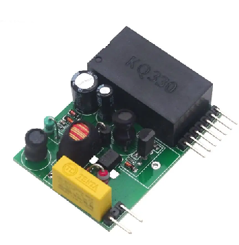

    If every switch and power point has one of these PLC modules, then the whole house (car, plane, etc) can have everything connected in parallel to just two wires (or one with ground return) and totally controllable remotely. Imagine how simple and easy that would make everything! Anyone on this forum into PLC?
    Power Line Communications (PLC) module KQ-330.
    Datasheet: Link

    You're spot on. And if using the CSE7759 you only need one optocoupler, since you're only measuring a pulse train. But will only measure absolute power
    Tuya has a page detailing some things you might find useful Link. Here they also make claims about the accuracy of the various current sensing devices they use. The CSE7759 is not listed, but I think it will be similar to the BL0937.
    The non-isolated design does indeed reduce costs, but in my experience, it also has the best accuracy. Each transducer you add (voltage, current) does introduce a phase lag and potentially some linearity error, due to the nature of the magnetic components. If you can do all your readings and then just send the result via a digital optoisolator you're more likely to require fewer pins on the host and have better accuracy overall. The fact that it comes out cheaper is the cherry on top of the cake. Thankfully power meter IC's are now very accurate and compact.

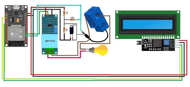

  • Arduino EmonLib as a reliable bidirectional AC meter
    #33 21017507
    cyber5
    Posts: 10
    Hi cdtdsilva, You say on your other thread . . .
    "Another device, which is not so common is the BL0942 - a fully serial programmable power monitor which provides details on power and direction and can therefore be used for measurements of energy in either direction. Chinese firmware programs the device in order to only obtain the absolute values of power, so to be able to measure its direction, it is necessary to flash it with Open Becken."
    I have been searching and searching. There are lots of power meter chips - and breakout boards, GitHub sites, videos, etc. for them - and most use the non-isolated design. But, I can't find any examples or any info on using these power meter chips to read bidirectional AC current. And what you describe above seems highly experimental and not guaranteed to work.
    So the simplest solution is to just use an Arduino and the emon lib: https://github.com/openenergymonitor/EmonLib
    I have been using this for years and it has proven itself to be accurate and reliable. Here is an example setup:
    Power monitoring setup schematic with Arduino and display.
    If you want the code for this just let me know.

  • Suggesting PLC instead of per-unit Wi‑Fi for meter boxes
    #35 21018309
    cyber5
    Posts: 10
    I just googled "TO-Q-SY1-JWT" and this came up.
    Panel with eight Tongou Wi-Fi smart switches, model TO-Q-SY1-WT, mounted on a DIN rail.
    See here: Link
    What you have there is 9 competing wifi units transferring trivial amounts of information - and most meter boxes where these things go are Faraday cages. That's about as stupid as using an excavator to dig an ant hole in a waterfall. That's what I mean by having too much wifi!
    A better system would have these units talking to each other via PLC (Power Line Communication) and a separate pluggable PLC unit with wifi (that can be plugged into any powerpoint) for collating the information and communicating with the host or phone app via wifi.

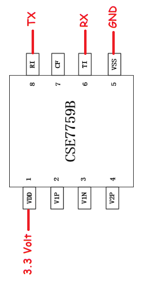

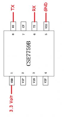

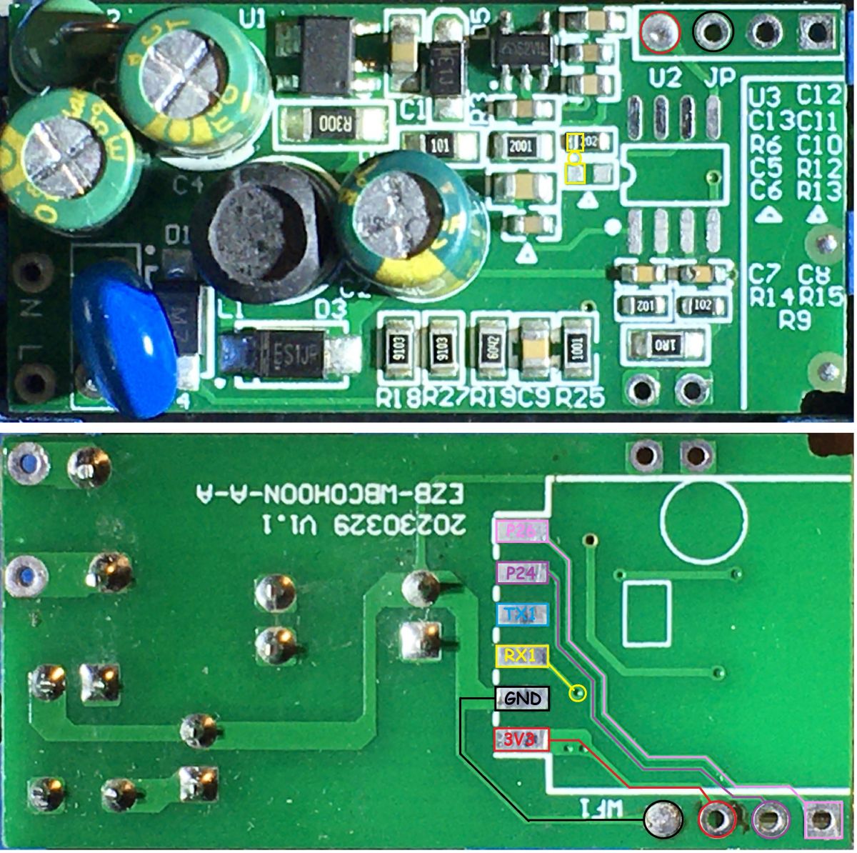

  • Need guidance on connecting CB2S to PCB pads
    #38 21062805
    ThomasBW
    Level 4  
    Posts: 8
    Dear all,
    I am new in this forum and trying to program Open Beken on an EARU EAWEM-T-CT power meter.
    User taktlos shared a lot of information about the power meter and it seems that he also installed Open Beken on it.
    I tried to install the software but failed.
    I desoldered the CSE IC from the PEC and also the ribbon cable.
    The programmer was connected to the PCB pads of the CSE chip as shown below.
    Diagram of the CSE7759B chip with PCB connection labels.
    I was not able to connect the CB2S.
    Can somebody guide me on how to connect the PCB correctly.
    Thanks to all,
    Thomas
  • Unsoldering CB2S enabled OpenBeken flashing
    #39 21065077
    ThomasBW
    Level 4  
    Posts: 8
    Dear all,
    I check the reason why I could not program the CB2S.
    After a lot of measurements, I think the reason is that the TX1 of the CB2S is not connected to CSE.
    About this, I think the only way to program the CB2S is to unsolder the chip.
    After this, I could program the Open Beken on the chip.
    Resoldering and it worked.
    PCB board with visible connectors and electronic components.
    How can I set up The Open Beken so that the device starts to work? CSE7759B I cannot select or find or how to set up.
    This is my first time using OpenBeken and then with such a complicated device.
    If somebody can help a newbie, I will say thanks in advance.
    Thomas

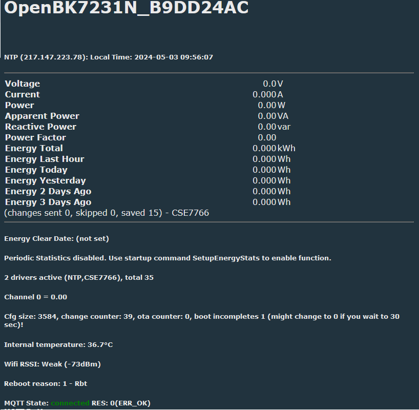

  • Need help configuring P10 RXD1 for CSE chip
    #41 21067212
    ThomasBW
    Level 4  
    Posts: 8
    Dear p.kaczmarek2,
    first of all thanks for your support and help.
    I checked your Links and added the Line to the autoexec.bat.
    After restart I could see the Measurement interface on the screen with all values with 0.
    Measurement interface of OpenBK7231N system with energy values at zero.
    I think that I have to config the P10 (RXD1) in the config but I don't know what I should enter CSExxxx. I cannot find it in the menu.
    Can you give me a proposal on how I should set up the Pins in the Configure Module.
    Thanks in advance
    Thomas

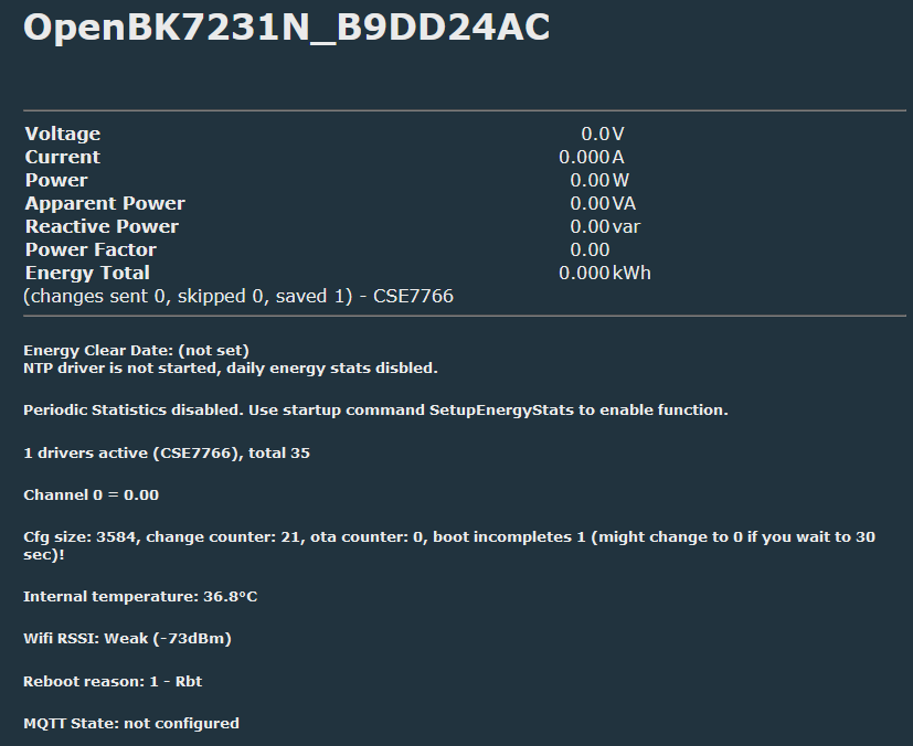

  • CSE7766 driver not communicating over UART
    #42 21068506
    ThomasBW
    Level 4  
    Posts: 8
    I read a lot of Posts about CSE7766 but still no communication with the CSE.
    When I check the LOG no entry.
    I did the follow steps.
    1. Add a autoexec.bat
    startDriver NTP
    startDriver CSE7766
    2. Add Flag 26 - [UART] Use alternate UART for BL0942, CSE, TuyaMCU, etc.
    The soldering looks OK, CB2S is also in position in worst case I will take it off again and make the connection with wires.
    The only point I am not sure is that the UART connection is setup correctly or I forget something.
    Screenshot of the control panel OpenBK7231N with no measurement data from CSE7766.
    I am a beginner so cannot see something.
    Also the LOG looks a bit strange because no idea what it means and every secound a message.

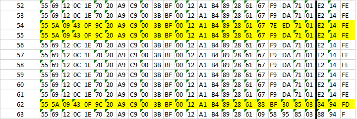

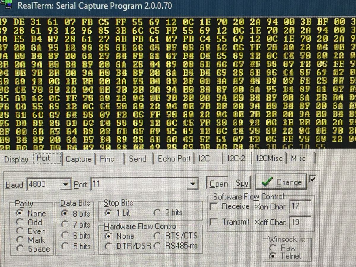

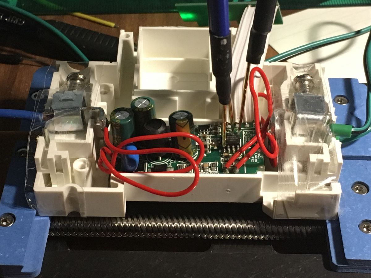

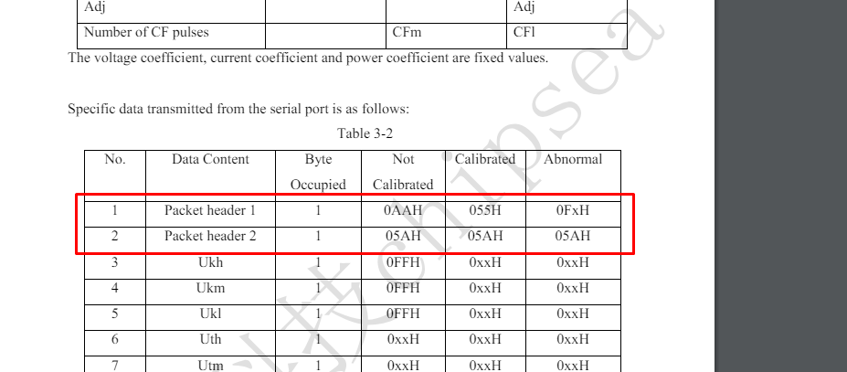

  • CSE7759B sends 0x55 0x69 frames, not 0x55 0x52
    #43 21070333
    ThomasBW
    Level 4  
    Posts: 8
    I checked today my device again about the missing UART communication.
    To handle not with 230V I use the programming adapter as Power Supply.
    Connect 5V and GND on the CSE and then connect RX programming adapter to the TX of the CSE.
    Close-up of an open electronic device with connected wires and test probes.
    After connection switch on the Adapter and the EAWEM-T-CT connect to the wifi everything normal and all Values "0".
    I use Realterm to check the communication and I can see that the CSE communicate.
    Screenshot of RealTerm program displaying data in hexadecimal format.
    I read in the thread that the Data will transmit in 24 Bytes and the first and second byte is 0x55 and 0x52, so I search for this but all Data have more than 25 Bytes and 90% or more starts with 0x55 0x69.
    Screenshot of hexadecimal data, entries highlighted in yellow.
    Maybe this is the reason that no Data is shown in the OB.
    Has somebody same experience? And maybe a solution?

    We are checking for 0x55 0x5A header, I don't know what 0x69 is. Maybe we need to alter the driver code... that could be done easily - we have online builds.
    Here is CSE7759B datasheet:
    CSE775..pdf (1 MB)You must be logged in to download this attachment.
    Screenshot of a data table showing packet headers 1 and 2 with hexadecimal values for uncalibrated, calibrated, and abnormal cases.
    according to this document, second packet header byte is always 0x5A so I am a little suprised... but maybe we need to read into it a bit more
