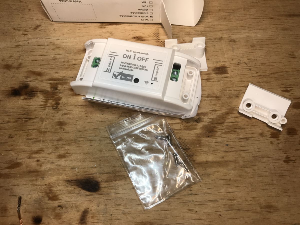

    Set contents:
    Wi-Fi ON/OFF relay module and mounting components on a table

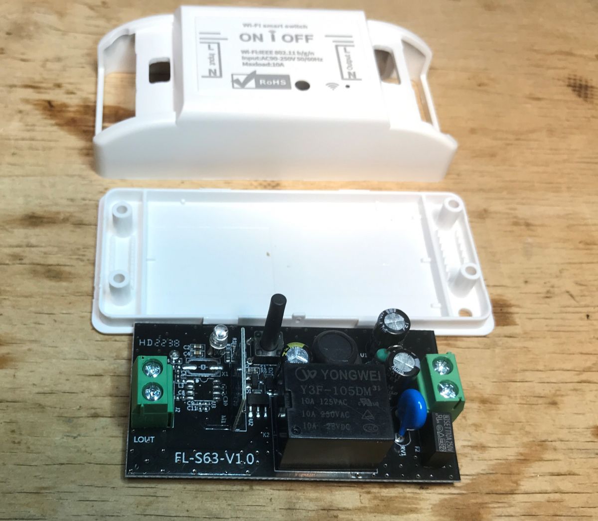

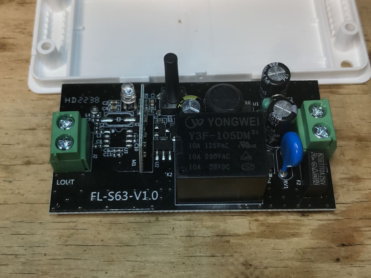

    LXU402 interior
    We look inside:
    Open LXU402 relay module with visible electronic components on the PCB.

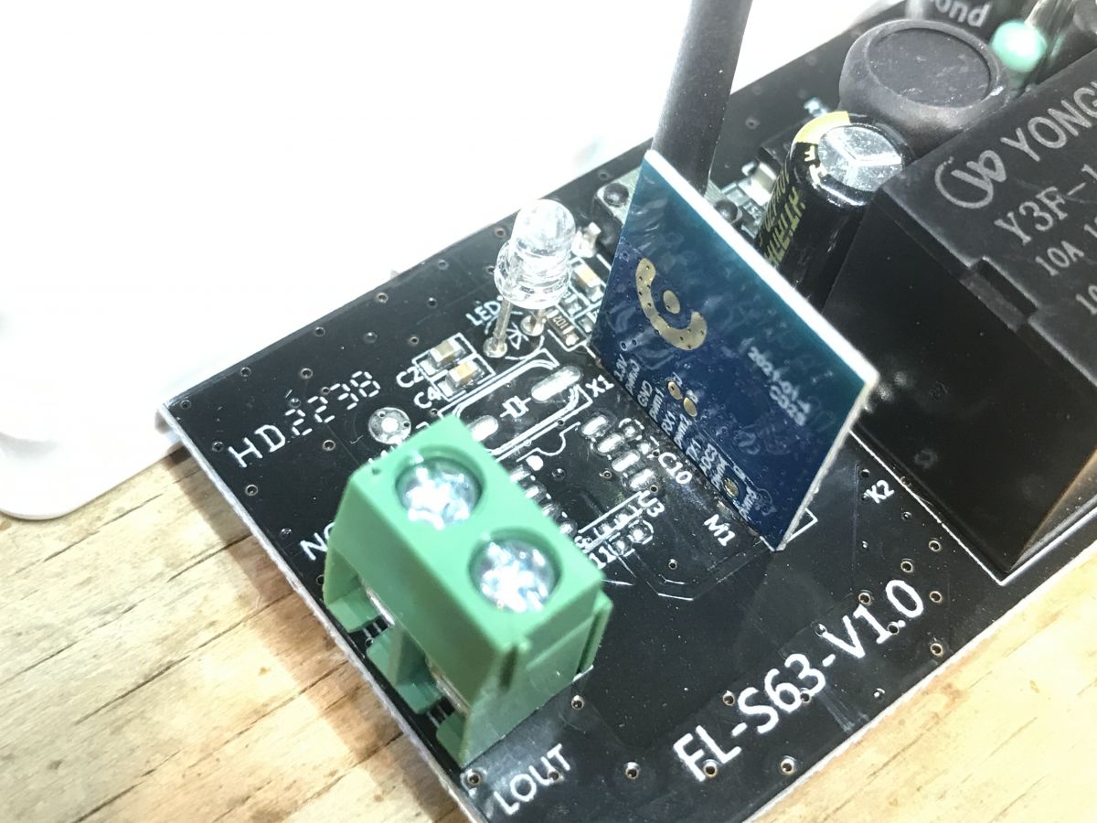

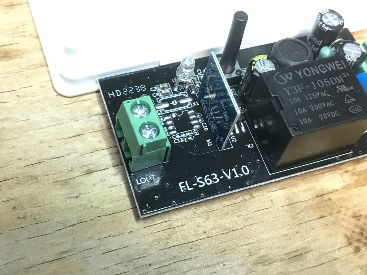

    PCB name: FL-S63-V1.0
    You can see here the place for the radio system, the SOIC8 element and the resonator. Y3F-105DM relay:
    Close-up of the interior of the LXU402 relay module showing the PCB. PCB board of the LXU402 relay with electronic components.
    At least there is a fuse and a varistor at the input.

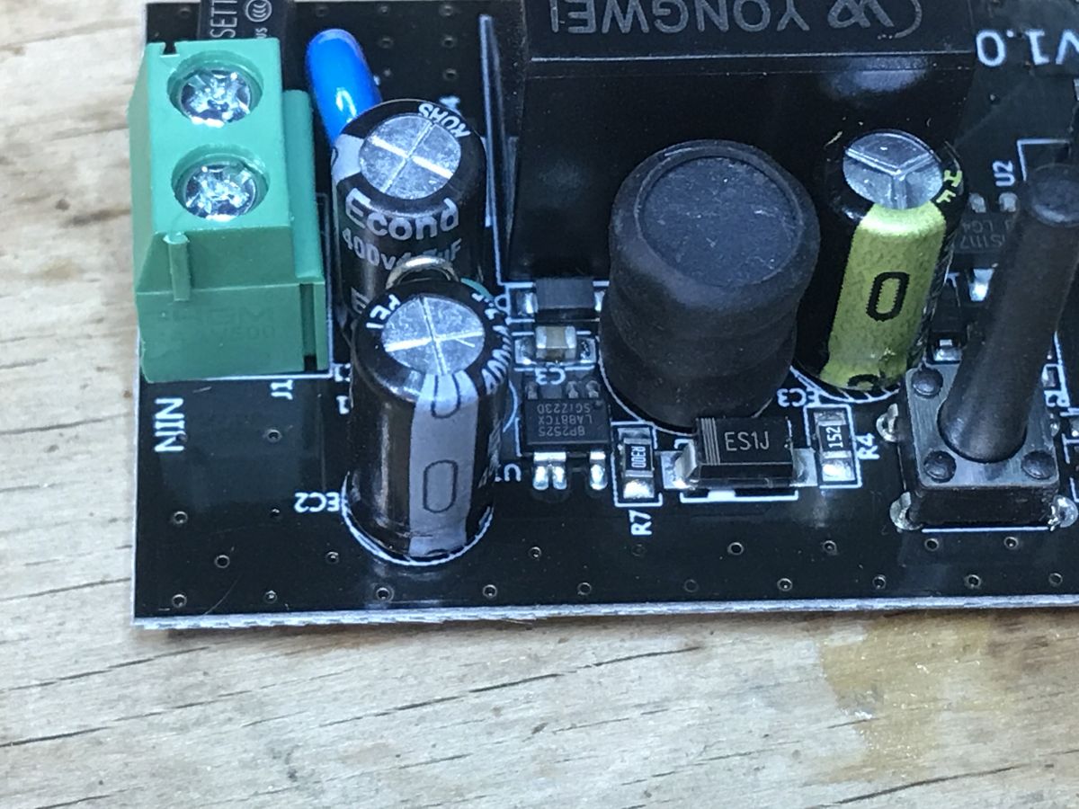

    Interior of the relay module marked FL-S63-V1.0

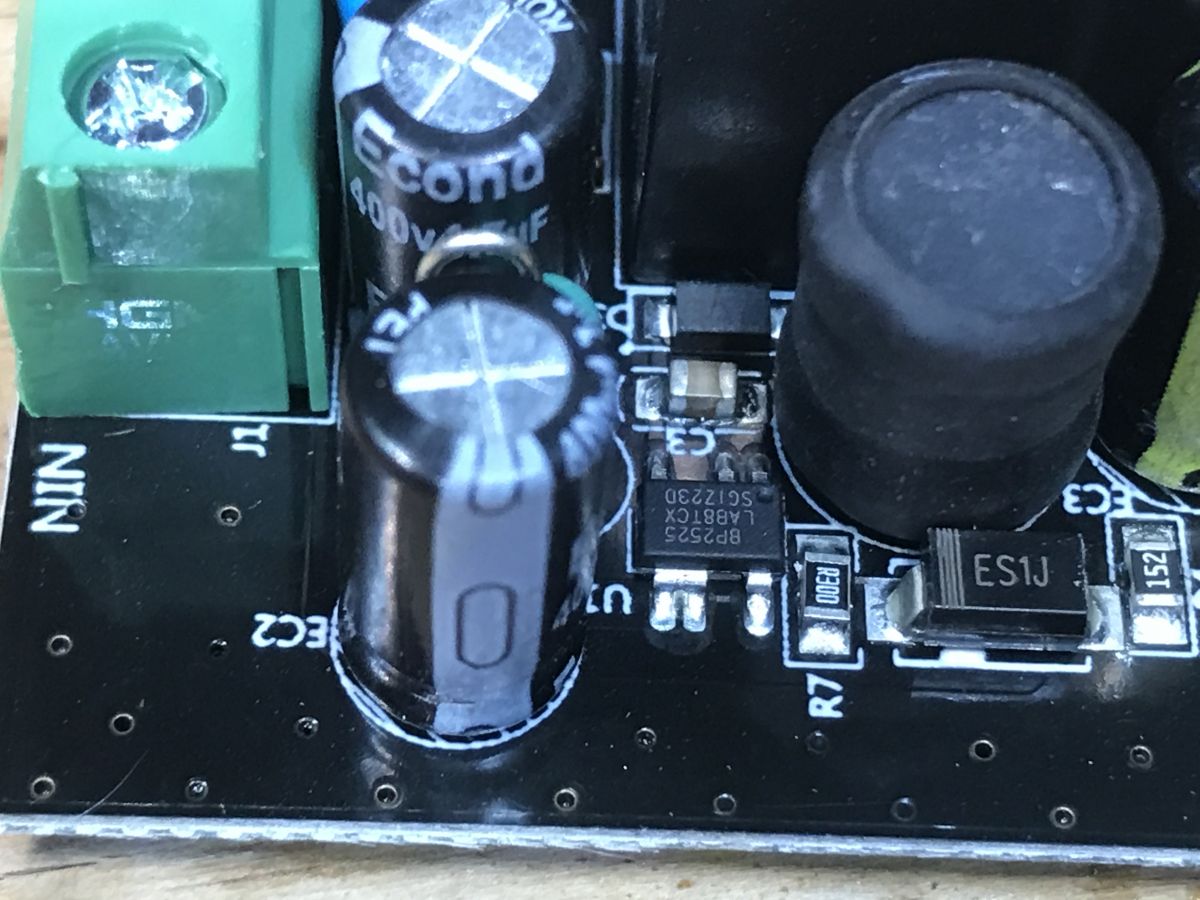

    The entire BP2525 power supply (as usual! Non-isolated power supply, step down from the mains) and AMS1117-3.3V:
    Close-up view of electronic components on a printed circuit board. Close-up of the relay module interior with electronic components.

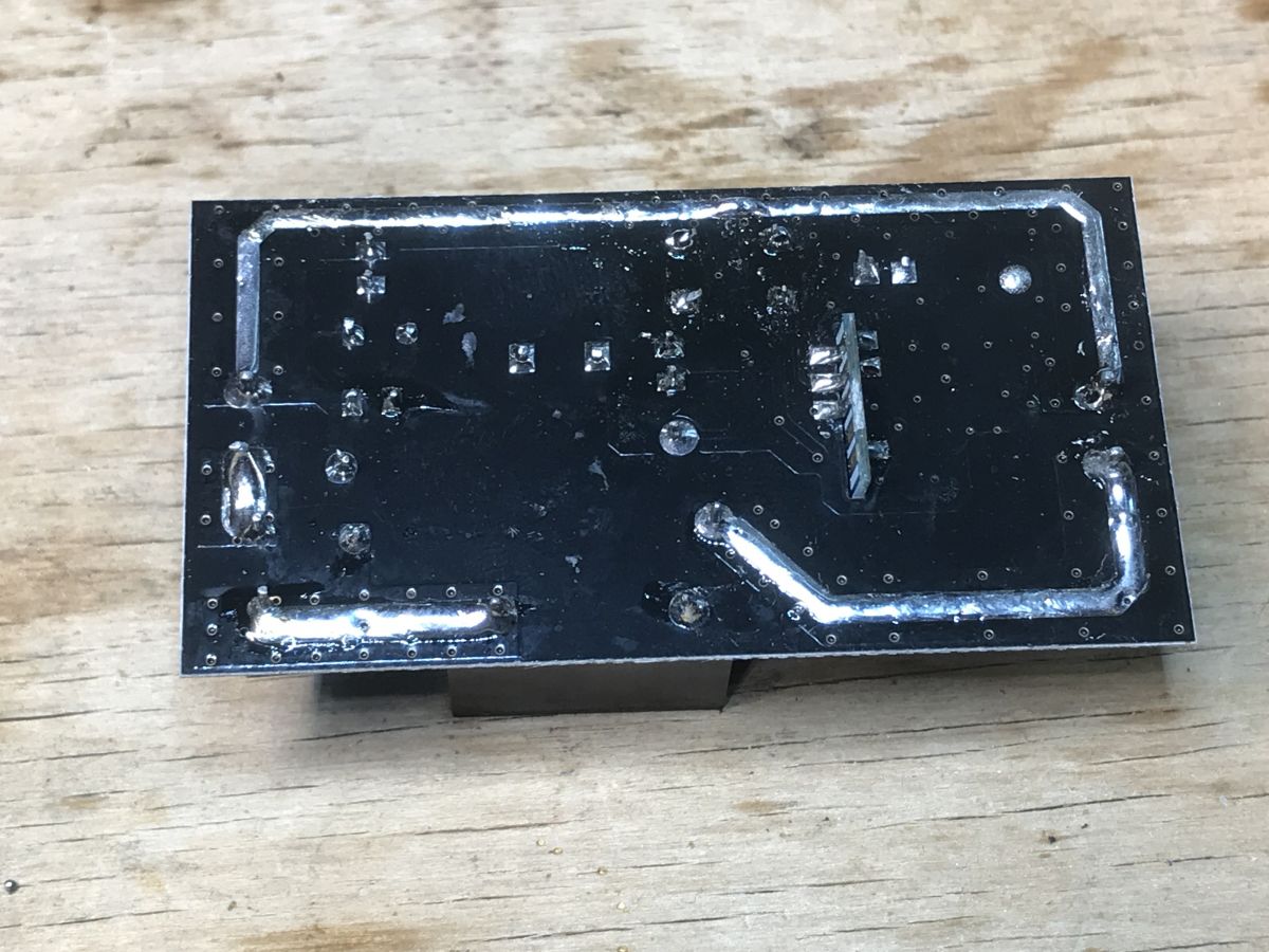

    The current paths are bold (the relay cuts off only one wire):
    View of the bottom side of the LXU402 relay PCB.

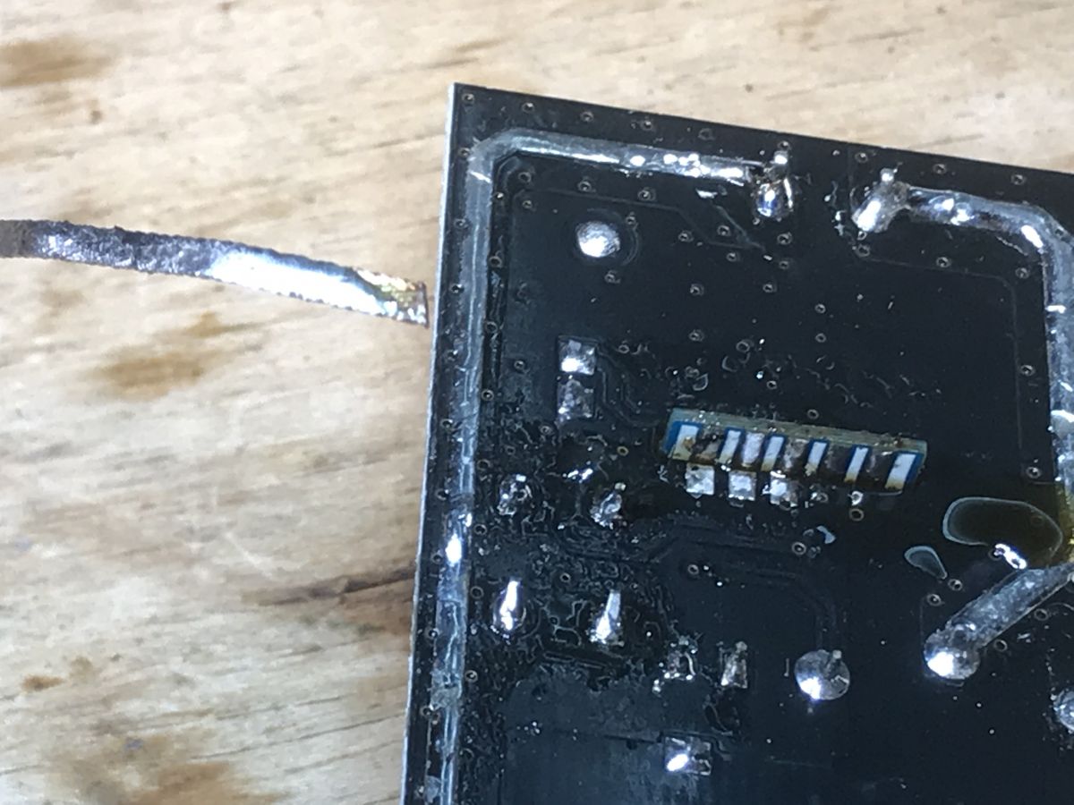

    LXU402 firmware change

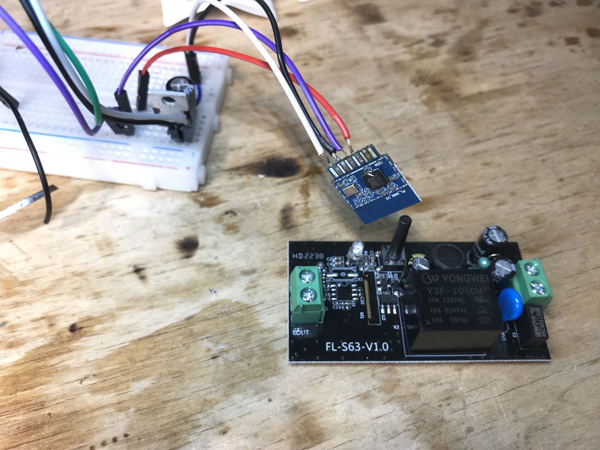

    The easiest way is to desolder the module. All you need is flux and braid. This saves us from problems like "we have a button with a capacitor on TXD1 and it interferes with programming":

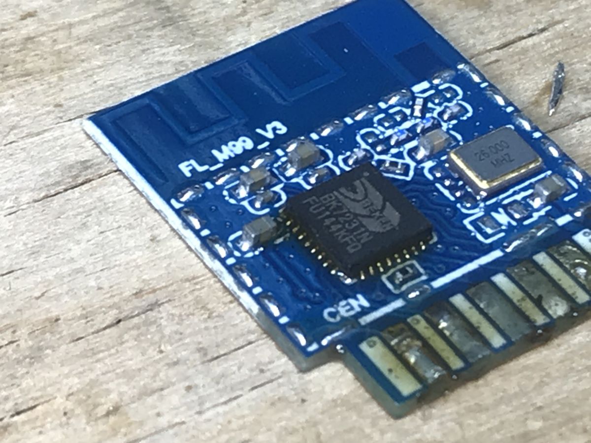

    FL-S63-V1.0 PCB with soldered wires on a wooden background.

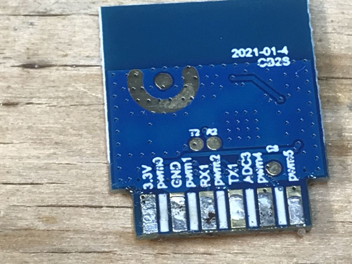

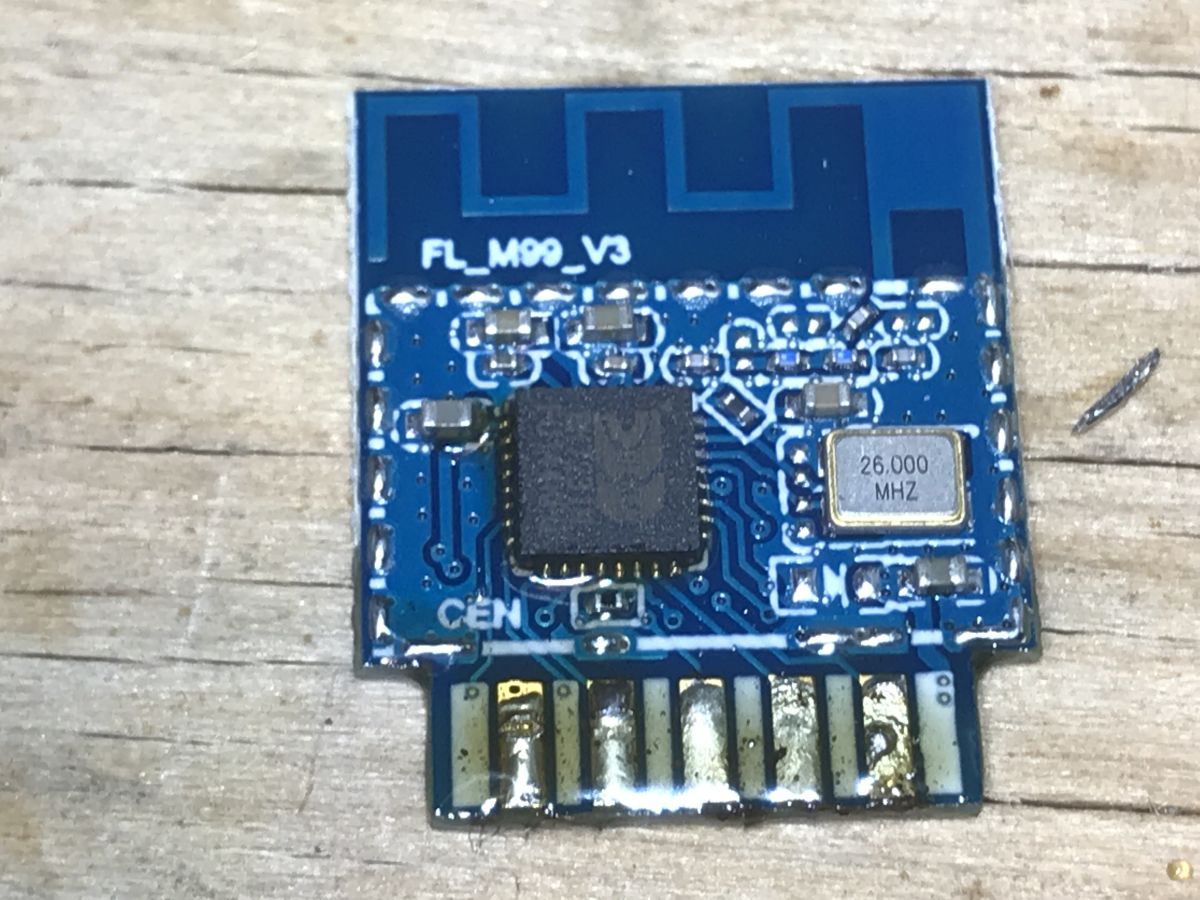

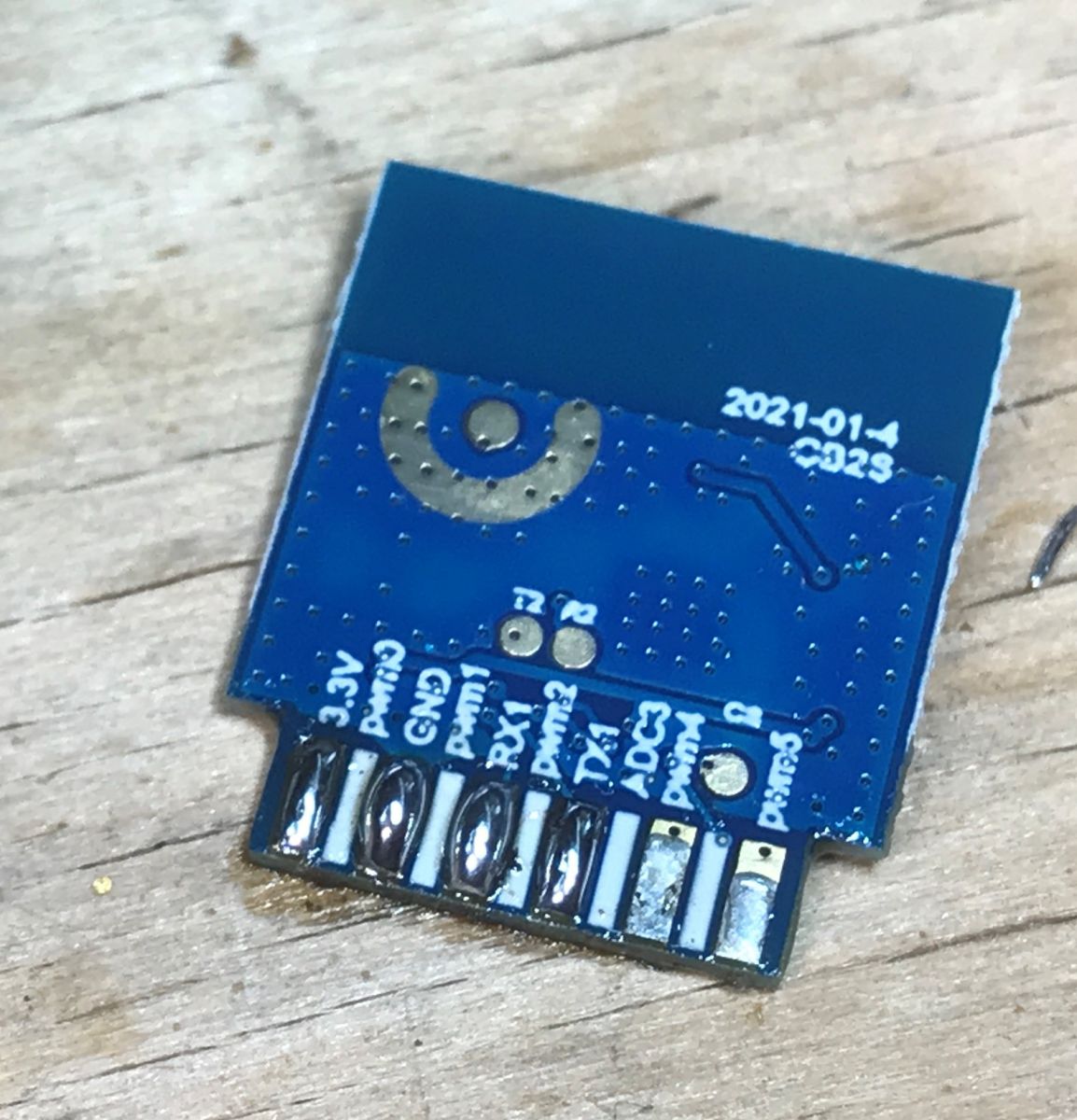

    Desoldered:
    PCB with pin labels, including 3.3V, GND, RX1, TX1. Photo of a WiFi module with a BK7231N microcontroller. Close-up of the FL_M99_V3 PCB with the BK7231 chip.
    GPIOs are signed - we need 3.3V, GND, RX and TX.
    We upload the batch according to:
    First I whitened the pads:
    Electronic module with labeled pins on a blue PCB board.

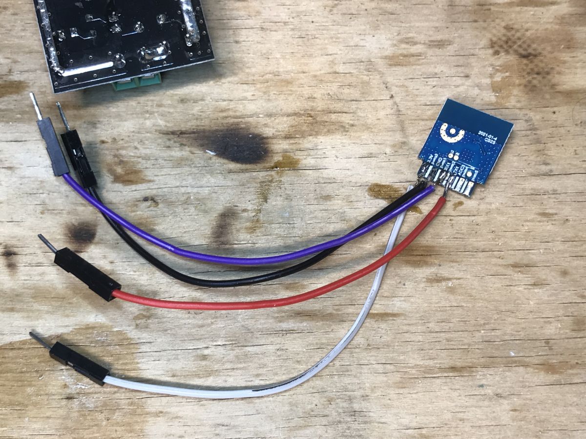

    Then I soldered the cables:
    Relay module with four soldered wires on a table.

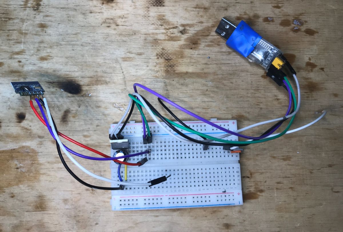

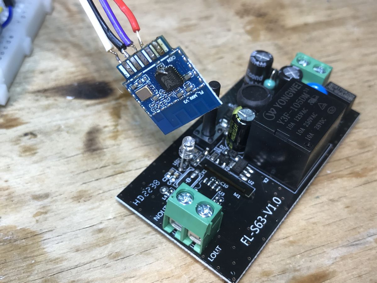

    Here is my USB to UART and LDO 3.3V converter to power the WiFi module:
    Prototype breadboard with wires and a USB module.
    LXU402 relay module PCB with desoldered and soldered chip.
    FL-S63-V1.0 relay board with soldered WiFi module wires.
    After performing the power off/on cycle, the flasher correctly programs this module and loads OpenBeken, having previously read the Tuya configuration:
    Interestingly, the FL_M99_V3 module is seen by Tuya as CB2S .

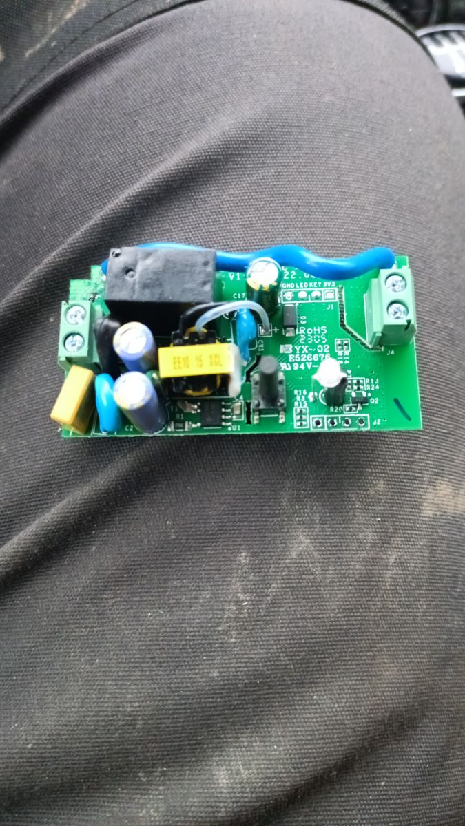

  • #2 20883027
    marik_te
    Level 22  
    Posts: 666
    Help: 29
    Rate: 57

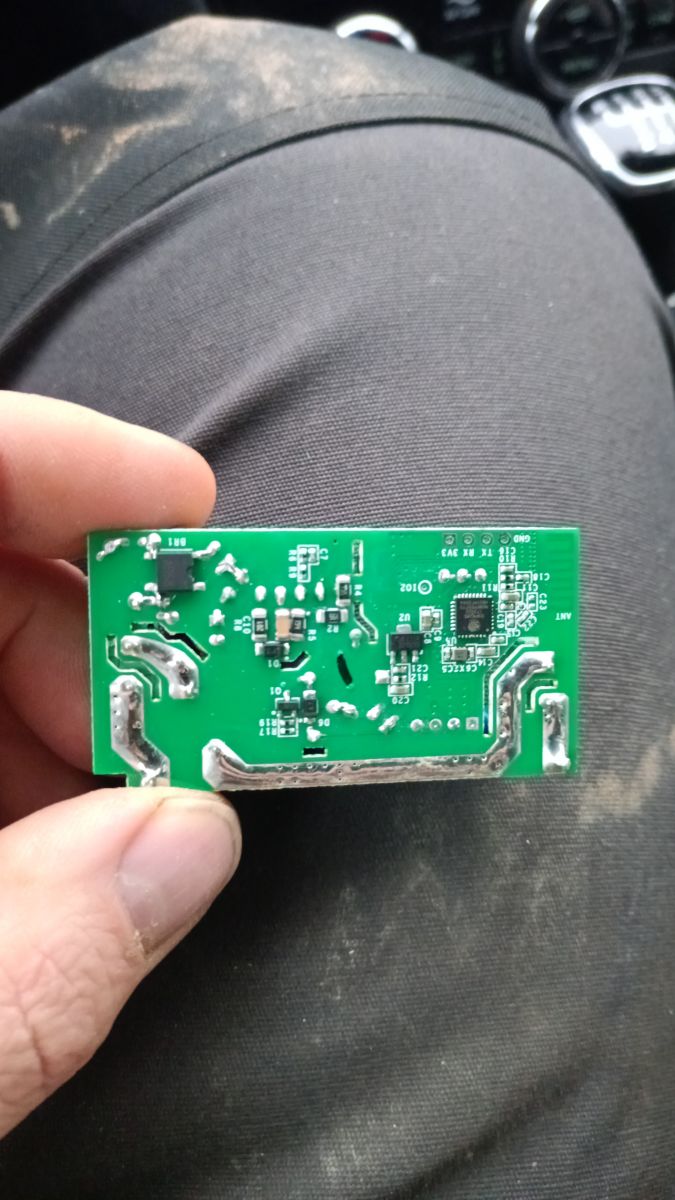

    As a curiosity, Sonoff`s photos. The housing is identical from the outside, but a completely different structure inside. And the price is almost the same.
    Image of a Sonoff electronic board on black pants, showing various components. Close-up of a Sonoff circuit board held in hands.
